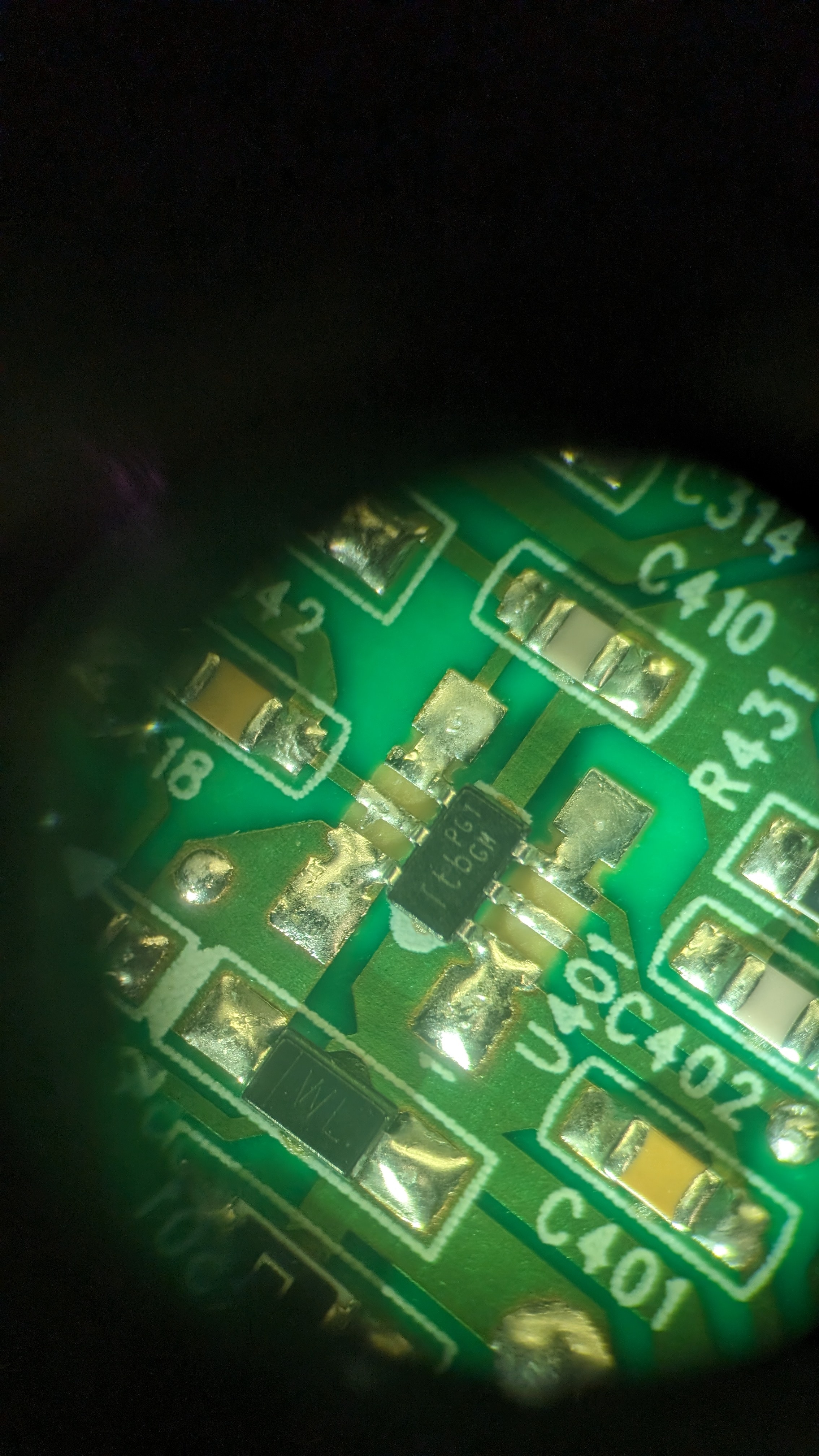

    Hey guys, I'm trying to identify U401 on the subject board. I've attached a picture of the IC, but can't make any sense of the code and my Google searches bring up nothing. Hoping somebody can help!
    Nick

    Check this out https://www.diodes.com/assets/Datasheets/DMP6110SVT.pdf

      This is PWM, not Mosfet!
      https://elektrotanya.com/content/tcl...-ic-azonositas

        I agree lotas, not a MOSFET. So, am I safe to use PF6003AG like in the link you sent?

          Your PWM manufacturer is "Leadtrend Technology" (their font).
          Well, since they write that it fits like an analogue, then download the datasheet and compare the pinout with yours...​

              Alright, so I found it. It is an LD5537G1. But, I can't find any G1 variants for purchase, all I can find are LD5537T which is just the basic LD5537 I think. I attached the datasheet for G1. Does anybody know of an equivalent that I could order on Digikey? Is the standard LD5537 ok to use?
