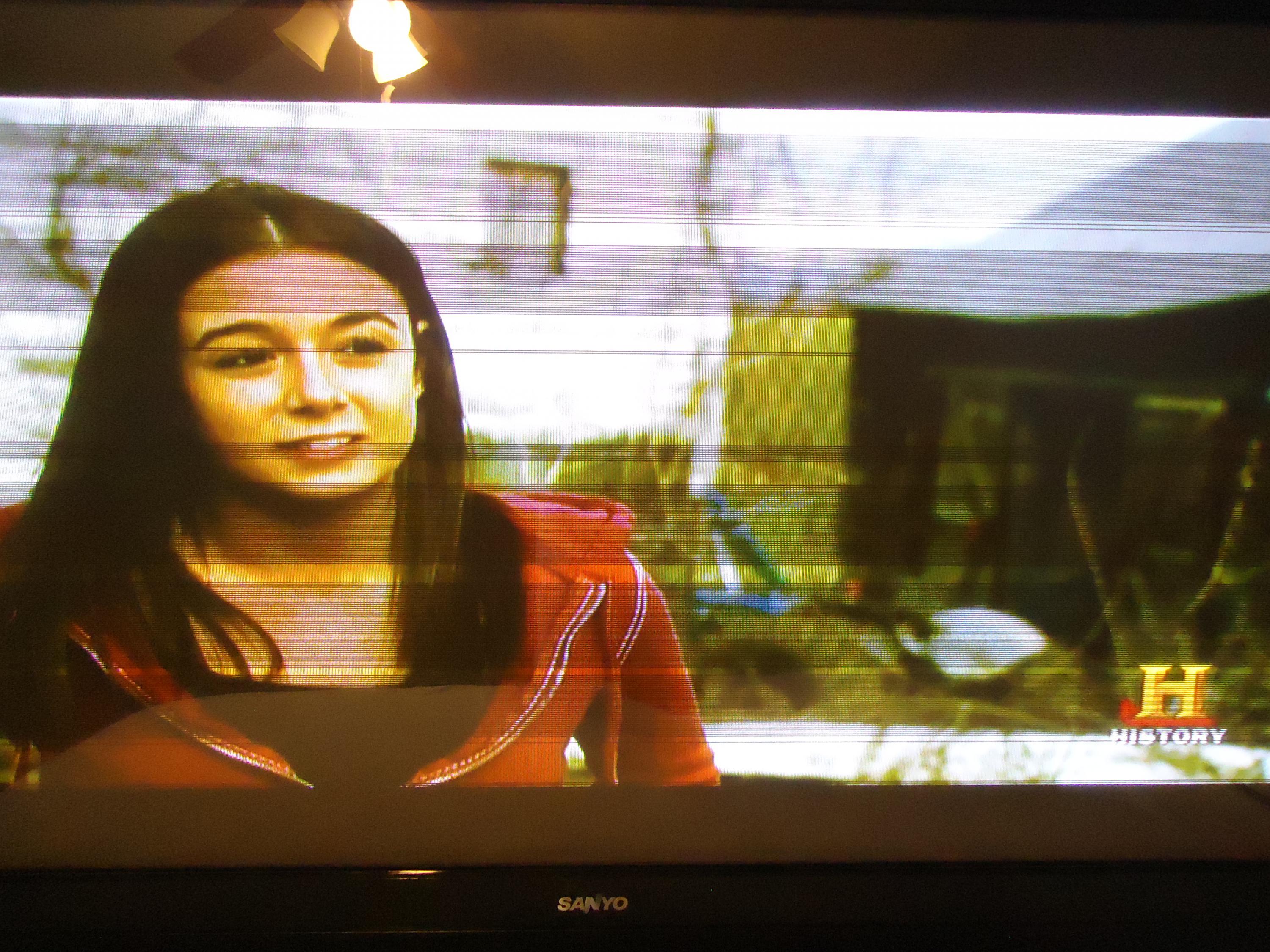

    I got this tv for 50 dollars brought it home and plugged it in this is what I got.
    Does this look like a bad panel Don't want to just toss money at it.
    The buffers have no shorts and all the ICs look good.

        That is most likely poorly seated ribbon cables on the Y-buffer board. Panasonic/LG/Samsung panel?
        Easy fix, looks like someone may have replaced Y-buffer but couldn't seat ribbons proper.
        Only adjust them with POWER OFF!!!

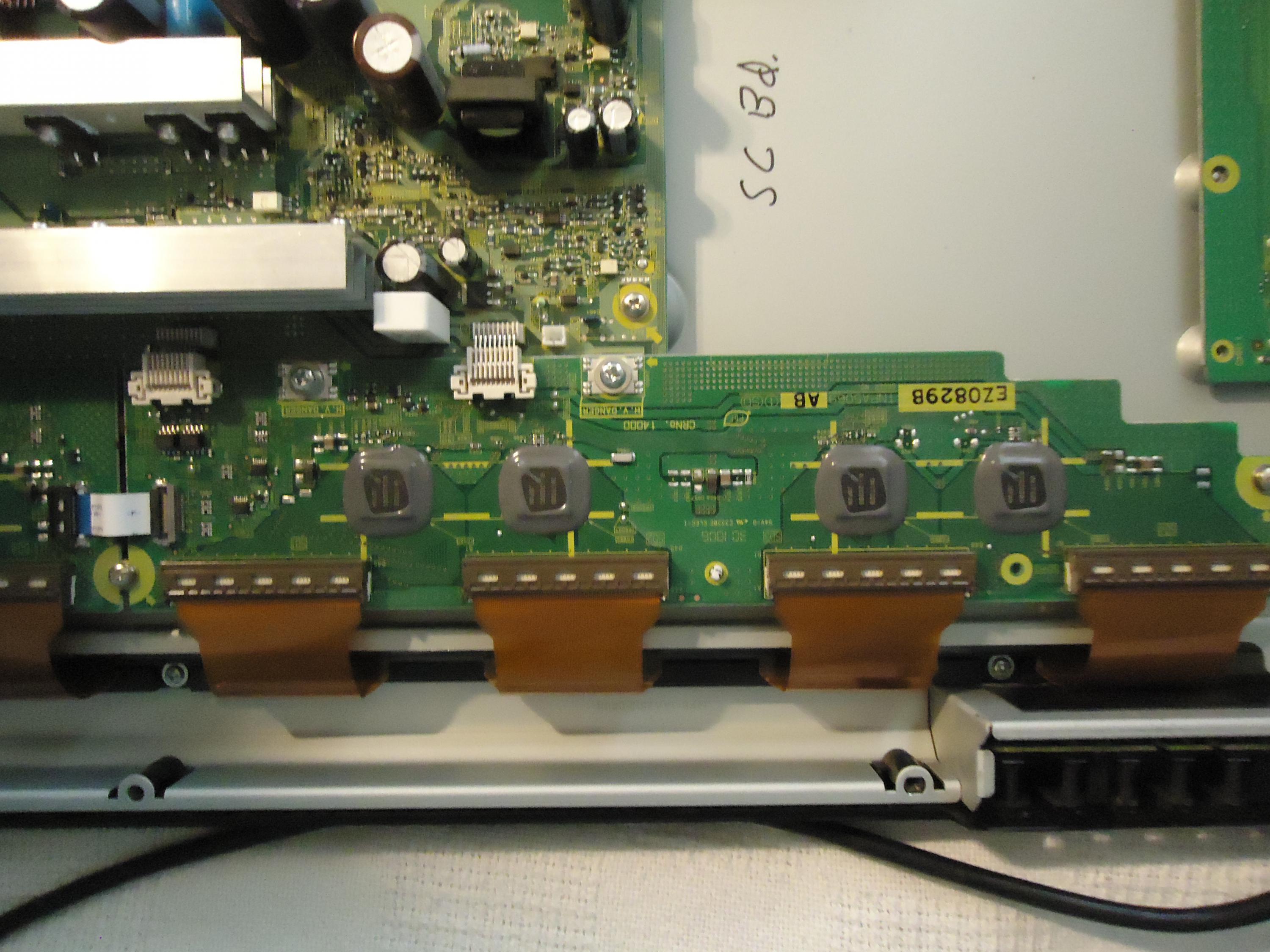

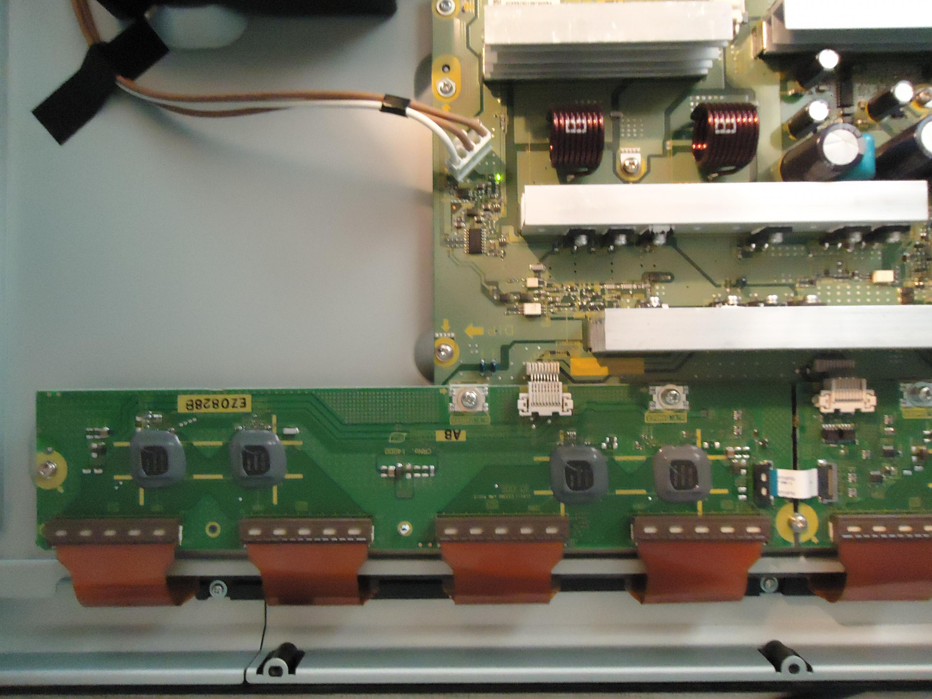

                OK here are the pictures

                  Re: Sanyo DP50740 weird lines
                  Do you need a picture of the cable disconnected?
                    So, Panasonic panel. Those are the trickiest.
                    Basically, pull every ribbon out. Start from scratch.
                    Undo the latch (lift it), slide cable in. Two positions: first is the easy one, the obvious one. Avoid that. Second gives a little click. You want to hear/feel that click, and make sure it's perfectly lined up in the horizontal.
                    Do that for each ribbon, and it should be golden.
                    From experience (having done a couple of Panasonic panels), these are always buggers to get right.
                    Be very careful not to tear/damage the ribbon.

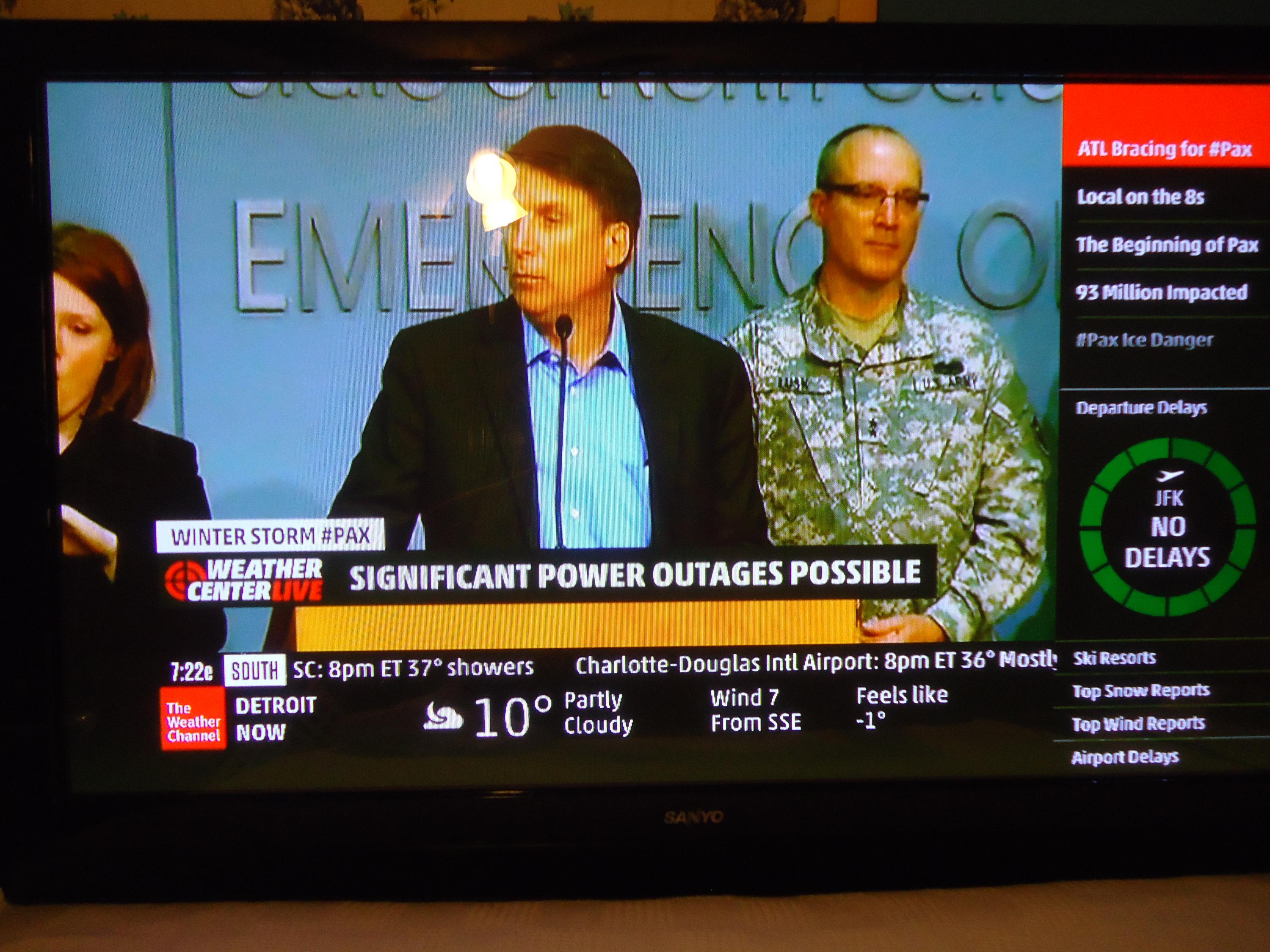

                        Tom66 its working thank you very much. I was ready to part this tv out. Its the click that I wasn't doing before very flimsy ribbons I didn't want to break them first time. Thanks again

                                      That is the picture after the ribbon reseat.
