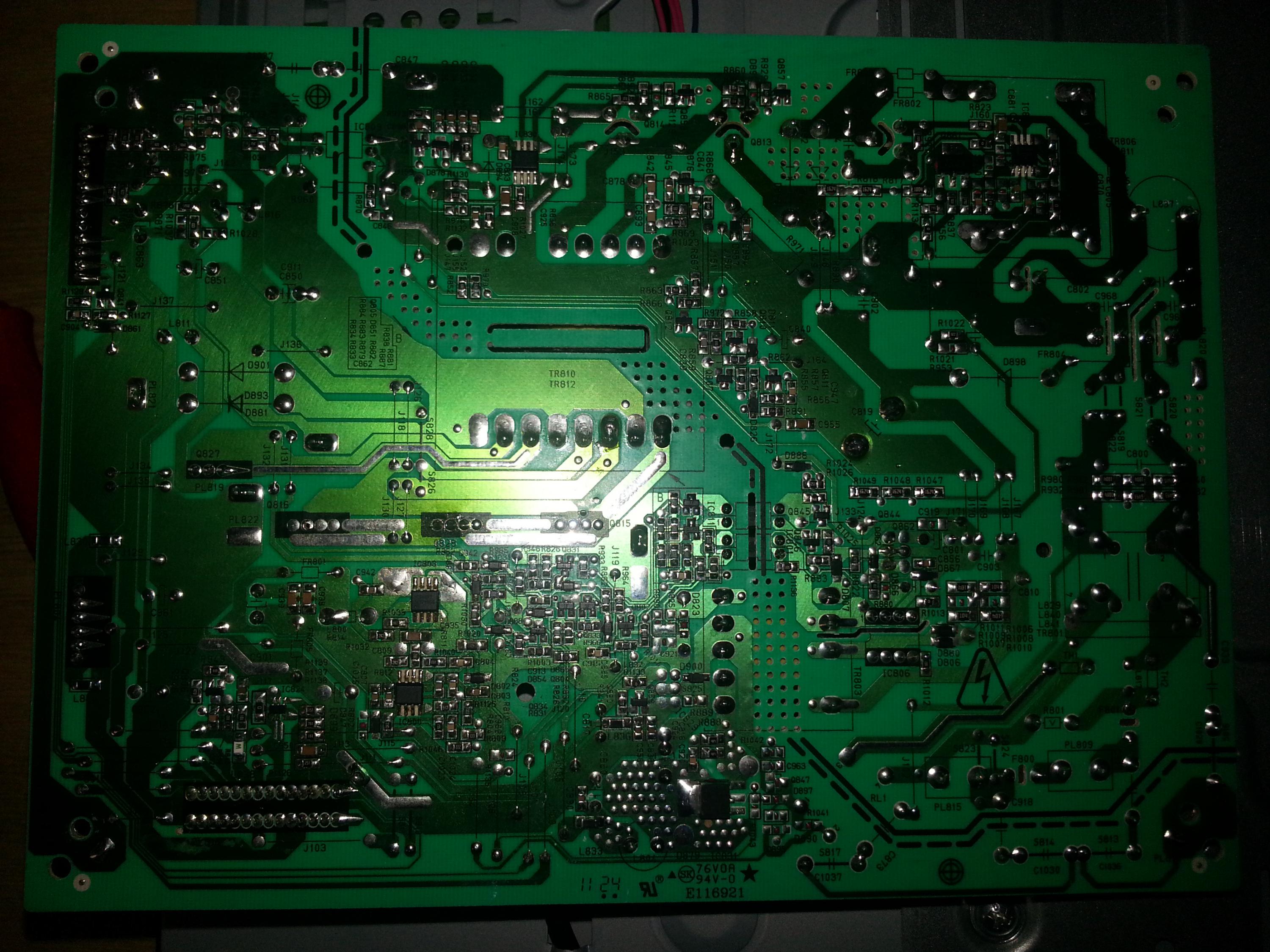

          OK i have 12V, 3,3V 24V but there is no 5V. On 3 pins where should be 5V i got 0,8V only.
            Re: LCD TV SHARP LC-32SH340E can't start

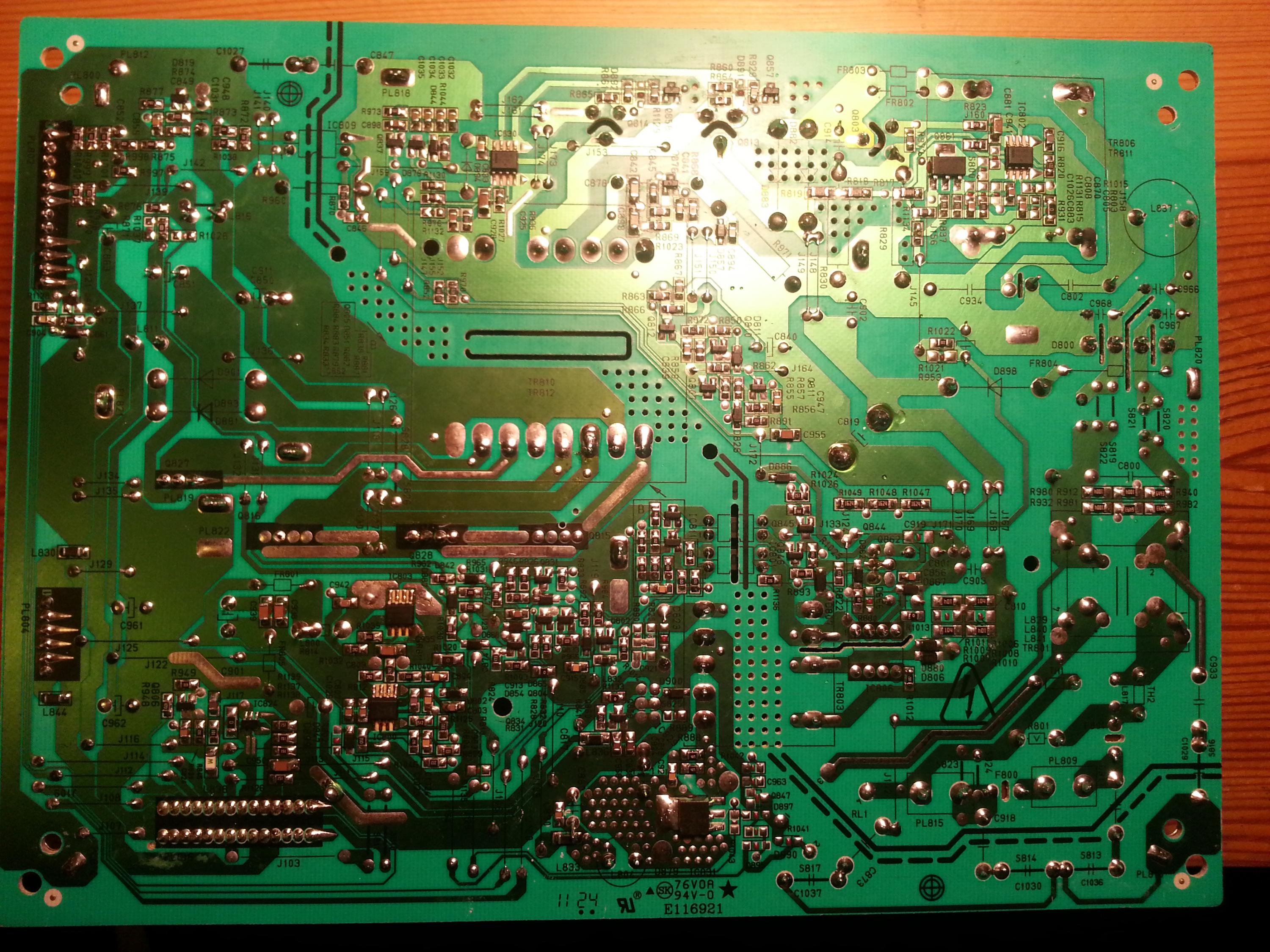

            Post a picture of the underside of your power supply. The 5V is generated by buck converter from 12V supply.
              Sorry for bad quality, not easy in night
              I found brown place right under IC803 (MDS5852), it's on photo, looks like it was overheated.
                Can you double check that part #? Can't find anything on it. It is quite possible that part is at fault.
                  Sorry for that, MDS 5652 DK 174HGG
                    OK, that's the MOSFET, it could be bad and can be tested later. What about IC801?
