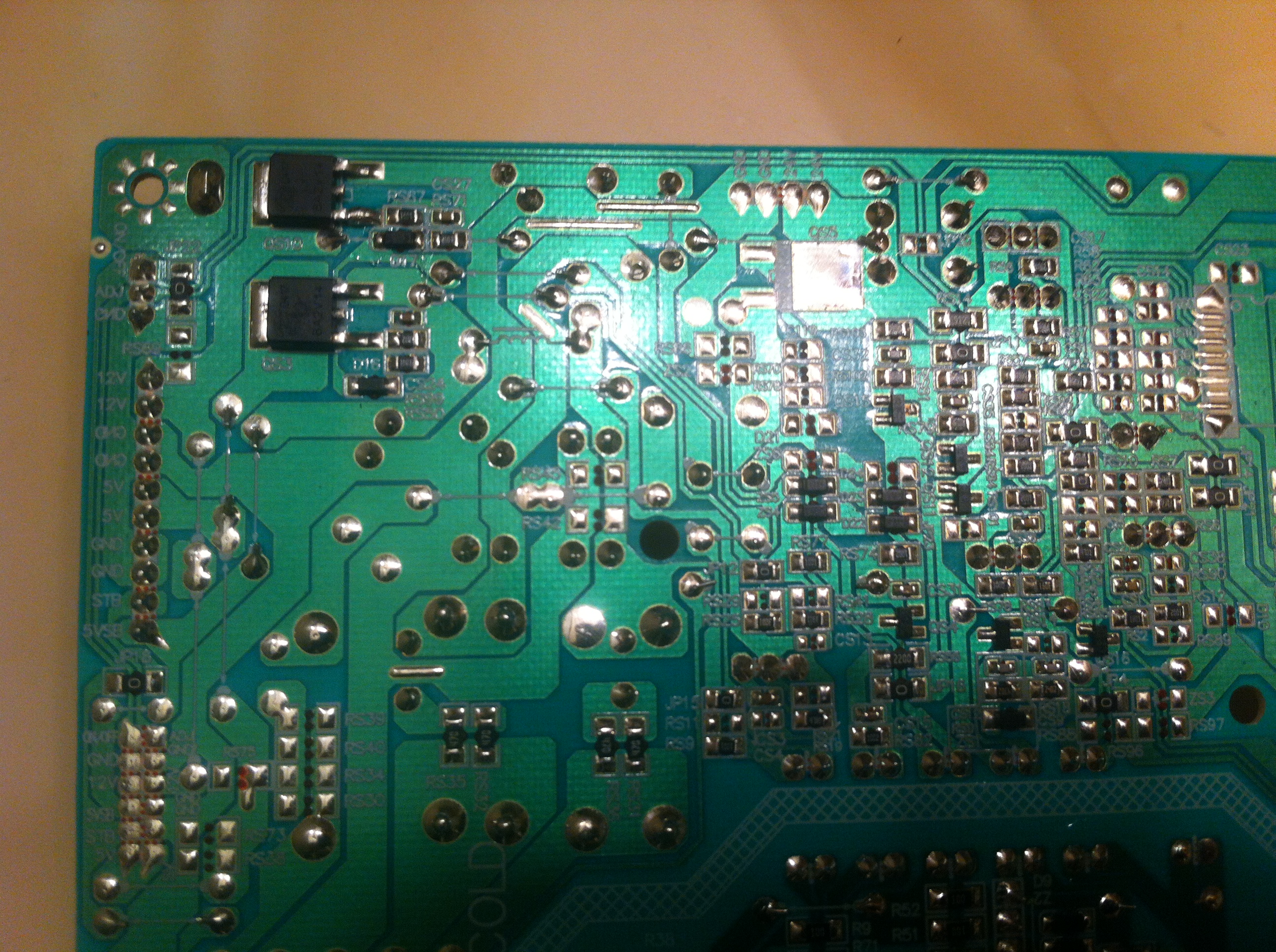

          That reading indicates main board is switching on LED backlight. So fault is with PSU or backlighting.

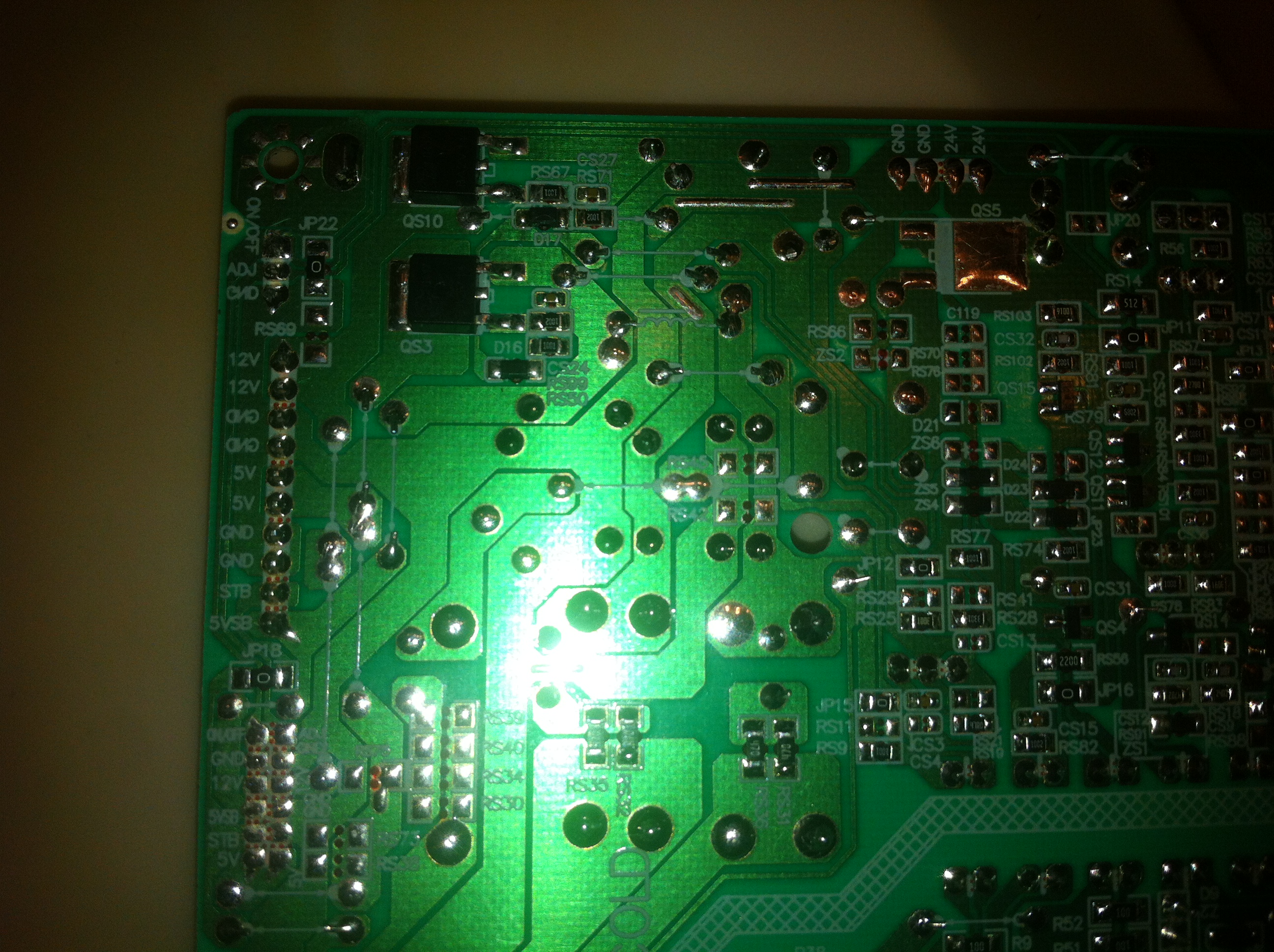

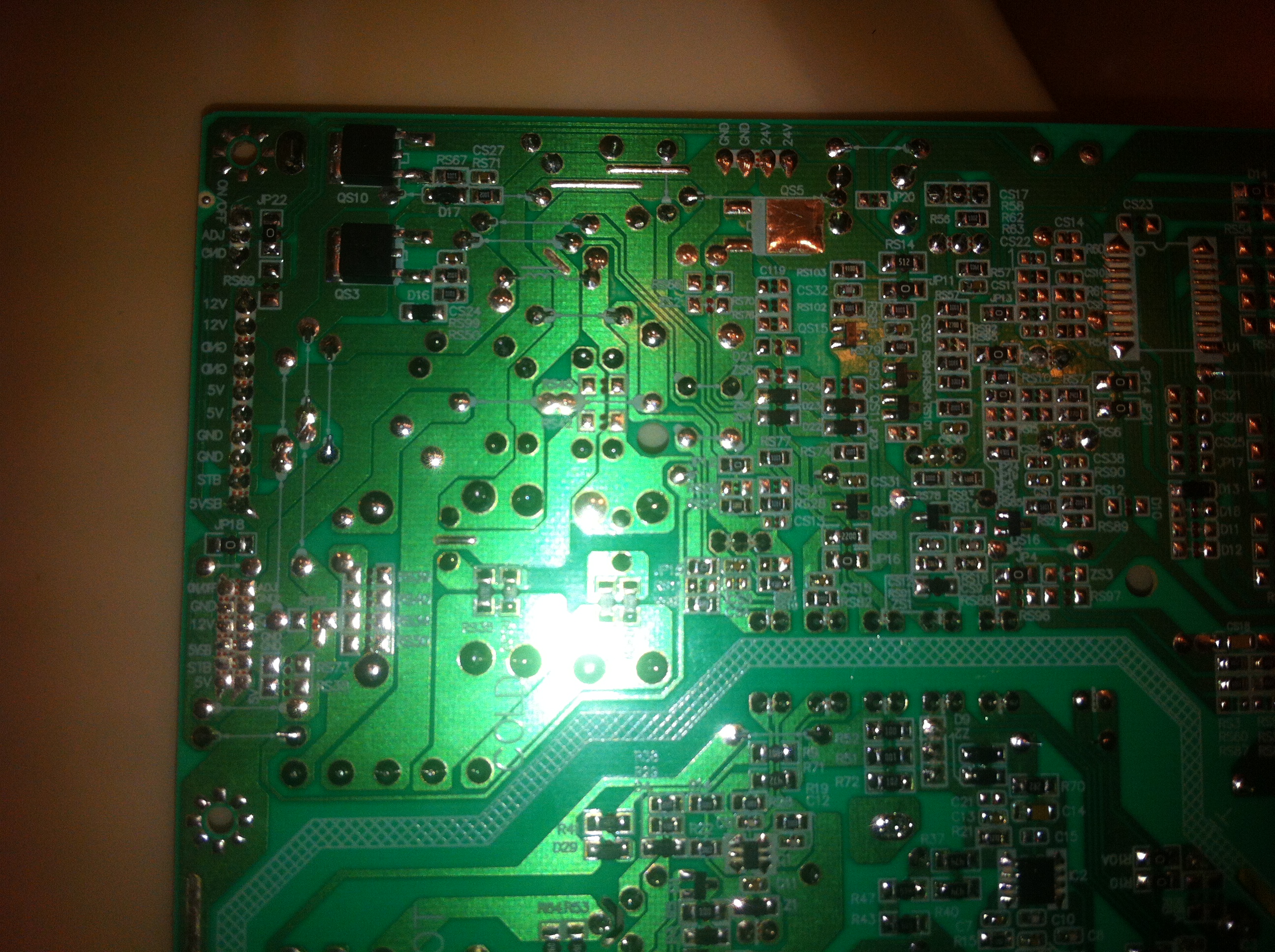

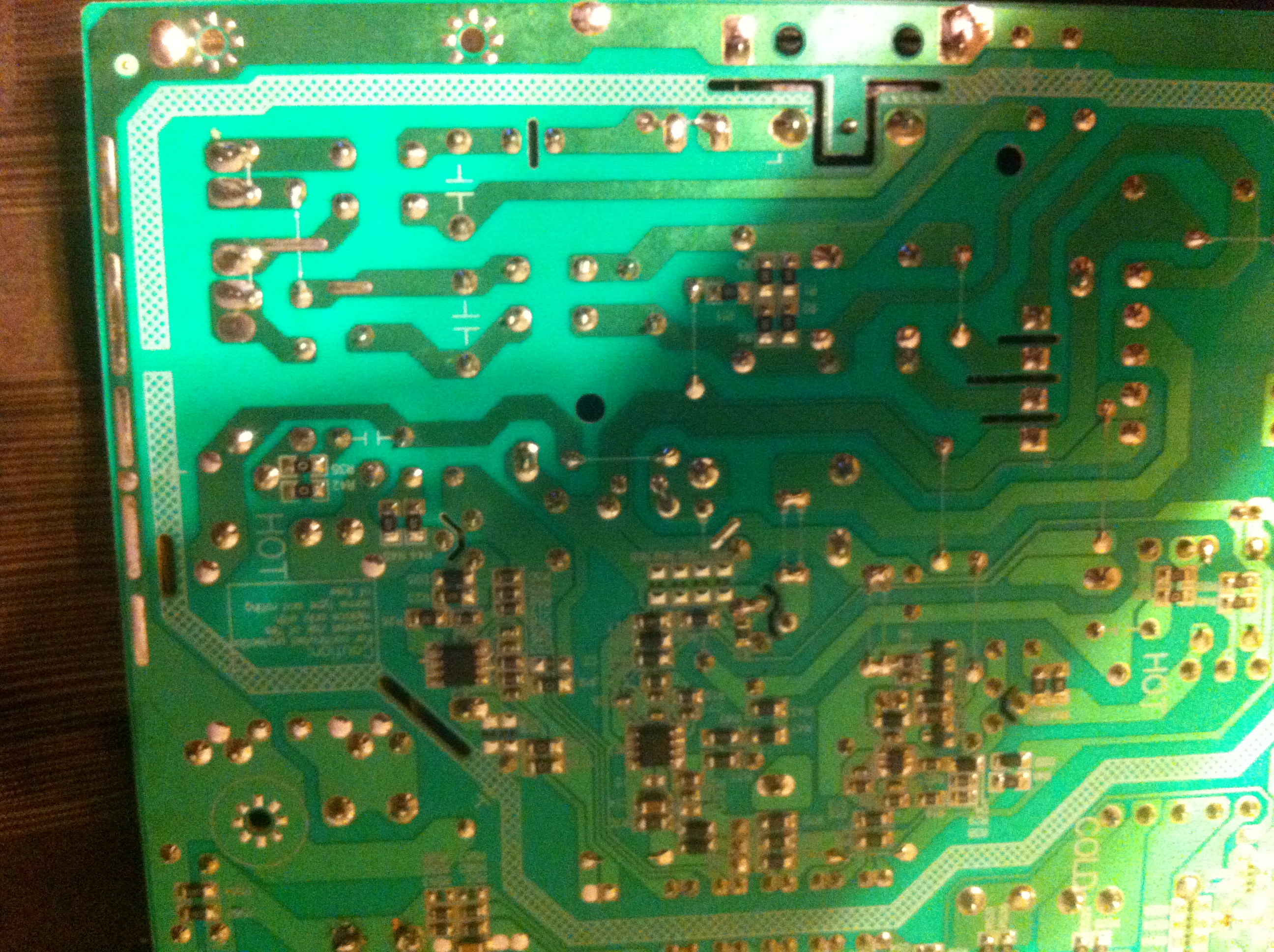

          Can you remove the power board carefully (turn TV off for 30 minutes - unplug at wall - before doing this) and take pictures of the bottom of the board?
            Re: Proscan PLDED3996A led backlight help

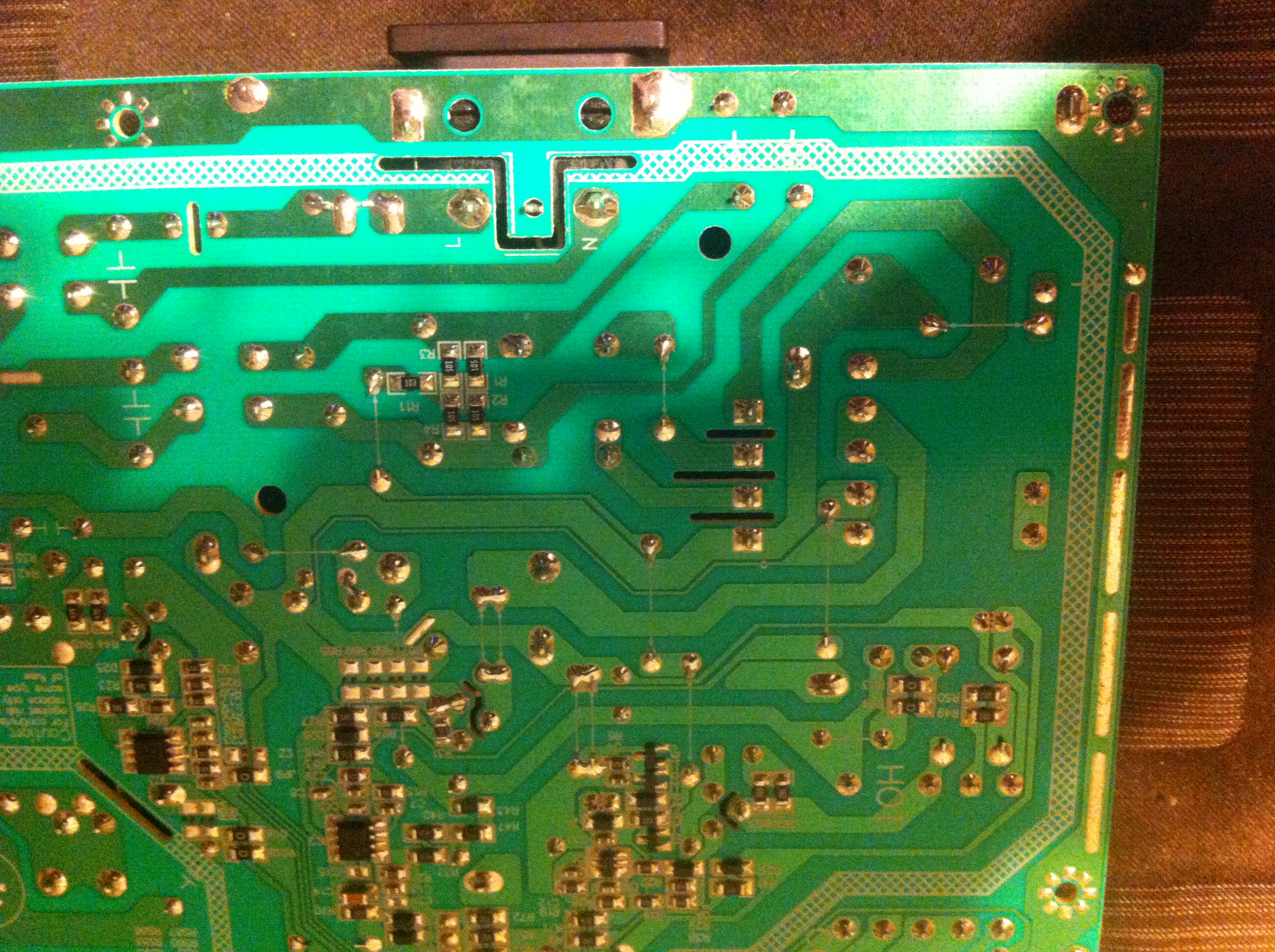

            this is the back of the psu, is this what you want? thanks you i know is not fun to help a dumb guy like me
              Need a clearer photo of top left of this board - ideally with consistent lighting and sharper focus.
              https://www.badcaps.net/forum/attach...5&d=1391989814
              One tip with board photos: taking a board out into pure sunlight can help. Try using macro photos. If you have a smartphone or camera with tap to focus, tap on a large dark object with contrasted edges, like the device in the top left, to help improve photos. I am able to get super-sharp photos with a Galaxy S2... which is nearly 4 years old and only 8 MP sensor.

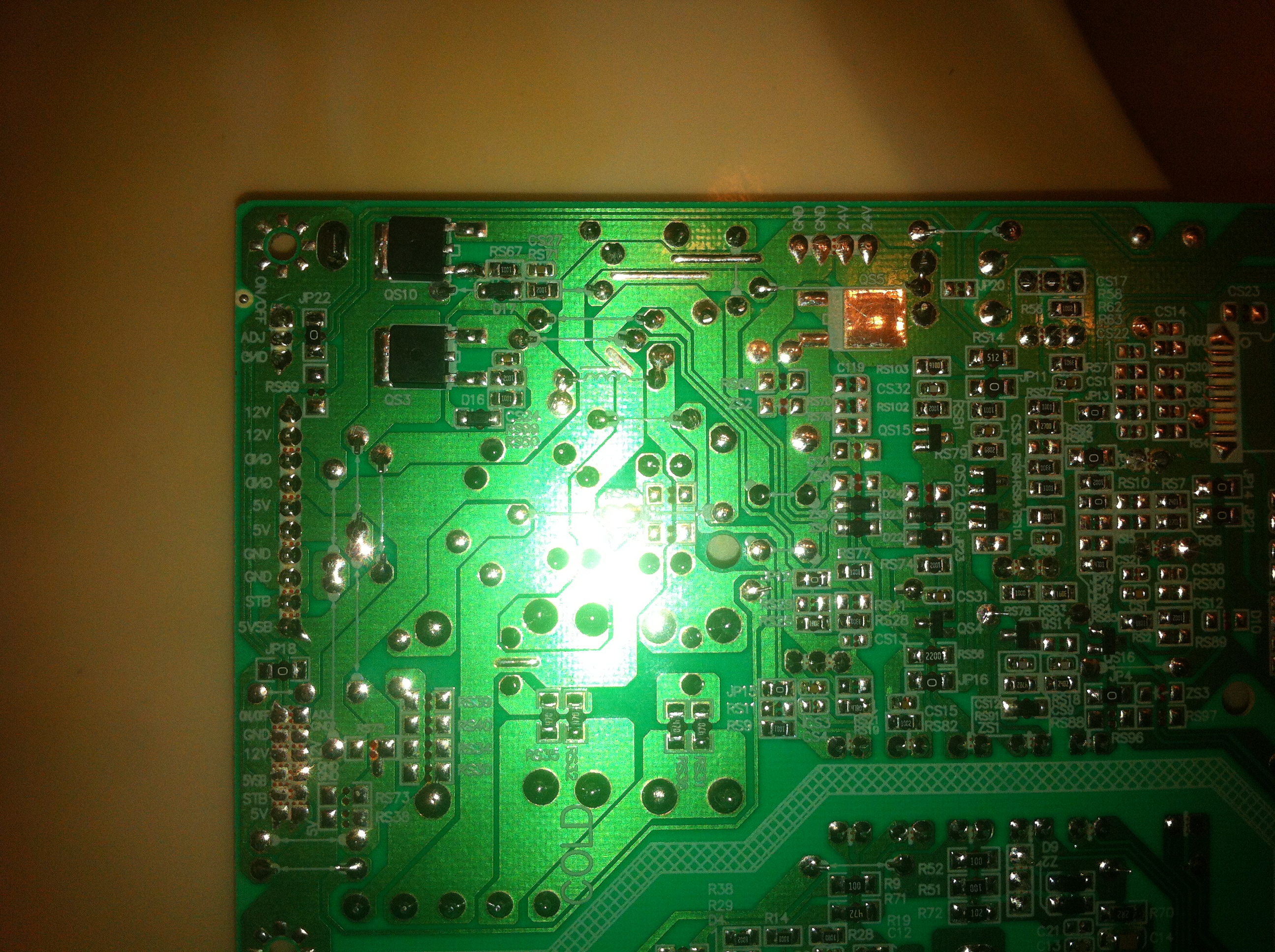

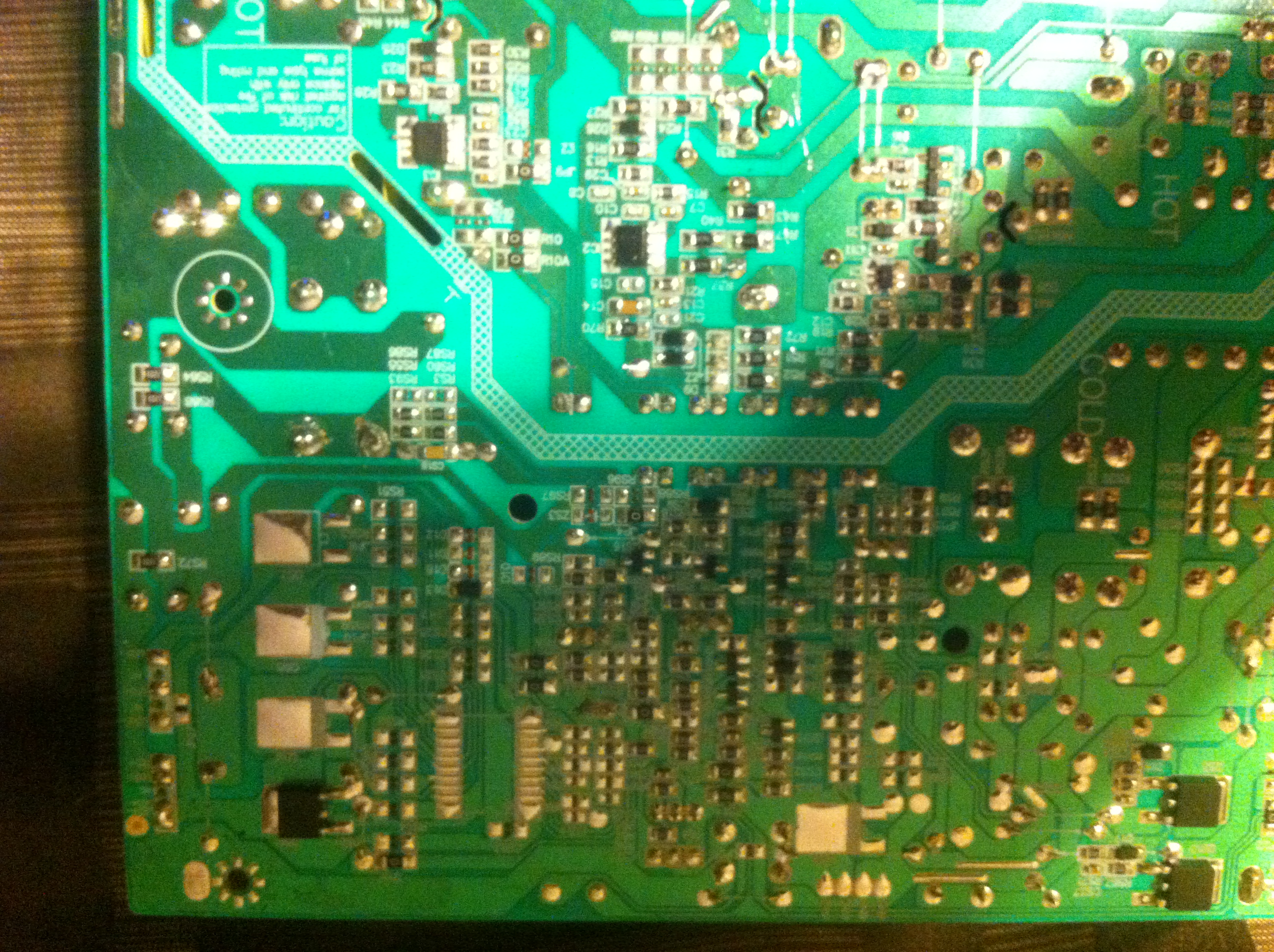

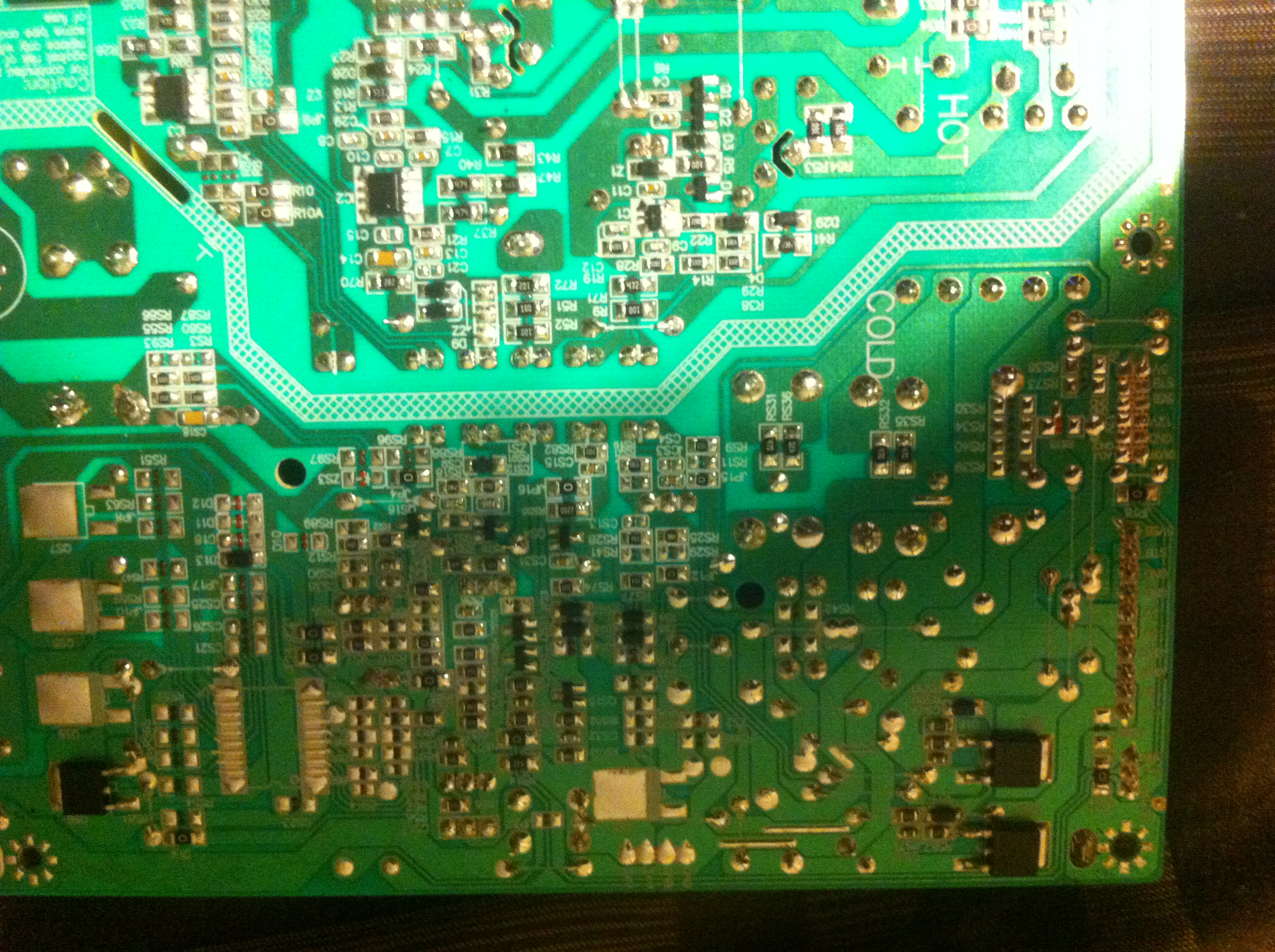

                any better? im using an iphone 4 that i know doesnt have the best camera, if not ill get a better camera and sunlight tomorrow, thanks
                  I will try and come up with a response tomorrow (too late right now), but if I happen to forget, please reply again. Photos look usable enough to understand circuit, but I will ask for part #s in trying to decode it.
                    #29

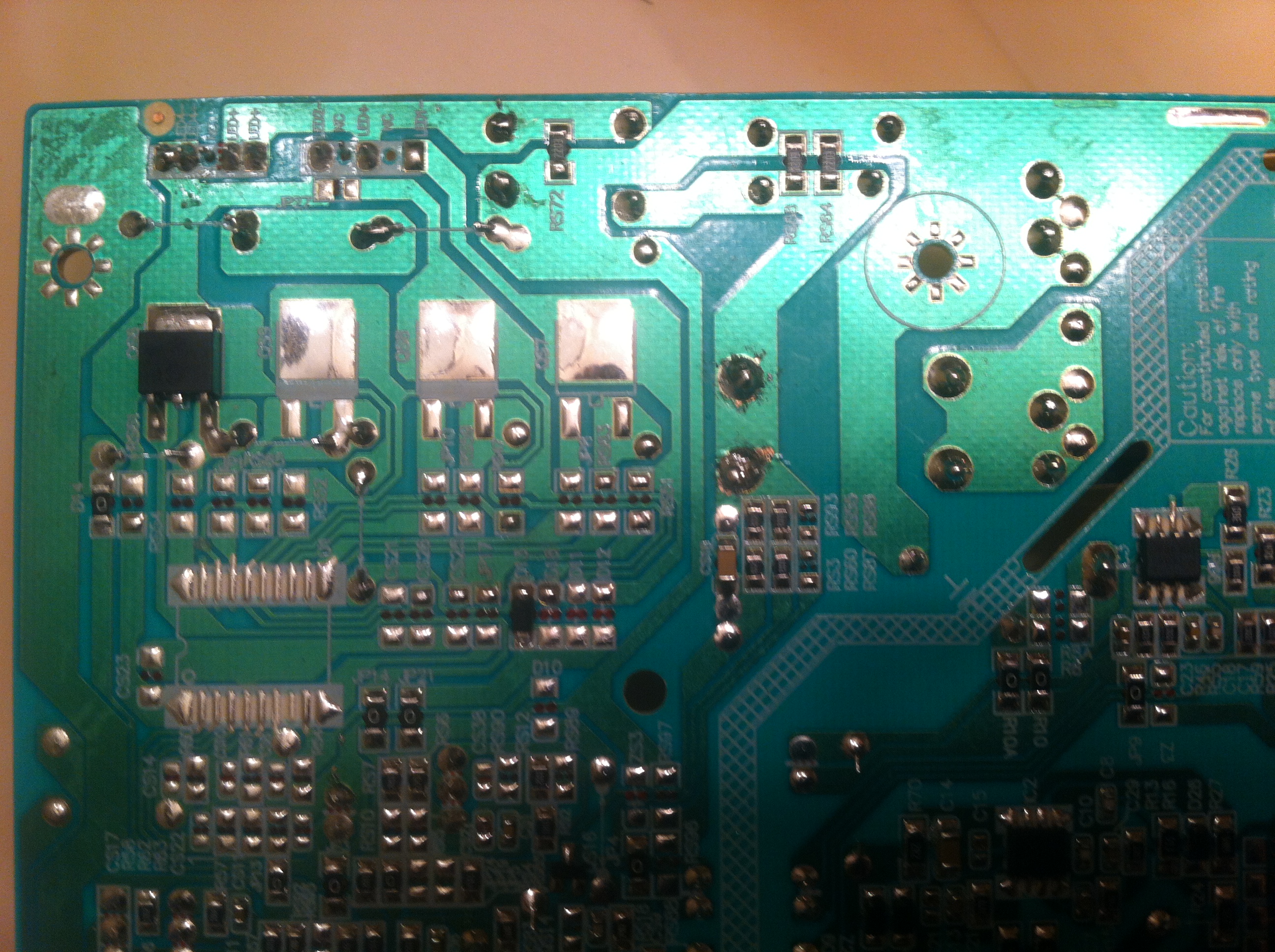

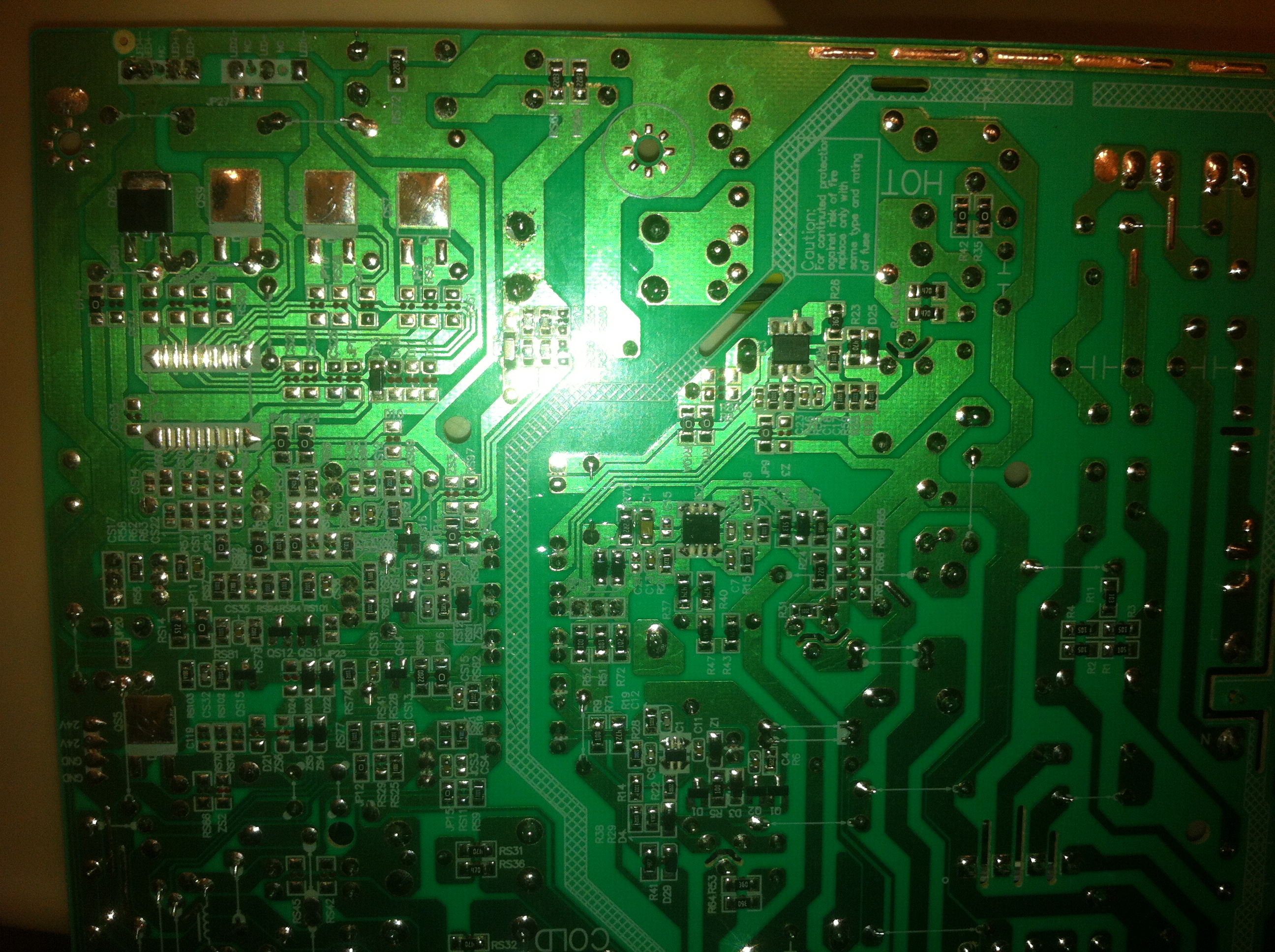

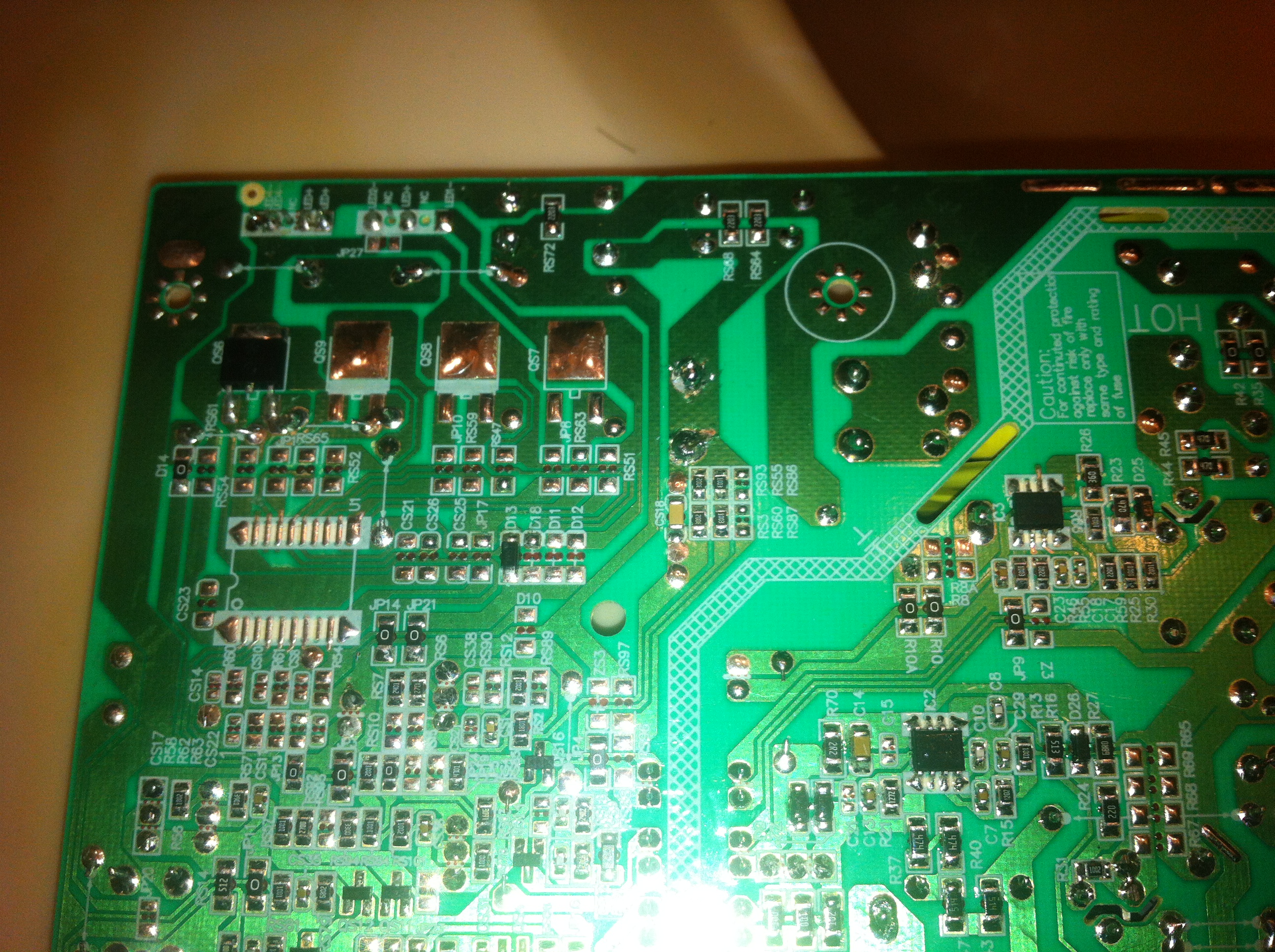

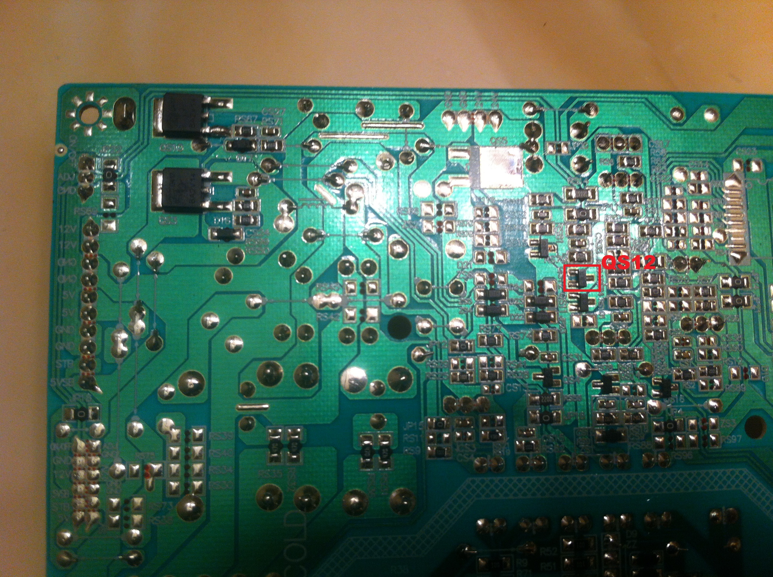

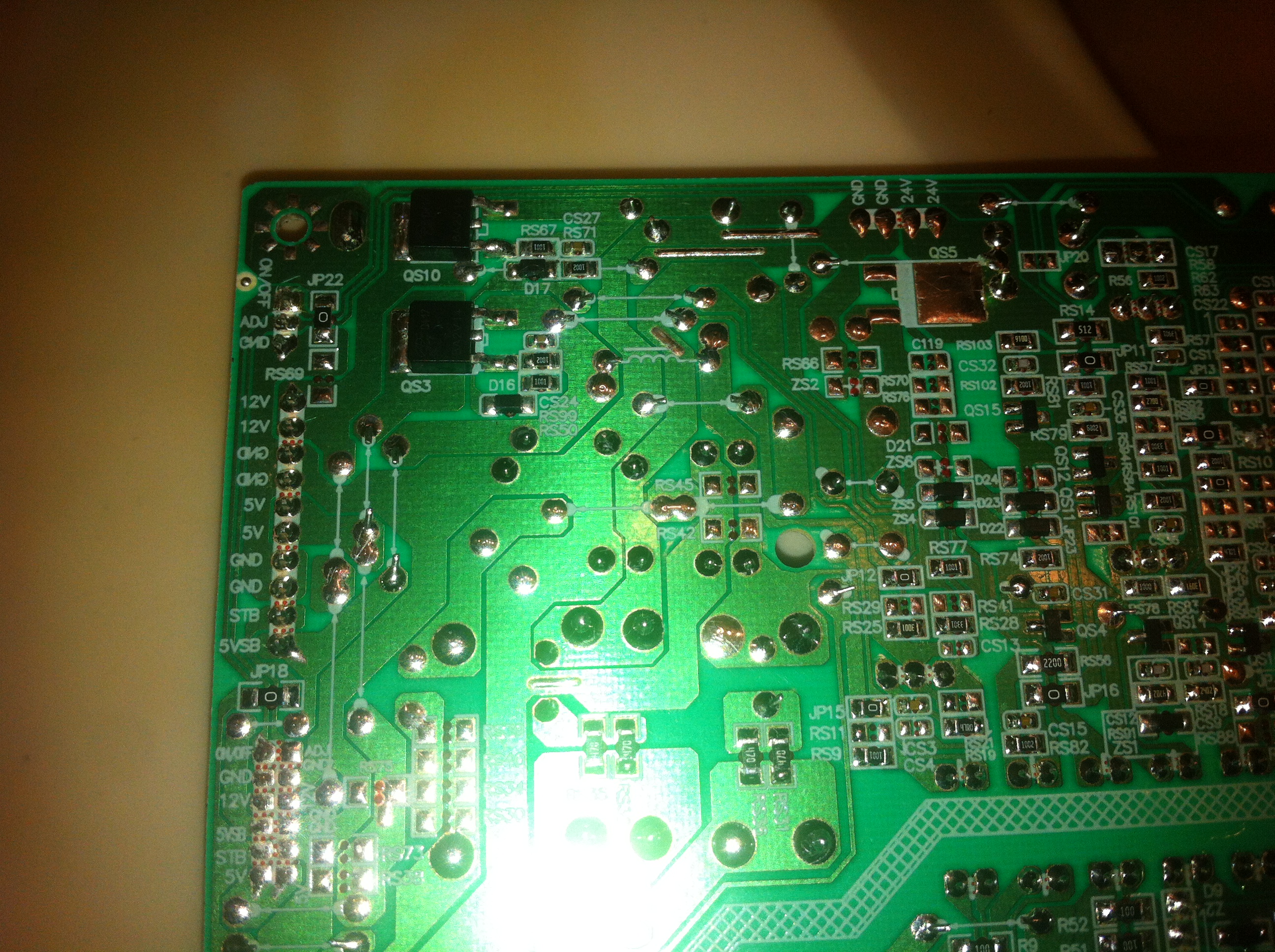

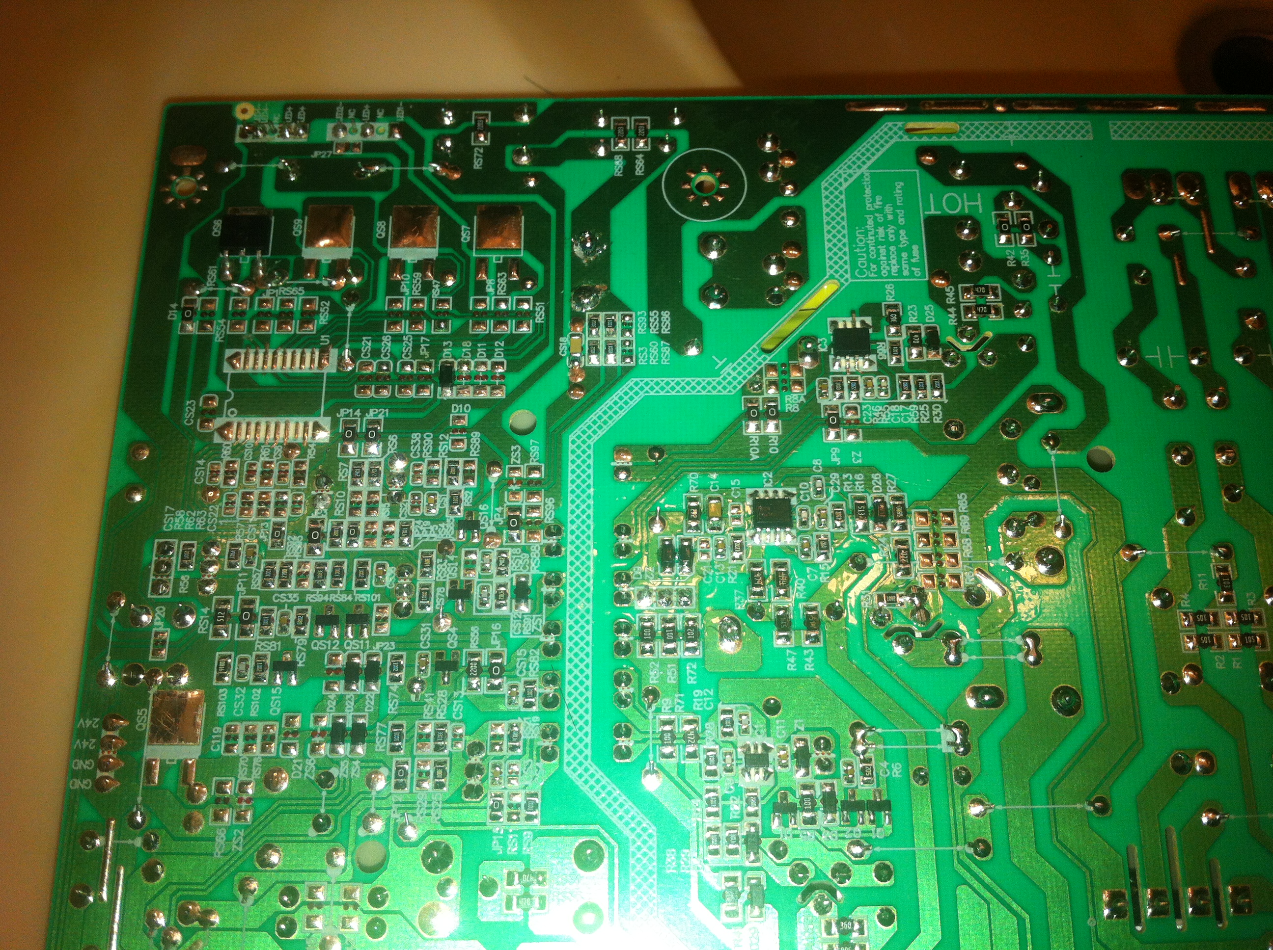

                    thank i just noticed that i took pics of the top right, here is what you ask me, thank you, yea it is late for you (uk) i,m at -5 GMT, so see you tomorrow ill bump this thread

                        TV is alive!!!!!!!!!! Thanks everyone especially to tom66 for point me to the right direction
                        It was a bad transistor(QS12)
                          #32
                          Nice one, sorry I did not have time to get back to you, how did you determine that to be at fault?
                            #33
                            i was going from the on/off pin to the other end testing all components and following the beep, and when i checked the QS12 i got O.L where ever i put the proves so i decided to pull it off and replace with one i took from one of the many boards i have, and i got lucky,i paid $30 for it
                              #34
                              I'm very surprised that any random transistor would work but nice fix!
                              Do verify that backlight turns on/off OK - for example when switching sources, you do not see noise or errors on the screen which clear shortly after.

                                  The transistor I got is very similar to the QS11 that is next to the QS12. Do you think the QS12 and the QS11 are different ?
