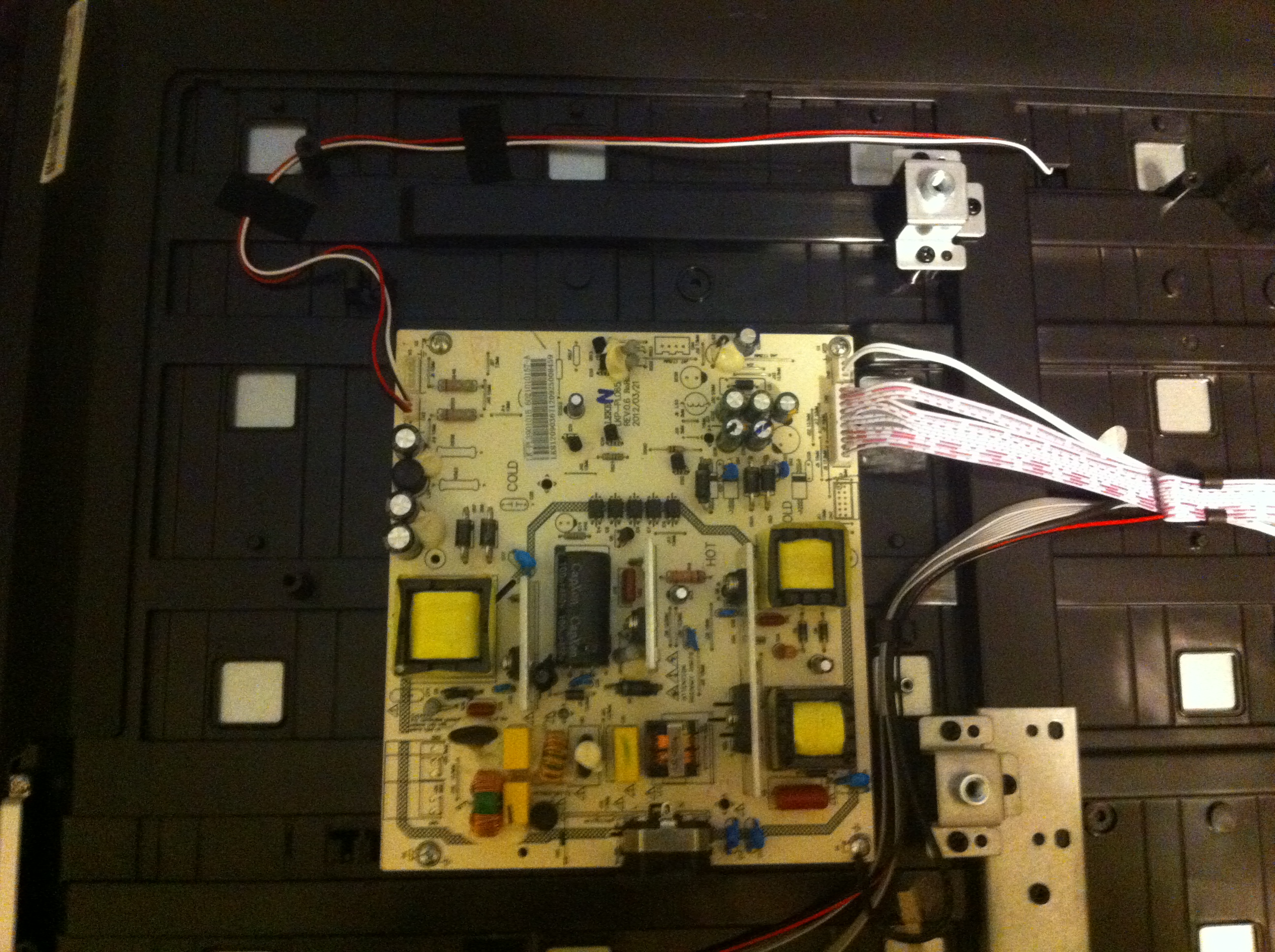

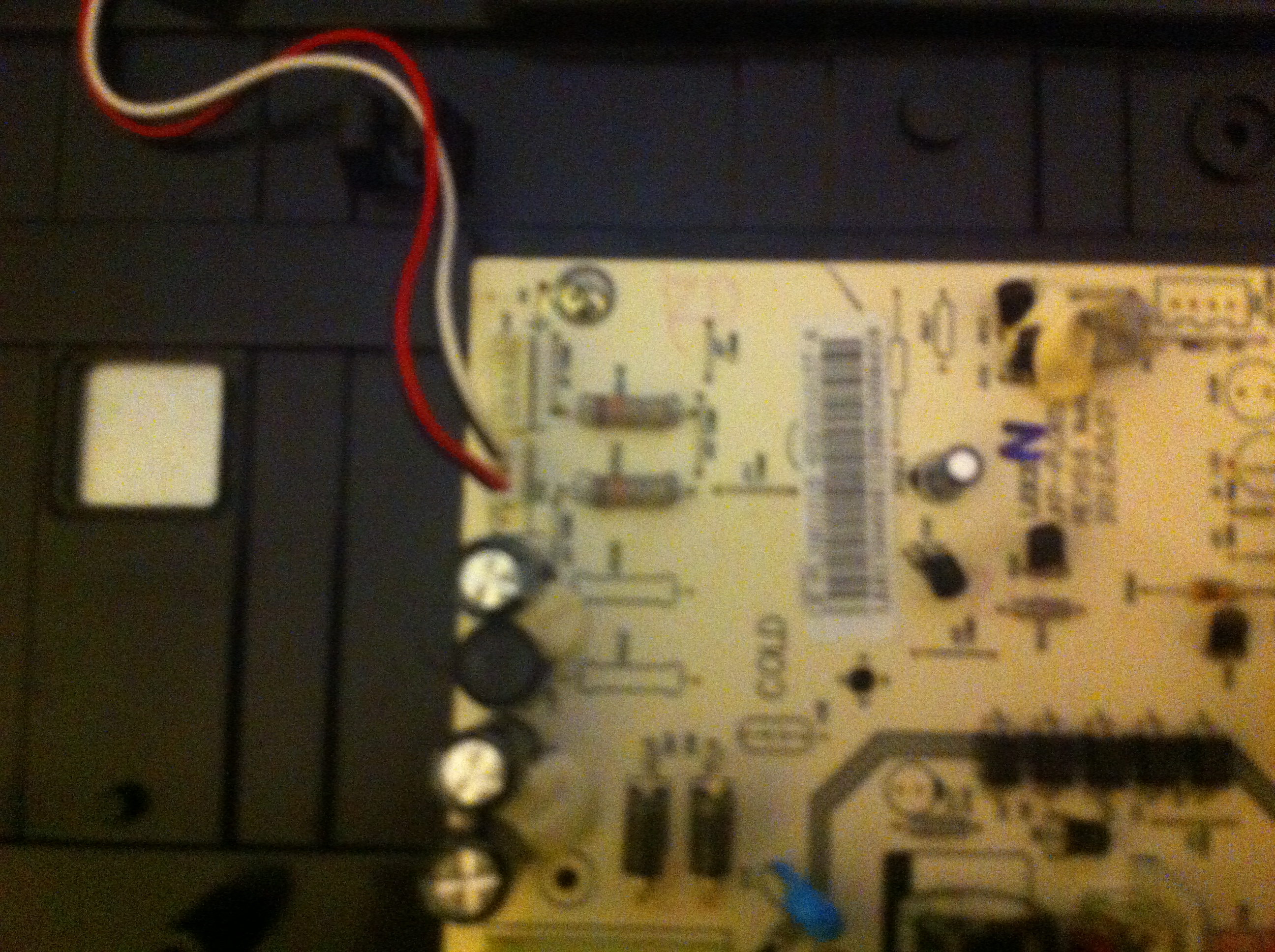

    hi everyone, i have this Proscan 39 with a backlight that is not working, forgive me if my question is dumb, i can see the menu when i point a flashlight to the screen that's why i think is the backlight. there are four wire(black/red-black/white) going from the power supply to the back of the screen. my question is should i be getting any volts out of these wires? i'm not getting any
    any help? thanks
    edit:i double checked i have black/white 9v and black/red 59v is that ok?, is there board behind the screen? sorry i'm learnig

    What do you measure from WHITE/BLACK to RED/BLACK (there appear to be two wires going into the connector, I am guessing they fan out.)
      Re: Proscan PLDED3996A led backlight help
      thank you for reply, i get 9v out of black/white 59v out of red black, how im supposed to measure? i have three pin on the power supply but four wire going out,
        You have to measure across: red probe on end, black on other. Just measure between the RED/BLACK pin and the WHITE/BLACK pin.

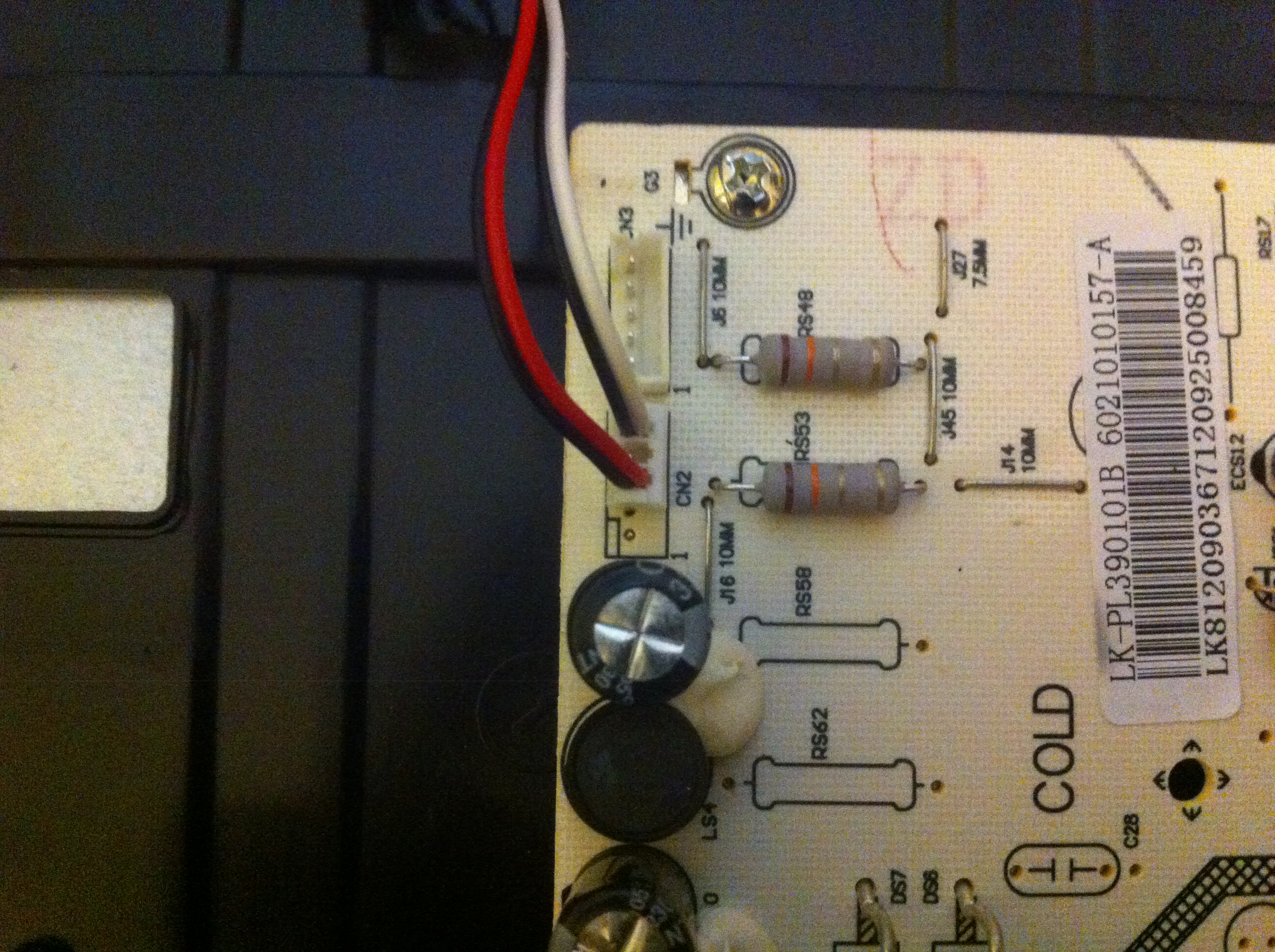

                        Plug should be in PSU. As if normally installed. If testing directly is difficult/impossible, try inserting a wire or paperclip into each pin of interest.
                          with the plug plugged in(the one that goes to the light) and tv on i have almost the same 0.023-0.030 volts

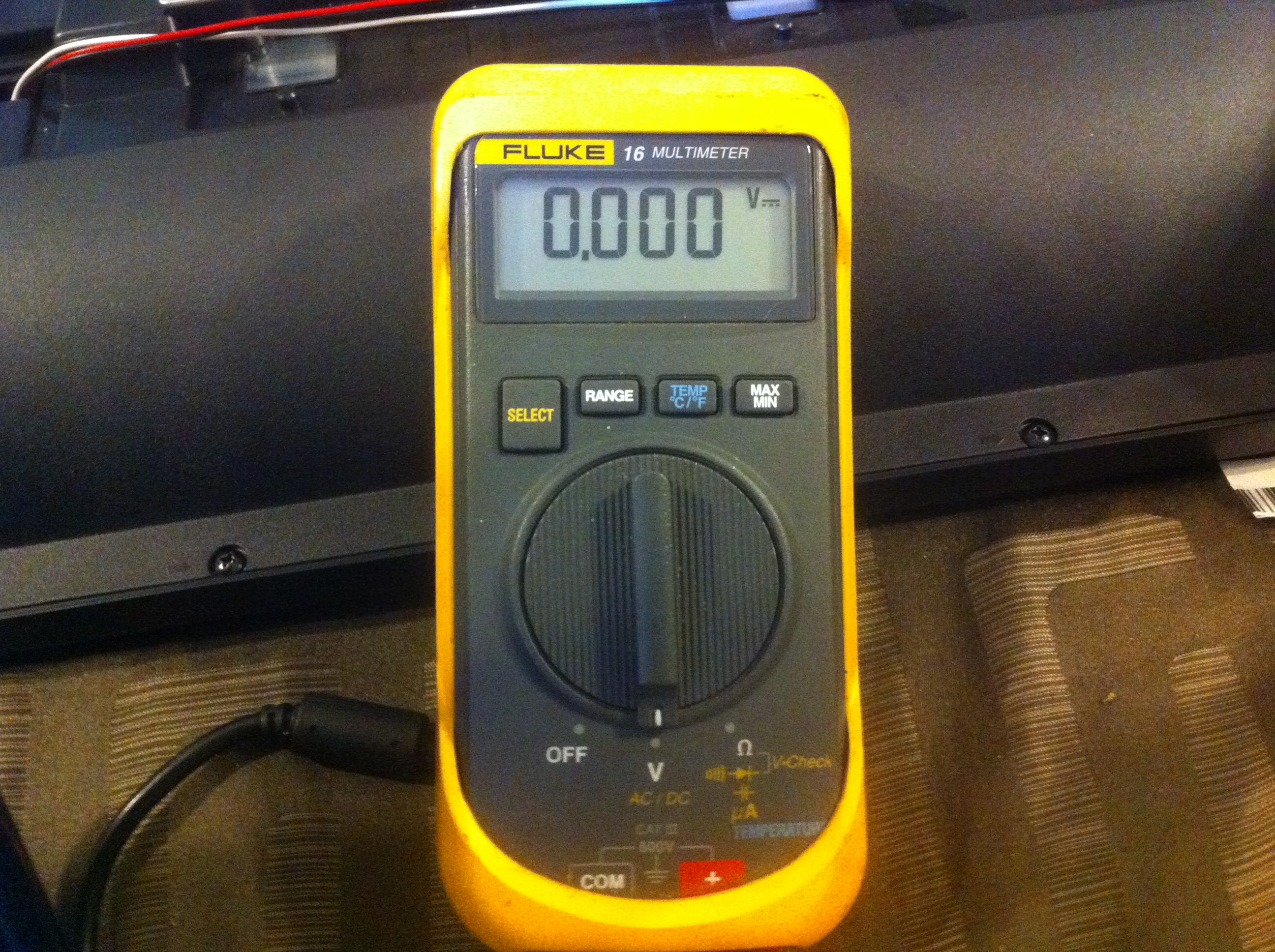

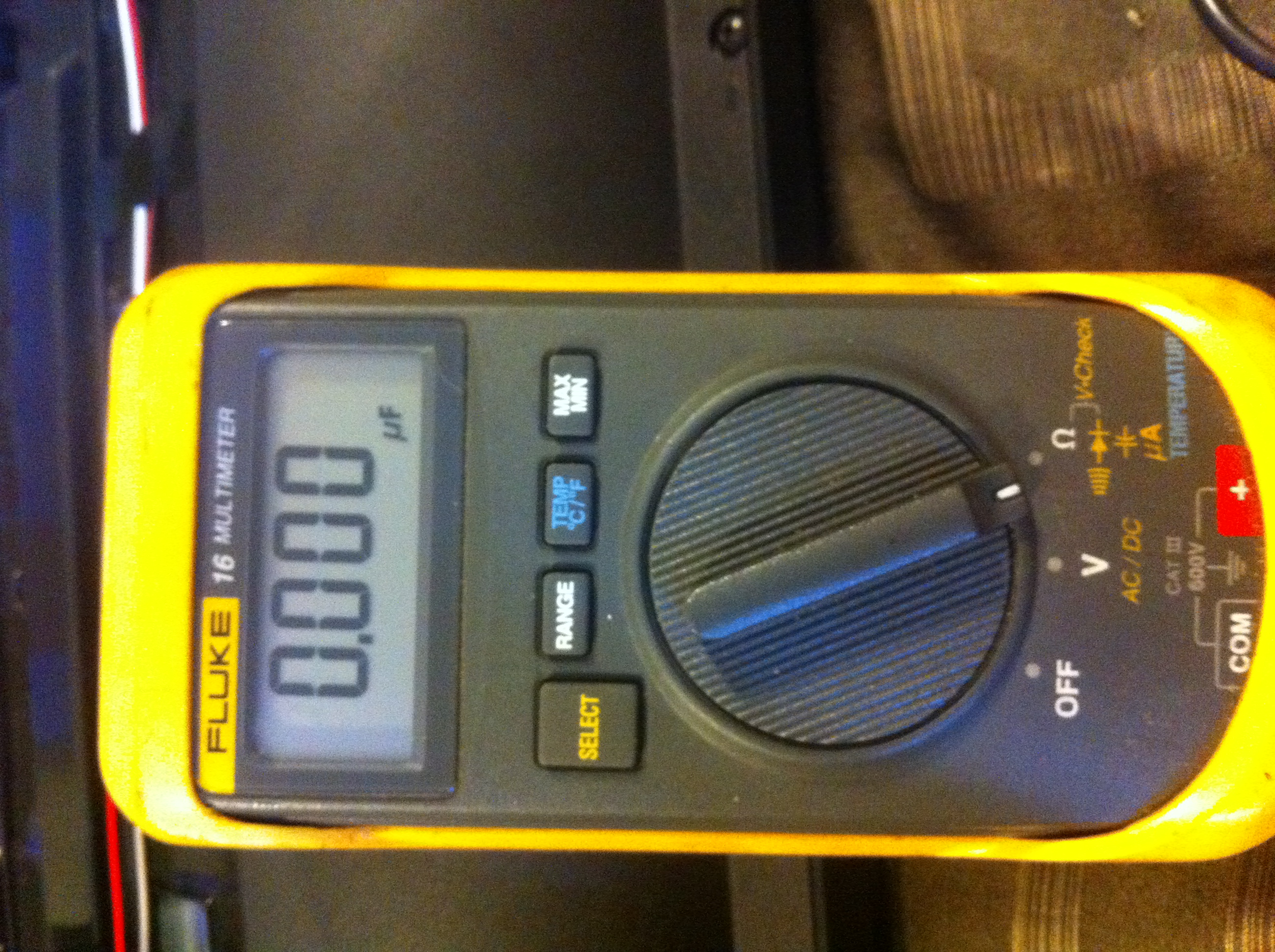

                              What the reading of this resistors should be? i working with this DMM, thanks

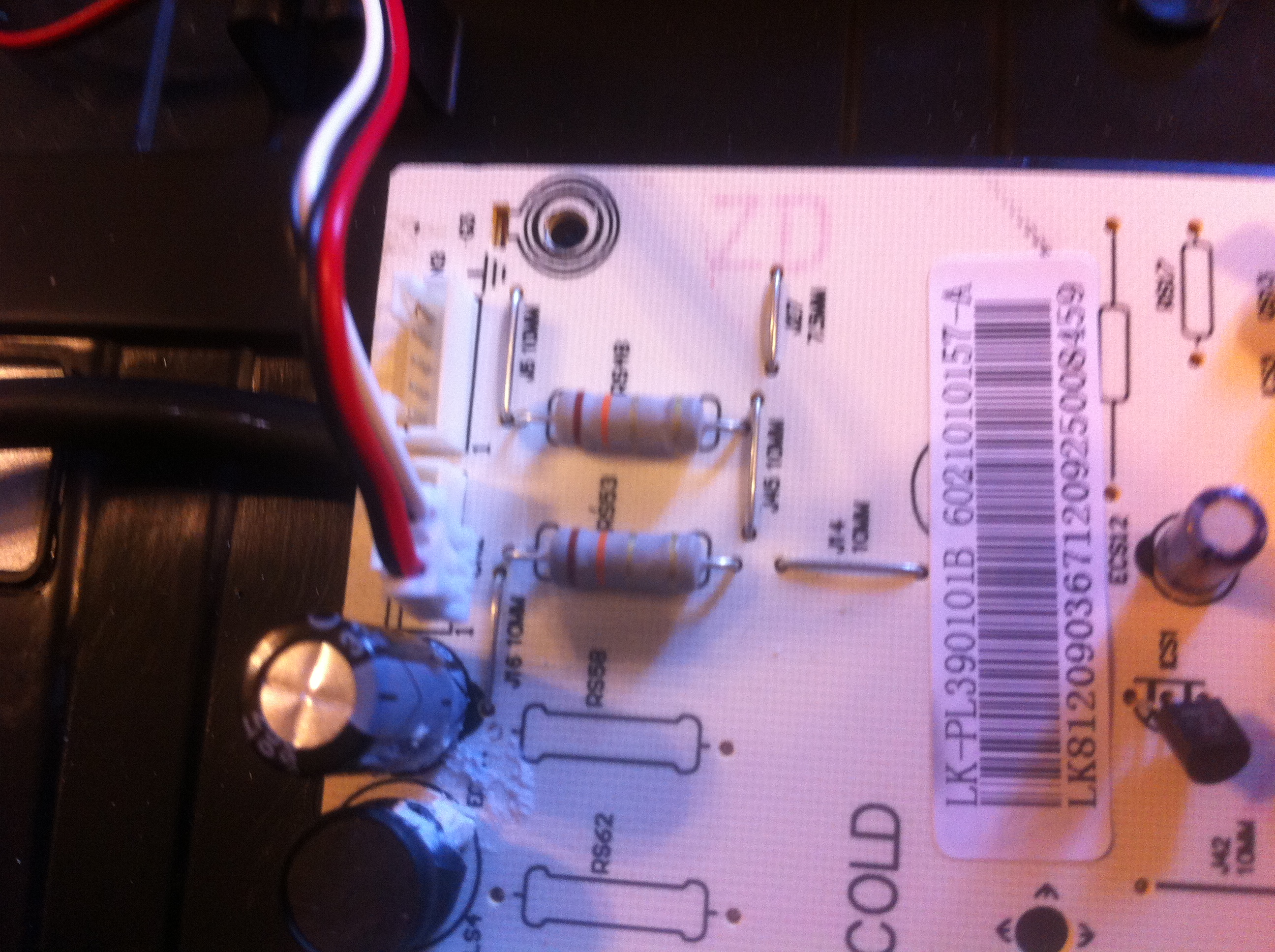

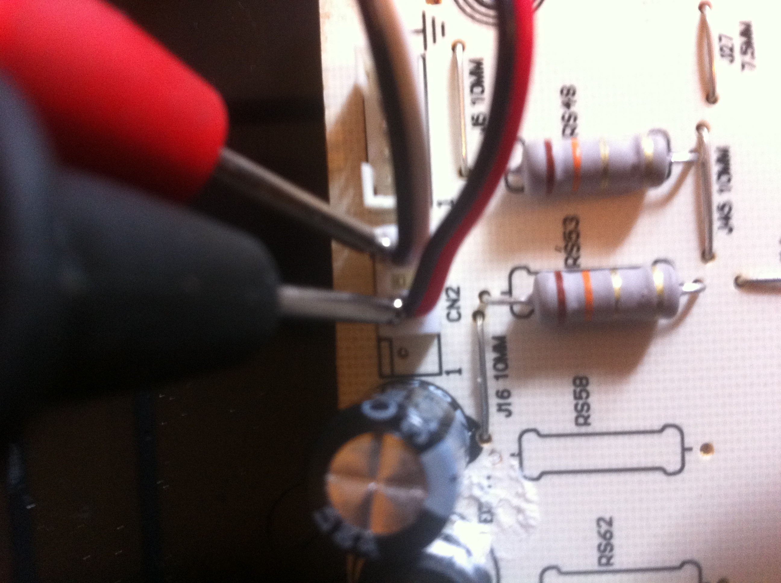

                                For the voltage check reading 0.023V, could you take a picture of how you are testing? It's just the readings are counter-intuitive.
                                  this how i set the DMM when checking for voltages and i got all my reading right when checked the other side of the ps the one to the main board
                                    Can you make a picture of how you probe... may require a third hand...
                                      im here alone my wife be back within 3-4 hours, i took a pic with one hand just so you see where i put the prove, and i know im making contact when i first turn the tv on i get like 0.80v after 2+ mins with tv on i get 0.023v-0.030v

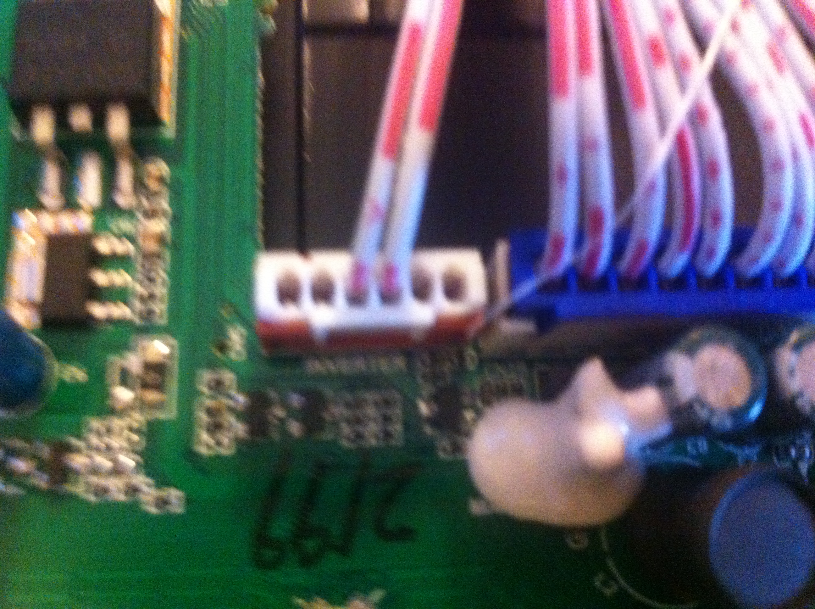

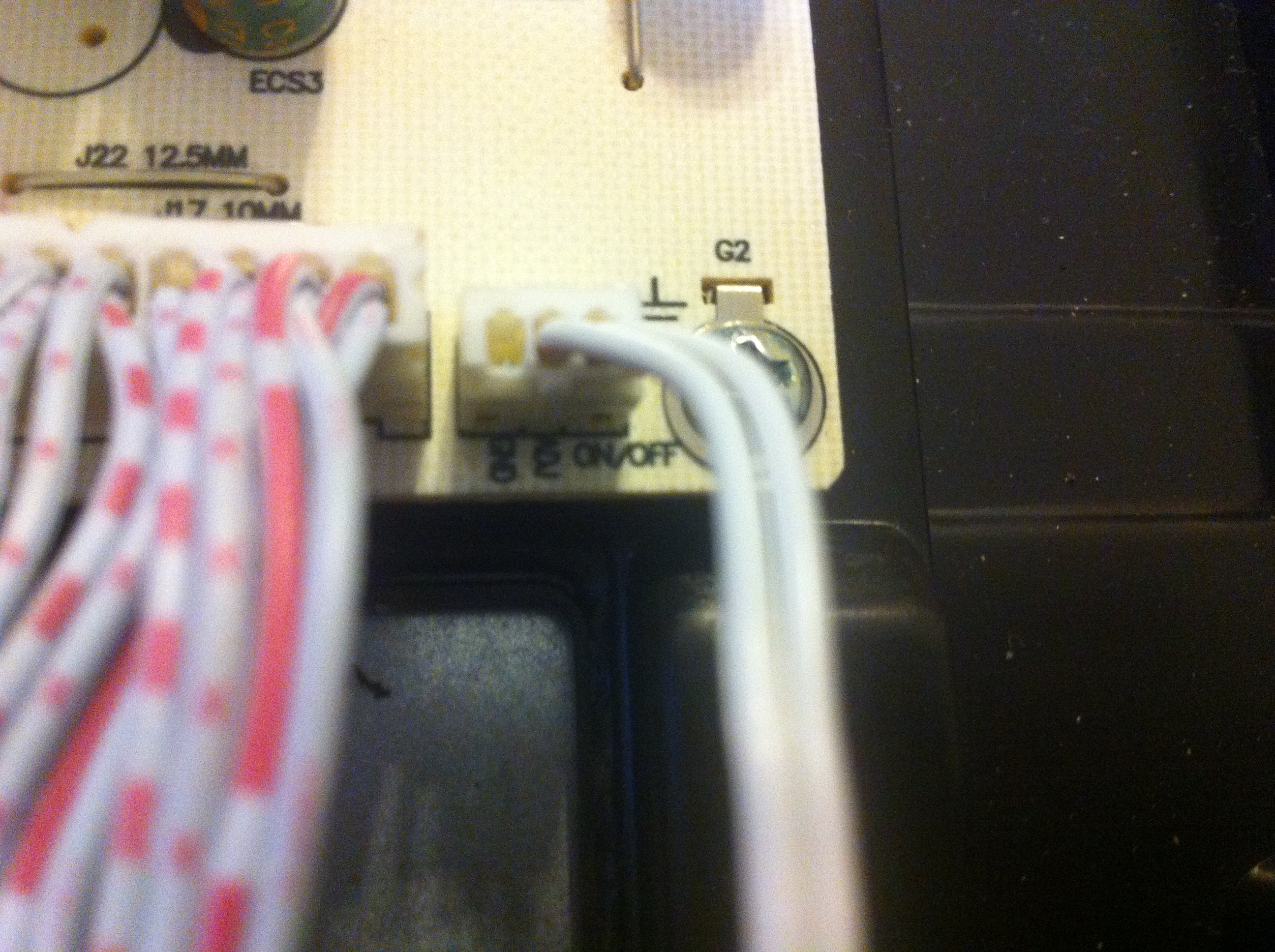

                                        one question, one connection on main board says inverter and goes back to the ps is this what send power to the backlight?. reading 1.4 when tv on
