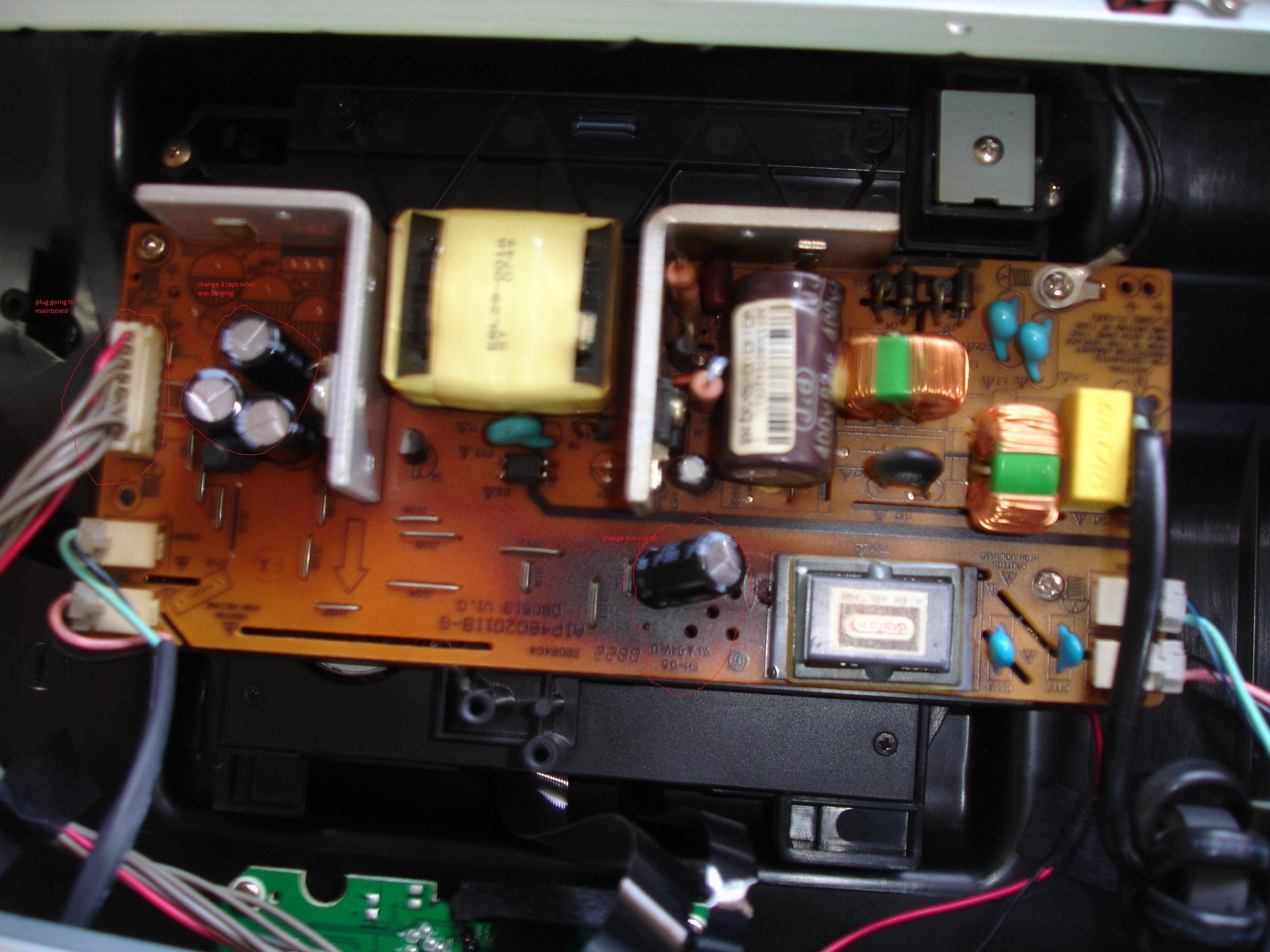

    I have a l22lid648 logik tv their was no standby light so I got down to the power supply and found 4 caps was bulge 680uf 16v so I have change them now all I get is standby light coming on then when I press to bring tv on it just blinks 4 times and that's it their is a transformer for back lights on the power board could it be that.any help please

    Other caps may be bad as well - but its a start.
    Post good clear picture of the set with the back off and one of each board.
    and a close up of the connector on the power supply that goes to the main board and the area on the back of the board (((where the power supply connects.))
    EDIT Sorry just re read that - should say "where the inverter transformer is"

      Check voltages from PSU board in standby and when working.

        voltages in standby 12.25v first 3 pins
        GND 0.00V NEXT 3 pins
        ADJ 3V
        ON/OFF 1V
        TV SWITCH ON 12.22V FIRST 3 pins
        GND 0.01V NEXT 3 PINS
        ADJ 0.03N
        0N/OFF 4.37
        and its a 8 pin plug going from power supply to mainboard
        will put a picture of the power supply on

          Board looks very sad - post a pic of the back so we can see what is burnt
          Was the set yours when it last worked? some history of how it failed might help.
          Assume there is no flash at all from the ccfls
