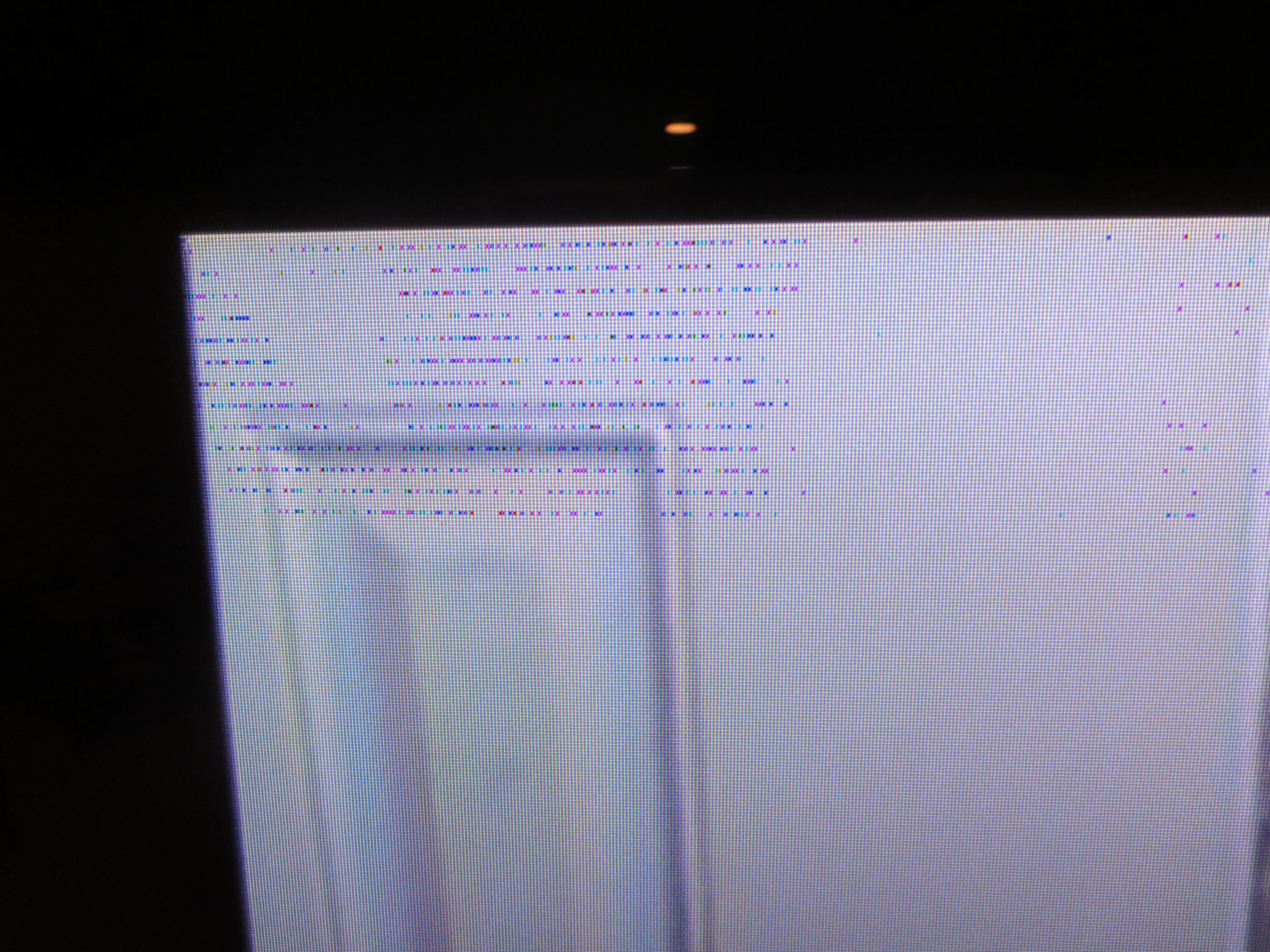

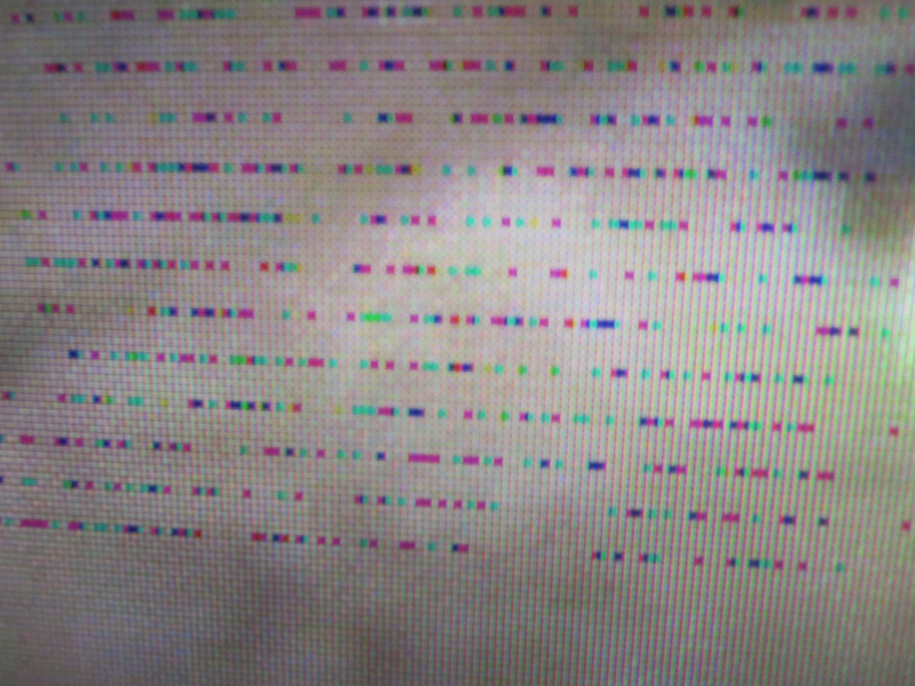

    Looking for advice with the new problem. Yesterday, my tv developed these lines across the top of the tv. They are there when the TV is "cold" -- after 5 min they are gone. Turn tv off and back on -- not there. Let "cool" down for 20 min -- they are back.

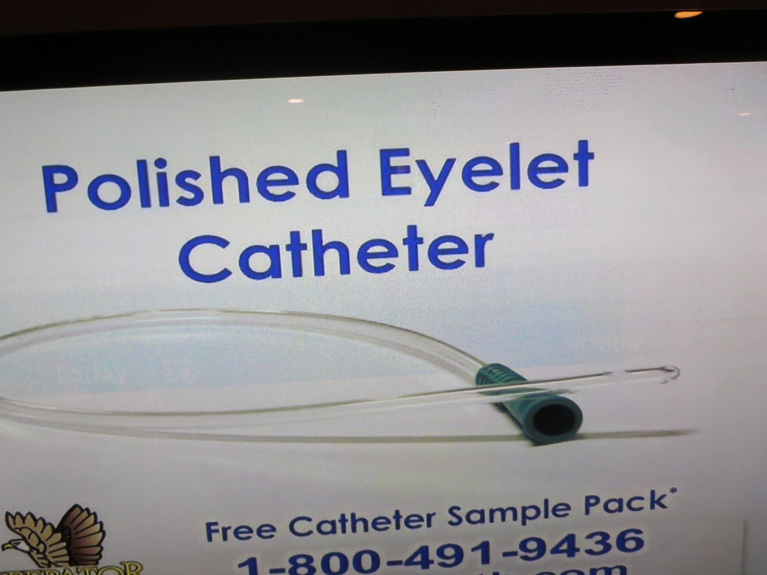

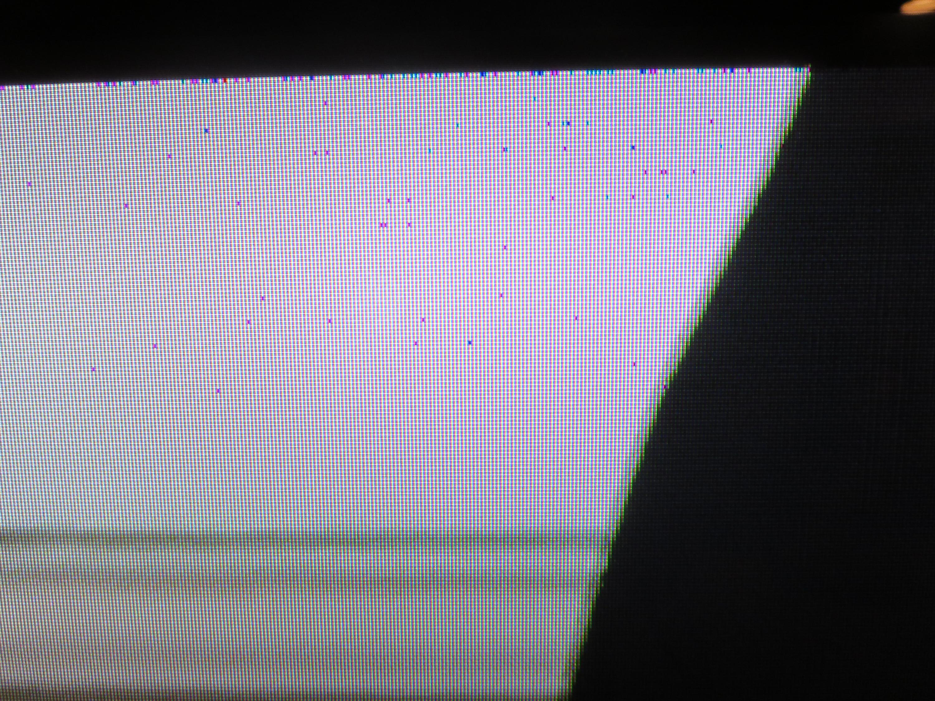

    See pics. You can see the color of the pixels making up the lines and how they fade on the additional pictures over time.
    Also, sometimes get a ghost when screen is really white -- this is new as well.
    Any ideas? Bad panel?

    No its not a bad panel. Possibly one of the scan ic's on the SU board is giving up. Also could be a capacitor issue driving that Ic or the top buffer board.

      Thanks for the information. Getting it serviced now. Will let you know the final outcome.
