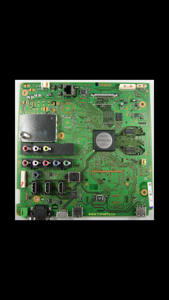

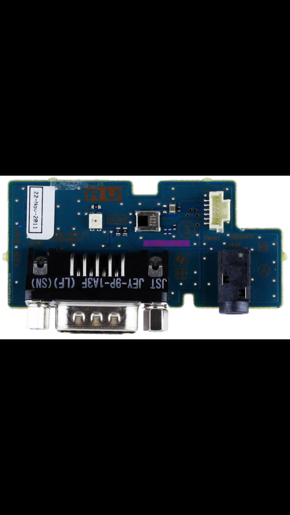

    This is a TV I picked up a while ago that had a back lighting problem. turned out to be the LED backlight driver board well I replaced that no problems. but I'm having an issue trying to pin out the RU board. this is a small board that connects to the back of the TVon the mainboard. I don't know what its function is but I believe it has something to do with the bluetooth function for the 3d glasses on the black plastic cover it is labeled remote. It has a db9 connector along with a headphone jack that's black.
    this board was all mangled up and the wire harness was cut its a 6-pin harness. I had to order another board and it's hard to find. Upon getting the board I had mocked up a new harness harvested from a nother sony tv. Upon connecting the board back to the main board it causes the remote function not to work. So basically the remote control will not operate the TV. The TV still works with the buttons on the side no problems but it physically locks up the remote control function. So I thought it was an issue with the board so I ordered another RU board. I get the same effect. Does anybody have this style TV or similar that uses this bored could possibly give me the pinout configuration of the 6 Pin harness. or if somebody has the wiring schematic could tell me if I have the pinouts proper. I just ran hpen in the Loom the same way as a direct connection but maybe there is a cross wire somewhere in the Loom that I'm not familiar with. Thanks
    Re: Sony KDL-55hx729 RU board?
    I was doing a search and noticed that some of the BATV mainboards do not use this RU board. on the mzinboard there already is a remote jack, but on this RU board, there is also a remote jack. Why does the TV need two? I dunno. But also on this RU board, there appears to be dome odd looking pickup sensor of some type, but the board in encased in a plastic frame, so Im thinking it has bluetooth capability. Aldo there appears to be a round sensor on it as well, kind of looks like an LED but that doesnt make sense. As well as a DB9 male jack on it as well.
    Basically I mocked up a cable and am unsure if I have the pinouts proper. No remote control function if it is connected. Cannot tell if Bluetooth is working as I do not have the 3D glasses.
    Sony BATV board number A-1825-544-A
    Sony RU board number A-1820-418-A

      My guess would be RS232 for control/home theatre automation. For example those connections allow a computer to turn a TV on from standby, and for a home theatre amp to mute TV speakers, etc. Also used in larger set ups to coordinate scaling and image processing between displays.

          I figure that the jack on the side is remote control input via wire for an IR blaster/receiver. That is optional, but will be passing the IR signal from the remote receiver to the main board - it will be a simple interrupt switch, like used on headphone jacks.

              It has a switch in it. Switch selects between R/C input and external.

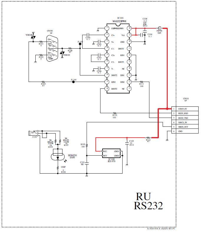

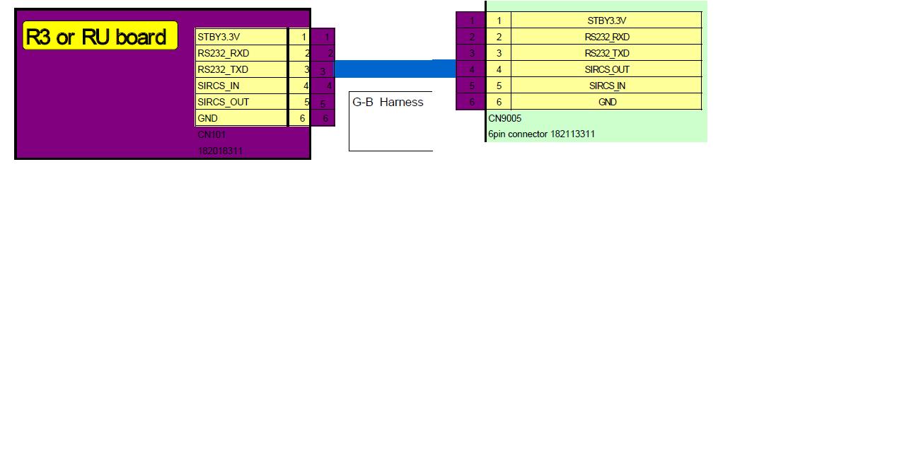

                                    Schematic.
                                    pins 4 & 5 have my curiosity. looks like pin 4 at RU is not connected anywhere. Wonder if they cross?

                                        I have not got the foggiest with Sony, is the RU still an issue? Just did an edit. Is the cable a straight through or maybe a cross at pins 4,5?
                                        a quote from the pub.
                                        Control4
                                        Enables extended command of the Control4 controller using REMOTE (RS232C, D-sub 9 pin).
                                        If [Control4] is set to [On], “Control for HDMI” (“BRAVIA” Sync) is not available.
                                        Whatever that means?
