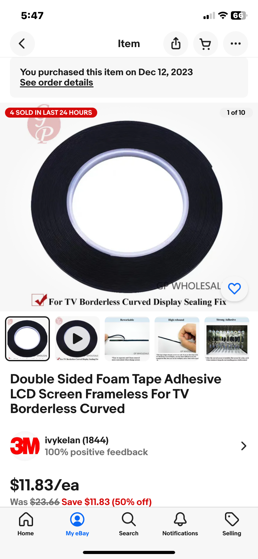

                      Oh, by the way. Do you guys have a link or suggestion as to the double sided tape I should use when I install the screen back in the tv?

                        I don't no, just make sure, sometimes with the stupid tape they use has like a foam to it and this foam gets everywhere. If it gets under the screen it will be VERY visable and it is like electrostatically charged so that shit sticks to the screen backing. I always carefully lift the screen side with suction and use flashlight to look for any little bits and vacuum as much as possible. So make sure that's all cleaned up before you put it back on. That is, if it's the foam tape.
                        I generally glue them back down, I haven't found the replacement tape they use yet. I'd like to know also.

                          Sorry for so many questions. What kind of glue do you use for the screen. Also, what do you use to clean all the old double-sided tape off?

                              I am definitely not the expert here and only learned through internet. But I use b-7000 glue. Works good and is easy to clean up excess. Unlike super glue which is more permanent this can be removed again. I was suggested this through TV repair people on internet. To get glue off the bezel of you lucky at the very end of the tape you can lift it up and pull from there smoothly across. The screen.. well I have the edge lean off a box I use as the table and pick as many of the loose ends off lightly with my fingers. If it's foam that is. I've seen several posts about people cracking their screen trying to get it all off so I leave it and glue it. That's why I don't use tape. This might not be the best method but it definitely works and secured well for me. The other members may have better suggestions

                                Usually I can very carefully peel a corner and pull it off in one piece. Any left over residue I use alcohol and microfiber.
                                • Storyteller12
                                  • Jun 2020
                                  • 625
                                  This is the only tape I have found that works. You need to leave the tv flat for a day to get a really good bound. After that good to go
