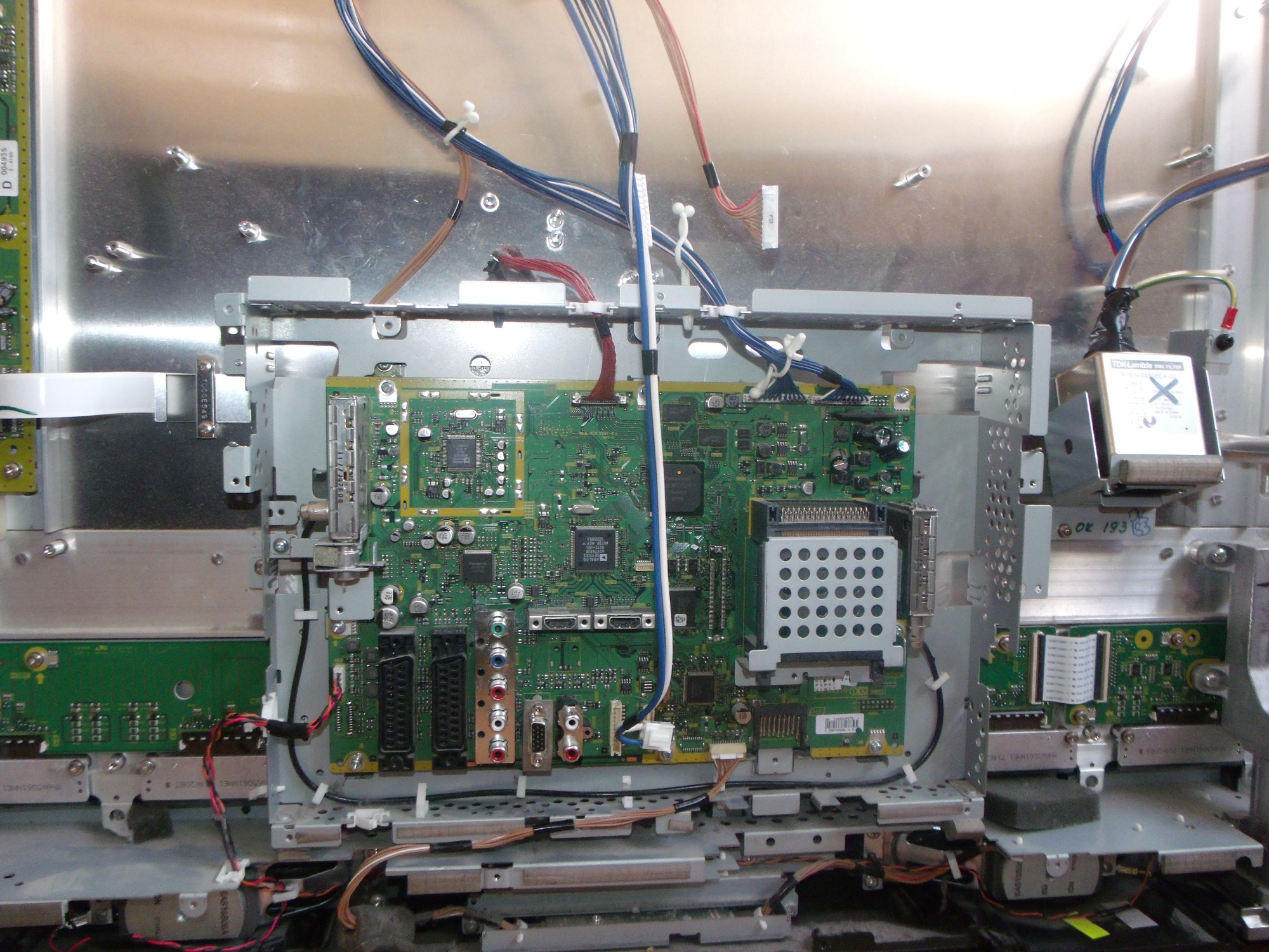

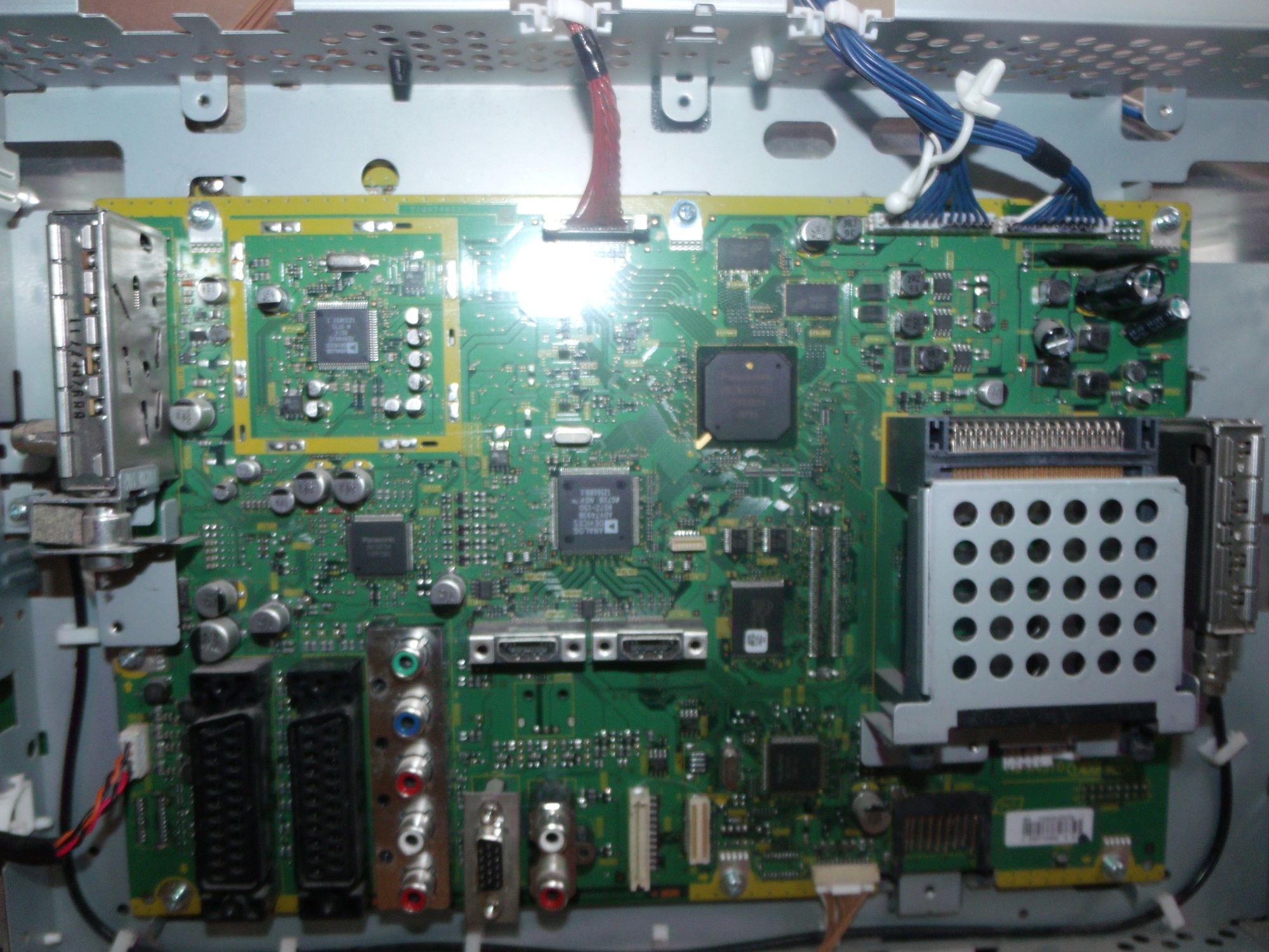

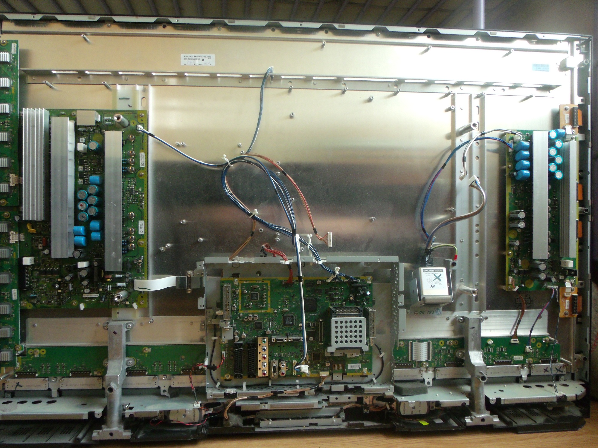

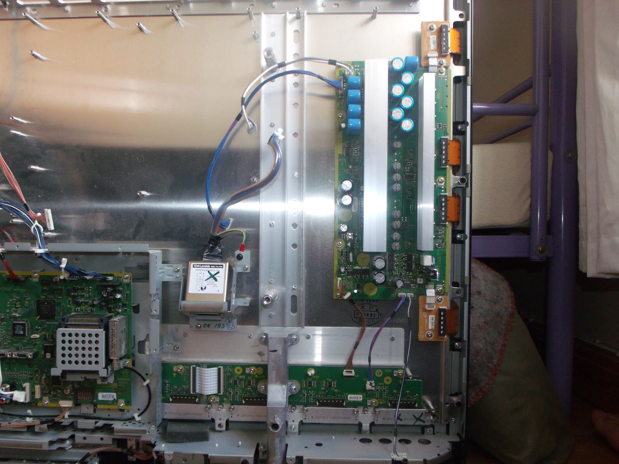

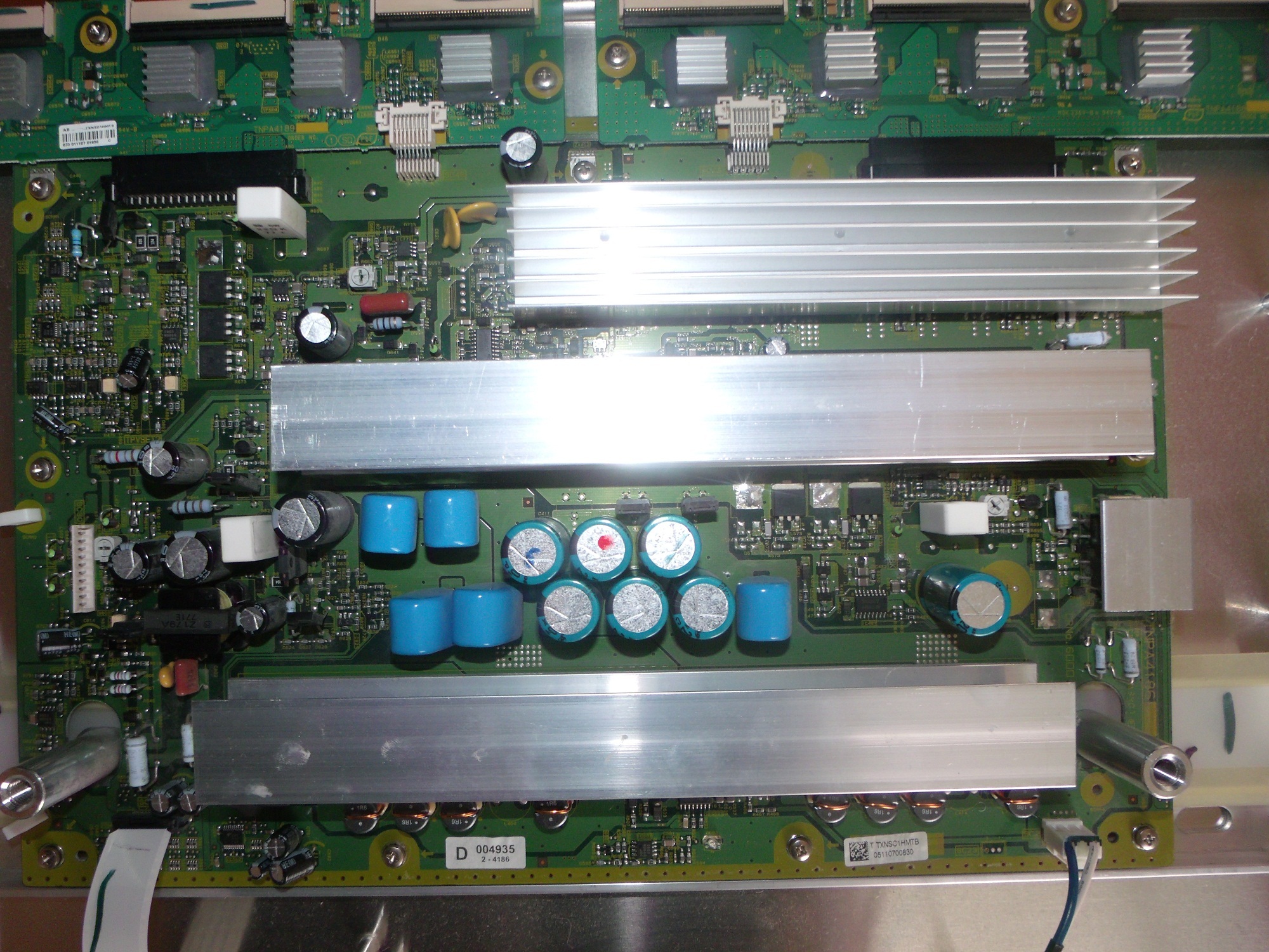

    Good morning I'm hoping someone on here will be able to help me out with a schematic for the power supply (EXTMM655MEH) of my 50" Panasonic TH-50PX70BA I've been using the schematic attached below though I don't think its quite right.
    Here is the issue I'm having:-
    TV: Panasonic TH50-XP70BA
    Fault: Not powering up red flash code 12
    Voltage for sound abnormality Sound SOS
    I've checked for 15v on the connectors to the A board from the P board but it appears to be missing so I'm looking for a schematic to enable me to find the faulty component on the P board. Thanks

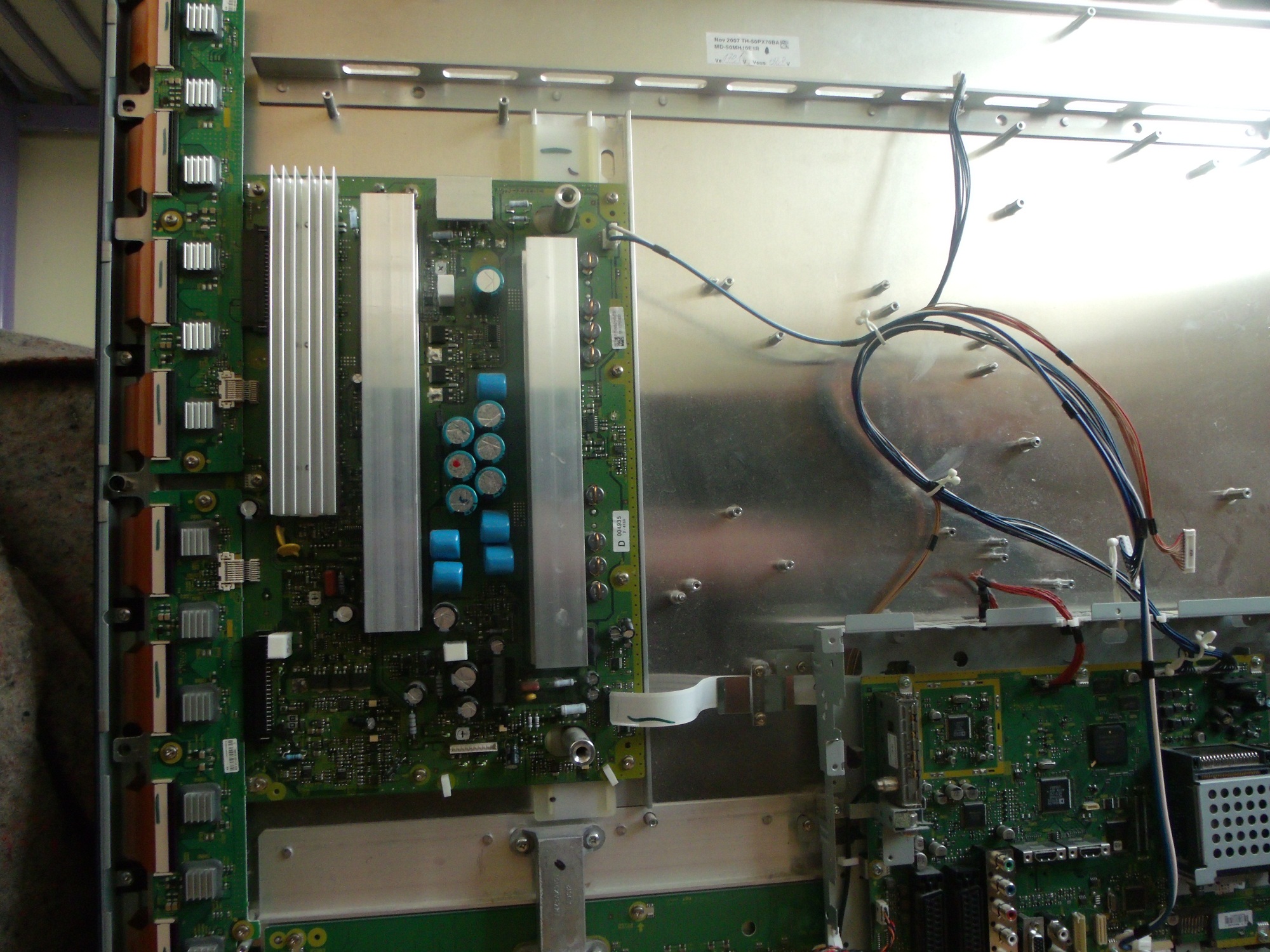

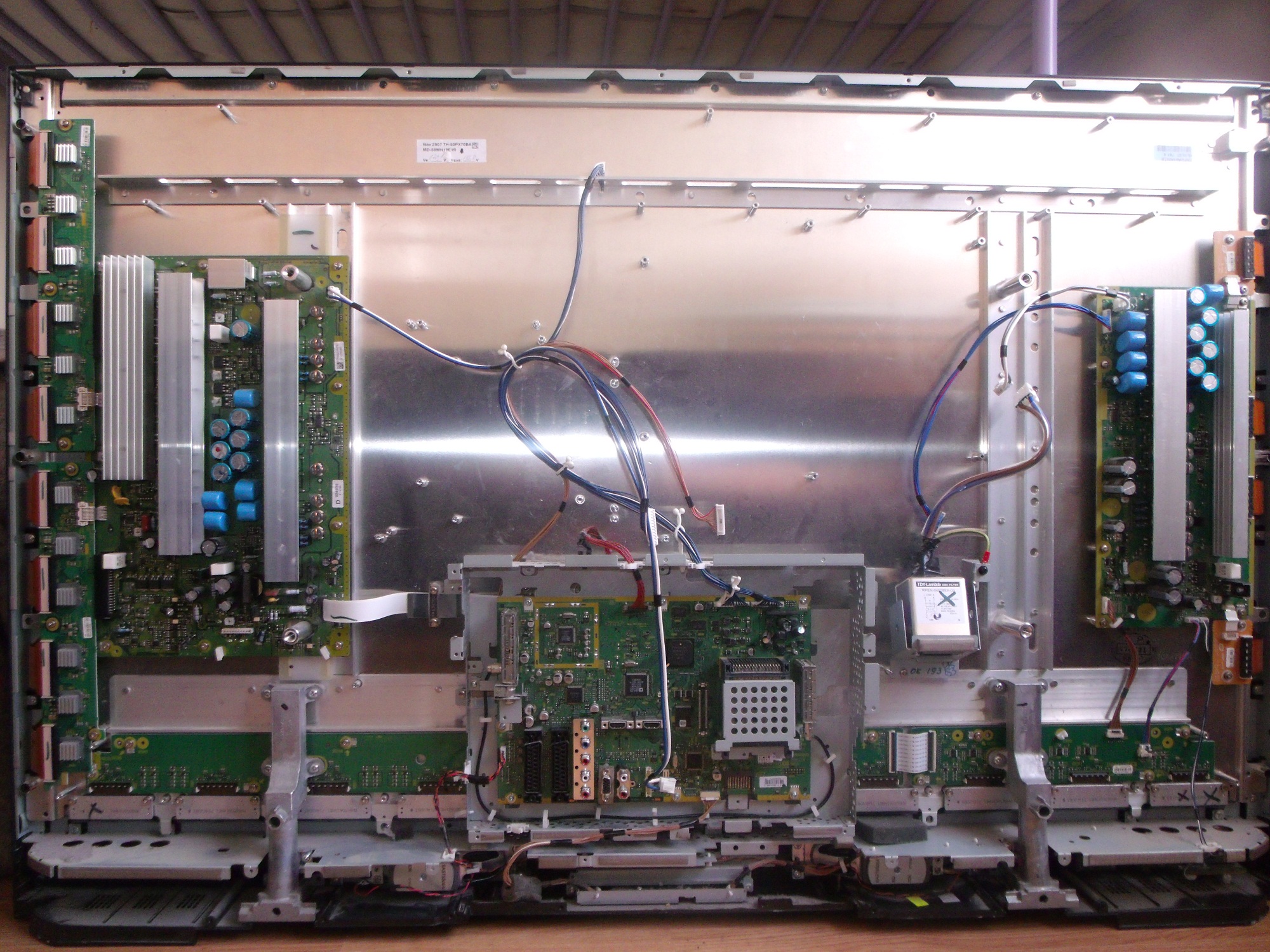

        OK. So this model is not the same as 70B and has an A board? Try downloading TH-50PX75U manual, has the PSU model you mentioned but at a glance it's looking real close.
        If you can upload some pictures of the layout of this model.

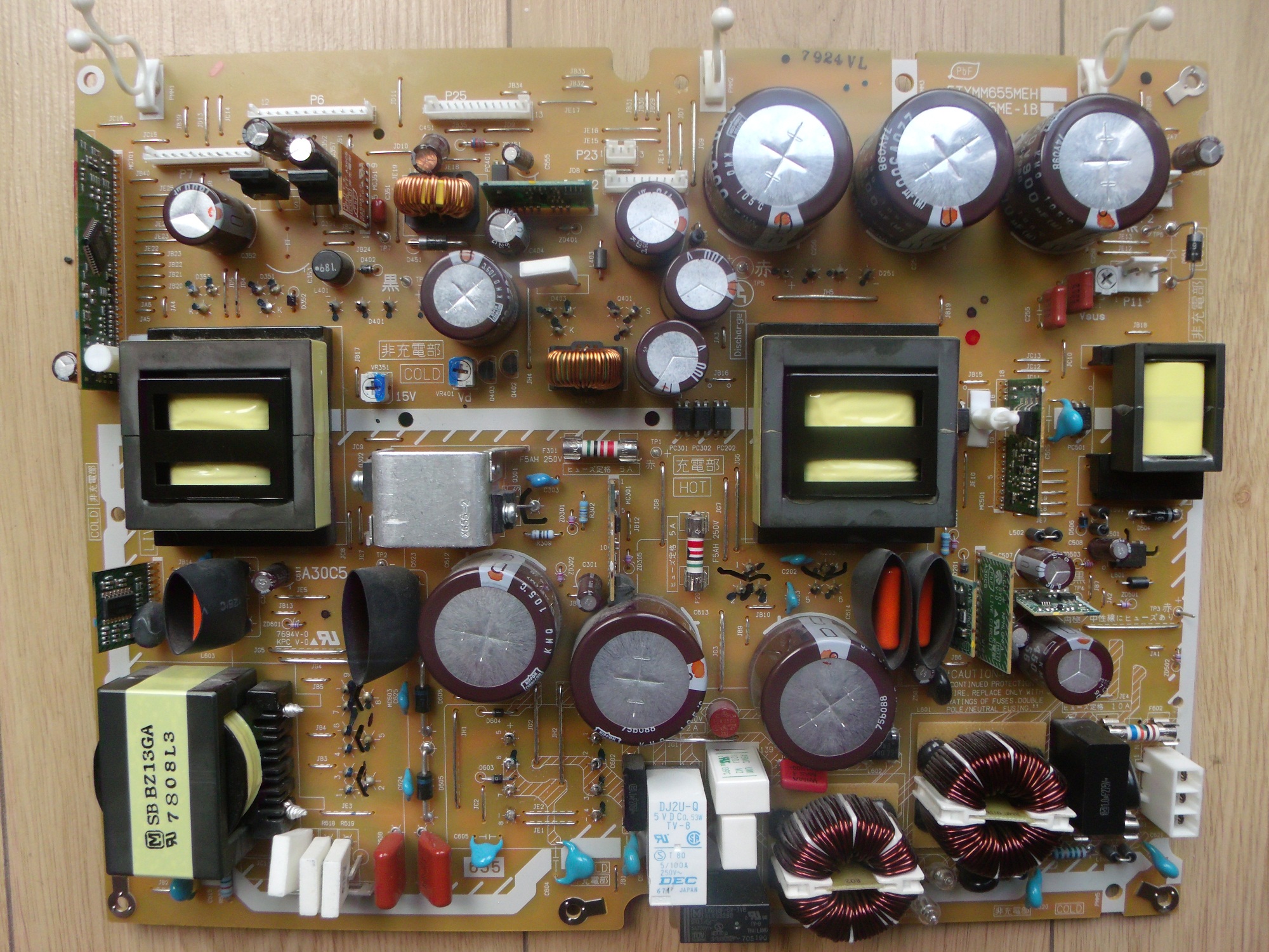

                    Hi everyone I have some more info so, I have traced the voltage circuit and this is what I've found. from T301 (I assume this is the voltage transformer) on JD6 and JD7 I see 0.9v at power on, this 0.9v can be seen at MC351 on pin 7 and at MC701 at pin 1 (I assume this is the self check for the 15v circuit) also at pins 2,3,&4 of connector P6 and 1&2 of connector P7 so from this I'm thinking that the cold side of the circuit is all ok and the fault lies with the conversion of the voltage to 15v
                    lmao ho hum..... maybe I should read other peoples post before I start to write lol thanks for the info tw2005 so its worth me replacing the 1.0uF resistor on the MC301 and MC201 then? I'll order some now :-) thanks, I'll keep you all posted.

                      quote!! lmao ho hum..... maybe I should read other peoples post before I start to write lol thanks for the info tw2005 so its worth me replacing the 1.0uF resistor on the MC301 and MC201 then? I'll order some now :-) thanks, I'll keep you all posted.
                      make sure you order 1uf 50volt panasonics i just used ordanary leaded ones and glued the capacior to the ic mines been working great a verry fiddly job look at the video for tips and remember to mark which ones is mc301 and m201 as they might be different took me about 2 hours to do the whole job as was fiddly and loads of screws lol.

                          Hi all I have now replaced the capacitors on the boards MC301 and MC201 but I've still got no 15v, I see on the other post link he's talking about bad/poor wiring plug connections. can this cause no power on the 15v ? or does anyone have any other suggestions thanks.

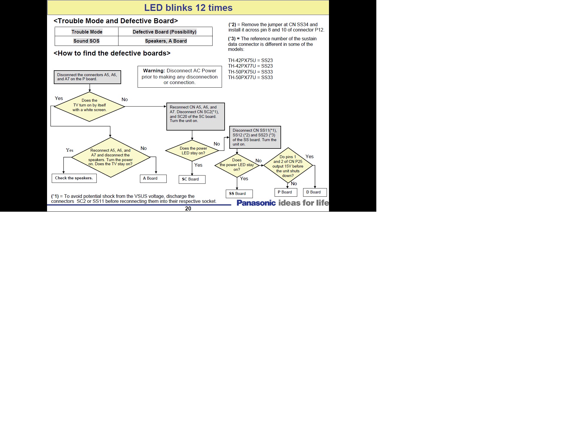

                            Hi once again all, I'm getting no ware with this TV... so back to the start then.
                            I've gone back to the flow chart and have a question I've done the remove A5, A6 and A7 and no the TV did not turn on with a white screen, so I reconnected the connectors A5, A6 and A7 and disconnected SC2 and SC20, Now here's the question the power light comes on green and then starts to flash code 12 so does that count as the light staying on or not? if it counts as staying on then the flow chart points to the SC board? any body got any ideas?
                              no, what they're after is a solid lit, normal startup. Blinking is error.
                              have you checked out Q351,MC351. with PaulG's 70B which does not have an A board he found 15V was generated but not switched on for the sound by Mc351/Q351.
                              Does this have a D board? I'm unfamiliar with these but i'd continue down the flow chart and see how you go.

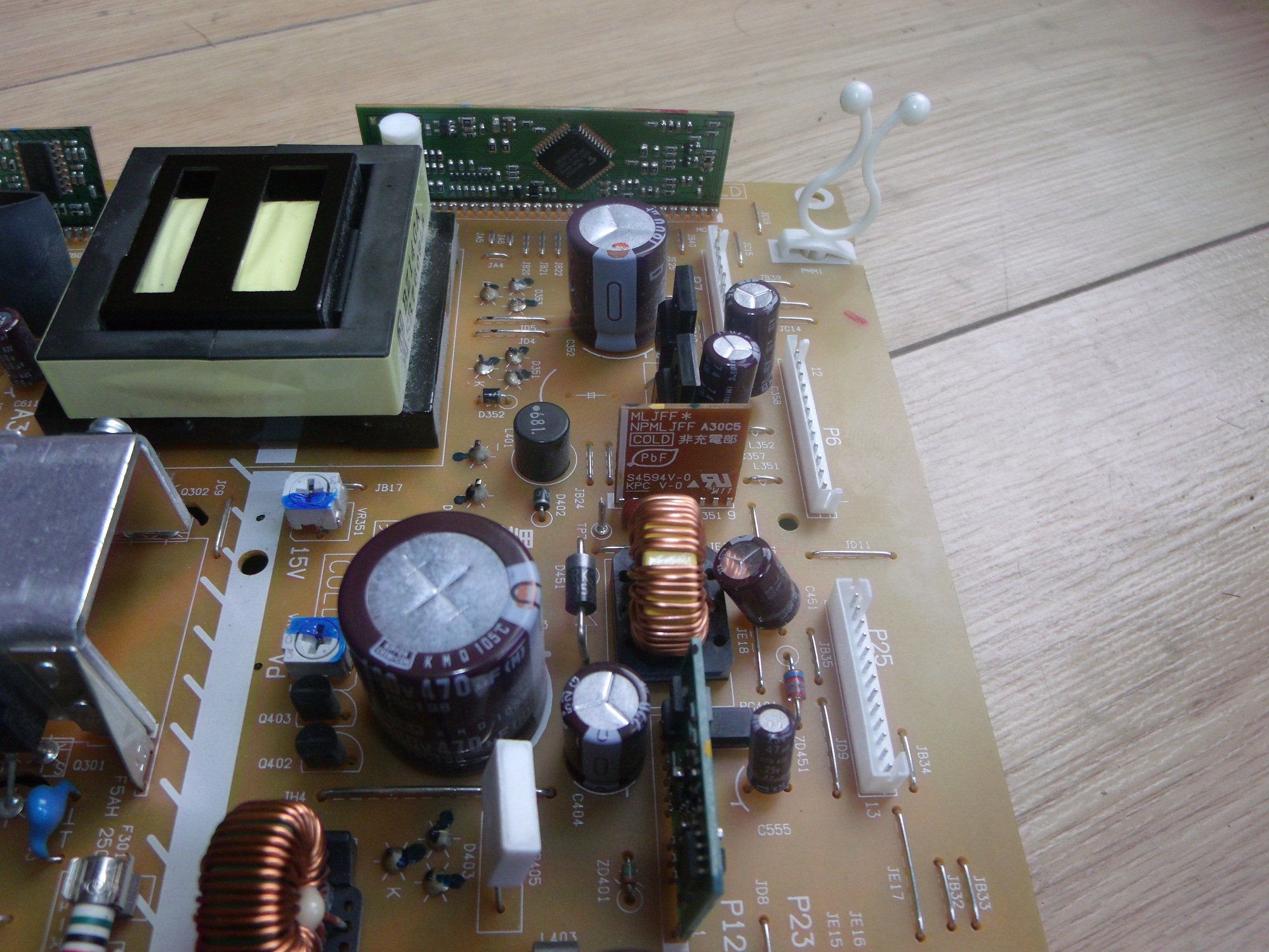

                                Any chance you can get a clear shot of MC351 module to see the cct and components.?

                                  Thanks for your help tw2005 I've continued with the flow chart, its telling me to remove the jumper from SS34 and install it across pins 8 and 10 of P12 so I have removed the power switch and installed it across pins 8 and 10, still getting the flashing error, Next step: Do pins 1 and 2 of CN P25 output 15V before the unit shuts down, No I get a spike of 0.8v if the units been of for a long period if time and a steady 0.1v if its off for a few minutes so the flow chart is pointing to the P board. I'll take a picture of the MC351 when I get back I'm just heading out right now thanks
                                  • tw2005
                                    • Oct 2011
                                    • 6458
                                    Re: Panasonic TH-50XP70BA
                                    I'm expecting the same fault , that being the PSU. Sorry if the MC201/MC301 threw you off the scent. The main reason I dug up the post was there was a reply in there from a pana service agent and mentioned was MC351 as part of a trio of modules to be replaced.
                                    Seems to indicate to me MC351 may be a known issue and was hoping it may be something really simple like a cap etc on that board.
                                    That module turns on 2 separate 15V lines Q351 & Q352 both come from the same source.
                                    Just need to deduce how MC351 switches Q351 on.

                                      Sounds like you're following 10 blink chart not 12? On the PSU, next to MC351 there's a post TP7. If you hook up there and turn on should see 15V.

                                        Hi again tw2005 I'm following the 12 blinks attached, as for TP7 I'm getting 0.1v so does that mean the 15v isn't coming out of the high voltage side then?
                                        if so am I heading back to the MC301, MC201?
