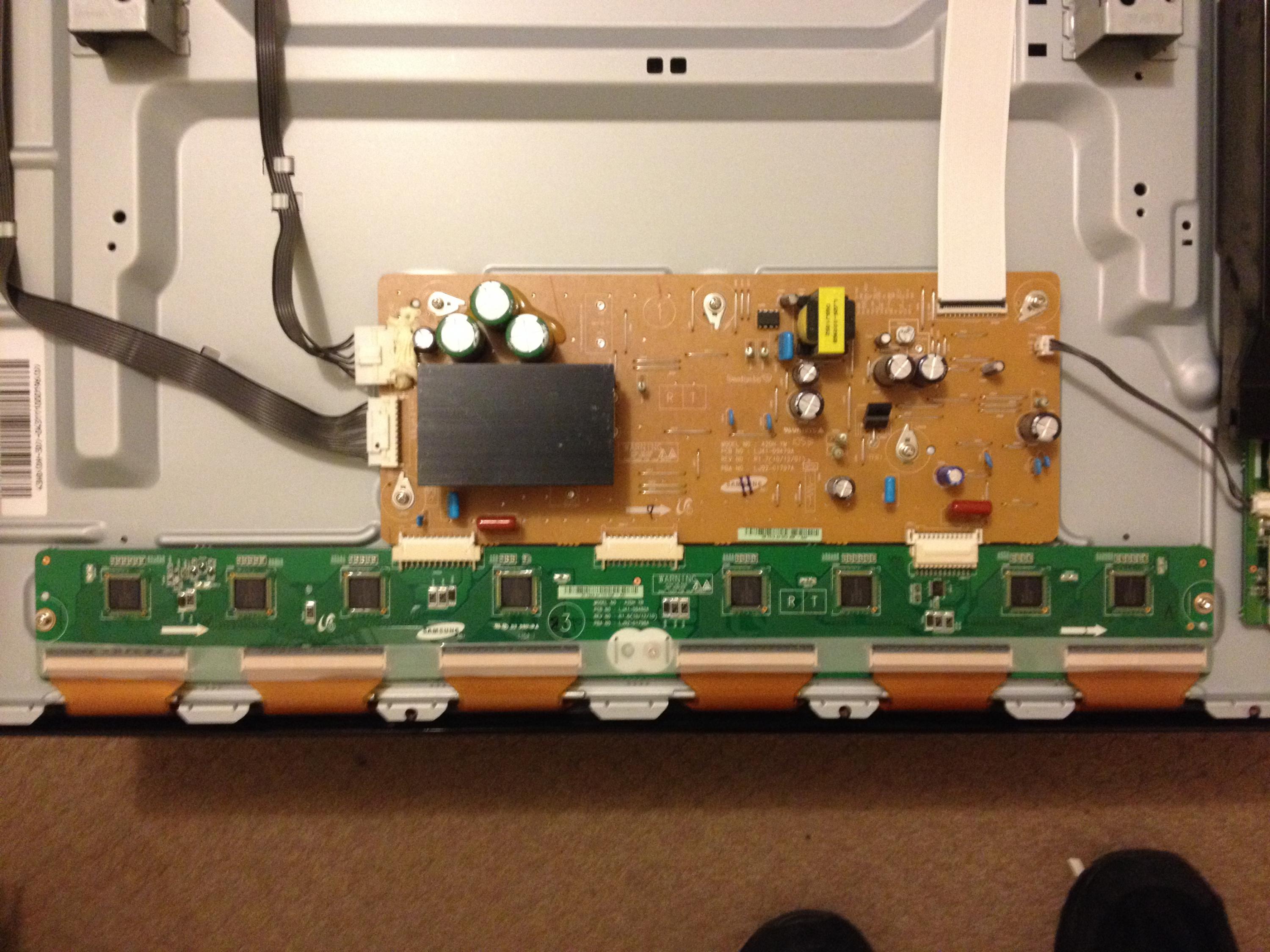

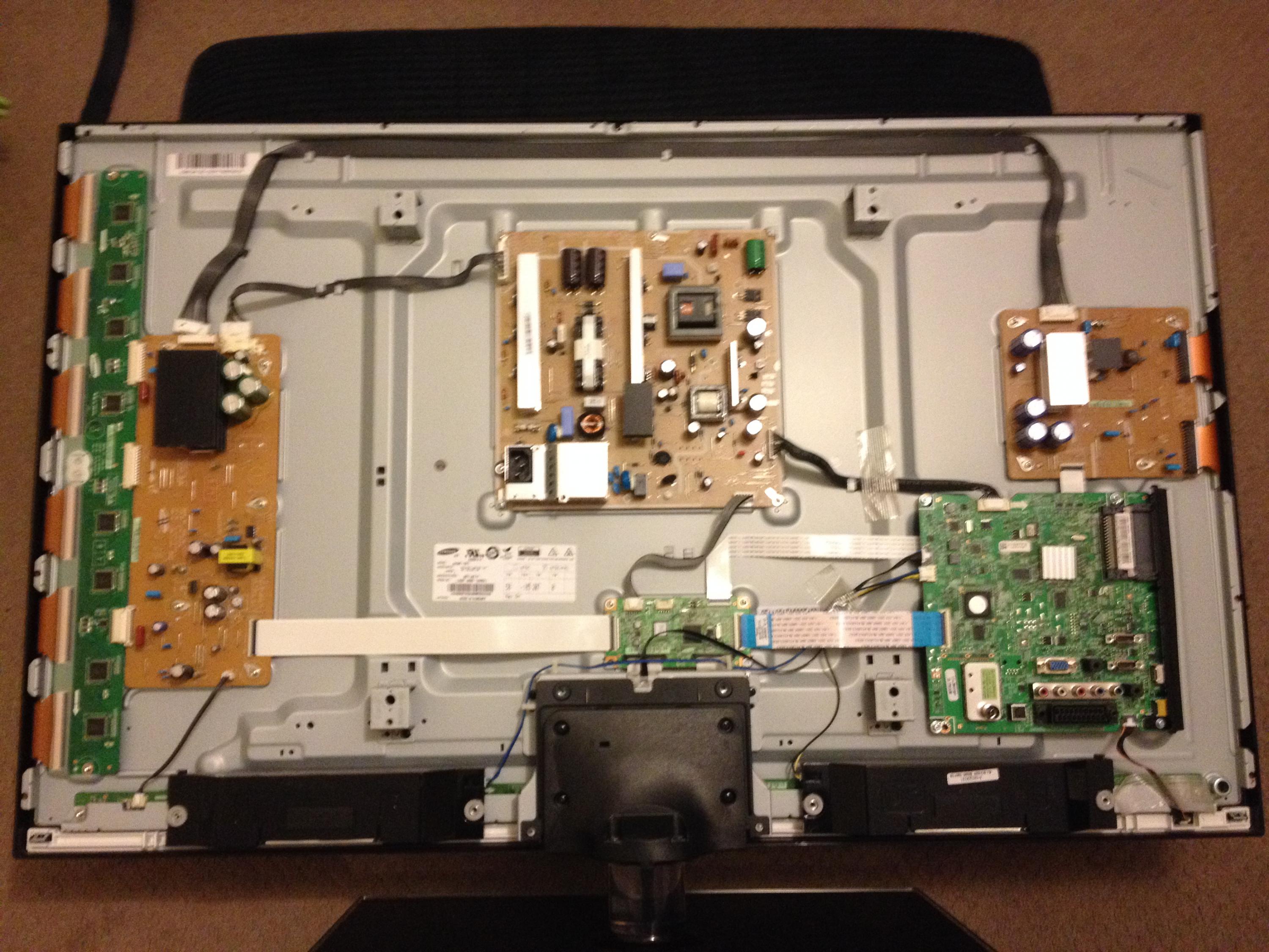

    Standby light will flash once as it trys to power up and it clicks from PS
    Then it continues like that
    I have removed the back and nothing is burnt out that i can see
    If i remove the X-main from the Y-main the set then has the standby flash 5 times then off but no display or start up sound, the T con LED is then on for about 5 seconds then goes off for about 2 seconds and keeps going
    I know there is problems with both y and x mains on these but i was hoping i could narrow it down to 1 if possible

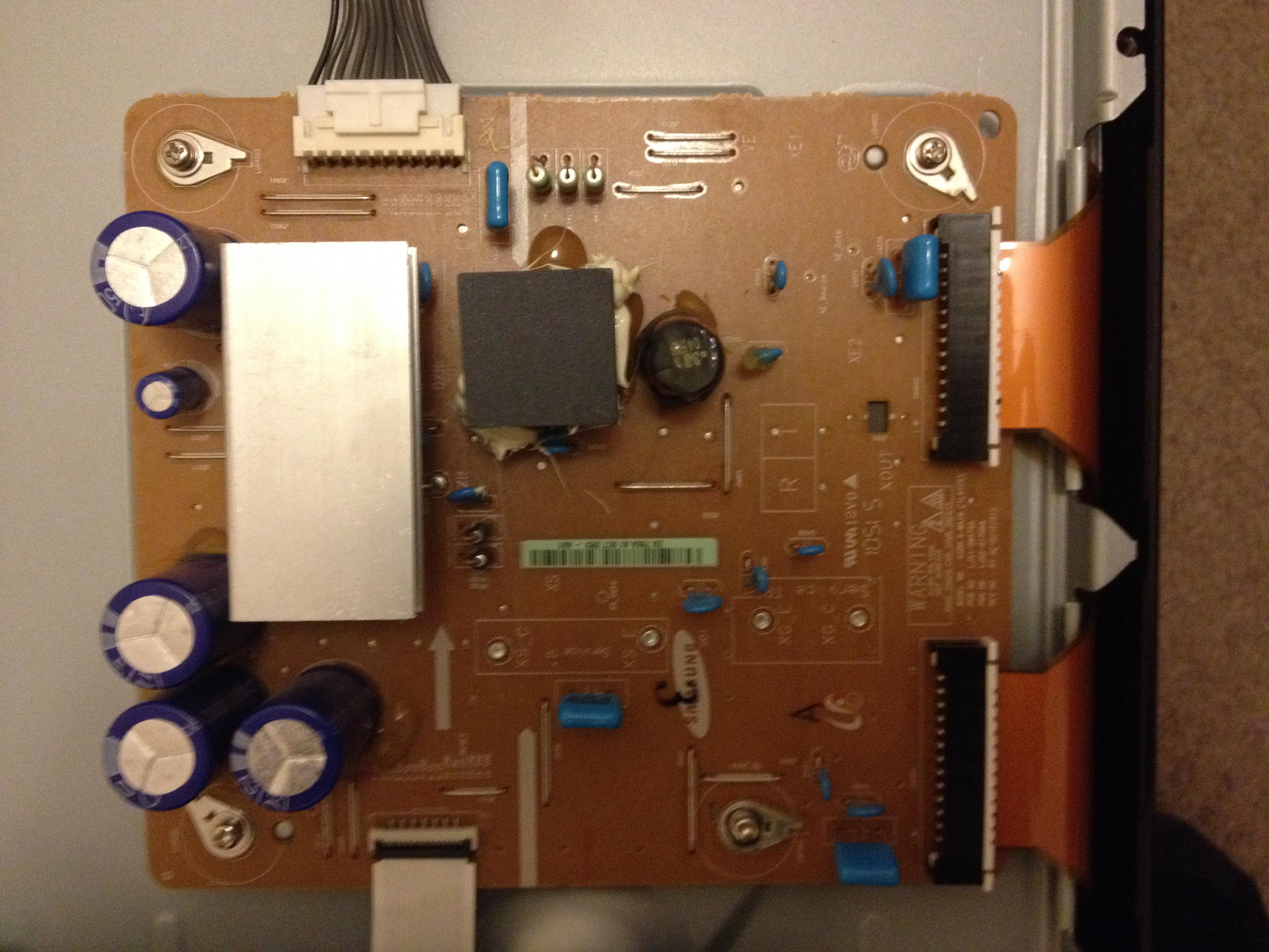

    Usually if the Y-main is bad, there's a high chance it will take out the X-main as well. If it was just the X-main that was bad you could usually get away with replacing that one.
    The boards are relatively cheap, but the mosfets on the heatsinks for each board are usually the ones to blow and cause the clicking problem.

      thanks Glitcher - when i disconnect the x-main there is no clicking does that mean my y main is good ?
      Is there any way i can check, i dont want to buy an x-main then blow it from a bad y-main
        Re: Samsung PS43D490 clicking when powered on no display
        You need a scope to verify. You can look at control board LED. It should blink 5 sec off 2 sec on with fault detect (X-main missing will cause this.)

                  thanks tom going picking up a scope next weekend and iv ordered a X-main for the tv

                      quick update new xsus resolved the set - updated the firmware and now its sold after a weeks testing - didnt get the scope in the end as the seller wasted my time will post when i find one cheers all
