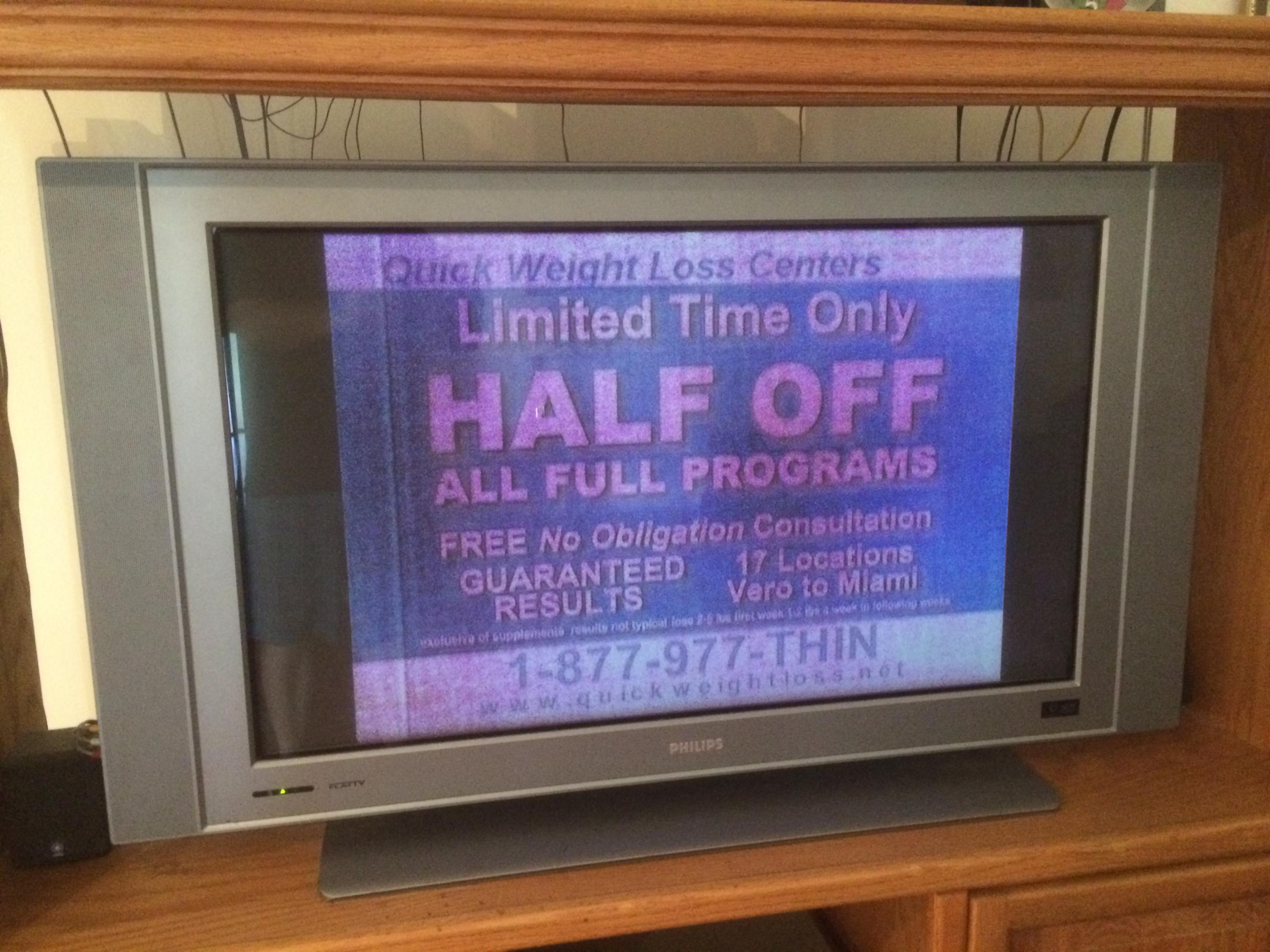

    I have an old Phillips 42PF7220 Plasma TV that has been pretty reliable for years. I have done some of my own repairs. I replaced a Y-Buffer board in January of 2012.
    Today it started acting up again. My wife turned it on and the picture appears very faint, as if it's being viewed through a black fog and the image has a red tint to it. You can see the picture in the image I posted above.
    Has anyone seen anything similar on their plasma? Do any of the experts on the Forum have any suggestions as to repair. I think it's a 2004 so it may be ready for pasture. I thought I would give it a shot instead of adding to the landfill.

    Clear cut Z-sustain / X-main failure right there.

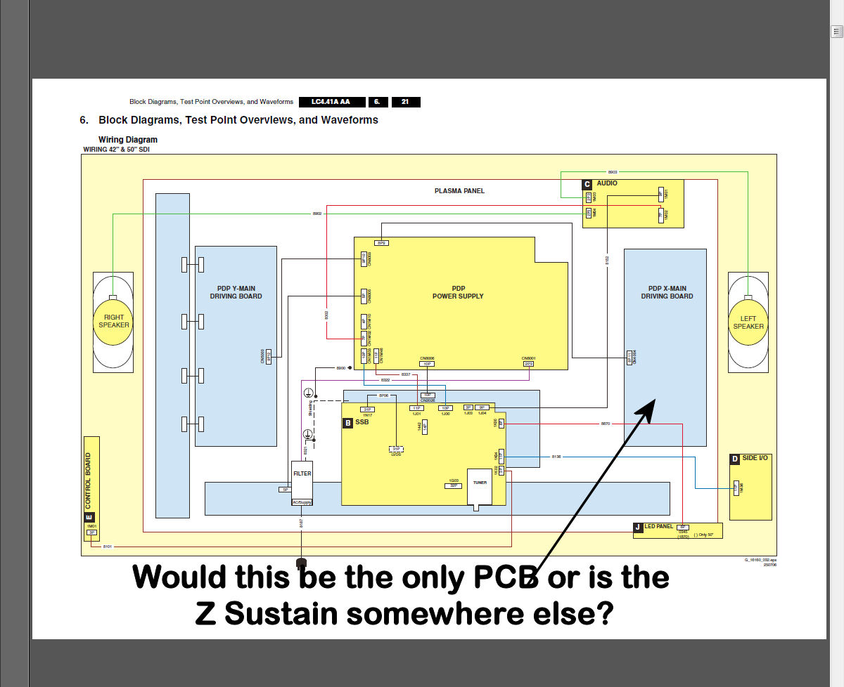

      In the manual I have it shows a PCB to the right of the power supply called the PDP X-Main. Is that what I want to replace? Is the Z-Sustain a separate PCB? If so could you point me in the region I should be looking for it.

        The Z-sustain and X-main are different names for the same part, in your case, it is X-main because the panel (display) components are made by Samsung.

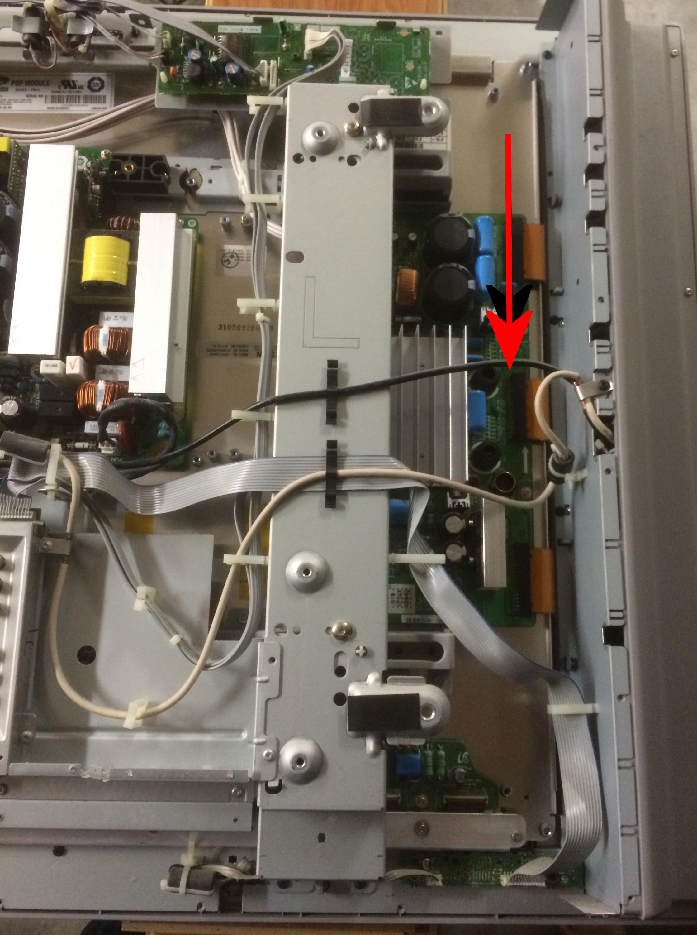

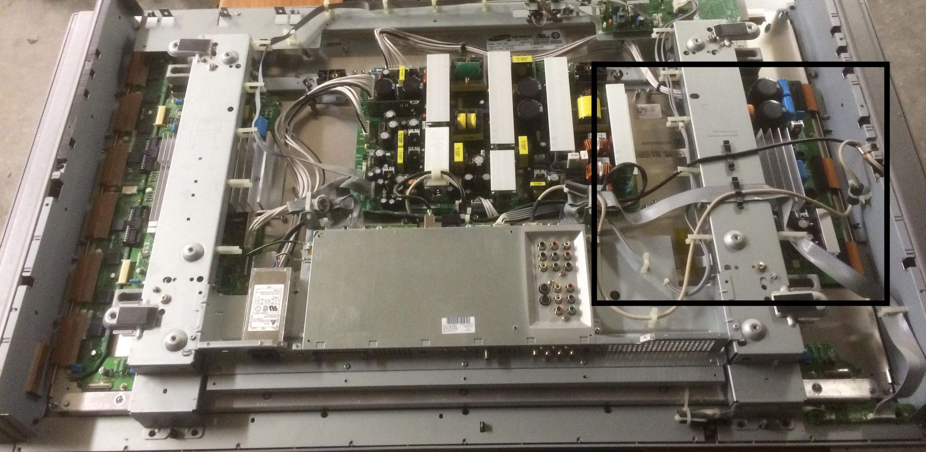

          I have the backcover off and it looks a little different than the manual. Is this the one:
          Once I have the board out is there a chance i just need to replace some blown caps or it do I need to replace the whole board?

            Yes, that is the X-main.

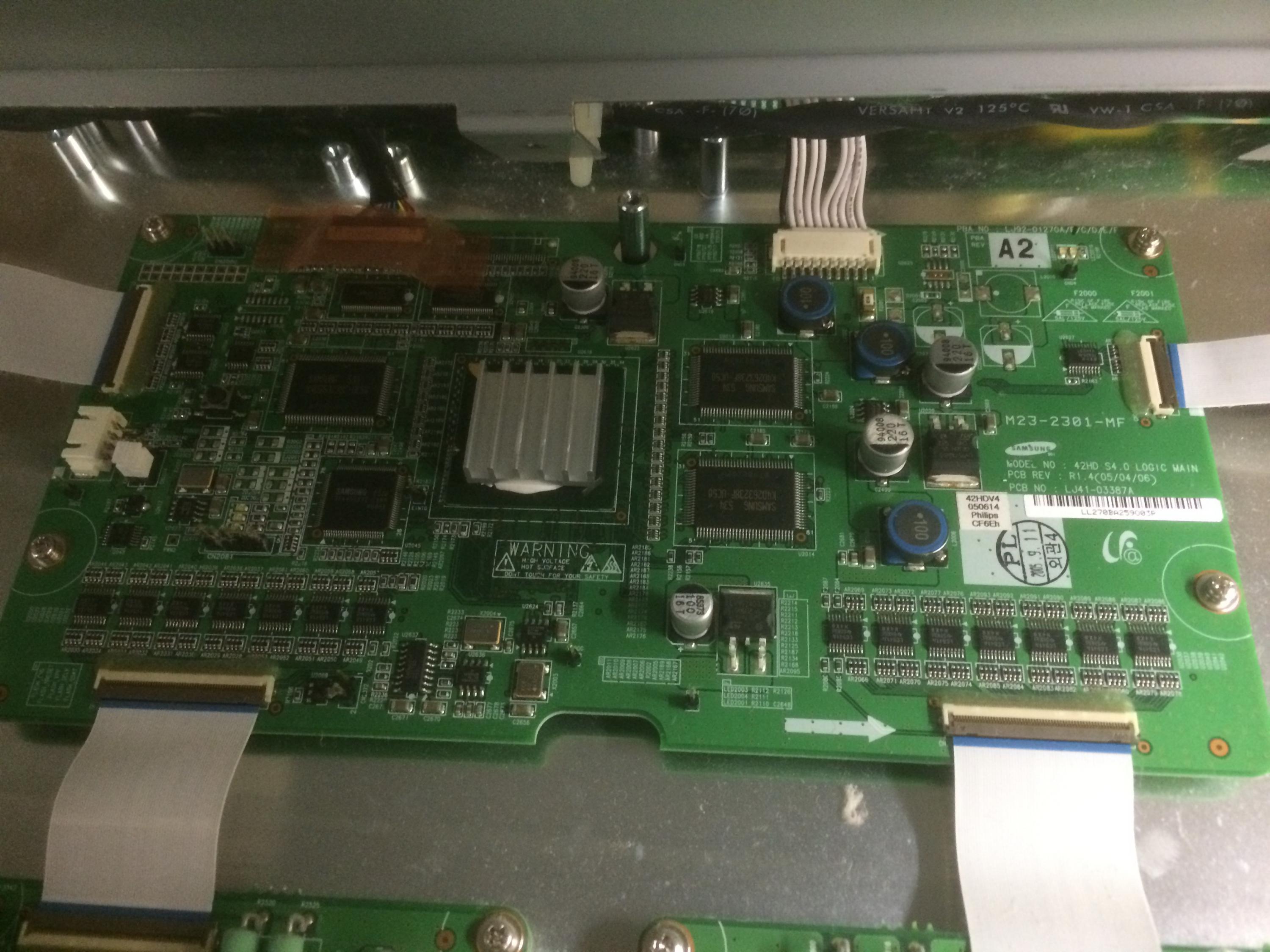

                              We had one here which was not resolved by X-main. It turned out to be a bad component on the control board feeding into X-main. It required in depth analysis and about 100 posts but we did sort it out. I'll see if I can dig out the thread. IIRC, an oscilloscope was necessary.

                                I'm second guessing whether I fully seated the small latch ZIF connector leading into the board. I'll open it back up and double check. Could this explain it?
                                I don't have an oscilloscope and it sounds like it will be beyond my capabilities but I would like to hear what was discussed in the earlier thread.

                                      OK great. I read through the thread. I don't have a oscilloscope. If I find that I have the new X-Main well connected would it be worthwhile to test the resistances across the resistor banks you indicated in the thread? I have a multimeter. I'm a mechanical engineer but am pretty clueless with electronics.

                                        I have the TV apart again and it appears all the connections to the X-Main are solid. Are there any tests I can do without the oscilloscope I can do? I have a multimeter. I included a picture of the logic board in my TV that is connected to X-Main by the narrow flex.
