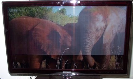

    Samsung LED Smart TV UE32D6100 white haze
    Hi
    Got a problem with this tv the picture has a white haze over the picture.
    Please see picture attached. once the tv warms up say after 20mins screen will display perfect. Problem only effects 2/3 or more of the screen.I have looked at the power board and don't see any swollen caps etc.
    Any ideas please
    cheers
    Mark
    Re: Samsung LED Smart TV UE32D6100 white haze
    LCD panel is bad, may or may not be fixable (tab bonds.) Too common, too damn common with newer panels. This is March 2011 TV or newer. Crazy.
    • homerclone
      • Jan 2014
      • 53
      • uk
      Thanks Tom. Think you are right. This sucks
