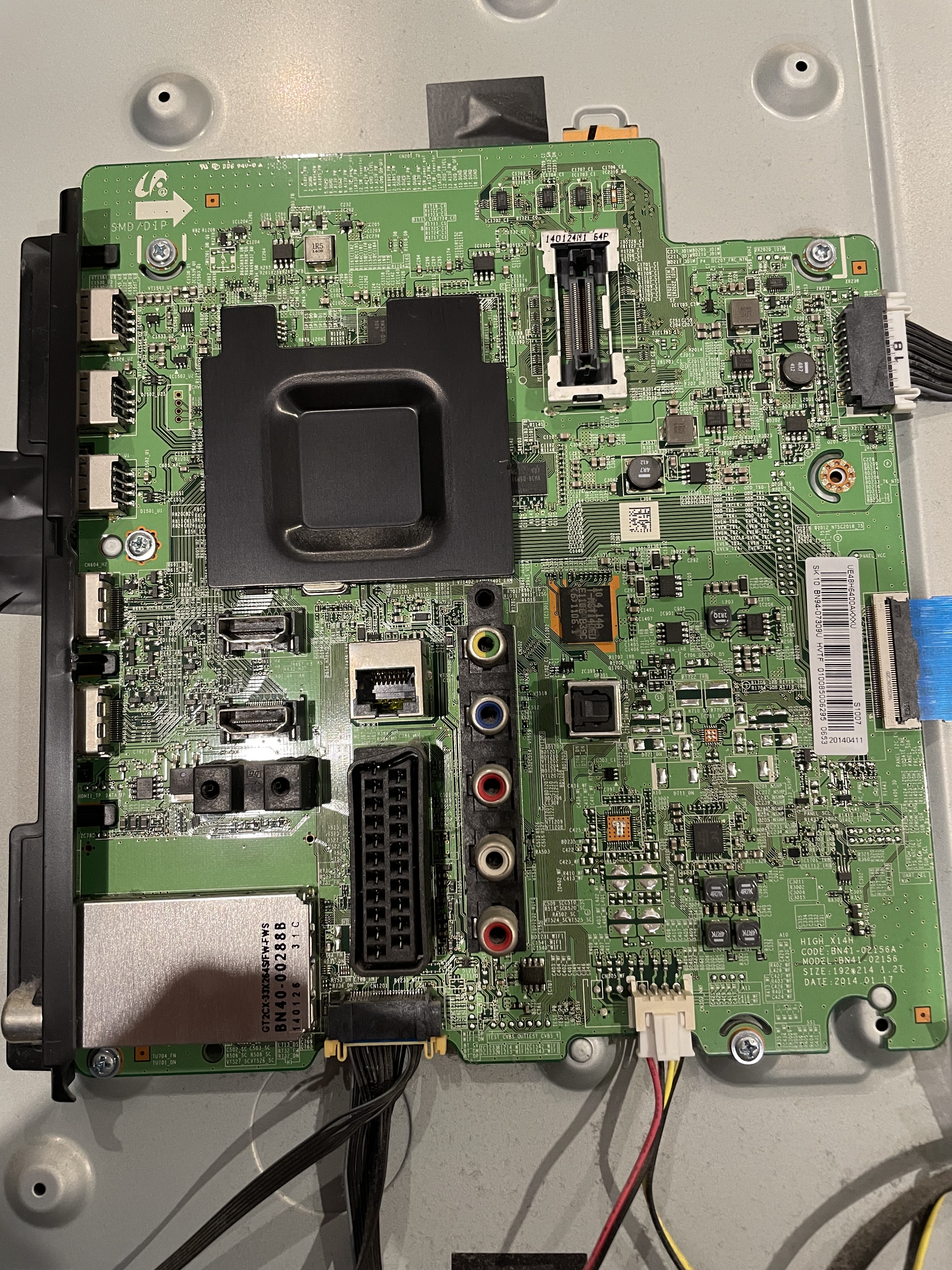

    Hi, I'm new here and looking for some advice on how to diagnose an issue i have with 2 samsung TVs.
    I have a UE32J5500AK and a UE48H6400AK both with the same issue of red light but nothing happening on the screen, the red light responds to remote or button press by flashing once but stays red. I have searched forums but most turn up a blinking red light.
    I have tried replaceing the power board on the UE32J5500AK last year but this resulted in the same outcome.
    The UE48H6400AK recently developed some small bright areas on the screen, then last week would not power up displaying the same symptoms as the UE32J5500AK, i appreciate that the 2 issues may not be the same but i would like to diagnose the correct parts to replace.

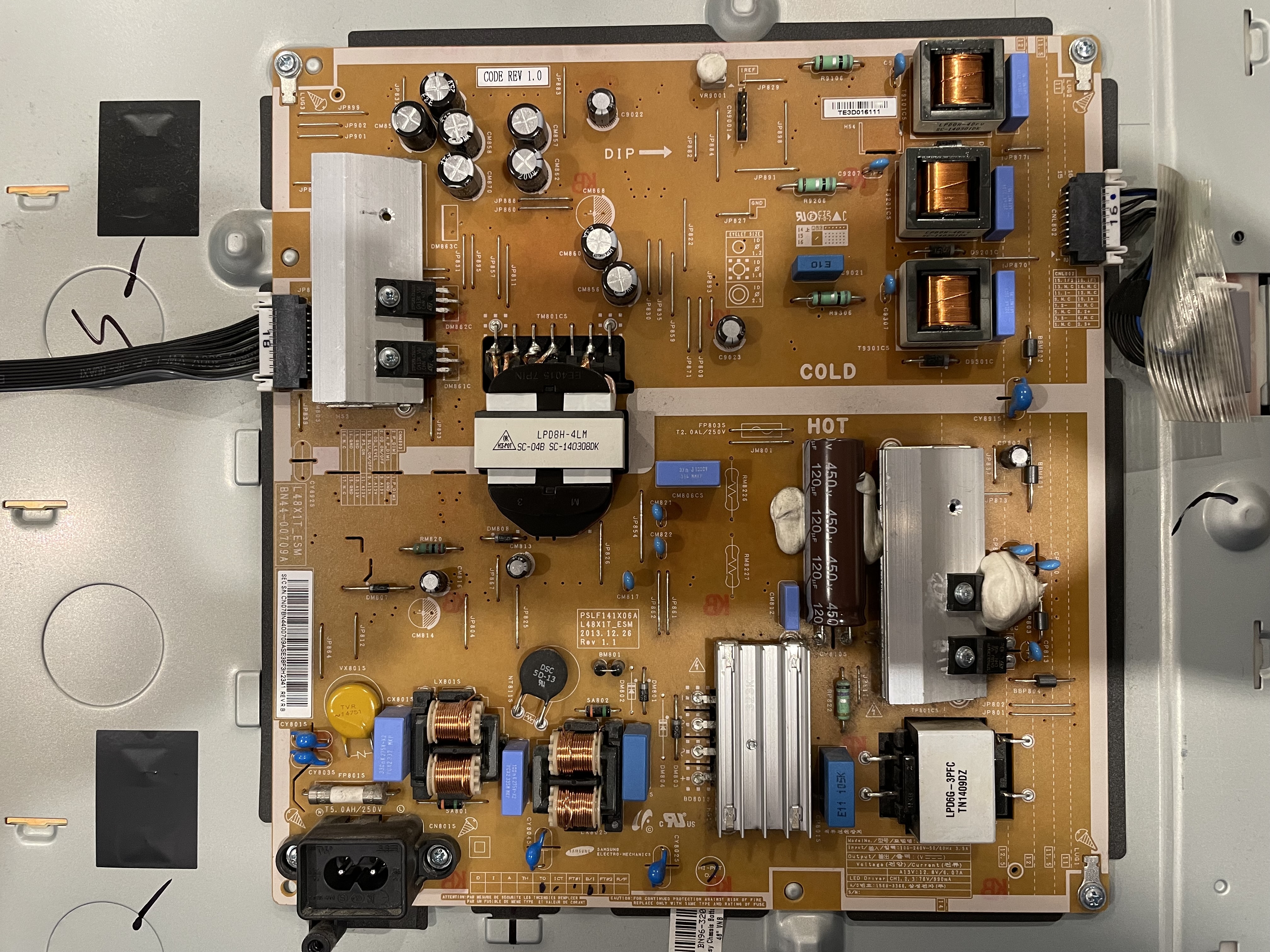

    First test, unhook cable from powerboard to mainboard, plug power cord in, see if backlights come on and stay on, need at least a focused picture of each board and one of the whole back including all the boards.

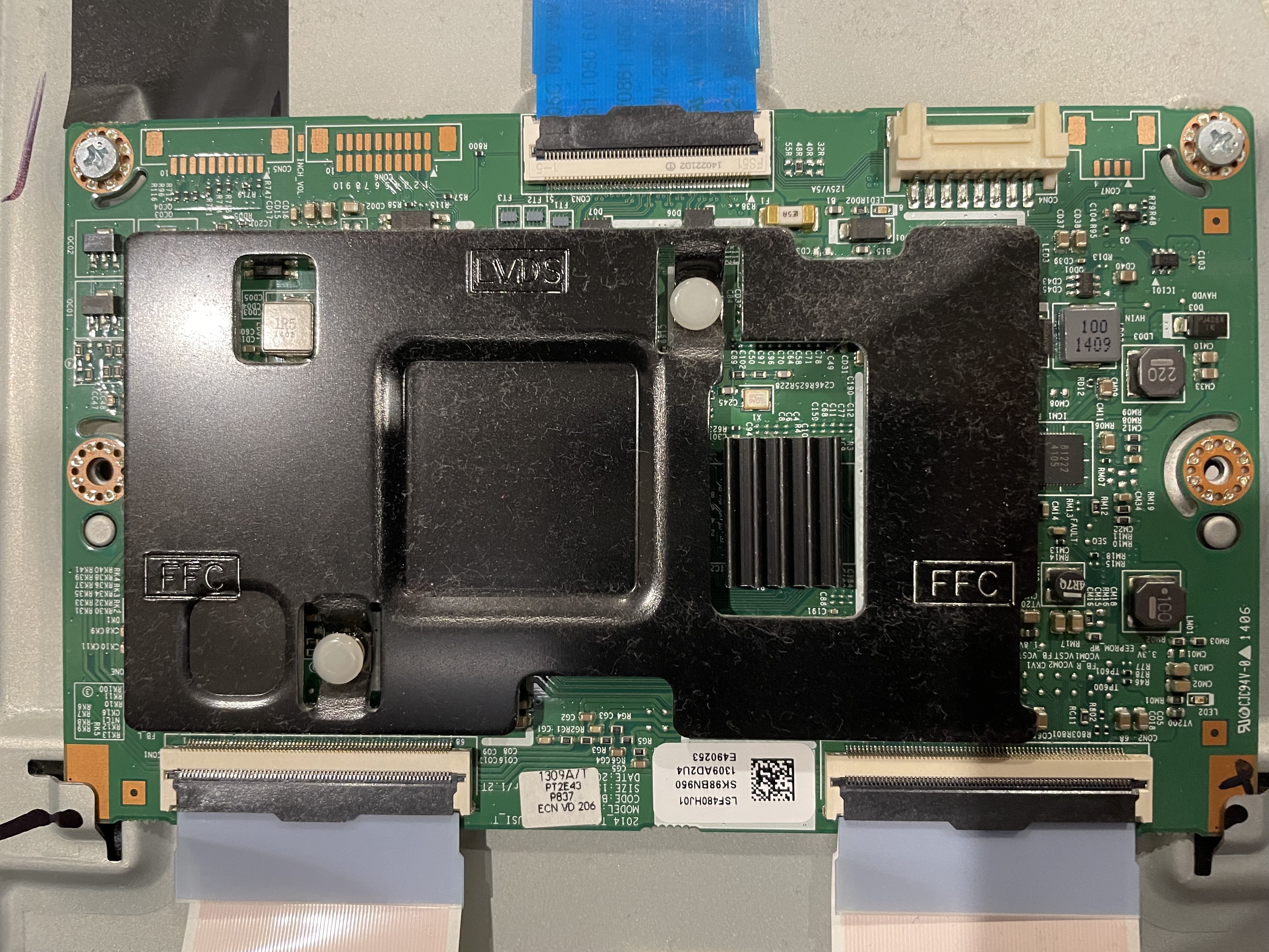

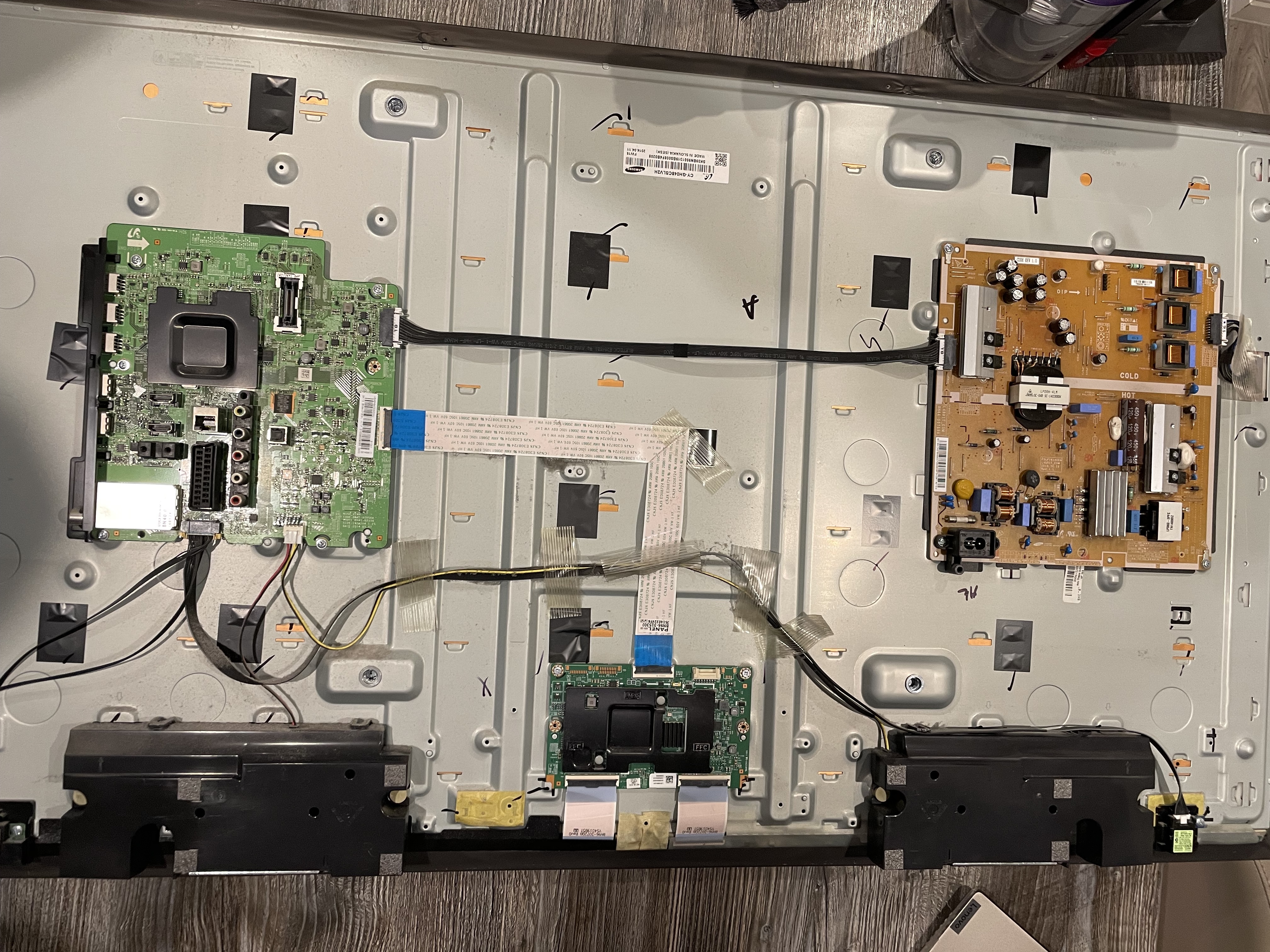

          UE48H6400AK
          Removed cable from power board that was hooked up to the main board, plugged power cable in and the back lights came on and stayed on?
ID:	3234390 Click image for larger version
ID:	3234391 Click image for larger version
ID:	3234392Click image for larger version

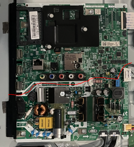

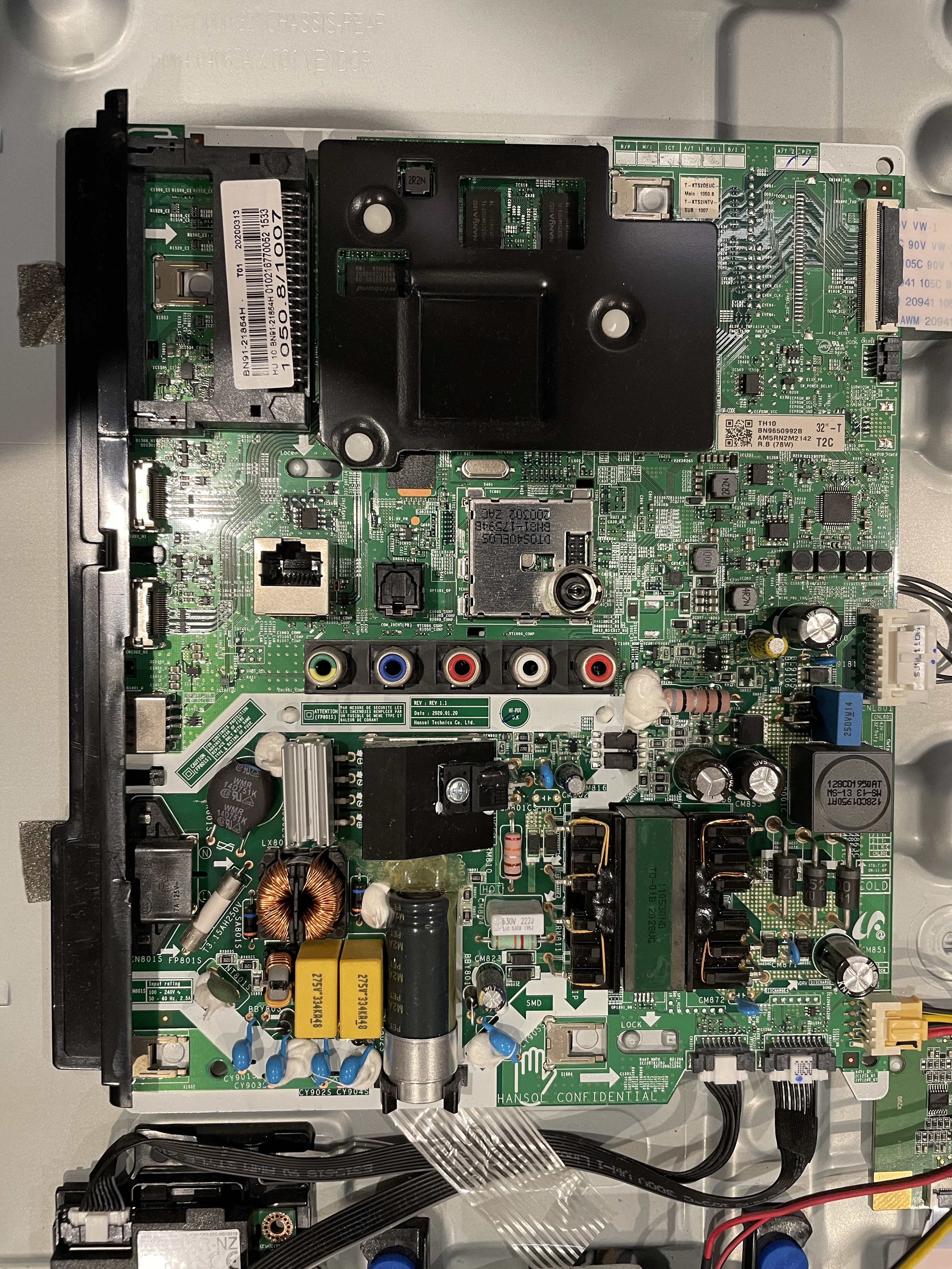

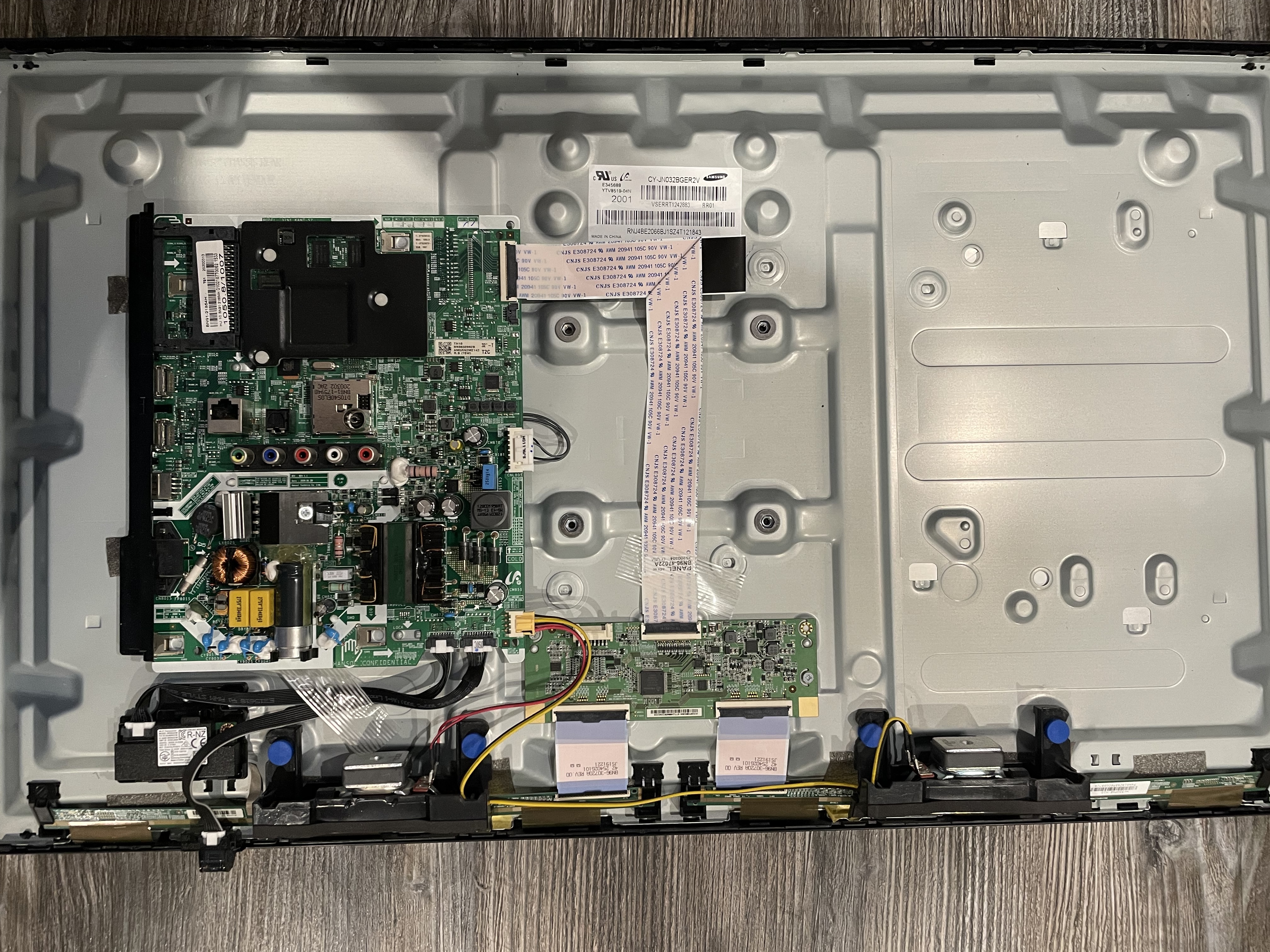

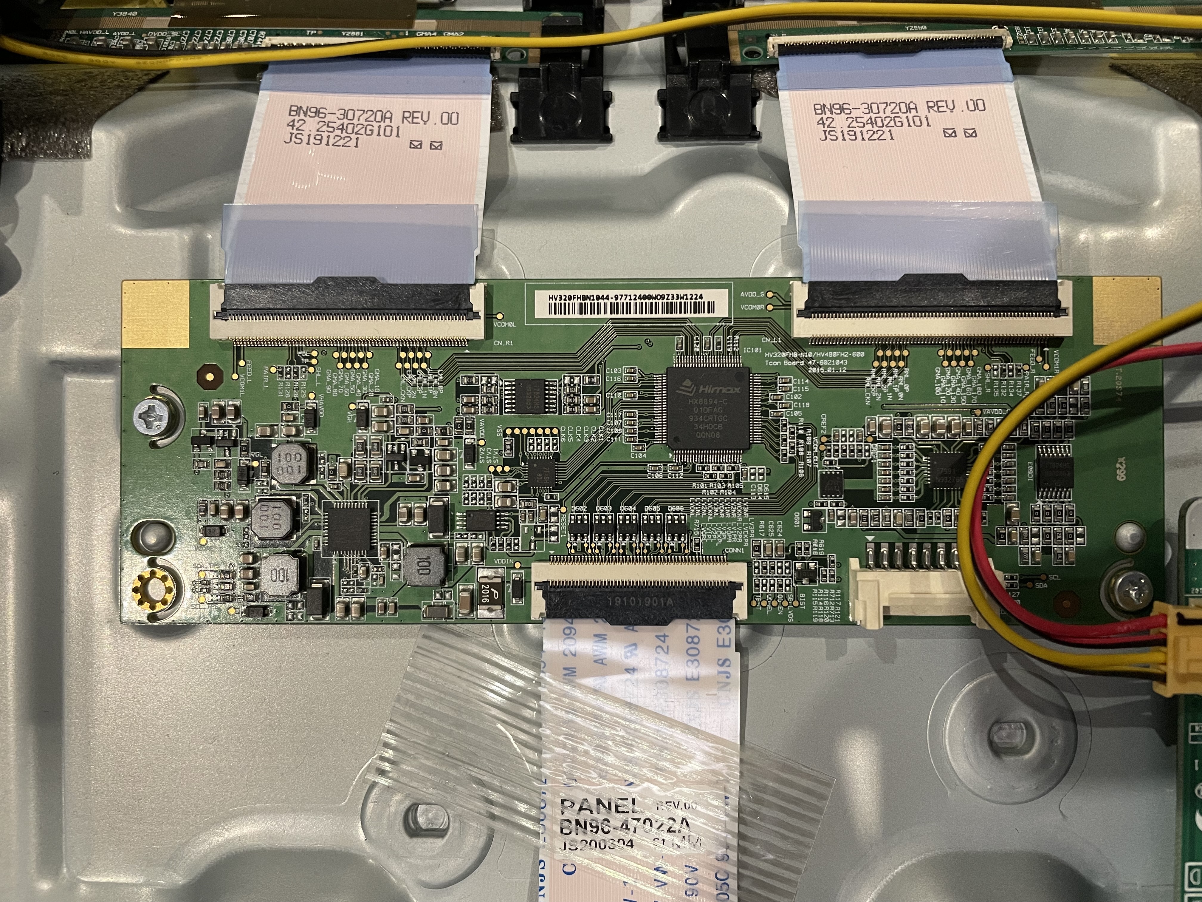

          UE32J5500AK
          Same method as above bu no back lights came on (on this set the red standby light blinks every now and again, doesn't stay on)

            Originally posted by slimsoul
            UE32J5500AK
            [ATTACH=JSON
            {"data-align":"none","data-size":"thumb","data-attachmentid":3234395}[/ATTACH] Click image for larger version
ID:	3234396 Click image for larger version
            How did you manage to disconnect the cable between the power supply and the motherboard on the UE32J5500AK, if this board is two in one (motherboard + power supply)?
            • slimsoul
              • Mar 2024
              • 14
              • Wales
              Disconnected the white 8 pin connector assuming it was going to a main board. Can the power be removed on a 2 in 1?
              • lotas
                • Jan 2016
                • 4671
                • Russia
                Well, how do you turn it off, of course not.

                  vinceroger69 nomoresonys do you guys have any advice on the next step to diagnose the fault on the UE48H6400AK?
                  Seems like the UE32J5500AK is a different setup and has a 2 in 1 main/power board and i was unable to remove power to complete the test, is there any other test i can complete for this setup?
                  • vinceroger69
                    • Mar 2012
                    • 6714
                    • uk
                    Hi on the 48 inch set it maybe a firmware issue hopefully lotas or diah can advise

                      Да, серия xxH6xxx играется со слётом прошивки, иногда помогает только перепрошить 25Q40, бывает что и в eeprom 24C512 и в eMMC.

                        Can this be resolved by replacing the mainboard? From a translation of your reply, flashing is possibly out of my skill set of special tools are required.
                          yes a mainboard swap should work fine just make sure you match all the numbers up from on your old mainboard and make sure you buy a board with a returns policy just incase it arrives faulty
