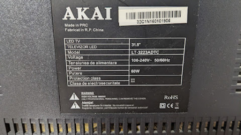

Akai Tv LT-3223ADTC dump needed
  • thesame
    • Mar 2018
    • 141
    • Romania

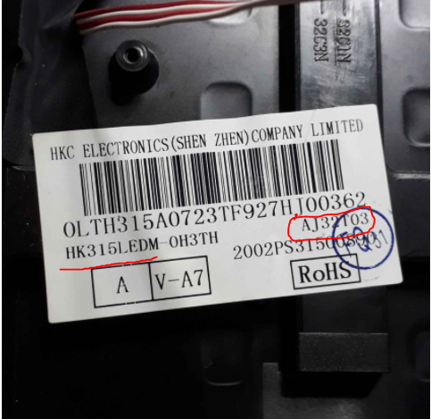

    The TV was stuck at the logo screen, every dump i have tryed for this board TP.S506.PB818 is upside down, i have also tryed dumps from different tv's using the same board the image is normal (not reversed) but the remote is not working.Can someone help if we can edit the hex somehow?Click image for larger version

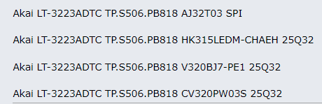

    Panel CV320PW03S ?

      I can see in my first picture upper left HK315L so my guess is that is the second version from your picture .

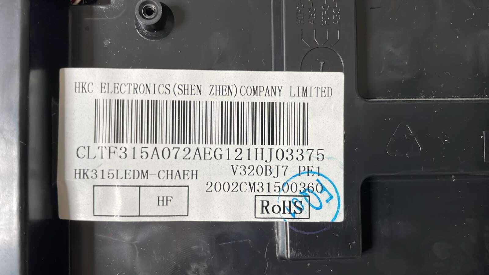

        You need to look at the panel strip, there is the matrix number.
          This is the trough number, and the matrix itself is on the right.

              This is it V320BJ7 PE1
              • lotas
                • Jan 2016
                • 4803
                • Russia
                Try.
                • lotas
                  • Jan 2016
                  • 4803
                  • Russia
                  Does not work?

                            It worked , thank you so much.
