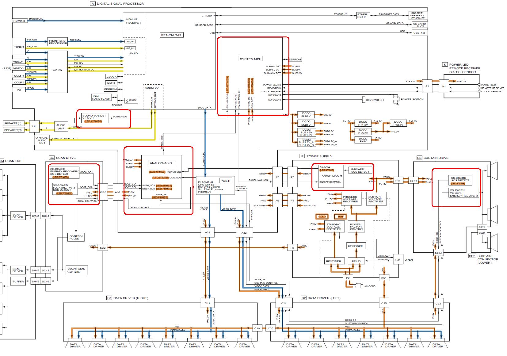

            yes. Using the SC as the example 5,15 and Vsus is supplied to that.
            Shorted Vsus will short the PSU. Trips SOS4 which is sensed by the PSU Micom. So in this instance you check the PSU voltages, you find Vsus missing, next step is to isolate anything connected to the Vsus line, you find it comes up clearing the PSU, you know either SS or SC had to be shorting this, you then check those.

            You may have already had a close look at a block diagram but I've highlighted the SOS blocks I can see.
