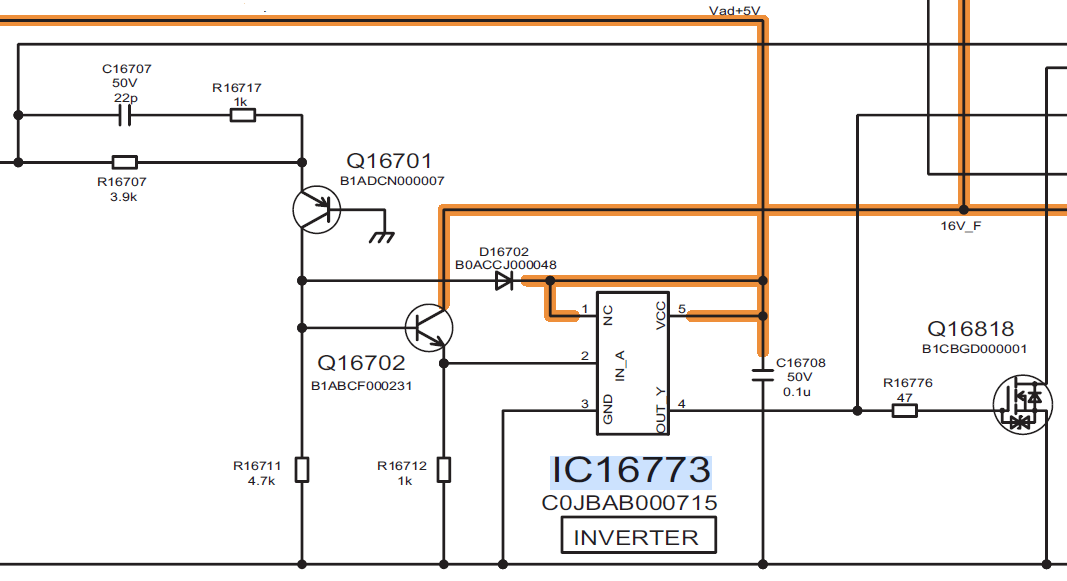

    After repairing my TNPA5081AF, it shorts out immediately after powering it.

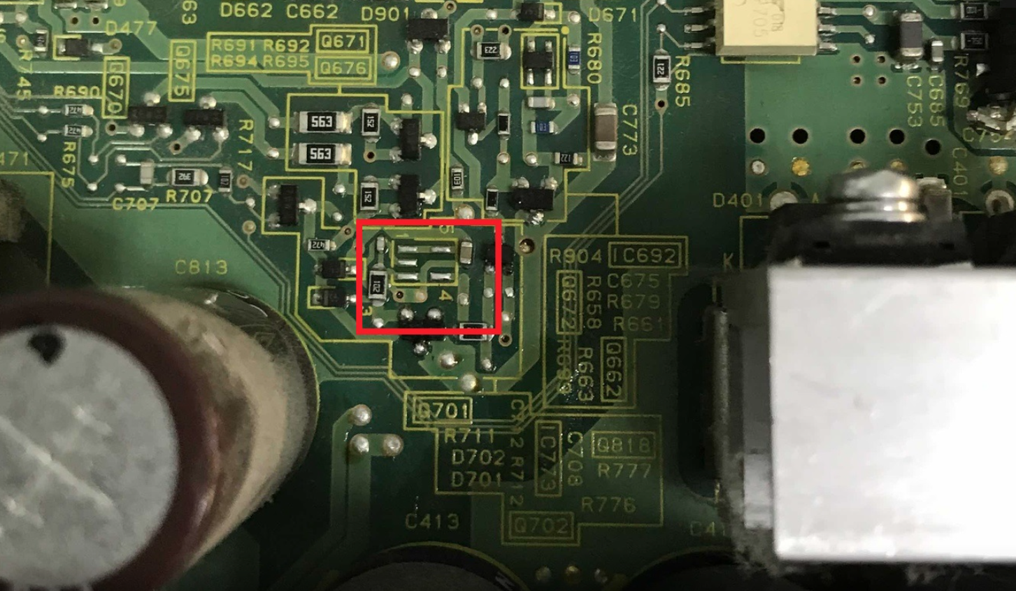

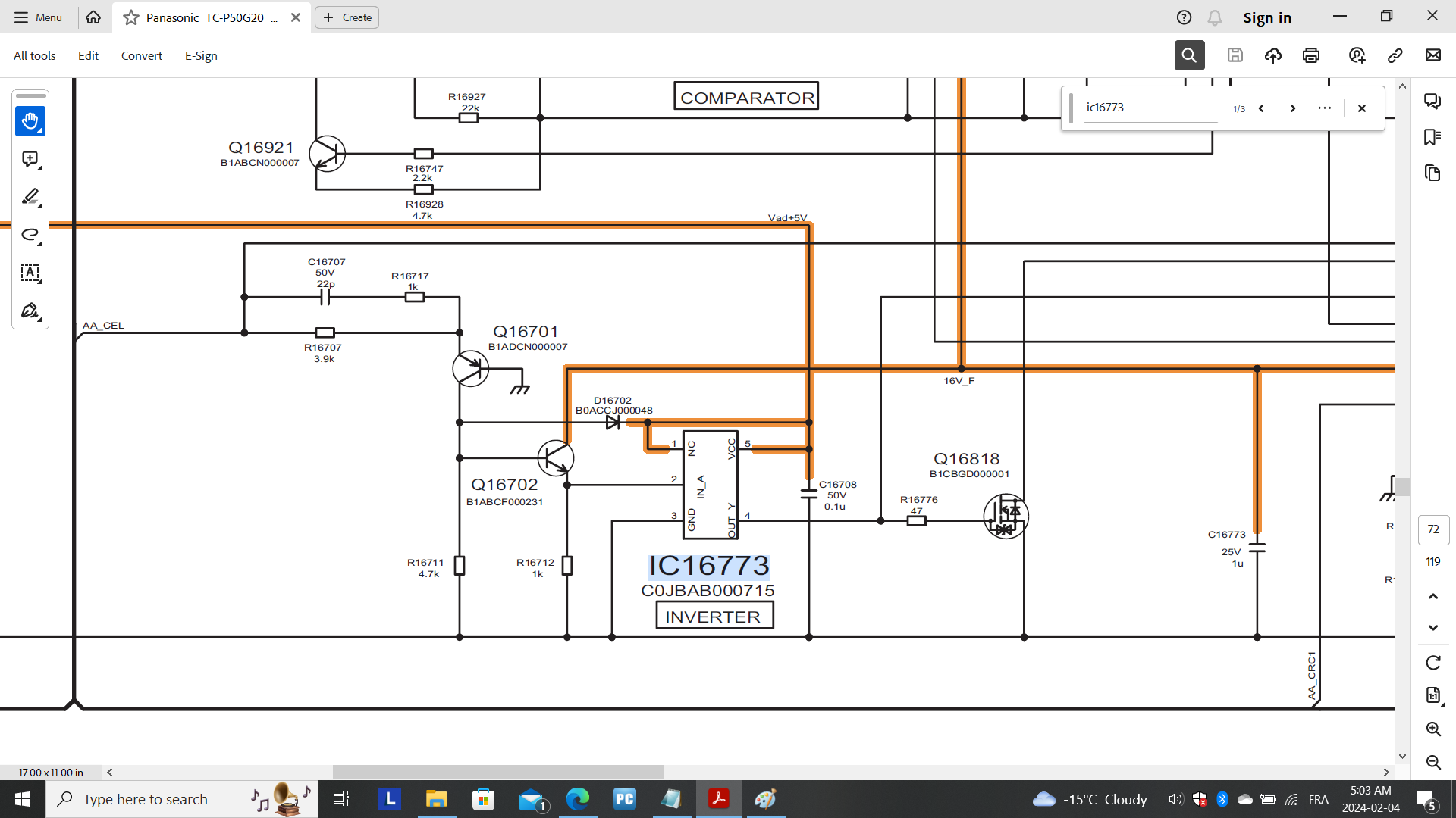

    I traced down the problem to the SOT23-5 Inverter IC773 (marked HA on its case, and IC16773 on the schematic). The chip receives a supply voltage of 5 volts but it receives 16 volts on its input. This is what I measure on the board, and this is also what I see on the schematic.
    I think that I found the data sheet of the IC773 chip. It should be a TC7SH14F. Its max input voltage is 7 volts. This is not a surprise that the chip will short out when it receives 16 volts on its input.
    Did you already had problems with this chip? What would be the correct replacement?
    Thanks.

    Yes, everything is correct, this is C0JBAB000715 IC(16)773 "TC7SH14F"

      Thank you for confirming the part number. But can you explain why it is shorting out immediately? I just don't understand why there's a transistor to pull the input to 16V_F while the input is only rated at 7 volts.
      The schematic matches the board. And effectively I measure 5 volts at pin 5 VCC and 16 volts at pin 2 IN_A. Does it mean that this is a design flaw? Or that Q16702 is not supposed to be turned on?
      Maybe I'm wrong to assume that 16V_F is 16 volts in reference to VAD. Can someone confirm?
      Another question, can someone explain me why the base of Q16701 is connected to ground?

        any _F = floating ground, which is a ground specific to plasma sustain voltages in the tv, it's the same as probing the screws that go into between SC and buffer boards.
