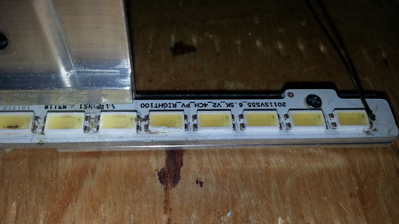

            I can't say for sure but it looks like these led's on the strips are secured with thermal glue. If I place an exacto knife edge on and apply some force I can pop the sucker off the board in one piece. I've ordered some thermal glue as I only have thermal paste atm. When it gets here I will see about making a proper type repair.

                    Part no. on led strip with 100 led's is 2011svs55-fhd-5k6k right--if any find the supply source I would like to know. I really think these led's open up and is the source of the blinking light problems we're having. They are almost impossible to replace one at a time. They are wired in series and one goes out they all go out. result blinking light. this set I'm working on is un55d6050tfxza samsung

                        You can pop them off with a knife. I'm going to use thermal glue to cement good ones back in place and jumpers to wire them together.

                                Do you have the dimensions? you may be able to install 2 or 3 LEDs that are not the same since the circuit uses constant current source, so you get the highest rating you can get, the Vf will be close enough so the total voltage drops on the string will be about the same (instead of bypassing the bad LED), just have to find one that fits the footprint.

                                  I can try to measure the dimensions. The other clue for my string anyway is the 6.5k designation which is probably colour temp. I measured 3.6v across one in operation. That's about all I got.
                                  I have probably 75 or so good leds so depending on how this repair goes I can probably apportion some out.

                                          Repaired. Again.
                                          Replaced three leds. Hardest part is wiring in the jumpers to complete the circuit because there isn't a lot of room between the leds and I couldn't make a functional solder bridge.
                                          Placed a light bead of solder paste down the back of where the leds are mounted before remounting the strip to the back plate.
                                          In the midst of a 12hour burn-in right now. Will check on them in the morning.
                                          In the first photo leds 6 and 7 from the right have been replaced.
