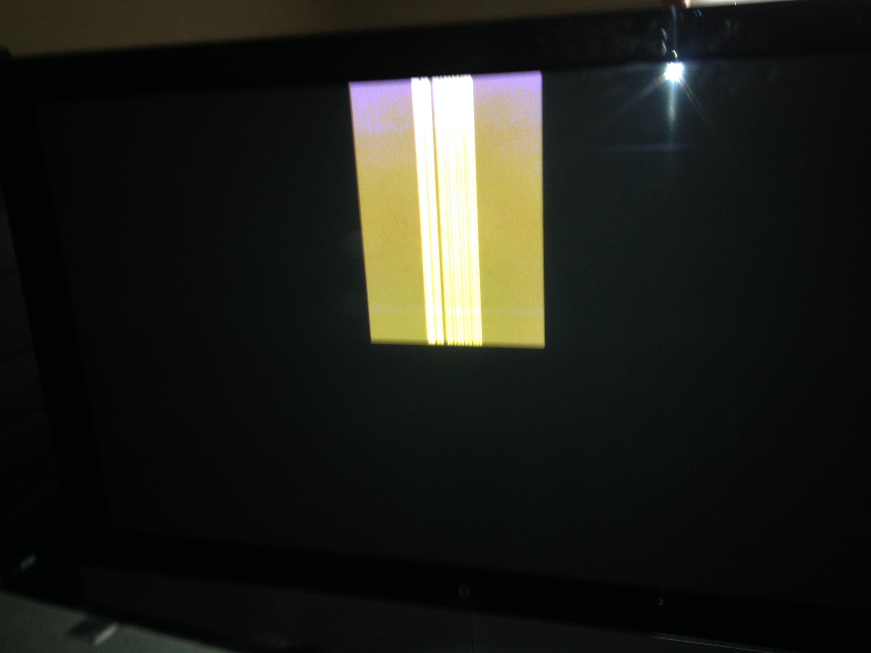

    Vizio P50hdtv10a vertical bar
    Got ANOTHER p50hdtv10a with flickering screen, replaced shorted ipms on the y board. Now I have a vertical bar in center of the screen when powered on, goes from top to bottom. I push input the vertical bar goes away, and a green distorted 8-inch box pops up in the left corner, but it is not readable. here is a picture, lower buffer is disconnected as of now, reason for only half screen.
    Re: Vizio P50hdtv10a vertical bar
    Try with both buffers installed. You probably have bad FETs on the buffers.

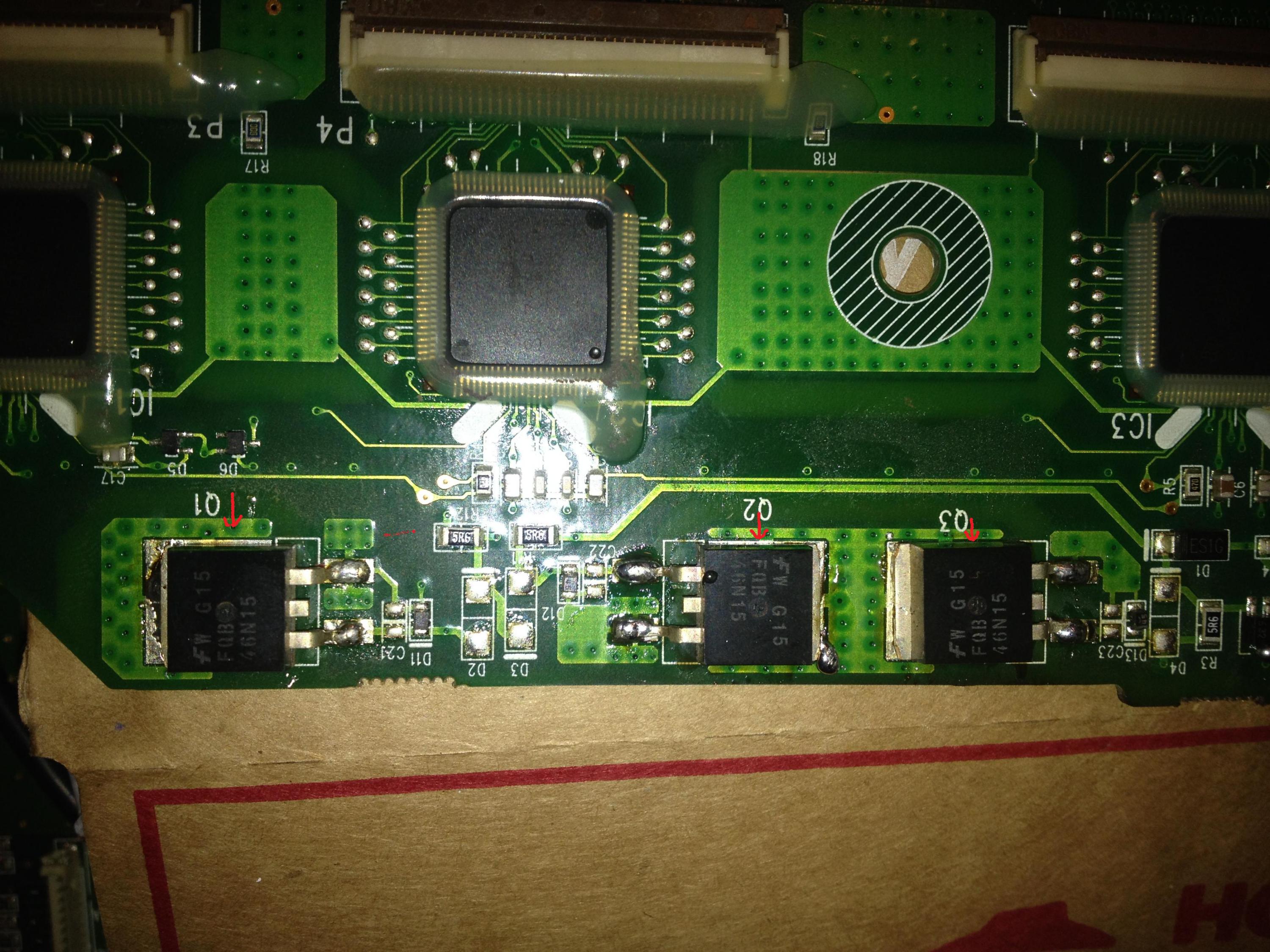

        all 3 fets on the upper buffer did not ohm out, was showing about 12 ohm each, replaced. But still have short to ground. All my ic's look good.no pin holes.
            Found 2 shorted fets after further testing, replaced them, short is gone from the buffer board. BUT, now when installed in tv, I get no picture, no screen "prime" glow at all. The y sustain is humming like it should. I dont wanna buy another y board.
