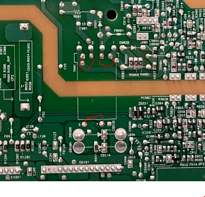

    I'm trying to troubleshoot a DPS-167DP-1 A power supply board from a Vizio M552i-B2 tv. The tv would no longer turn on, and I found the usual melting on IC901, with D950B and ZD909 shorted and R915 open. Sounds like this is a pretty common failure, so I replaced all four components expecting it to be an easy fix but it's still not working.
    I checked D801 and it's fine. I get about 170V DC across the main filter capacitor C800A. I'm not getting any voltage on the 5V standby pins in connector CN101, nor any voltage on the VCC pin of IC901, which is presumably why it's not working -- the datasheet wants 11 to 25V on that pin. Can anyone tell me where that voltage is supposed to be generated? I must have another component failed in there somewhere, but I have no experience with power supplies so don't know where to look.

                          There are three windings, 1 is the power winding, 2 is where the voltage for the PWM power supply (VCC) is generated, 3 is the output for the standby mode (+5v).

                            The markings on the transformer are below. I couldn't find a data sheet for the transformer, but another badcaps post suggests that the primary is 2~3, The vcc feedback is 1~4 Pins 5~7 are the secondary. Resistances measurements are no more than a few ohms across each pair, so I don't think the transformer is blown but it's not getting any AC voltage on 2 and 3.
                            MP-130I (01)
                            AV-DP11153 DELTA
                            DCUM 1418(06)H60
                            • nomoresonys

                                So check all the diodes and resistor and that capacitor right by T901.

                                  I can't find anything wrong with any of them. I even pulled most of the diodes out of circuit to make sure it wasn't an illusion that they were working. Capacitors seem fine. Resistors seem fine. Even the tiny resistors on the back of the circuit seem roughly correct.
