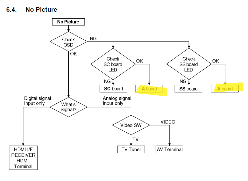

    Just picked up this Panasonic TH-50PX80U from a friend. She says a lightning storm took out her TV, her laptop, and her Comcast STB.
    Unit powers on, and the panel lights, but no video output. No buttons are responsive, even Power. After 5-10 minutes, the TV restarts. While the TV is on, I'm provided a steady red LED on the front of the TV, and a steady green LED on the "Scan Drive" and "Sustain Drive" boards.
    I've pulled both the PSU board and the main logic boards - no signs of any physical damage and no odd smells.
    Only two voltages are identified on the panel sticker, Ve (130V), and Vsus (185V)
    I've tested these voltages - test points were all on the SCAN and SUSTAIN boards:
    Ve: 129.0V
    Vsus: 184.1V
    VSET: 319V
    VAD: 147.8V
    Without anything else to go on, I'm thinking the logic board is toast - My next test is plugging in sources and see if I get audio.
    **EDIT**
    This flowchart in the service manual pretty much says the "A Board" (Which is the logic board) is suspect. Now to diagnose!

    If you are getting a screen lit but no video and buttons unresponsive I would be more inclined to say mainboard issue..

        @freakaftr8: The "A" Board is the one I suspect - with the HDMI and component connections. Did i use the wrong terminology?
        @erskine: No error codes from LED. Solid red light - which I interpret as normal.
          Re: Panasonic TH-50PX80U Plasma - Powers on, no picture (Lightning?)
          Yes mainboard. Logic board is the one that has ribbons going to the panel. That board should be ok

            The mainboard is the one I was referring to, I apologize!
            it seems that all the sources for this board (TNPH0716 "AH" suffix) are out of stock..
            Is there some sort of repair process for these boards? I don't see any physical damage.
