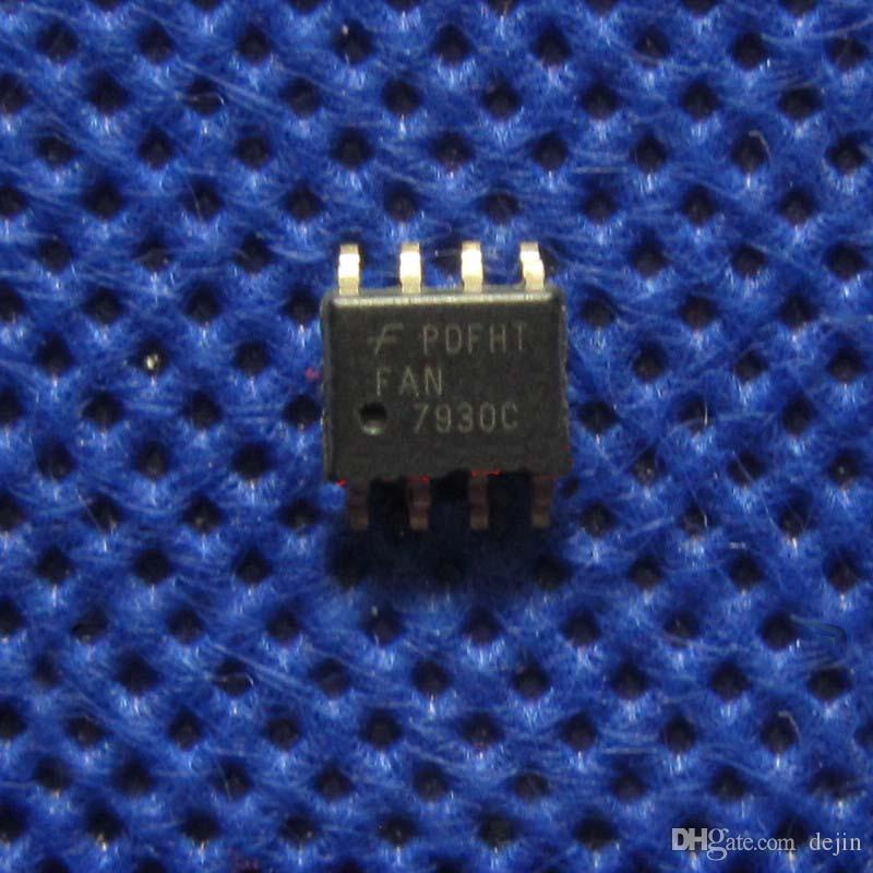

          May I ask what is the part number of IC2? Is it th e SMPS IC you mentioned in post? It seems gone on my power supply board and I need to find out its replacement. Thanks!
            #45
            Re: RCA rlded3950a-b sound but no video
            Ic2 - fan7930
