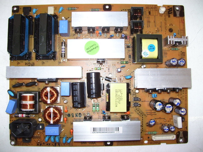

    lg 42ld550 tv
    blown fuse i removed the fuse and it reads short across in power supply bd.
  • webswan7
    • Sep 2013
    • 30
    • usa
    Re: lg 42ld550 tv
    images
    • webswan7
      • Sep 2013
      • 30
      • usa
      Re: lg 42ld550 tv
      the fuse is left of heat sink
      • webswan7
        • Sep 2013
        • 30
        • usa
        Re: lg 42ld550 tv
        repaired replaced power bd ebay 26 dollers
        • Dang
          • Aug 2013
          • 440
          Re: lg 42ld550 tv
          Some times it's just the easiest way, cheapest too.

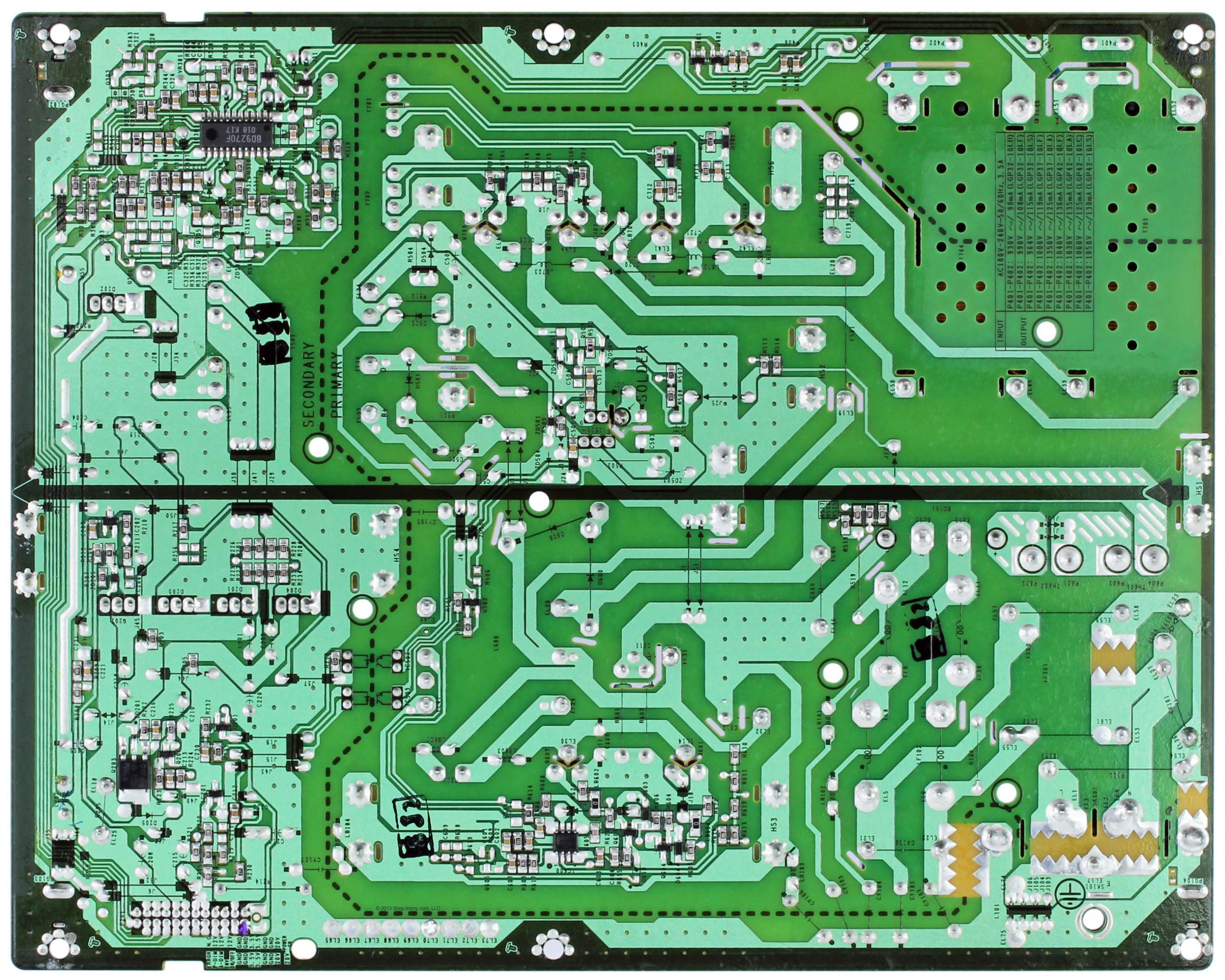

            Samsung UE46ES8000 Blown fuse but no other signs of short
            by jesterace
            Hi I wonder if anyone might be able to steer me in the right direction. I have this Samsung UE46ES8000 TV and it went bang during use. The main fuse on the PSU board is open. I've checked every diode/mosfet/transistor I can see and nothing appears to be short to cause the fuse to go. The DC output of the bridge rectifier is not short either. I've seen online that some of these models are known for having their PFC mosfet or other mosfets shorting and blowing the fuse but i'm not seeing that here. If anyone aware of these models having any issues to cause this? I'm reluctant to just replace the...
