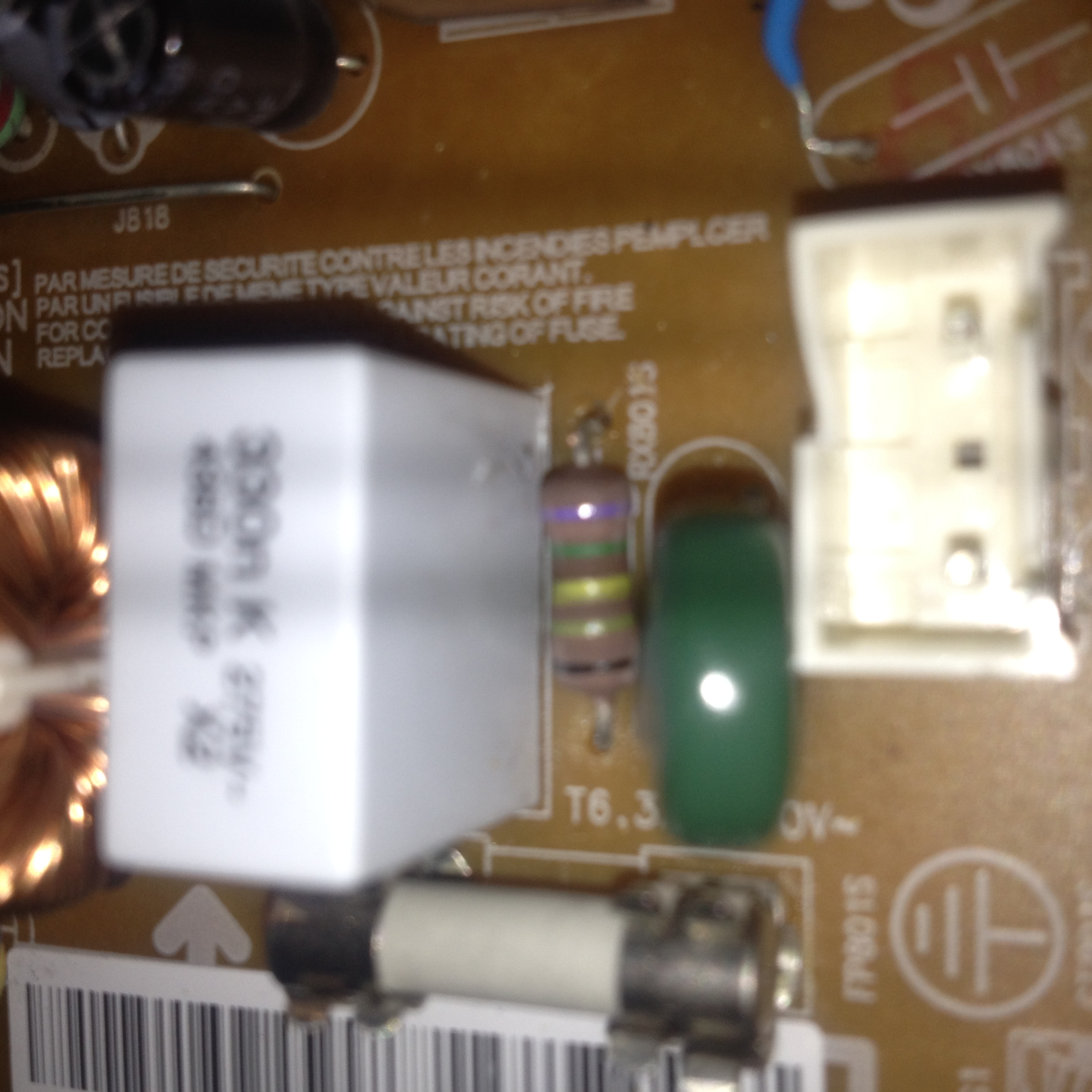

    Just out of poking around i poped out resister RX801S and tested it and the meter didnt read anything from it either way around :/
    can you post a picture or what colour bands has this got?
      Black Light Green Yellow Darker Green Purple

                  #48
                  Re: Samsung LE26A457C1D Power problem, It Banged
                  unlikely colour combination see here
                  http://www.hobby-hour.com/electronic...calculator.php
                              best guess on the resistor is violet green yellow gold black
                              750kohms based on 4 rings
                                  Sounds about right - only purpose of that is to discharge the CX### capacitor next to it - it's a safety thing to avoid a shock from that.
