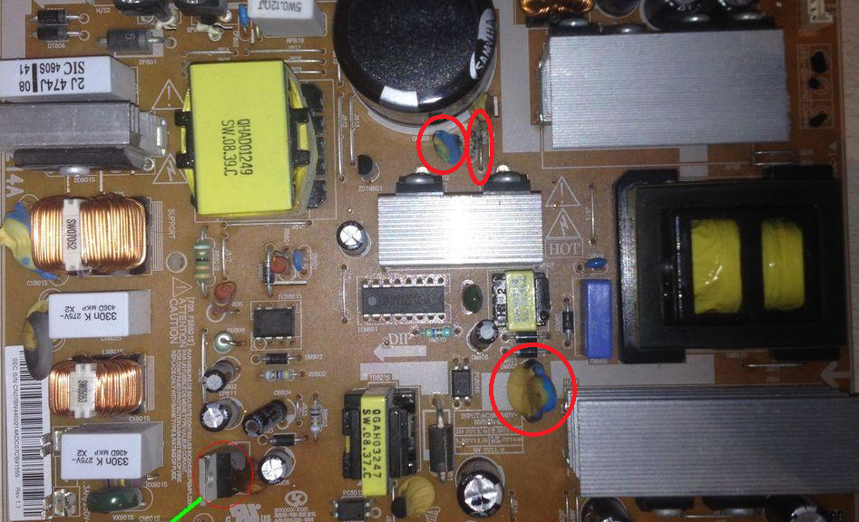

                                • coreyand
                                  • Nov 2014
                                  • 88
                                  #76
                                  Re: Samsung LE26A457C1D Power problem, It Banged
                                  I just repaired this tv by replacing the 222k 1kv sm small cap by the big blue cap, and replaced the jumper next to it, as well as the other blue cap ( i dont remember the numbers on it but its circled in the picture ) And the tv is back to life now. Pretty easy fix for me this time.
                                  Attached an image of replaced components.
