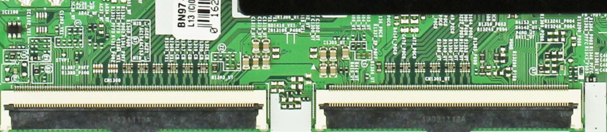

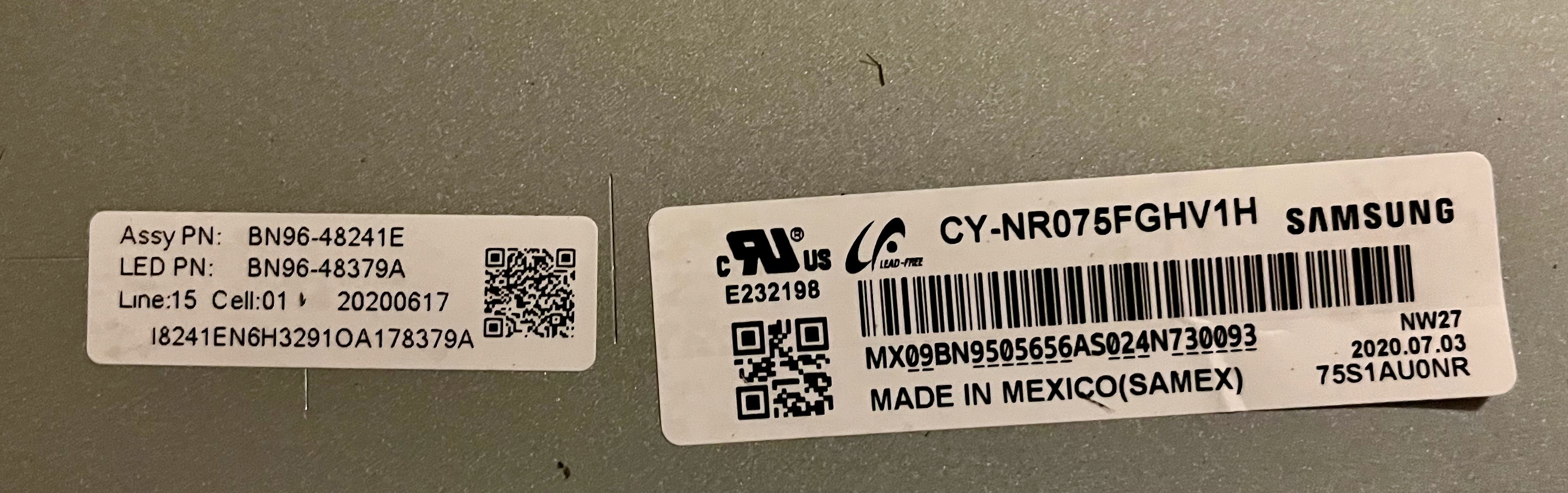

    Got a CA02 version without all the boards. LCD panel not cracked but unknown condition. Backlight seems to work with LED tester.
    Board sets cost 2/3 price of the TV. Found a FA01 version board set for good price. ShopJimmy doesn't show FA01 CA02 as interchangeable. main board numbers between 2 versions are different but t-con to panel connection appears identical. LCD panel PN is 1 letter different.
    Version CA02
    LCD = CY-NR075FGHV1H (letter H)
    main = BN94-14163F (shopjimmy link)

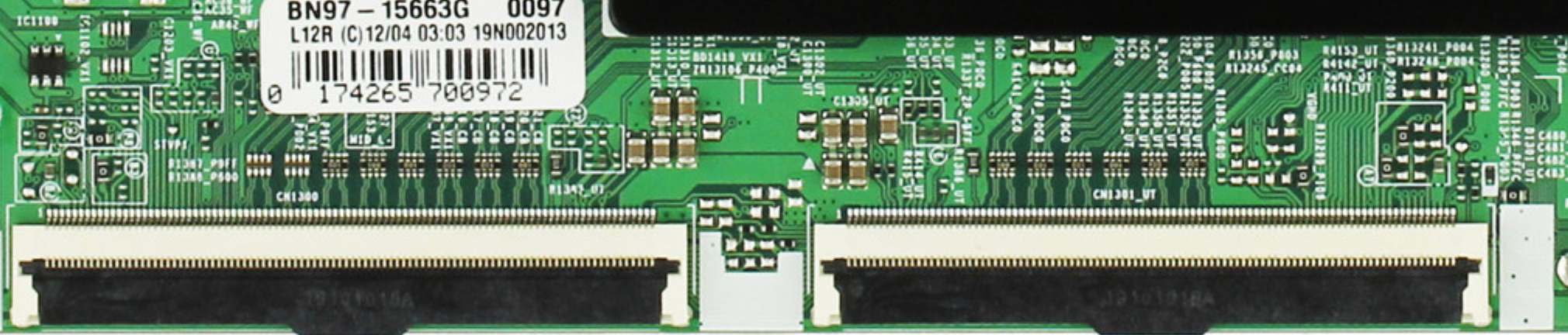

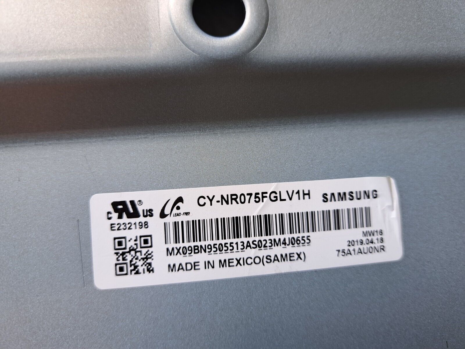

    Version FA01
    LCD = CY-NR075FGLV1H (letter L)
    main = BN94-14004D (shopjimmy link)

    Anyone know if FA01 main board can be used with CA02 panel?

          Thanks. Just to confirm, you have 2 different model TV (GU-75TU6979 and GU-75TU7979) with identical LCD panel and different boards?
          In my case, panel between CA02 and FA01 differ by 1 letter. Main t-con output connector circuit looks identical. Maybe likely interchangeable but thought I confirm before gambling on the replacement board purchase.
          • Diah
            • Feb 2013
            • 6421
            yes exactly.. if yours panel fine will work straight.... but its gambling not on my boards but on yours screen with out boards 99.9% its rubbish LCD and owner sold the boards
