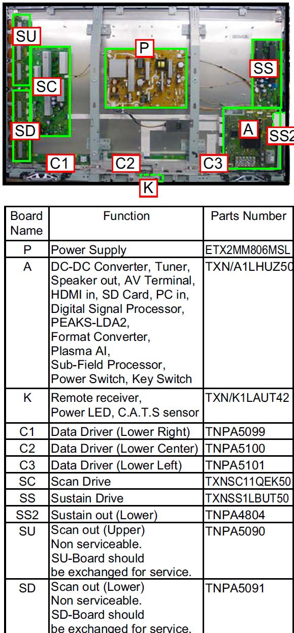

    When tv is plugged in a relay clicks twice when I hit the power button standby light blinks 10 times and nothing happens no power no sound. Anyone have any ideas?

    Must be the week of 50" G20/25 issues, I think your the third one. SC boards fail in these, can cause SOS10 & SOS4.
    Could try disconnecting SC2 at SC and see if it changes, there's a guide in a recent post 2010 G20/25 FHD Plasmas with plenty of steps to try. I'll check which one, just uploaded it again today.

        I unplugged the ss board I believe and it stayed 10 blinks when I unplugged the board I believe u said it went to 7 blinks
            No, SC board, LHS viewed from rear.
            let the power bleed off before reconnecting or measure it at the Vsus connectors otherwise the 200v that's sitting there may spike something.

                    The layout, New Zealand model but essentially the same, slightly different SC part number and A boards are different but it's what's you should see.

                      Yeah ok looks similar unplugged the sc board and had 7 blinks and unplugged the ss board and still had 10 blinks.

                              Which is the sc2 its not on ur diagram?
                              • tw2005
                                • Oct 2011
                                • 6458
                                Re: Panasonic 50" tc-p50g20
                                If you disconnected the Sc board, was it the 2 wire power cable from the PSU to the SC that was disconnected? That connector is SC2. There's only 2 connection going in, the white ribbon (SC20) P5V,P15v, data, SOS6,7 etc goes on that, Vsus (200v approx) goes in on SC2, it's the pins on the SC at SC2, cable removed, check that's there's no residual voltage at the pins, the caps on the Sc board may still be charged.
