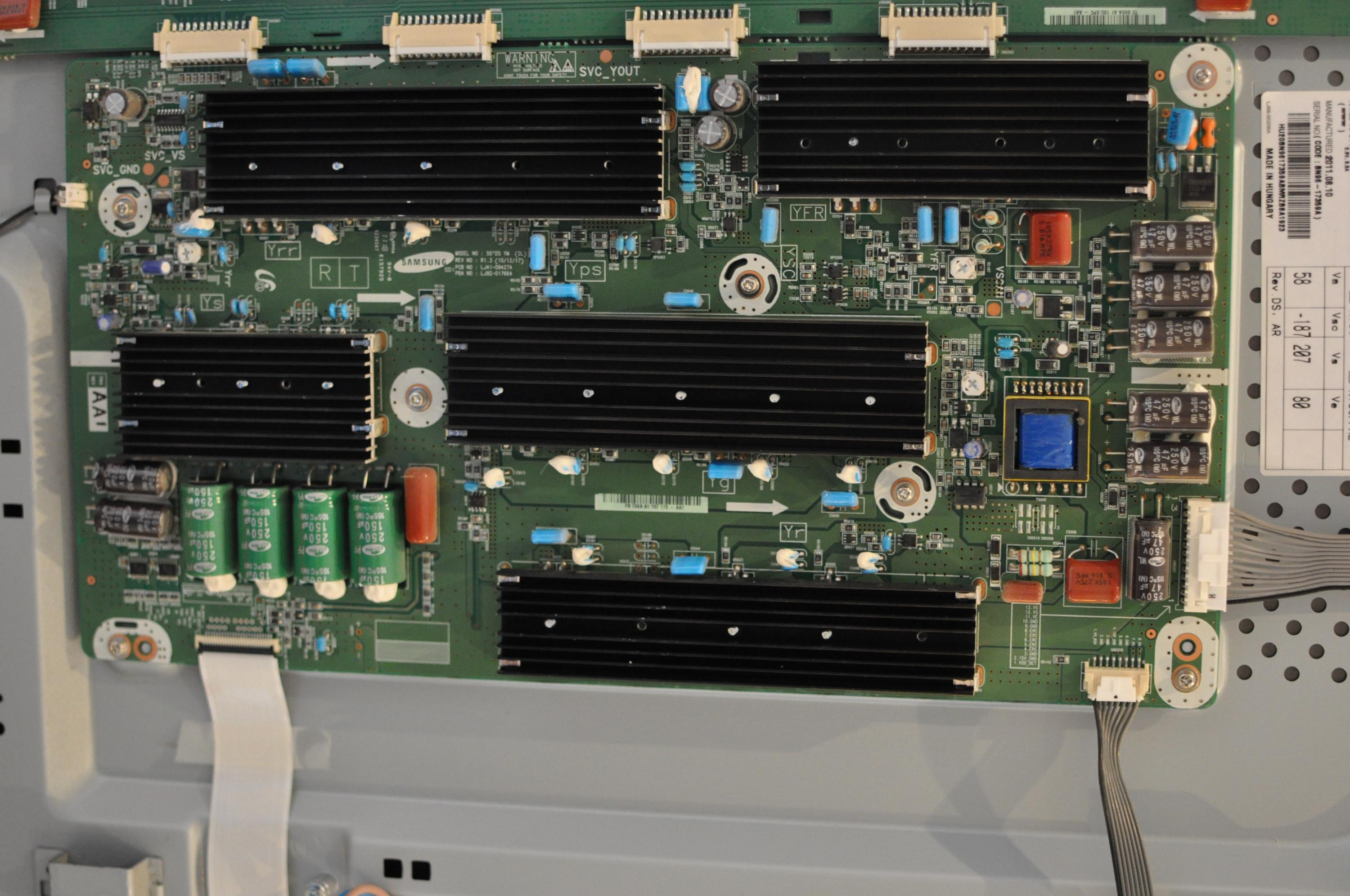

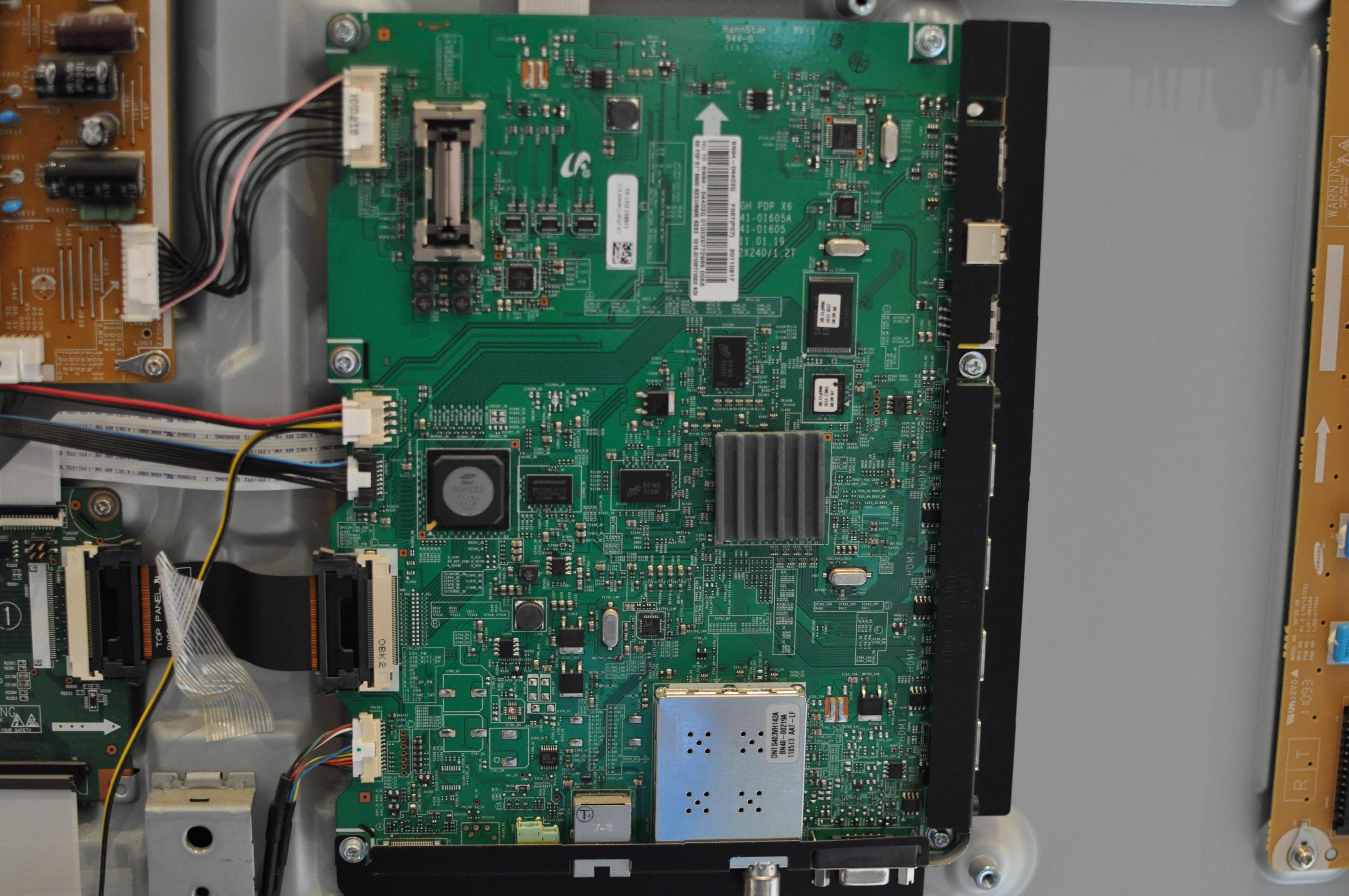

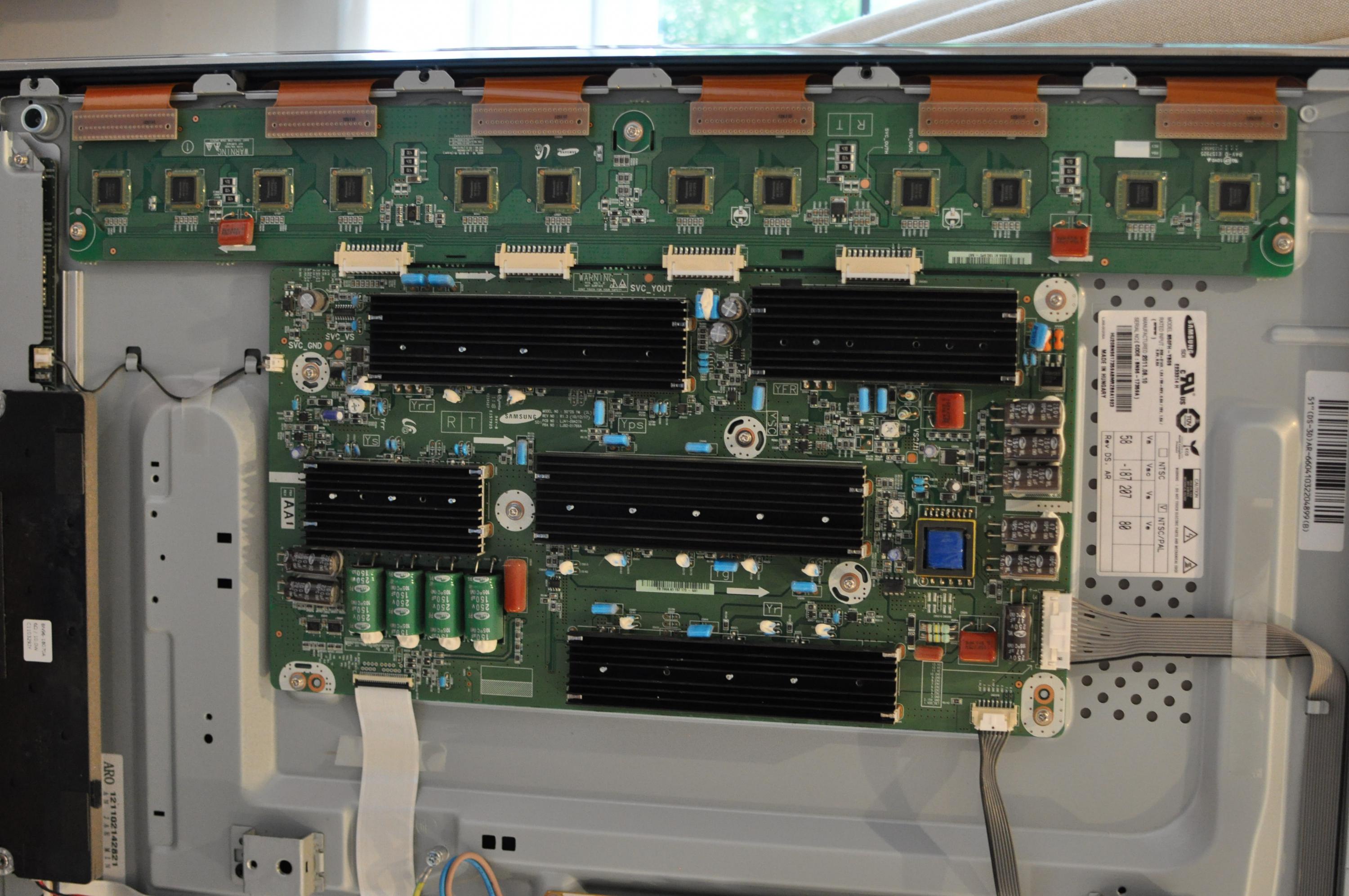

    Can you post a picture of the boards in the chassis?

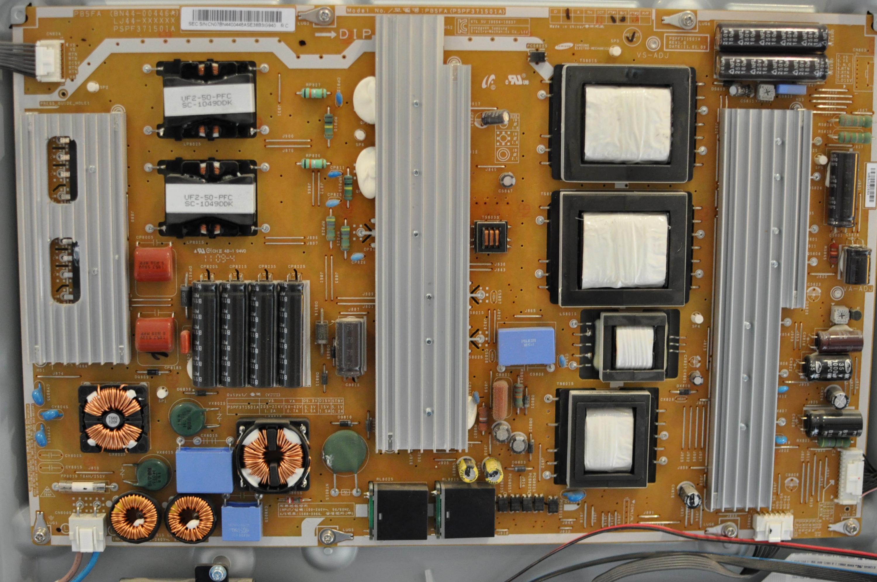

          Hi Tom,

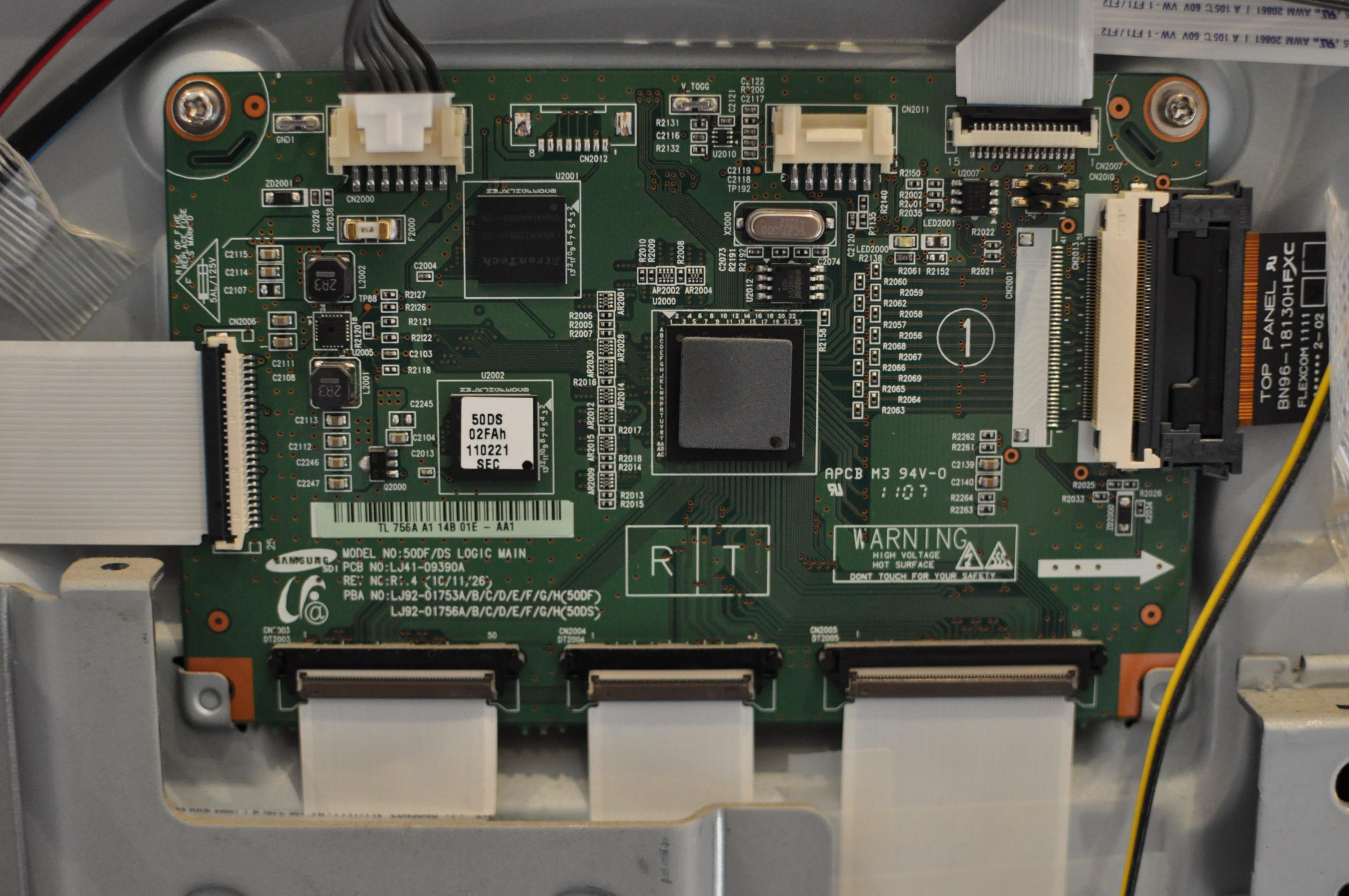

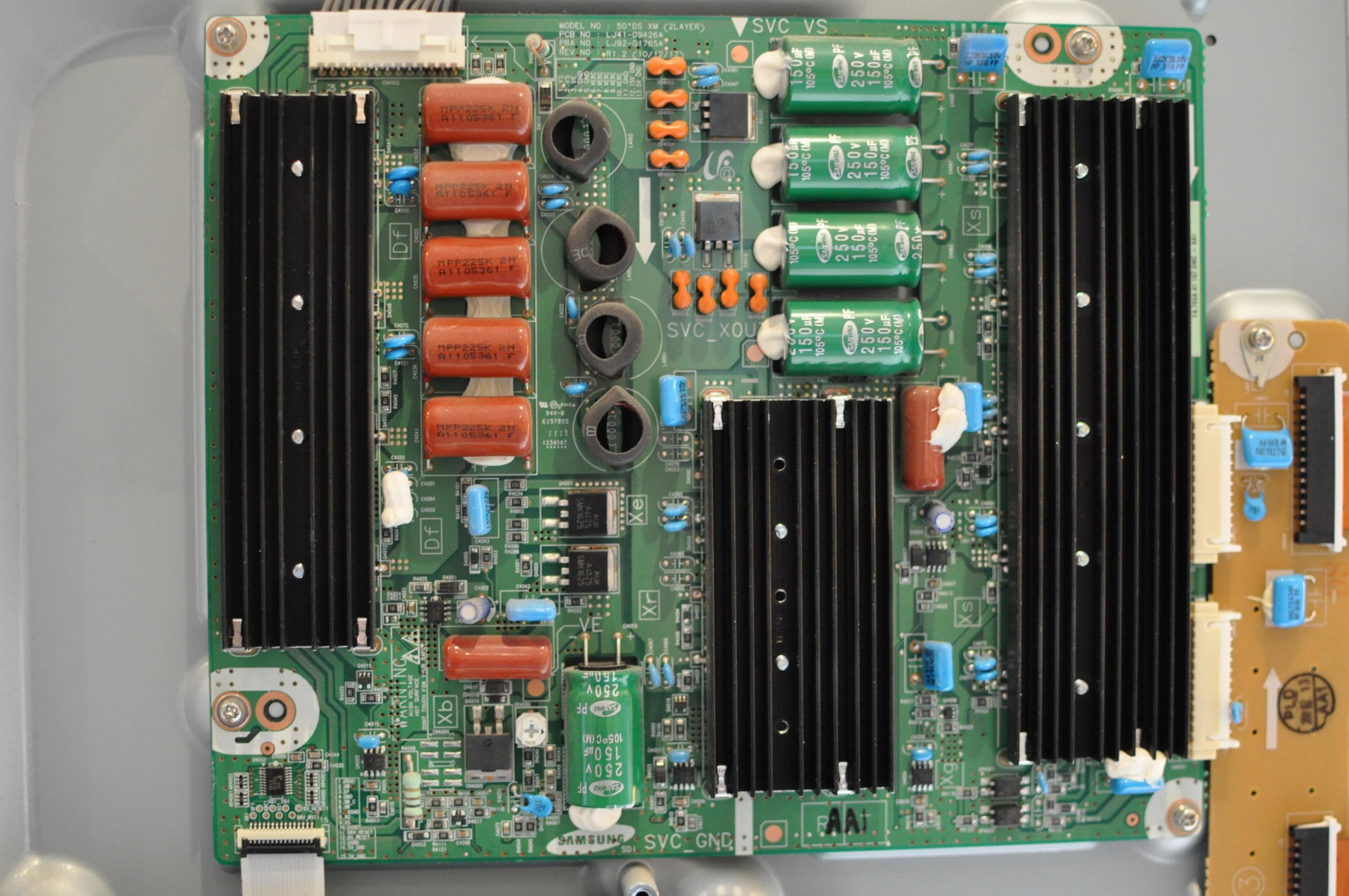

          Please see attached photos of boards.
          Thanks and regards,
          steve

              Re: Samsung PS51D6900 will not switch on

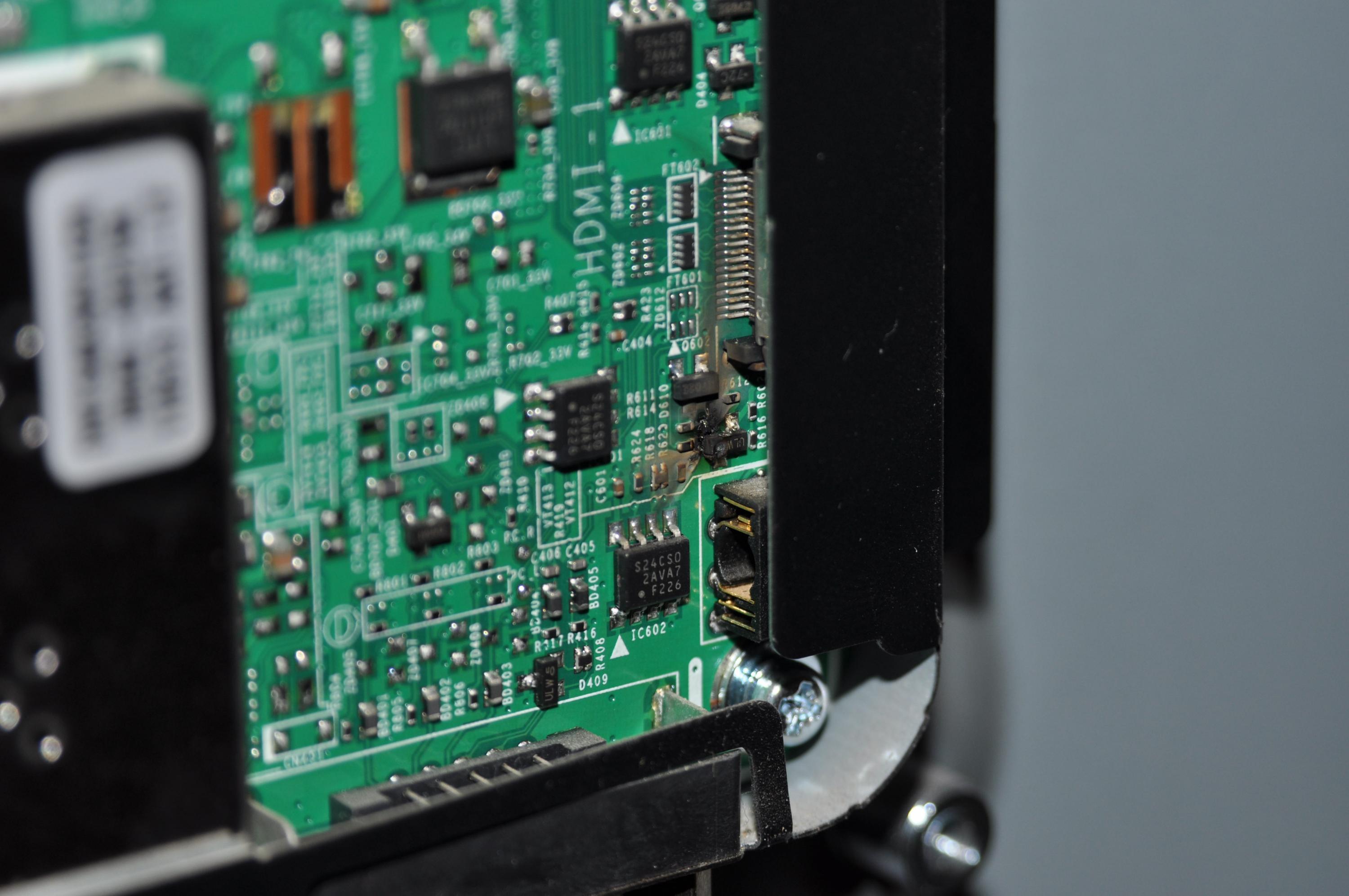

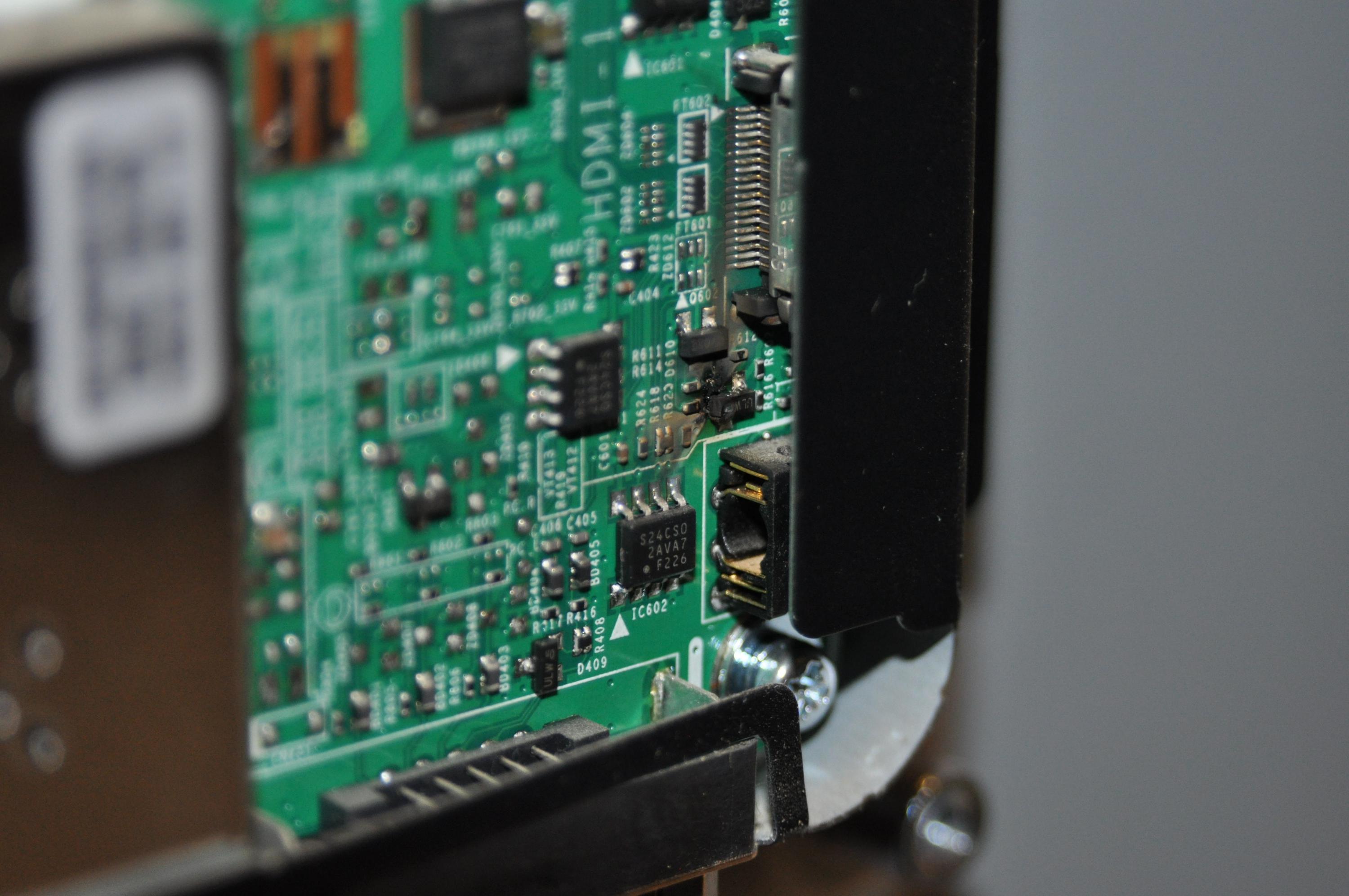

              I have taken a more detailed look at the power and main boards and found the attached damage to main board.
              Steve
                As I expected. The damage entered through the HDMI port.
                Can you confirm if there is a light on this board and if it is flashing:
                https://www.badcaps.net/forum/attach...6&d=1388574388
                if so, does it flash about once a second, or about once every 5~7 seconds?
                And, in a dark room, that is nearly pitch black, can you see any glow emitted from the display (though a Series 6 2011 Samsung may be quite dark...!)

                  This is HDMI 1, which is the port that was connected to the TIVO box.

                    Yes, there is a light flashing on this board at about once per second, and there is a faint glow coming from the panel.

                      Can you clean it up a bit and see what is left are the components paralleled on a HDMI 2
                        If those components are bad, I suspect that the main processor is completely fried; they're intended to protect that port and they've been completely destroyed in the process. The fix would therefore involve replacing the main board as the damage is probably too substantial to repair. I suspect the main video processor will have been in the very least badly damaged.
                        However, since the panel has a faint glow, it looks like the only fault is the main board.
                        So, test patterns can be activated:
                        https://www.badcaps.net/forum/showpo...61&postcount=2
                        The test pattern jumper is CN2010 on the board with the flashing light. The LVDS cable is the orange one with TOP PANEL printed on it.
                        If these are good all you need to do is replace the main board:
