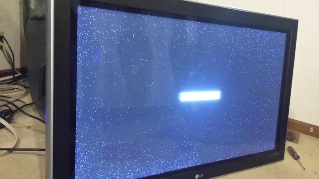

    This has been kinda interesting tv I've had a kicking around the house for the last year and I decided to finally tackle it it uses the P 42 X 2 panel and it had a bad control board the normal red stripes vertical issue. I replaced it with the control board that I found on ebay even though this control board is known for a bad soldering connection underneath the IC I took a shot and used it anyways well the TV work for the first few seconds and then I noticed the screen got all white mal discharge looking and then the Ysus popped
    what ended up happening is it managed to blow Q51. It's a 2SK2673 mosfet along with R79. I replaced all the components that shorted but yet I still have Issues. I have replaced that control board with a known good one and still have issues mainly as soon as you powered on you have really bright sparkles definitely mal discharge also the no signal banner on the screen is all white any menus that pop up all white you can't read them. looking at the circuit the MOSFET that blue controls Yramp. has anyone had any experience with this Ysustain board? It's a LG 6871qyh030c
    sorry I have typing issues my phone is totally messed up after I did this software update To android jelly bean 4.3
  • freakaftr8
    • Oct 2012
    • 3743
    Re: LG MU-42PM12X ysus issue
    Btw if I leave it on it will blow Q51 and R79 again.
    http://i845.photobucket.com/albums/a...ps3d7c0d2a.jpg
    http://i845.photobucket.com/albums/a...ps1bcefca5.jpg
    It.seems that yramp is maxed out and not doing anything but the rheostat is OK and no shorted diodes.

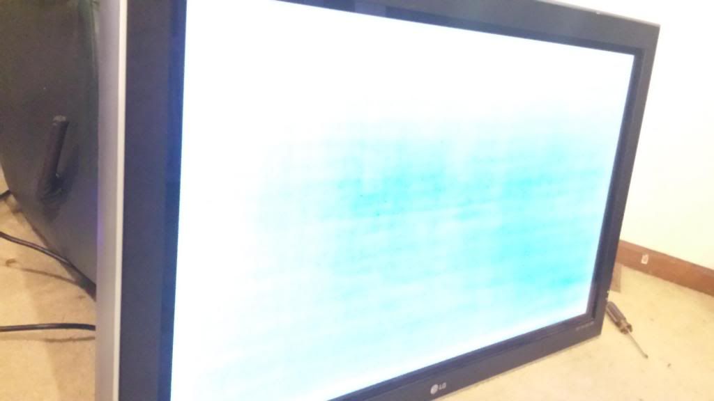

            okay well I thought I found the issue here's the deal tell me if this is weird or not. Well of course its weird I wouldn't be posting it duh.
            my new Lower buffer bored does the same exact thing. with just The upper board connected the screen looks perfect as soon as I Connect the lower buffer bored the screen starts getting all Mel discharge looking and the white no signal starts flickering pink and white almost like in sync with a frequency cycle of some type. I know if I leave the lower bored in and allow it to keep doing this it will blow the y Board again.

                    yes I have A scope. My father in law is borrowing it at the moment. I have tried the TV with just the lower buffer in place and I get the same result. Quite a bit of blue mal discharge and even though I didn't probe voltages at the time because it will immediately destroy the y ramp circuit on that why board if I leave it plugged in for over 10 seconds something is amiss like a dead short. The odd thing about this is the screen is perfectly fine with just the upper buffer installed. and I thought that besides the data signal both upper and lower bored share common voltages.

                      well I went ahead and ordered another Ysus board for this Tv and what I have is a surging pulsing issue with the screen its like the screen tries to cut out every second but then comes back perfect I can't hear anything ticking or pulsating behind the TV but it will do this and Indefinitely now it won't blow anything. I've checked vs and VA and they are not fluctuating. I have a feeling vscan is. I haven't yet checked. the weird thing is is if I start detaching ribbon cables to the Panel via y buffers the picture starts to clear up and it doesn't pulsate as much until I get to about the whole bottom row of the lower buffer disconnected the pictures perfect but as soon as I start connecting more ribbons the picture starts to pulsate. I replaced the YSustain z sustain, control board and upper and lower buffer boards. Vscan is controlled by Ysus. and I don't think it's a power supply issue at least to the best of my knowledge considering that the main voltages are not fluctuating. I created a video I'll post it soon
