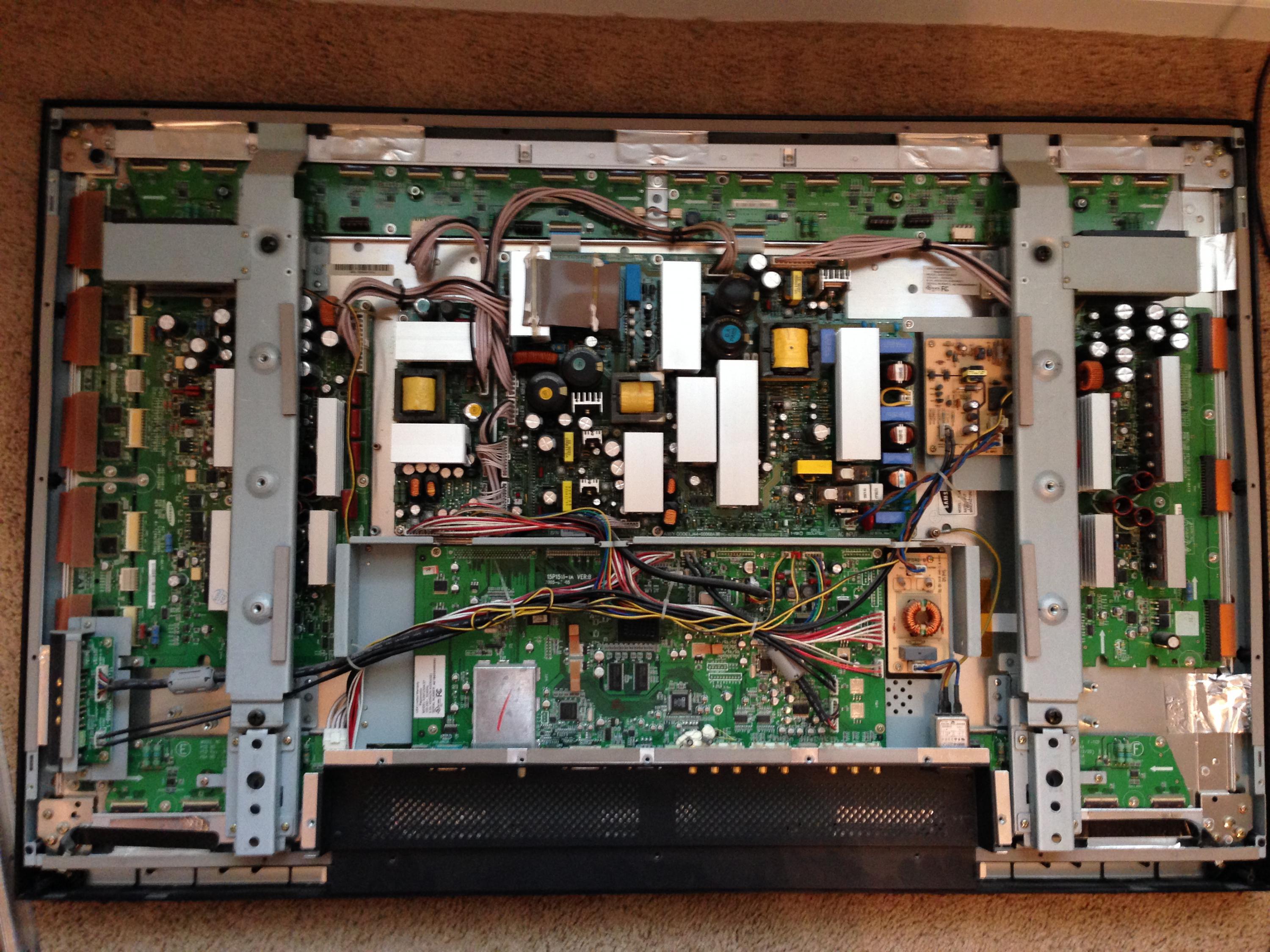

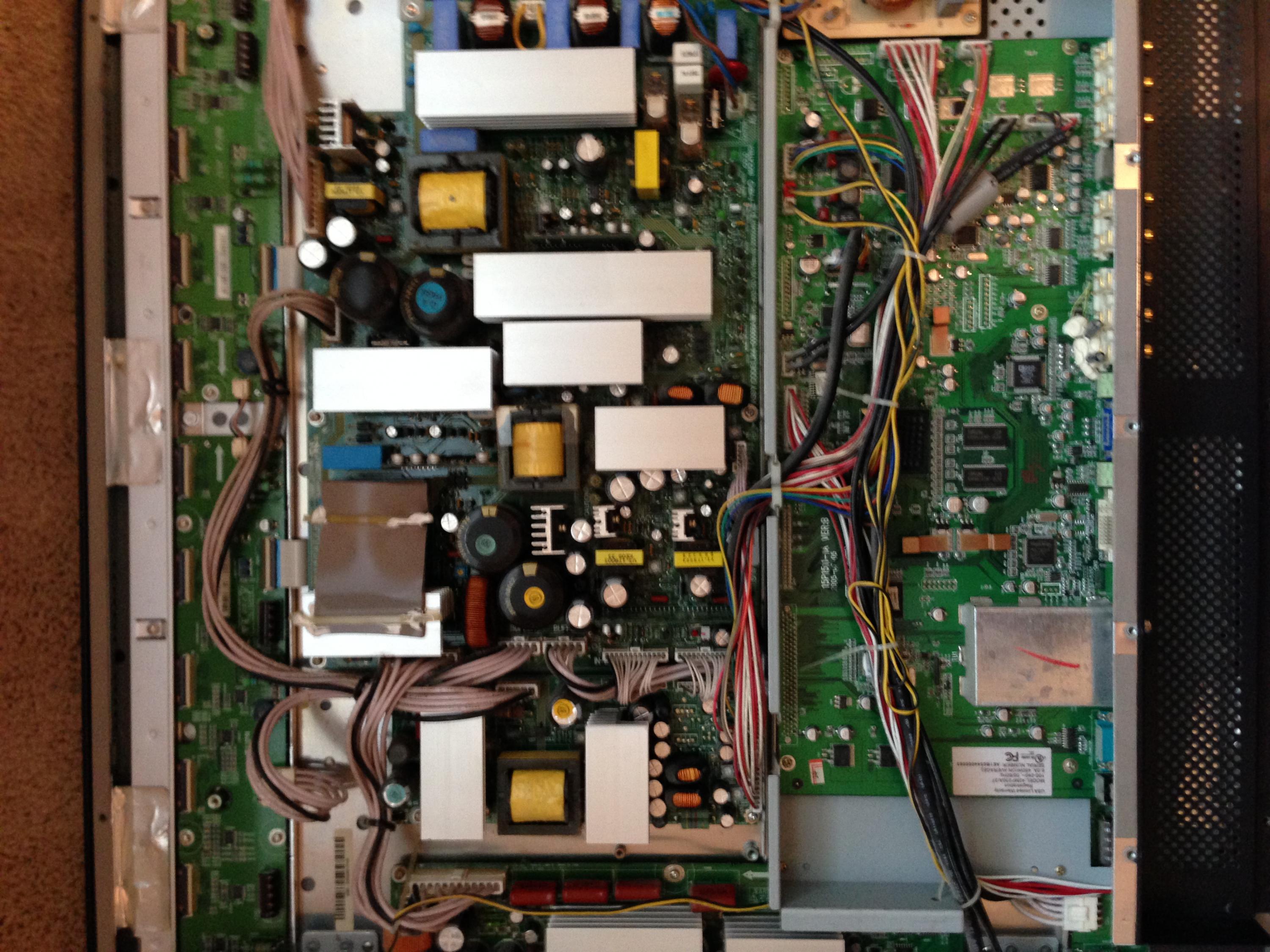

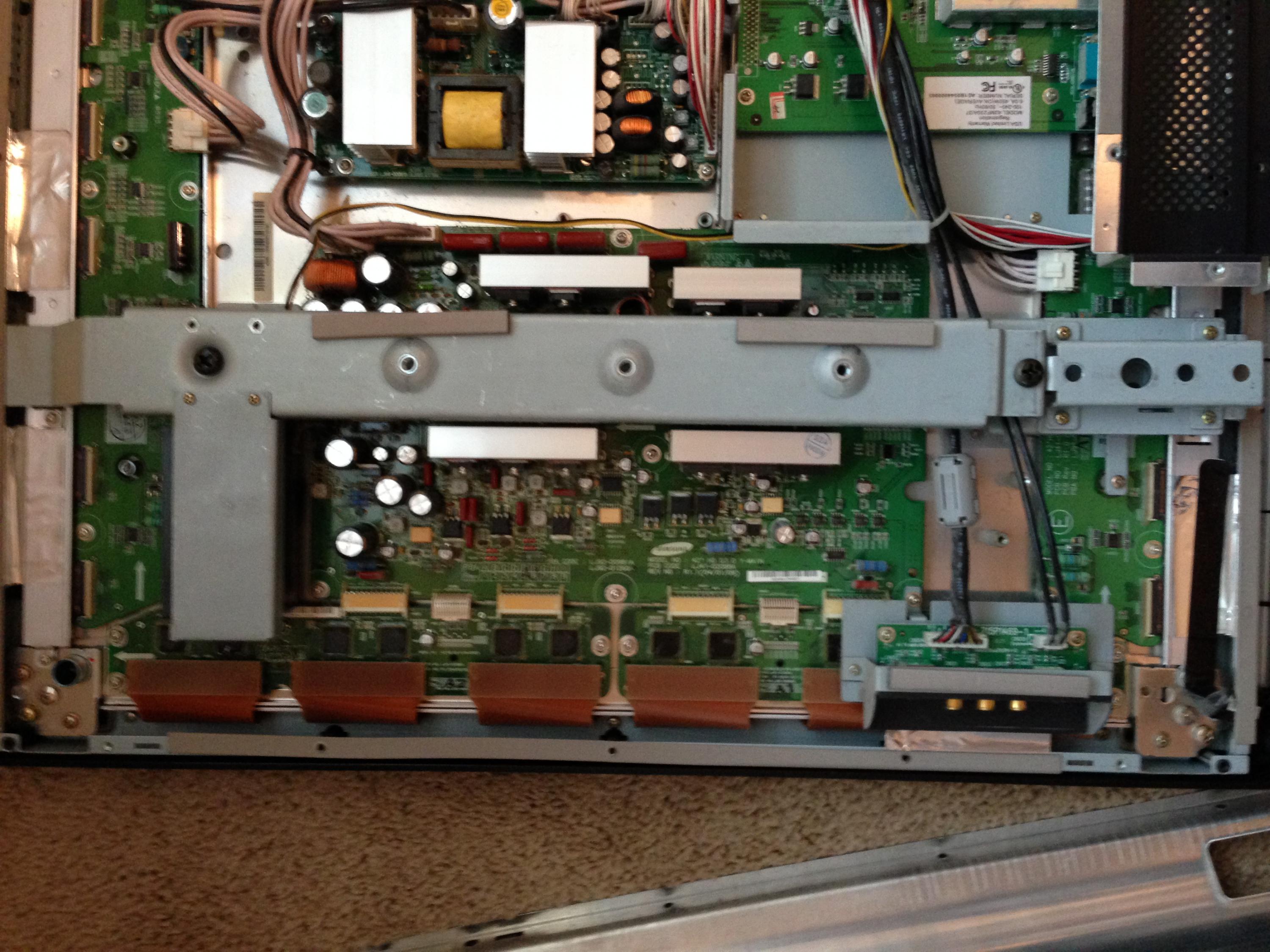

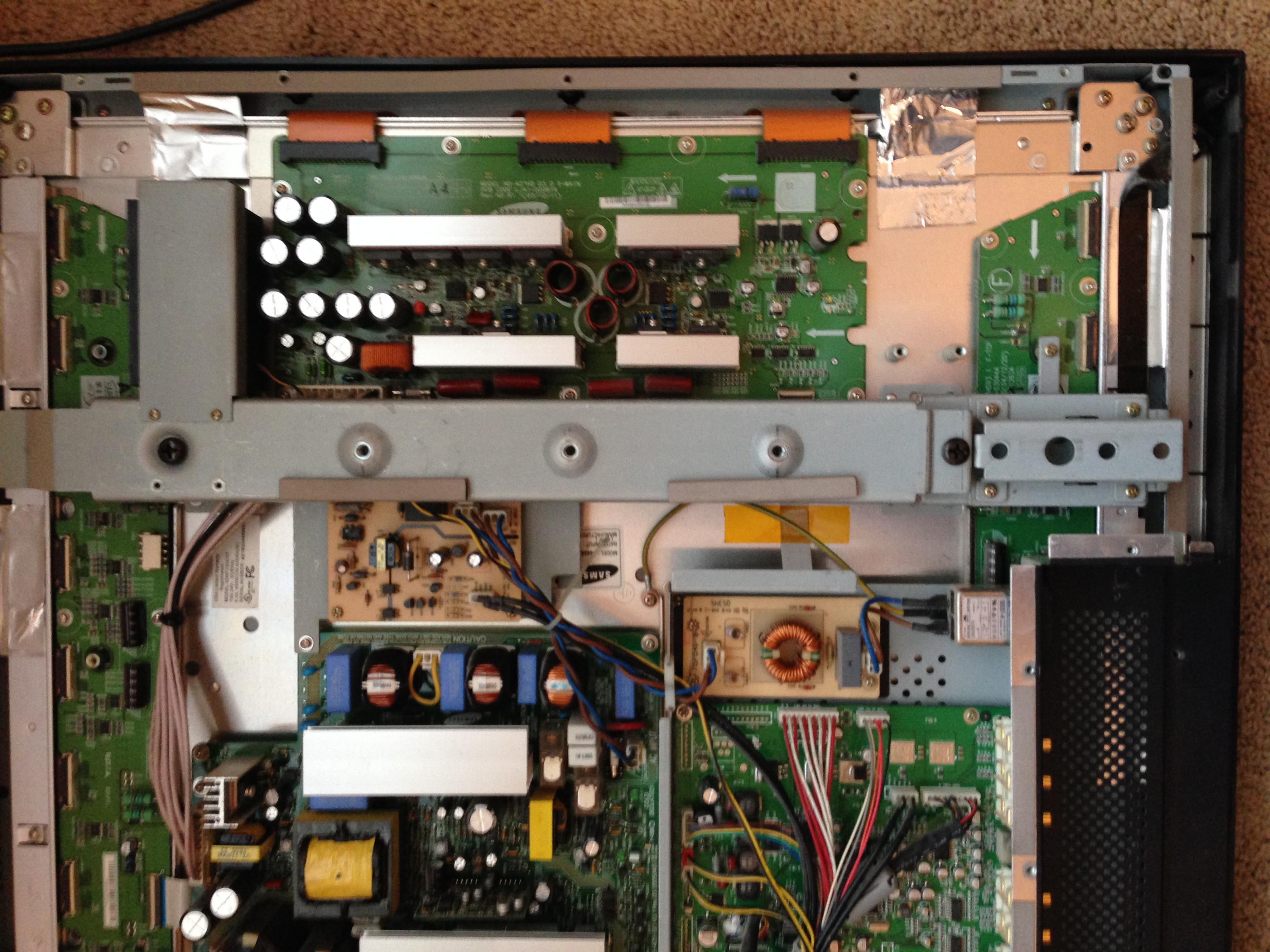

            Re: Dumpster diving found a TV - fixable?
            Ok, here are the pics of the tv opened up in the back.
              Y-buffer fault, new replacement buffer will fix it.
                Where is this located according to the pictures?
                • grizzay
                  • Dec 2013
                  • 11
                  im going to sound ignorant here but, is there an upper and lower on this one? im not 100% sure.
                  in addition, is there any chance maybe something came loose, like a cable on the "buffer"?
                  • grizzay
                    • Dec 2013
                    • 11
                    i also wanted to add that the first picture of the tv on, the distorted image will flicker for a quick second, then the whole big rectangular image will shift slowly towards the right of the tv. if i hit menu or input the distortion will appear in different areas of the screen.
                            See if you can check the Vsc and Vsch voltages on the Y-main.
                            Ysc = negative, -200V to -90V.
                            Ysch = Ysc + 70~150V.
                            • tw2005
                              • Oct 2011
                              • 6458
                              Y buffer (upper) $15
                              Y buffer (lower)$15
                              Ymain
                              Xmain
