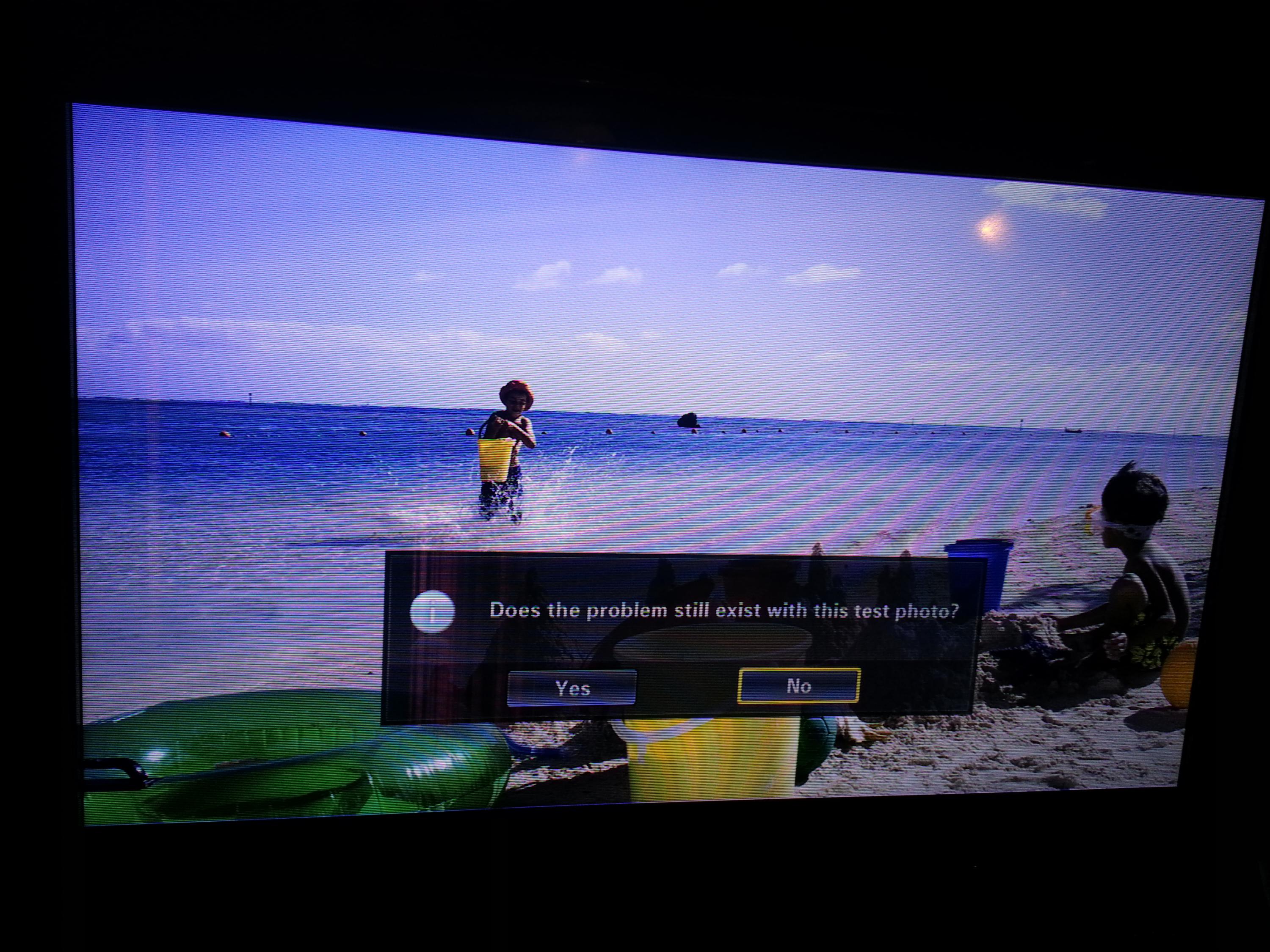

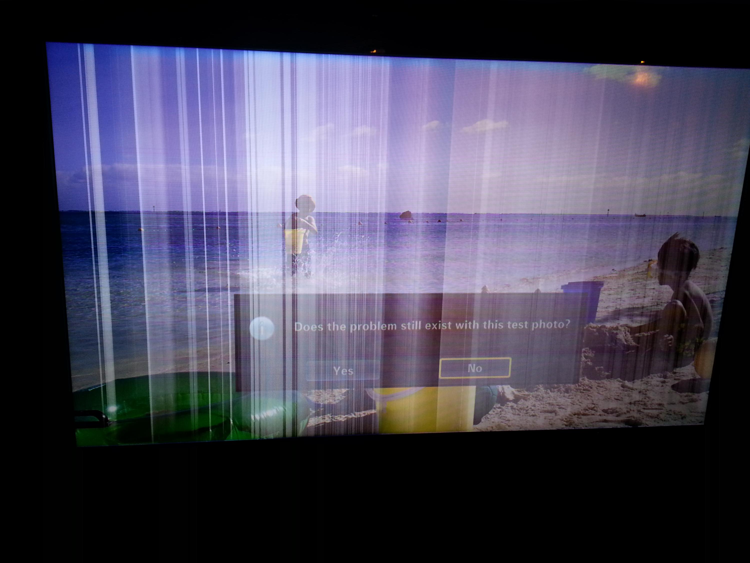

Iv a 32 samsung led tv when its turned on its fine but after a minute random lines apear down most of the screen. I checked the ribbon to the lcd and everytime I disconect and reconect the lines go away for a minute again. If this was a bonded tab issue would it not have the lines all the time?

Not necessarly, the problem ban be the lcd screen but is affected by even the littlest tracable amounts of heat on the ribbon ic or ics) affecting picture quality. Try freeze spray around the edges of the bezel especially concentrate on the top of the screen. See if the problem dissapates.Did I leave the soldering iron on? -

I dont think its a heat issue the lines are there after a minute and when I disconect the lcd for 1 second the lines dont reapear for a minute again not straight away.Attached Filesif you find these attachements useful please consider making a small donation to the site

Definitely panel, this is happening to tons of Samsungs and is a heat issue. The tab drivers have very little thermal inertia, so can cool quickly. There may be a fix for it, but it's not yet known.Last edited by tom66; 12-18-2013, 06:22 PM.Please do not PM me with questions! Questions via PM will not be answered. Post on the forums instead!
