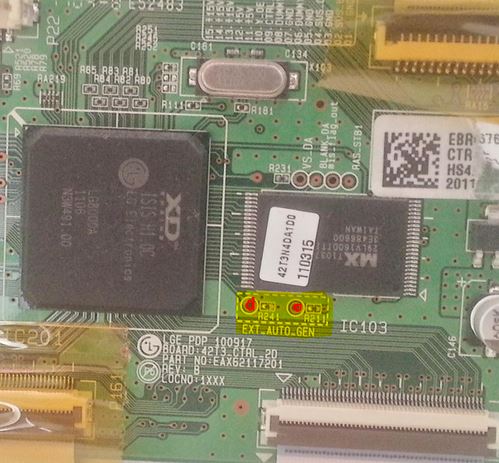

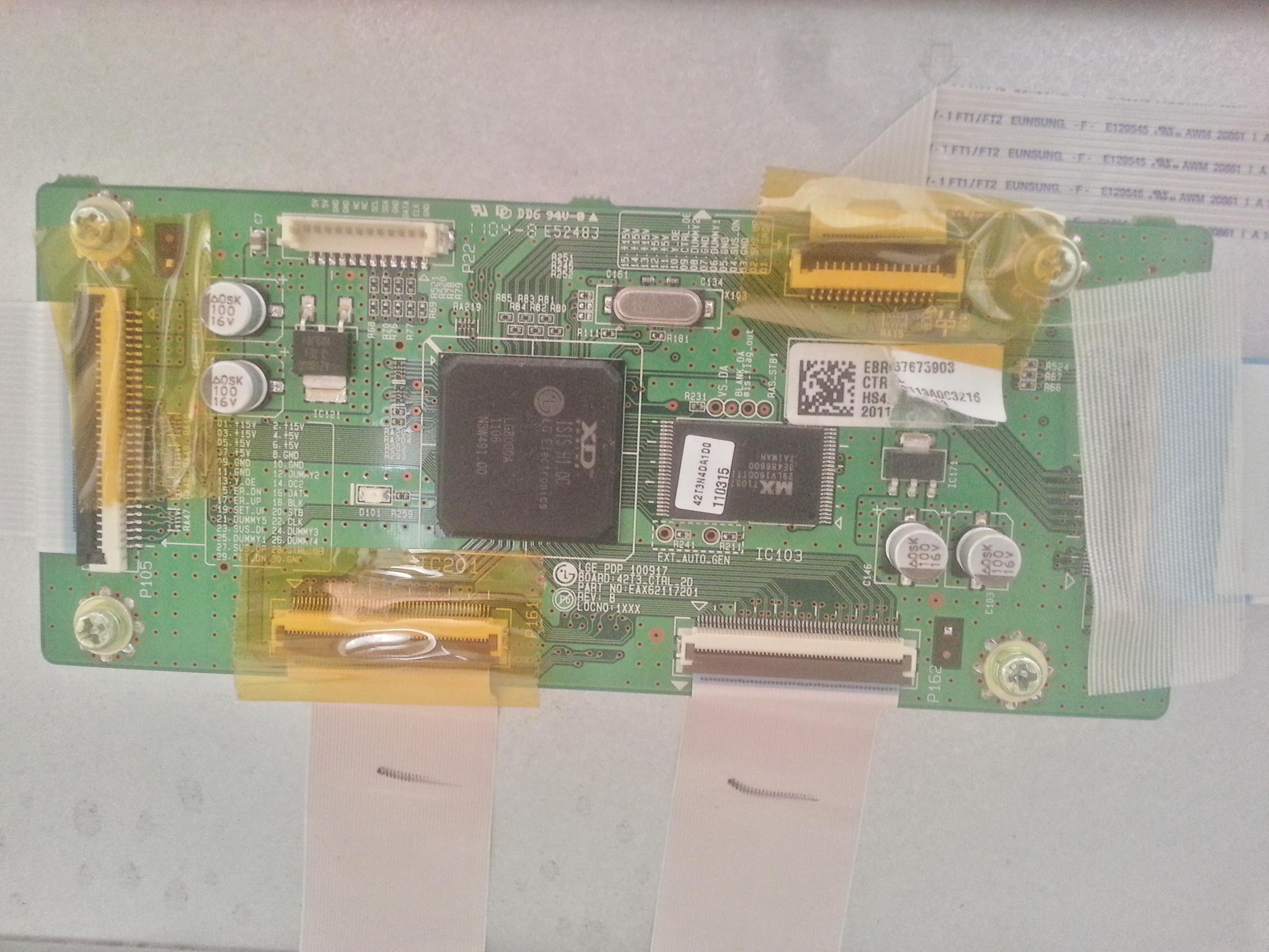

    Can you give me a close up pic of the control board
      Re: LG 42pt350 A little help.

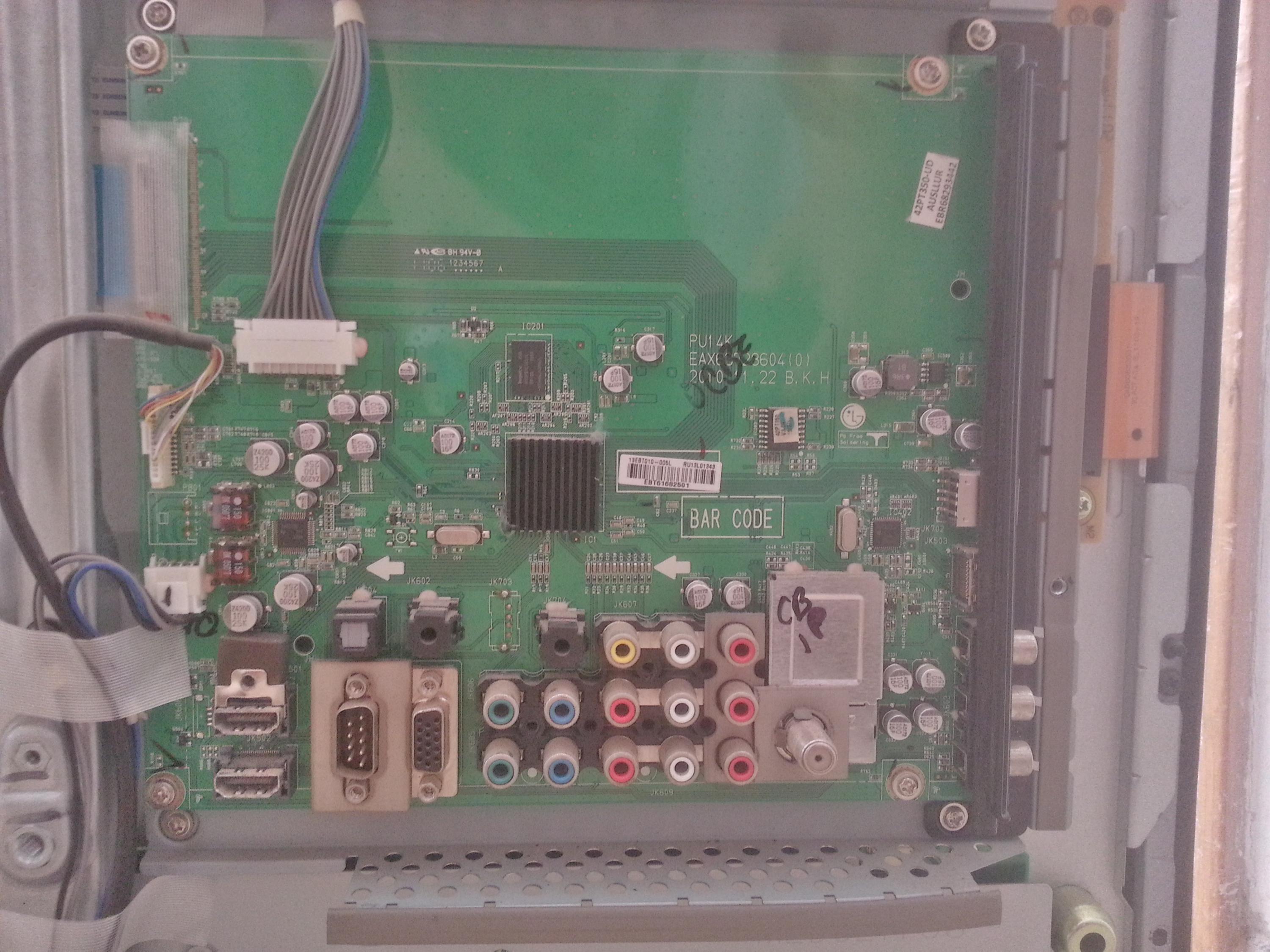

      Thanks for your help.. i'm attaching a pic of the control board and the main board.. let me know if these are ok.
        Yes brilliant.
        Unplug the TV.
        Take a piece of wire and connect the two holes marked as red in the highlighted area on the pic
        Unplug the LDVS cable (the one that goes from control board to the main board)
        Turn the TV on.
        You should see test patterns, do you?

            did the process with the wire, and still the same thing.. tries to turn on twice and goes back to standby.. thank you for your quick reply btw
              Main is probably fine then.

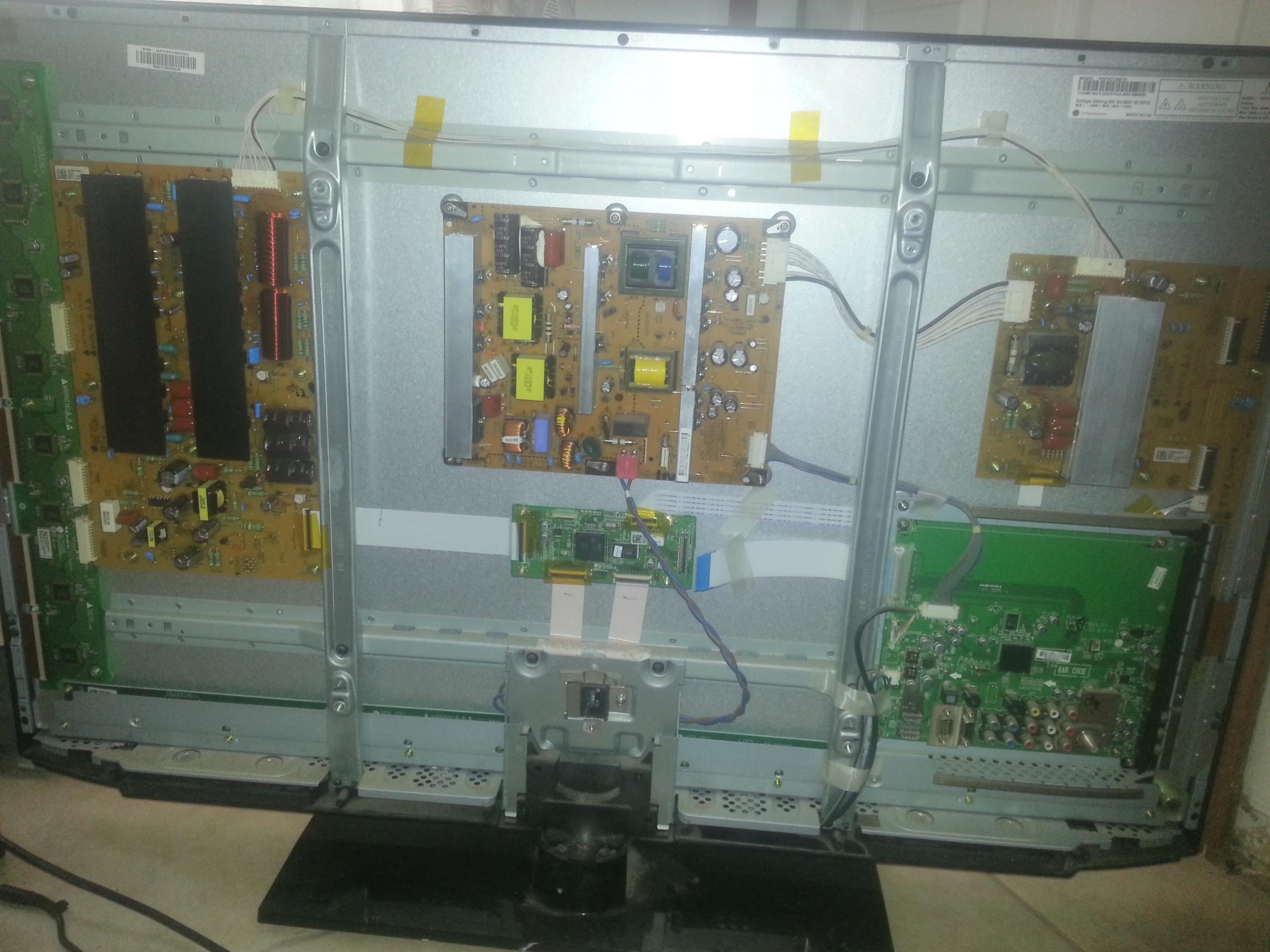

                            Thanks Tom, I really appreciate it. I found the locations I need to test through the service manual you provided. I have one question. The y-sustain feeds from the z-sustain. Is there anyway to bypass that? Or some other way to test. I attached a pic to the back of my tv.
                              Hmm, OK, I forgot about that design on this TV. Can you see what the TV does with the Z-sustain plugged in but the Y-sustain disconnected from the Z-sustain?
                                When i unplug the y-sustain board the plasma goes back to its original symptoms. attempts to power on twice and then goes back to standby.
                                  It sounds like your Z-sustain is bad then.
