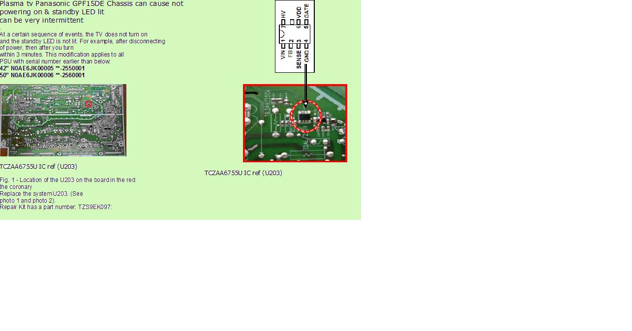

              possible solution I stumbled across.
              Plasma tv Panasonic GPF15DE Chassis can cause not powering on & standby LED lit
              can be very intermittent
              At a certain sequence of events, the TV does not turn on
              and the standby LED is not lit. For example, after disconnecting
              of power, then after you turn
              within 3 minutes. This modification applies to all
              PSU with serial number earlier than below:
              42” N0AE6JK00005 **-2550001
              50” N0AE6JK00006 **-2560001
              TCZAA6755U IC ref (U203)
              Not 100% if datasheet is correct device or proprietary for Panasonic by Fairchild.
              Does look like FAN6755UW going by the format in the sheet.
              Translated some other info.
              Some links for the IC
              http://www.ebay.com.au/itm/PANASONIC...-/160971382674
              http://www.ohmsupplies.co.uk/TCZAA67...42X50-TXP50X50
              http://www.notobsolete.co.uk/index.p...oducts_id=1209
              http://www.chsinteractive.co.uk/elec...-panasonic.htm

                      Just wanted to report that I saw the same "lack-of-standby" issue on a TC-P42X5 built in 2012 that I traced back to U203 before finding this thread.
                      If you have one of these similar models that seems to take forever after a power loss to actually "reset" and come into standby (and in this case eventually went totally dead, never came up to standby power), changing that Fairchild 6755 at U203 (a small 8-pin surface mount with one pin missing) power supply controller IC fixed the problem.
                      I ordered up 10 of them since this looks like a common problem and I know of several out in the field that I'd be likely to be the one doing service on and that this problem may well develop in some of them.
                      Easy fix, now I know exactly what to look for when it's this problem.

                                Glad I came across this forum! Panasonic TC-P42X5 plasma won't power on anymore after a power cycle. Only two year old. Checked fuses, were fine. Measured voltage at Vdd and got nothing. Figured the power board. Almost pulled the plug on a power board from eBay for $80 but decided to do a little search and found this forum. Went ahead and ordered a couple of FAN6755U (U203)from eBay for $3. Just got Em and replaced it on the board. Lo and behold, tv is up and running. Thanks Guys!!

                                  My problem is this; where is this chip found and on which board? I can't tell from the images linked above. Is it on the back of the "main" board with all the hdmi and other connectors, or is it on the larger power supply board?
