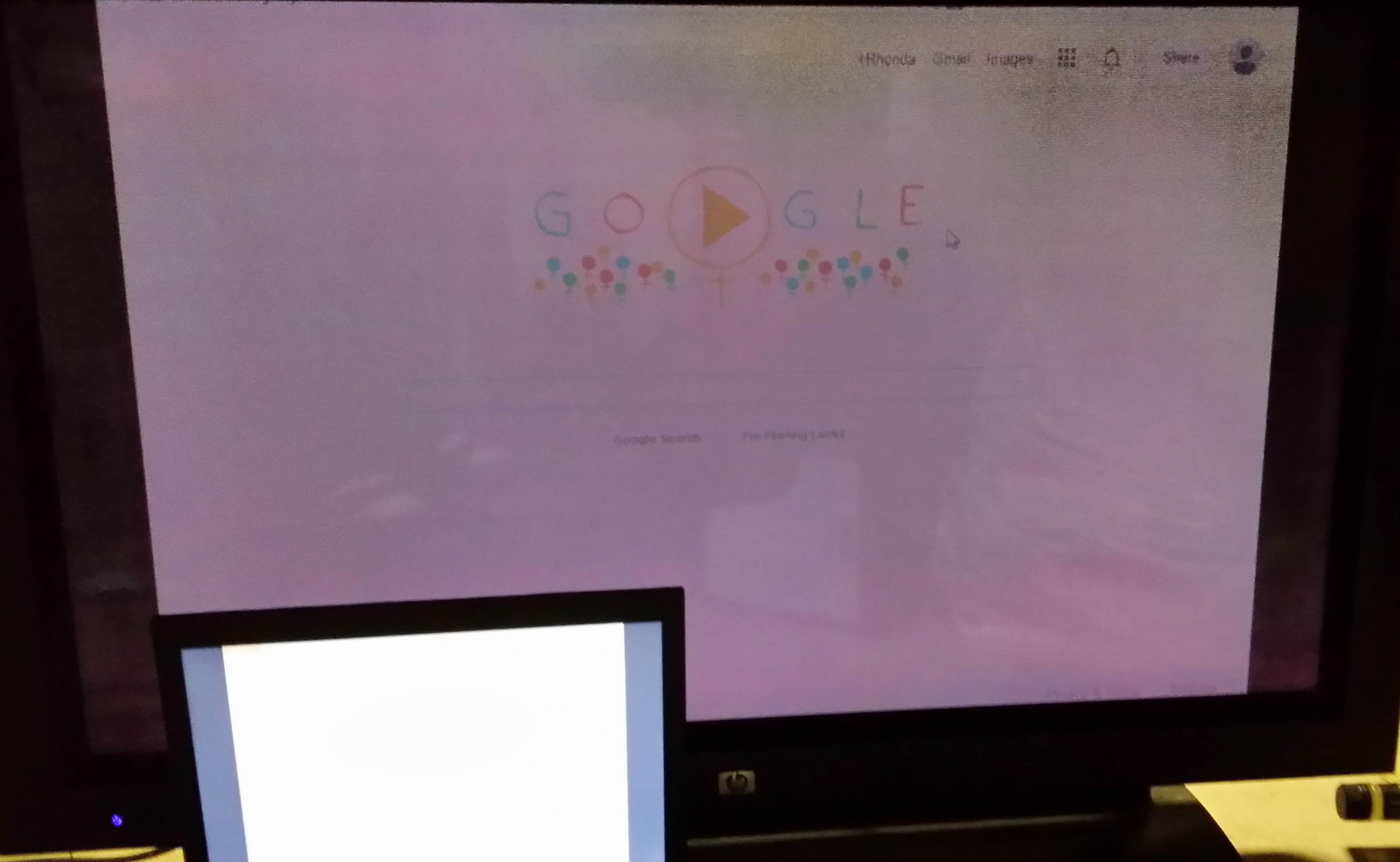

                  Re: HP PL4260N - Red Dots after YSUS repair - do not disappear after warm
                  CapKid.
                  I also have a HP PL4260N that's been garaged since it was 2 yrs old, apparently due to the same problem, and am hopeful I could enlist your help to get it usable. It sounds like it's the same problem that you've been fixing. Lots of pink/red sparkling, images are terrible, lack brightness and richness, and generally jacked up.
                  Could you let me know what other symptoms to look for, and if it's something you believe you can fix?
                    The red/green dots fault is generally a "watchable" TV but in darker areas, and trailing bright movements, red/green dots can follow objects.
                    Your fault sounds more like a Z-sustain fault
                      Tom,
                      Thanks for your reply. I've attached a pic. I tried to include the cloned imaged (google home page) on both the laptop and tv. As you can see, the camera seems to have adjusted it, because you can't see anything on the laptop. Just wanted to clarify, there is a huge difference between what it should be (like the laptop) and what it is.
                      Does this confirm your diagnosis?
                        Wirelicker--
                        I think there's summit else going on in your set, Check all the various voltages on Y-SUS and dont forget the V-Zbias on the Z-SUS...
                        Post them here, maybe one of those is off causing the issue.
                        Is the picture really dark as well?--difficult to see in that picture....
                        A picture of the chassis and the boards would help identify exactly what model PDP too....

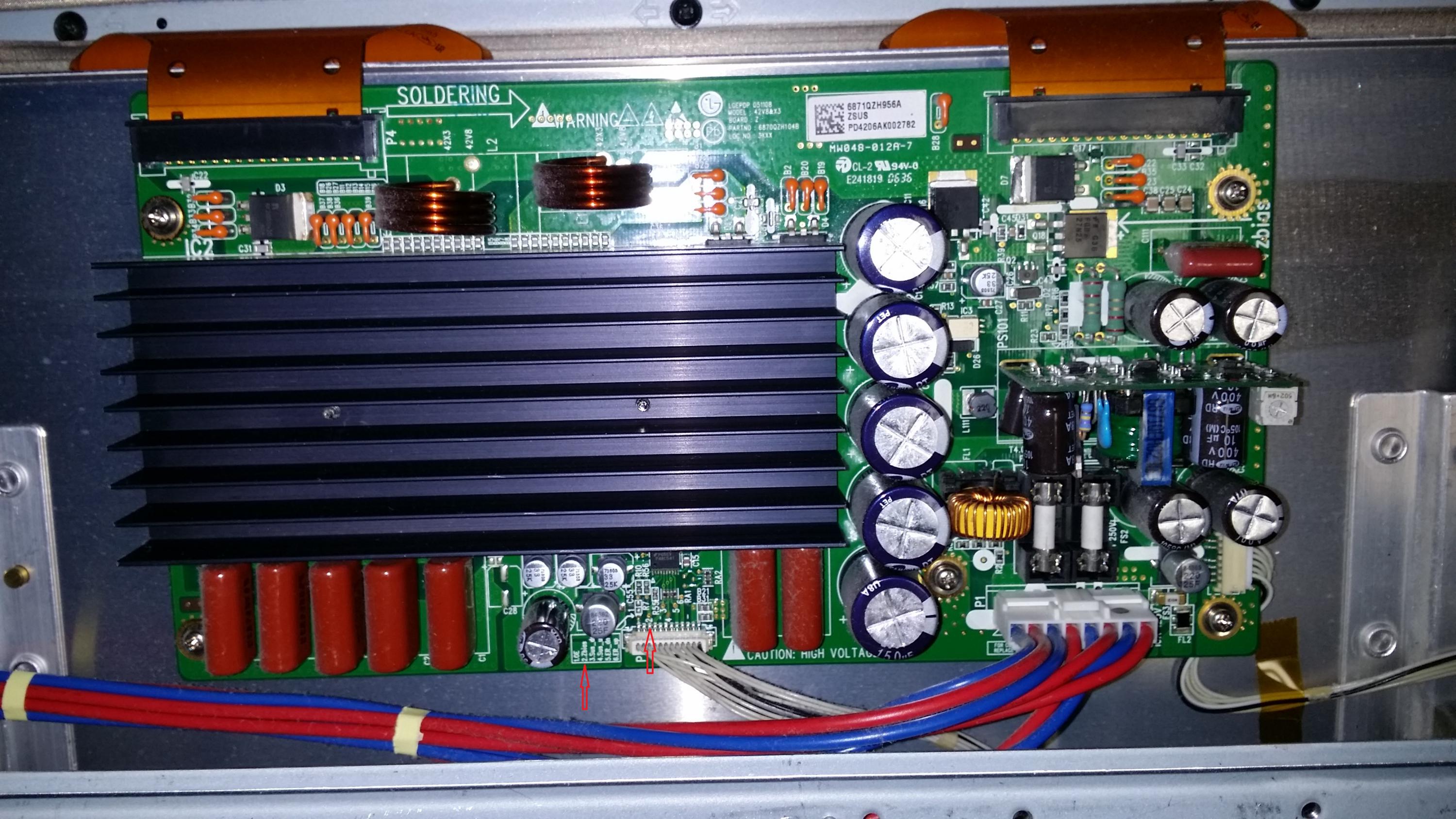

                          Voltages coming in are good.
                          Vs 188. Va 66.
                          Attached a pic of the ZSUS.
                              Here's what I got, tested Zbias and others at the white connector in photo...
                              1. OE 0
                              2. Zbias 2.7
                              3 Sus_dn 0
                              4 Sus_Up .26
                              5. ER_dn 0.082
                              6. ER_Up .31
                                Vzbias should be checked at the point near the orange ribbon connectors.
                                • wirelicker
                                  • Mar 2014
                                  • 12
                                  Let me try that again. Next to the ribbon there is an arrow printed on the board labeled zbias which points to an n-channel mosfet (fqb 27n25 g36). It registered.
                                  G: 7.3
                                  D: .047
                                  S: .138
                                  Another thing I noticed, the heatsink wasn't getting warm on the zsus.
                                    Looks like the VZbias supply is missing....
                                    Its generated on that small sub-board by the side of the MOSFET. Check for the resistance to chassis from the VZbias test-point, (Tab of that mosfet)--maybe there's a short on that line somewhere....
                                    TELEFIX
                                      No resistance when powered on.
                                      • wirelicker
                                        • Mar 2014
                                        • 12
                                        I found a bad fuse on the Zsus. Replaced it, and now the tv won't stay on. It acts like a throws a breaker a second after coming on. When I put the bad fuse back in, it powers up, and I get the same purple/pink and muted screen. The fuse I got to replace it matches spec, (4a, 250v, slow) but is glass instead of ceramic. Since the tv has 5 of the same fuse in different places, I juggled them and tested again, same result.
