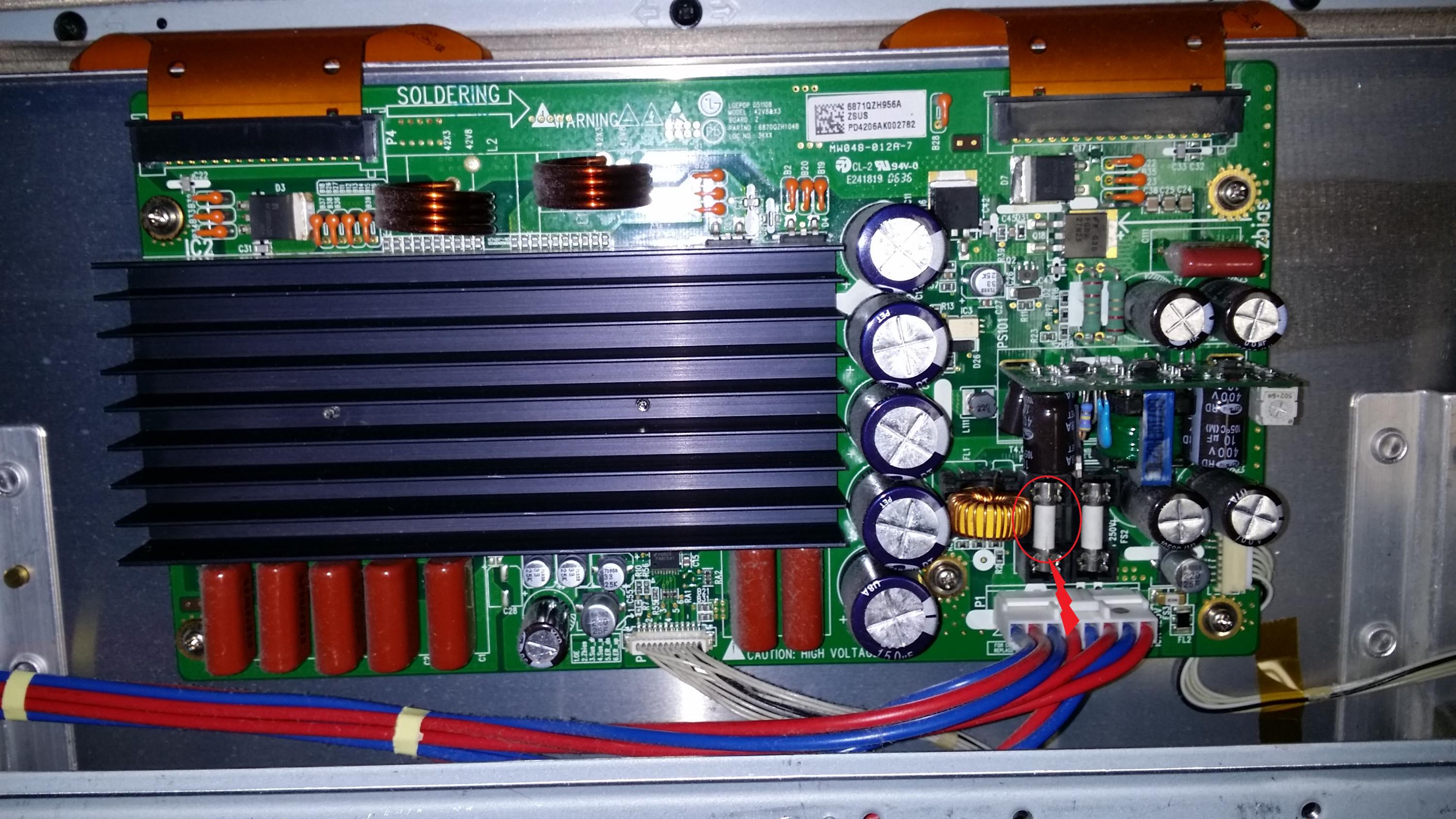

      Re: HP PL4260N - Red Dots after YSUS repair - do not disappear after warm
      Here's the location of the bad fuse.
        I'd like to learn how to think this thru, so let me know if this is good logic... Putting in the good fuse must be opening a circuit that probably has a short which is triggering a safety fault which shuts off the tv. Since the fuse is on the zsus, the issue is probably a short that's on the zsus, in the path of the bad fuse, and it's significant enough to trigger a shut-off fault.
          Yes, 99% of the time on these a bad fuse is caused by the IPM module, under the black heatsink.
            I disconnected power supply to zsus and tested resistance of both fuse-holders to the frame, and the holder which had the bad fuse was grounded (about 1 ohm), and other holder was around 49 k-ohms.
            I also rechecked resistance on the vzbias mosfet (disconnected power) and got much different readings. Probably did it wrong before.
            G: 97 k-ohm
            D: 97 k-ohm
            S: 5 ohm
            tab side: 97 k-ohm
