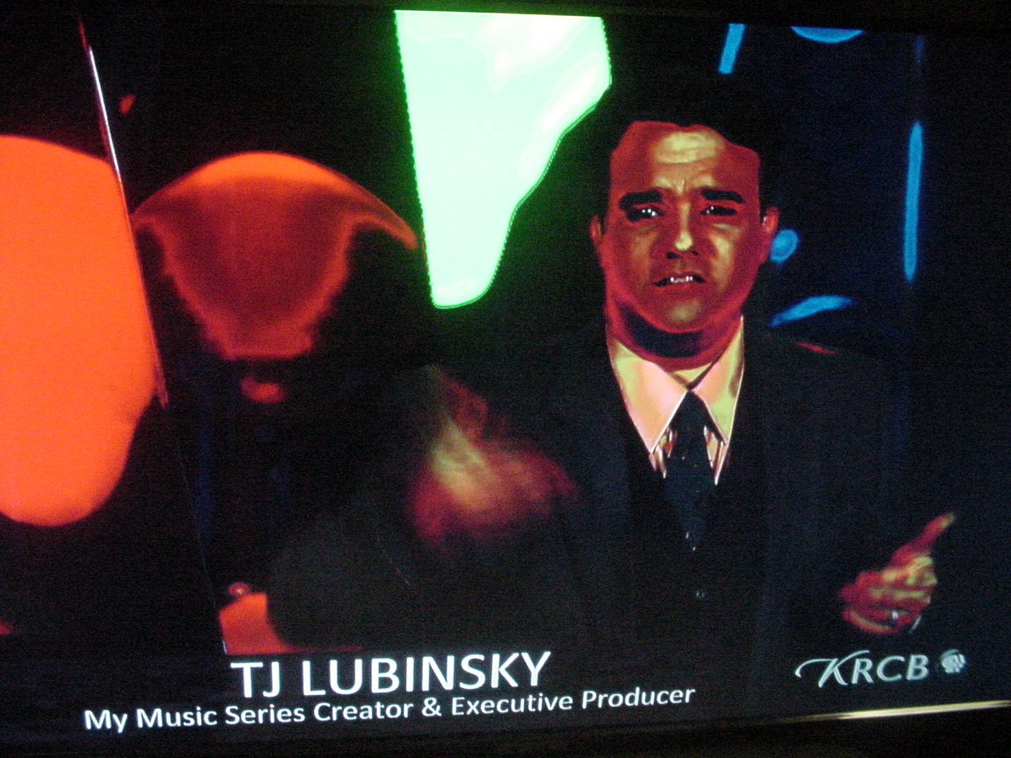

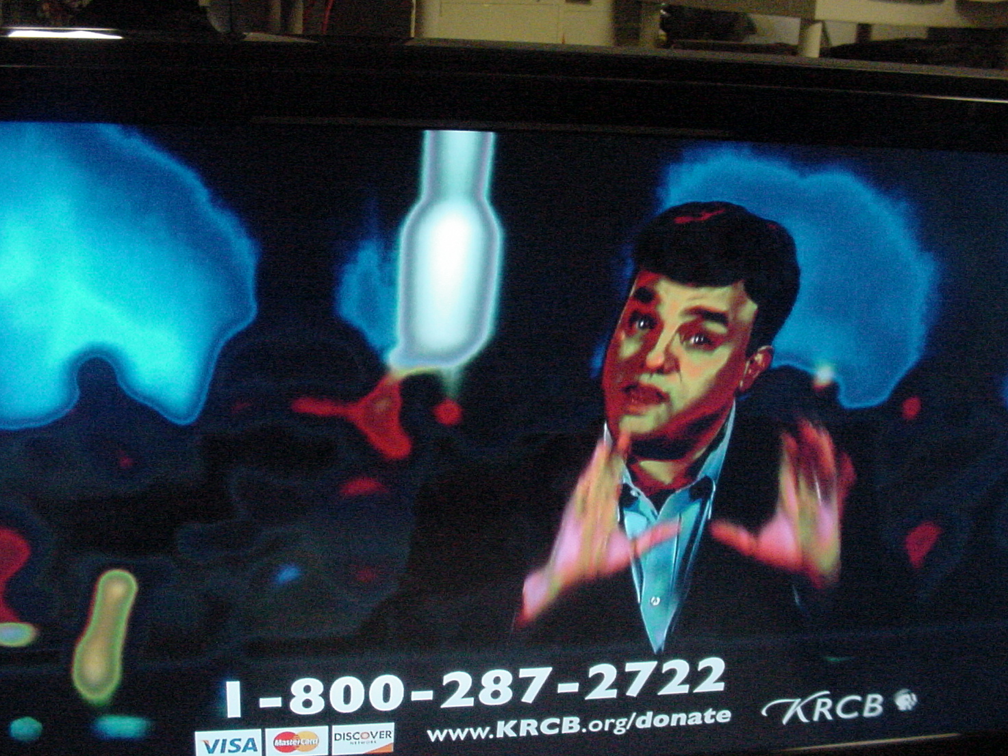

Sceptre X460BV-F120 with bad Gamma

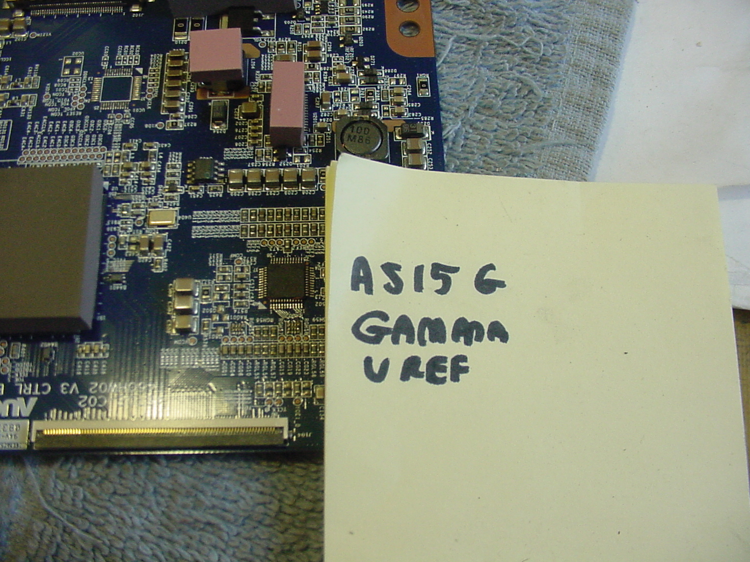

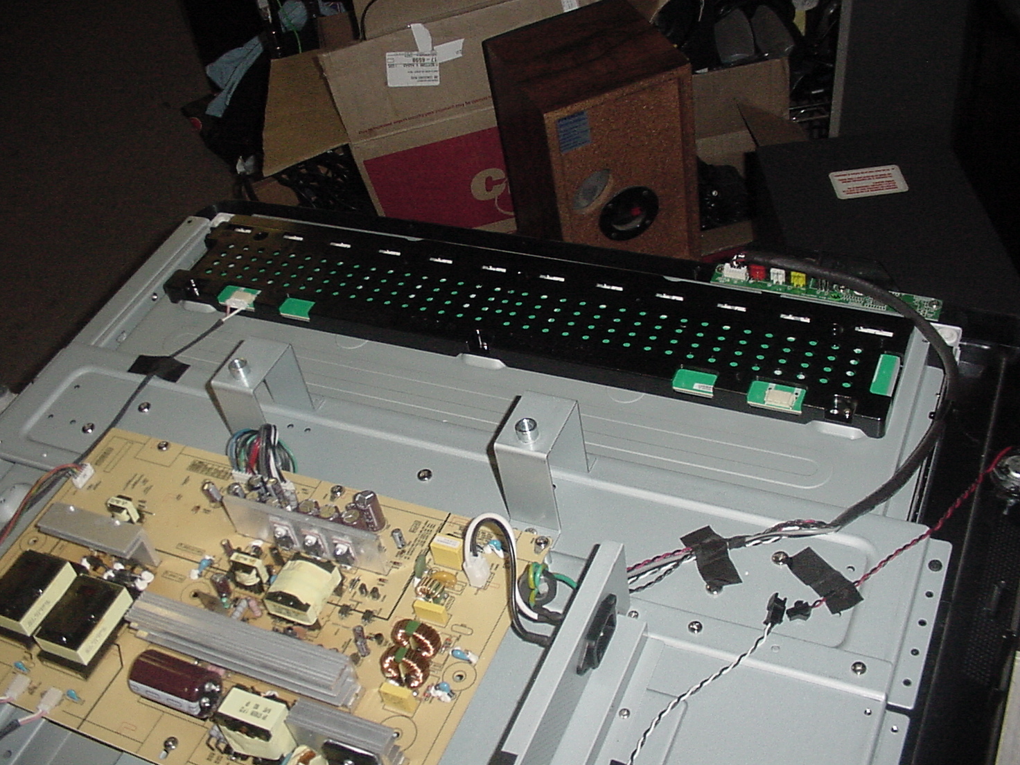

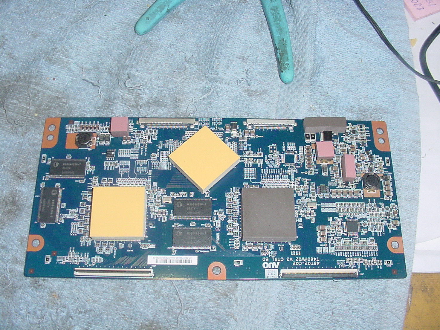

Just fixed this one today.
It has AUOPTO and the T-CON board with bad AS15G Gamma voltage ref. IC.Never stop learning

Did you do a check of the VGMA voltages and plot them out?Please do not PM me with questions! Questions via PM will not be answered. Post on the forums instead!
For service manual, schematic, boardview (board view), datasheet, cad - use our search. -
Re: Sceptre X460BV-F120 with bad Gamma
No I did not, did not have much time and space to do the voltage readings on the T-CON.Never stop learning
