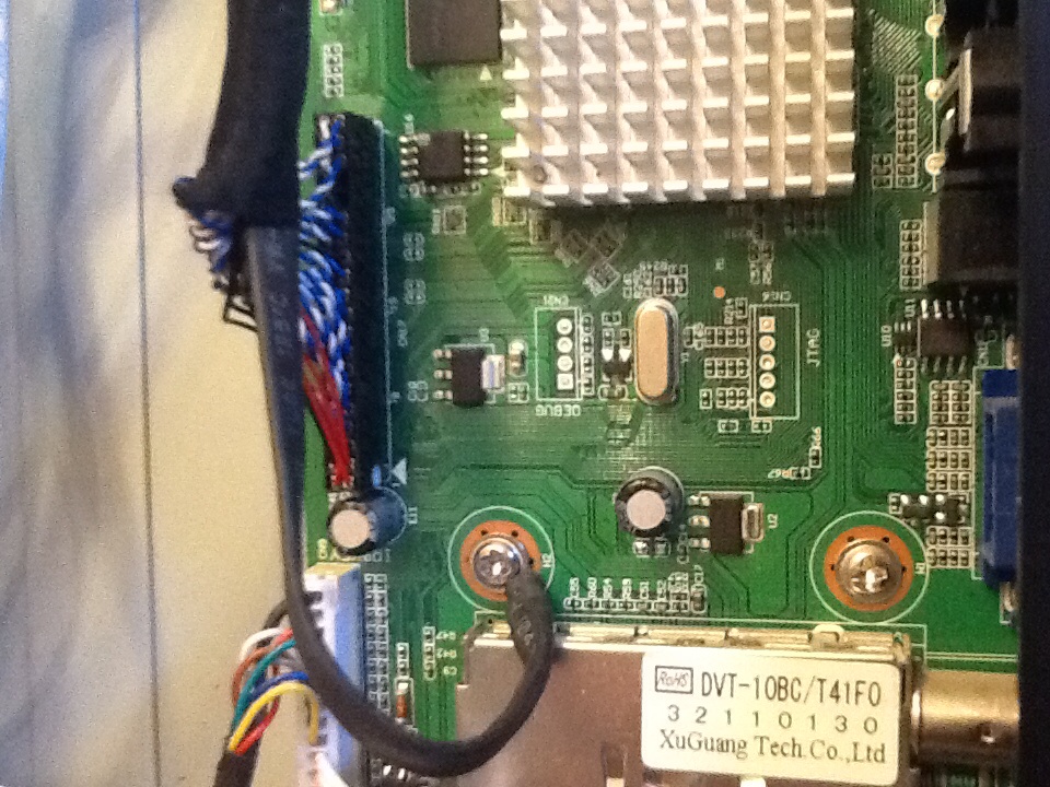

            Do you see the MOSFET in this picture? How do I test it? Or do I just replace it...?
              Re: 2011 rca 46la55r120q led tv - backlight works, no picture, no sound
              Little 8 pin device near the connector, do you see a part # on it?
              • kburks1230
                • Mar 2010
                • 87
                25l3206e
                m2i-12g
                • kburks1230
                  • Mar 2010
                  • 87
                  25l3206e
                  m2i-12g
                    Hmm, unfortunately not a MOSFET, but a memory for the processor.

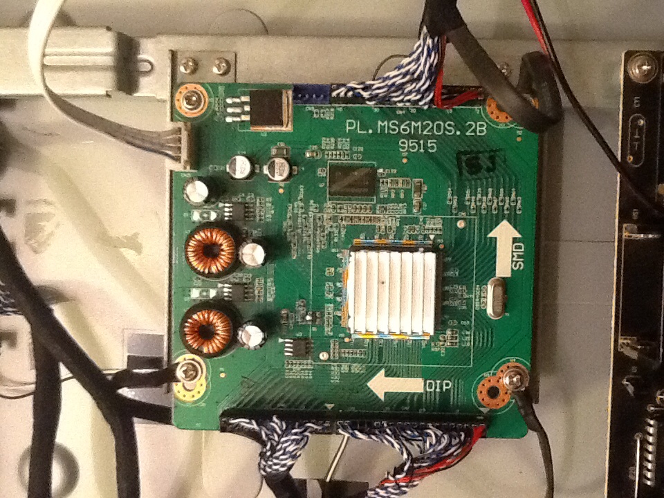

                      There is another board that goes from the main board to the tcon. See the pic attached here.
                        That is Motion FRC (="frame rate converter") board for 120Hz/240Hz picture. At the top right 4 pin connector what voltages do you get?
                        • kburks1230
                          • Mar 2010
                          • 87
                          There is also a bm1084 on the PL MS6M20S 2B board from the last post along with two little 8 pin MP1482DN chips.
                          The first board I posted a pic of is the the main board with the inputs. The LVDS cable goes from that board to the second smaller board I posted a pic of in my last post. Which is the main board?
                            Main board has video inputs like HDMI. Above post has motion FRC and there is also a t-con board
                              Tom,
                              I measure 12v 12v 0v 0v on at that 4-pin connector.
                                OK, and on the last right 4 red wires going off to the t-con board (coming out from the bottom of that image) do you read 12V?
                                • kburks1230
                                  • Mar 2010
                                  • 87
                                  Nothing on the bottom 4 red wires. The bottom right harness comes from the main board. The left harness goes up to the TCON. I have no voltage on those 4 red wires coming from the main board. I tested those 4 red wires on the main board and have no voltage there as well.
                                    Hmm, yeah, I looked closely at that board again and the power for the t-con passes straight through the board. Not sure what else to suggest; looks like your main board is bad.
