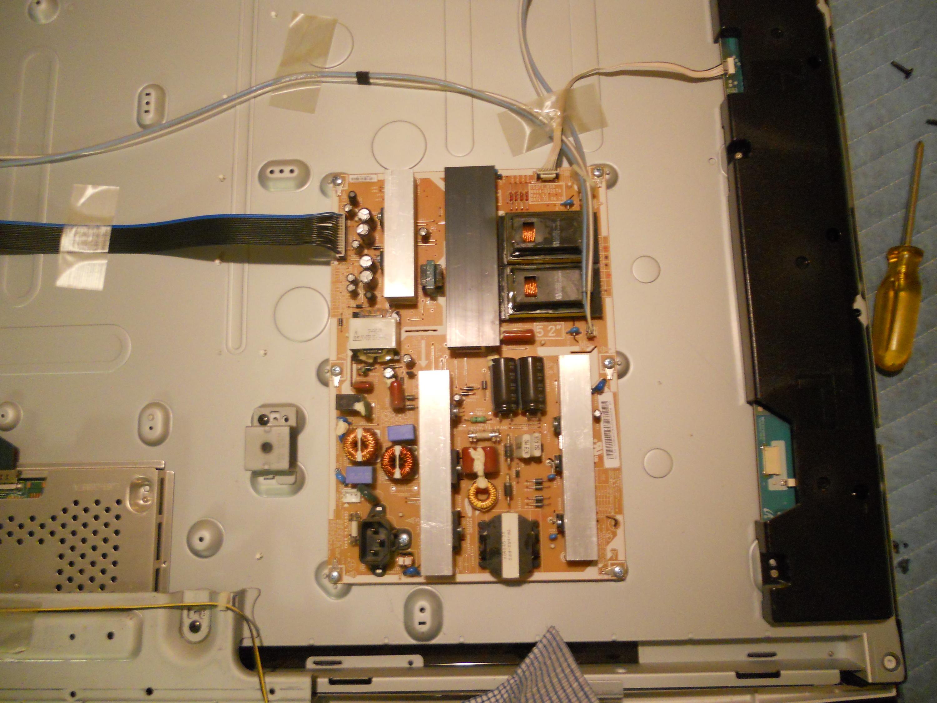

            Re: Samsung LN52B630 LCD TV keeps reseting
            I've seen lots of samsungs with bad caps, they have various symptoms. In your case, I would replace all of the caps n the cold side (35 V and below) on the power supply.
              Yes, you should replace them as a set not just the one with bulging top, use good caps like PANASONIC FM/FR/FC series.

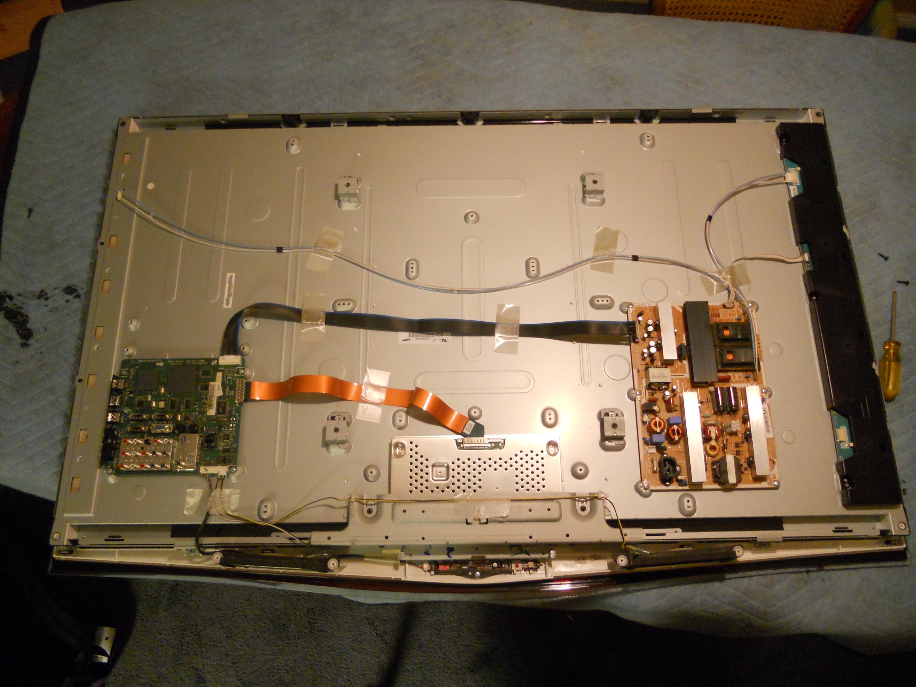

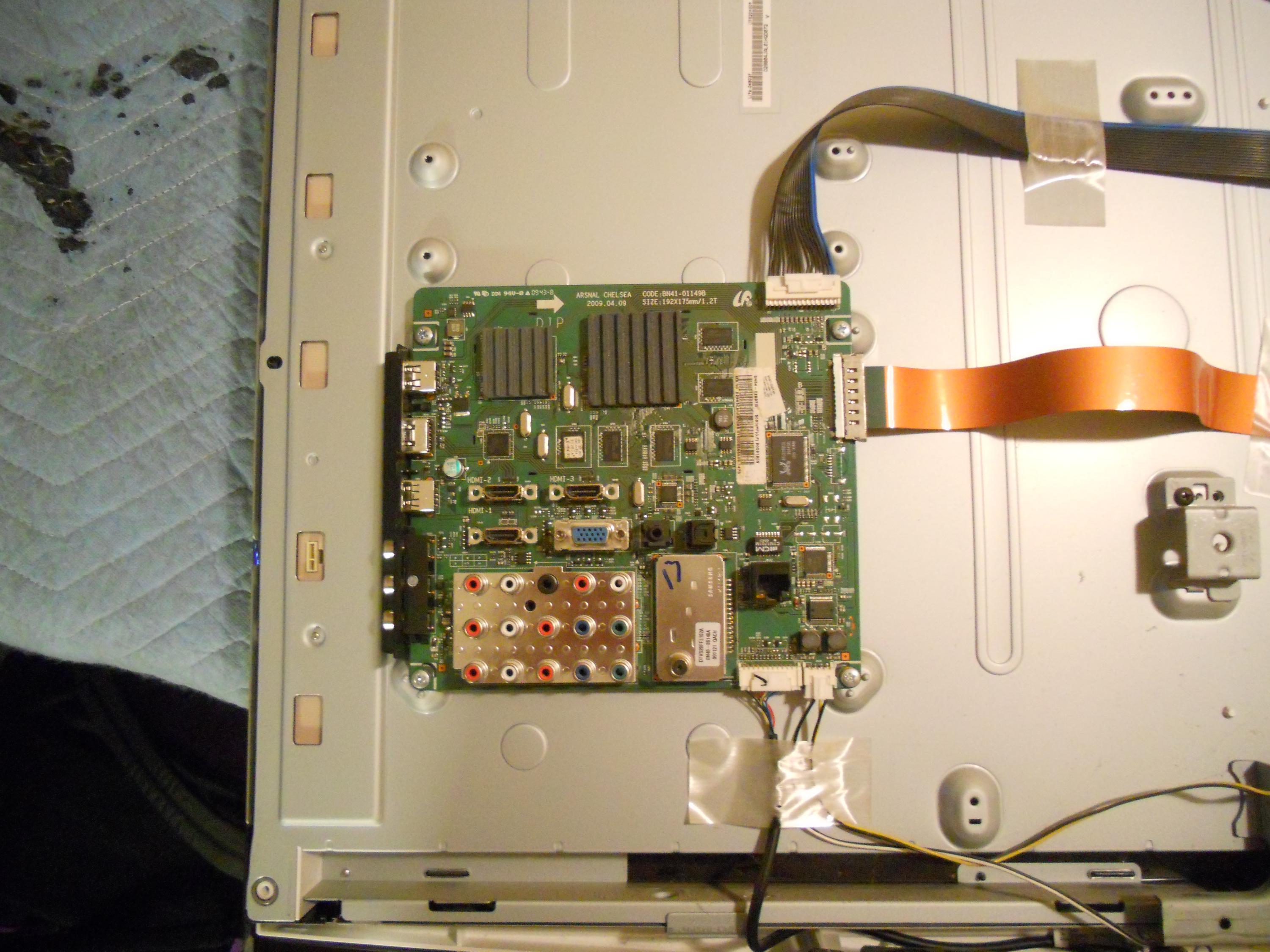

                So I managed to open up my TV and to my surprise I don't see any bulging caps! I have attached pictures of the back of my TV so someone can suggest anything else I can try.
                  Unplug the grey harness from the mainboard and plug the tv in. I'm not absolutely sure, but I'm thinking the backlights should come on and stay on. If this is the case, your mainboard is the problem.
                    I did unplug the harness cable and the backlights came on... How certain are you that it's a mainboard issue?
                      How long does it turn on for? Do you ever see a picture?
                                      So it seems that my issue is not resolved. I replaced the t-con board and it turned on initially but it's back to the usual. It turned off by itself and tries to turn on multiple times until it finally does. does this mean that it the main board?
