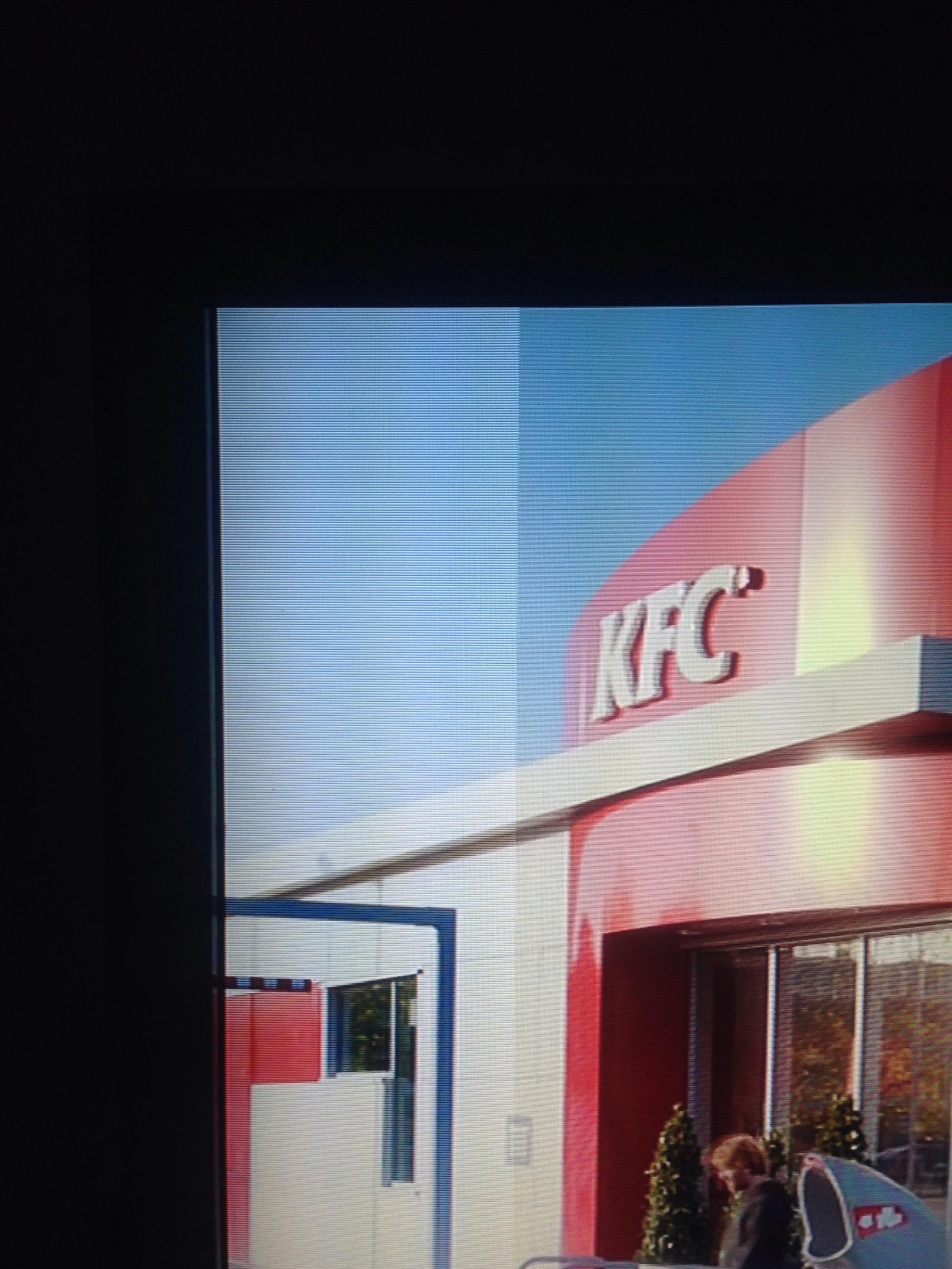

    Hi Guys!
    Firstly im a newbie so go easy....
    Last night my LG LCD tv decided to have a faint panel on the left hand side of the screen. It does start to flicker intermittently on the panel which is faint also.
    I've been told it could be the tcon board but if its the panel then its scrap....
    Has anyone any ideas.... Ive attached a pic so you can see.
    Any help is much appreciated!

    Common issue on these is panel tab bonds.
    http://www.youtube.com/watch?v=purk_SyiT44
    Different fault same root cause.

      Thanks tom, looks pretty straightforward to fix.... is there anything else i need to know when attempting this repair?
        Re: LG 42LH3000 Faint panel on side of screen
        The repair rate is only around 80%.
        Be extremely careful around the panel. One crack and game over.
