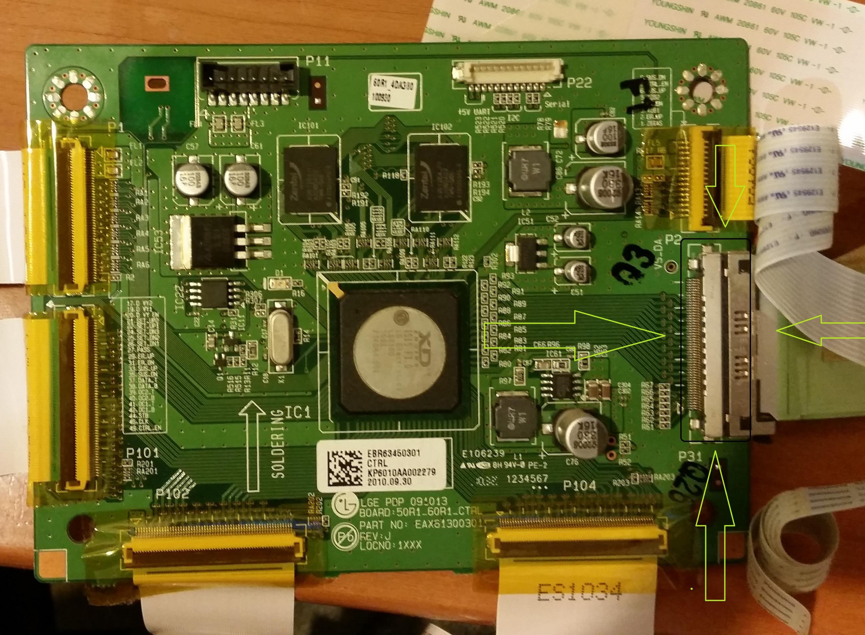

    OK, that's good.
    See attachment.
    With TV OFF and UNPLUGGED:
    - Disconnect the blue highlighted cable, by pressing each clip gently and pulling backwards with minimal force.
    - Place a wire link between the two holes marked in red.
    Then plug TV in and turn on if it is in standby.
    You may or may not see test patterns, but if you do, it indicates the main board is bad (not this board... the board with HDMI etc.)
    So I did this on my girlfriends TV and I got the test patterns. So I know its not the power supply because the tv stays on, and if you say test patterns mean that the main board is good and the board with all the Inputs on it is bad. Why when I his the volume button or inout button I still get nothing on the screen?

            I am having a similar issue with my 50PZ570. when I short out the 2 holes as in this post, the screen goes completely white. should there be different colours?
              #46
              Re: LG Plasma 60pk950-UA no picture or sound
              Yes after a few seconds it should cycle thru some coloirs

                I'm a bit confused here. I did the test and saw the cycling through the colors. That means the "main board - the board with the HDMI ports" is bad and needs replaced?
                My testing also shows the constantly changing voltages on the Y-Sus board as well, so I was thinking that the Y-Sus board had gone out. If the main board is also bad, I have at least two bad boards.
                My tv is the LG 60PZ950 with no picture or sound, but it turns on and the blue status light responds to the remote. The screen is light grey for a second when it turns on, but otherwise no picture. It went out suddenly while watching live TV - I had had the pink and green highlighting on bright scenes for a while now, as well.
                The voltages on the Z-Sus board seem fine. Still no picture or sound with the Y-sus or the Z-sus board disconnected from the power board.
                Thoughts? Am I correct in saying I need at least two boards because I saw the test screen colors?
                  #48
                  if you have the test patterns, then you have a bad main board only.
                  these sets suffer from bad solder on the bga chips.

                            when you did your test patterns, did you jumper the test holes and removed the lvds cable?
                            WHY CAN'T PHILIPS USE PHILLIPS HEAD SCREWS?
                              #54
                              Are you testing Vsc and -Vy across the resistors marked or from one end to ground?
                                #55
                                Ditto, what do you mean disconnected board below power board? WHich bit, there's multiple ribbons going to the ysus, zsus, main and the x boards below plus the 5V feed from the power board?
                                In a nut shell, Disconnect the power connector at the main av board, disconnect the LVDS ribbon at the main,
                                The board under the PSU is the logic control board, on that there are 2 copper pads, they need to be jumpered together.
                                assuming the rest of the TV is connected still(minus the main board) plus the TV in and switch the power point on, relays should automatically energise, TV will power up, screen should energise and see test patterns.
                                If that occurs main board is no good, likely the BGA chip solders have fractured.
                                The 2 pads are where R51 and 52 are , bottom right near that cap.
                                [IMG][/IMG]

                                  just to note, this is your lvds connector.

                                    Thanks everyone for replying. I forgot to jump the holes and disconnect main from power. I had only disconnected lvds. I get the test pattern. So main board is bad. That seems to be good news as the main board is cheap.
                                    The question is, is there possibly something with the power board that fried the main board? There is a very faint smell of something burning. Not sure if that is normal.
                                    Also, I screwed up the Vsc and -Vy testing. I tested to ground and not across the resister. When I test across the resister it's exact to spec.
