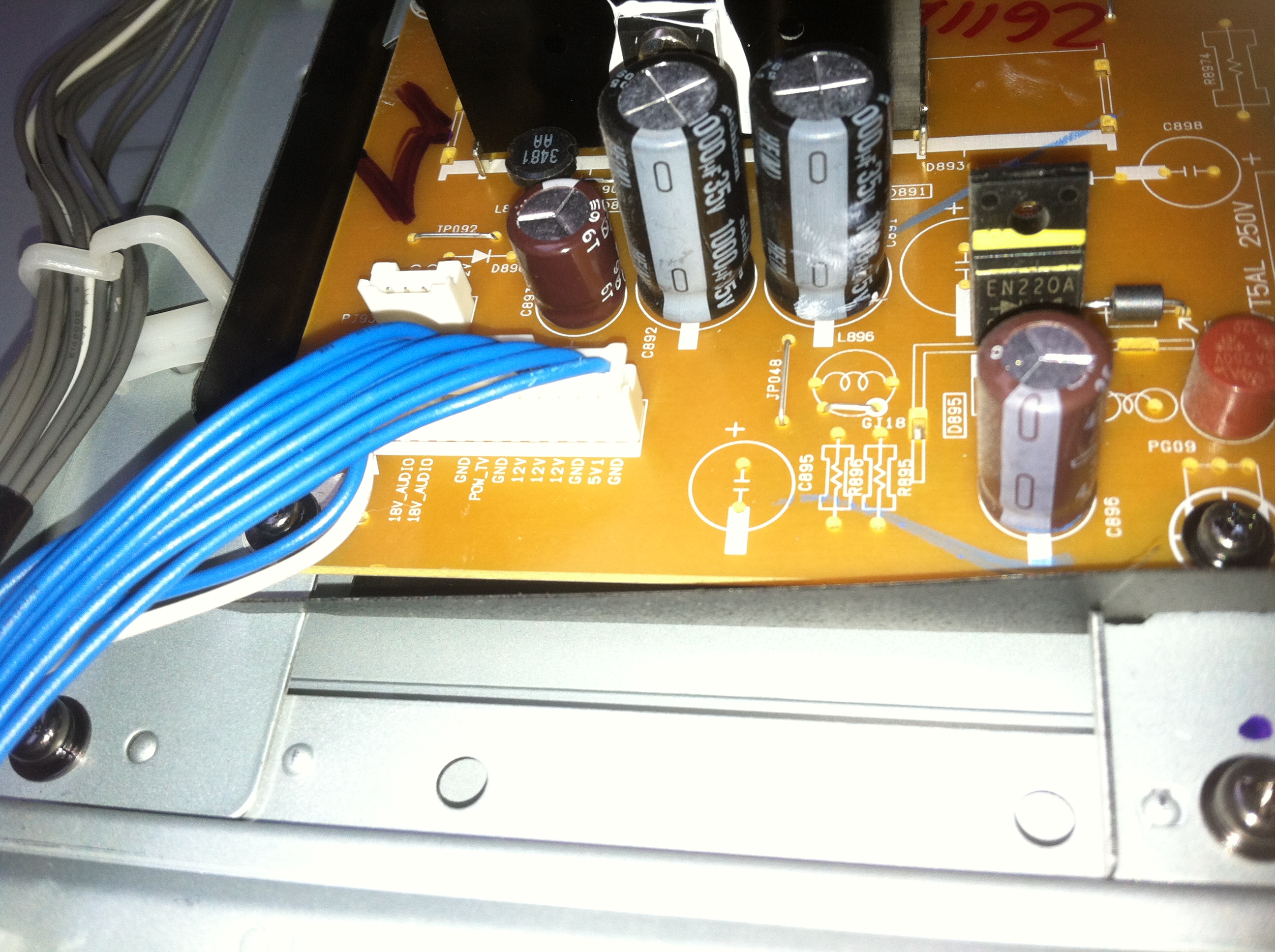

PJ90 (First Pic)
5V1 = 5V
12V = 12V
18V_AUDIO = 24V
15_24V(printed on opposite side of connector with 18V_AUDIO) = 24V
I didn't notice POW_TV until just now. I'll measure it and report back later.

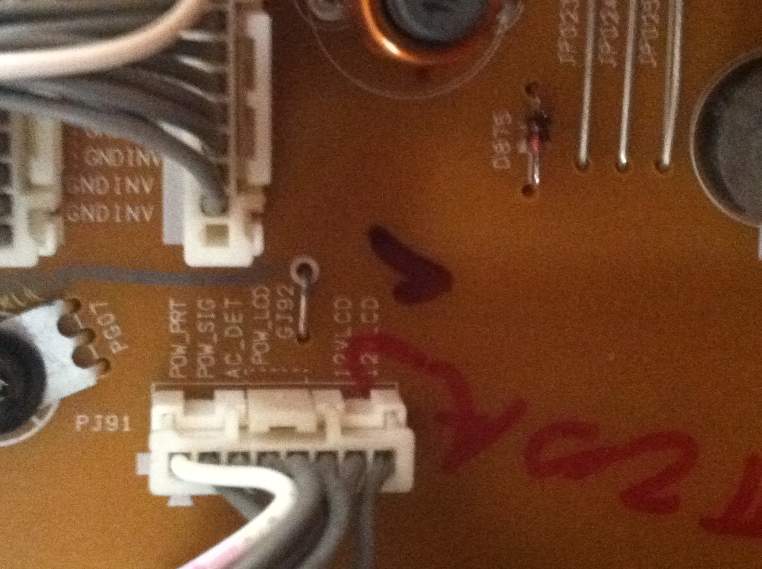

PJ91 (second Pic)
POW_PRT, POW_SIG, AC_DET, and POW_LCD all show roughly 3.0V
12VLCD = 12V

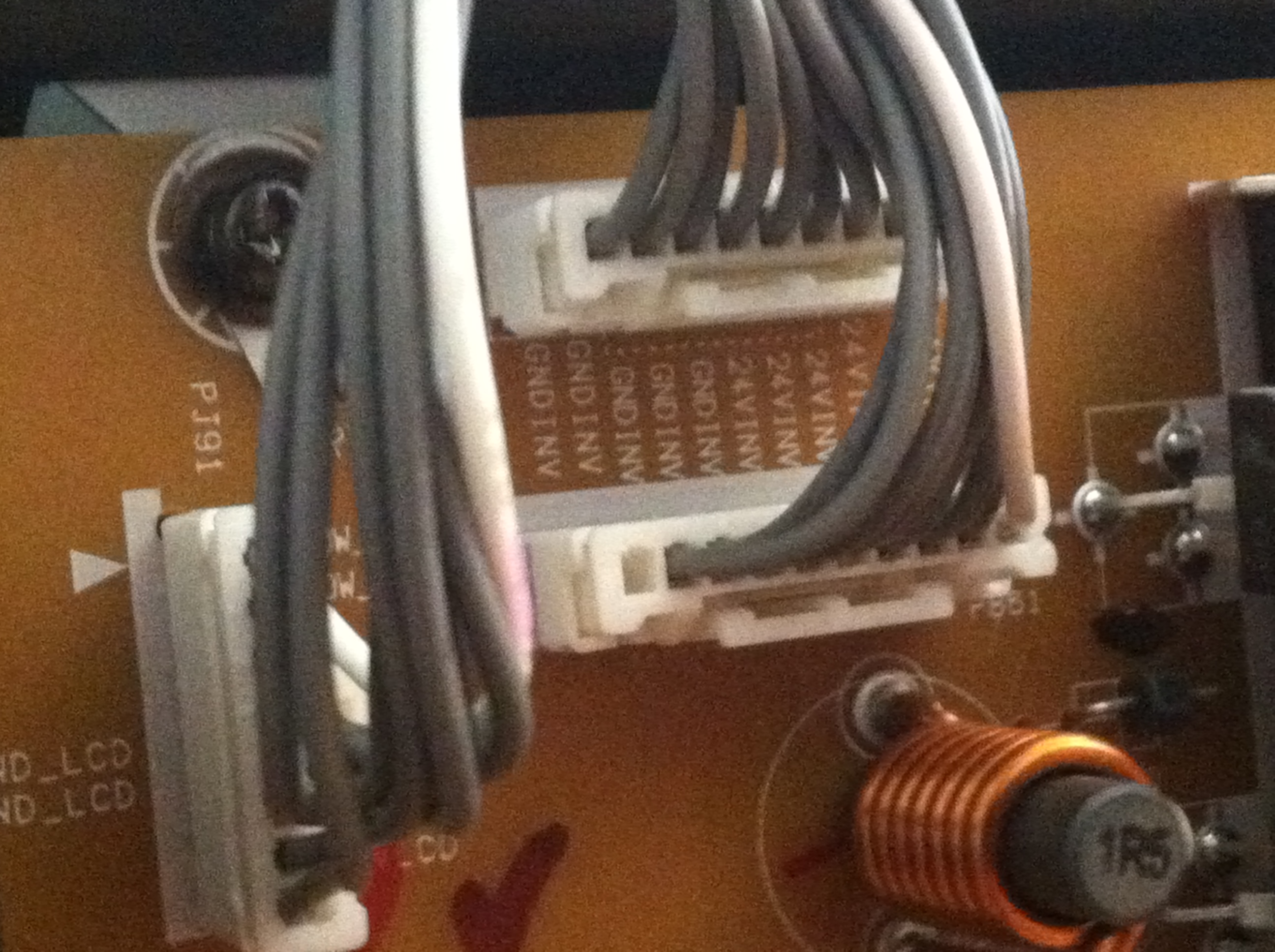

P860 (Third Pic)
24VINV = 24V

PJ90 (First Pic)
5V1 = 5V
12V = 0
18V_AUDIO = 0
15_24V(printed on opposite side of connector with 18V_AUDIO) = 0
PJ91 (second Pic)
POW_PRT = 3V
POW_SIG, AC_DET, and POW_LCD all = 0V
12VLCD = 0V
P860 (Third Pic)
24VINV = 24V (It doesn't drop at all)

PJ90 (First Pic)
5V1 = 5V
12V = 12V
18V_AUDIO = 24V
PJ91 (second Pic)
12VLCD = 12V
P860 (Third Pic)
24VINV = 24V

PJ90 (First Pic)
5V1 = 5V
12V = 0
18V_AUDIO = 0
PJ91 (second Pic)
POW_PRT = 3V
12VLCD = 0V
P860 (Third Pic)
