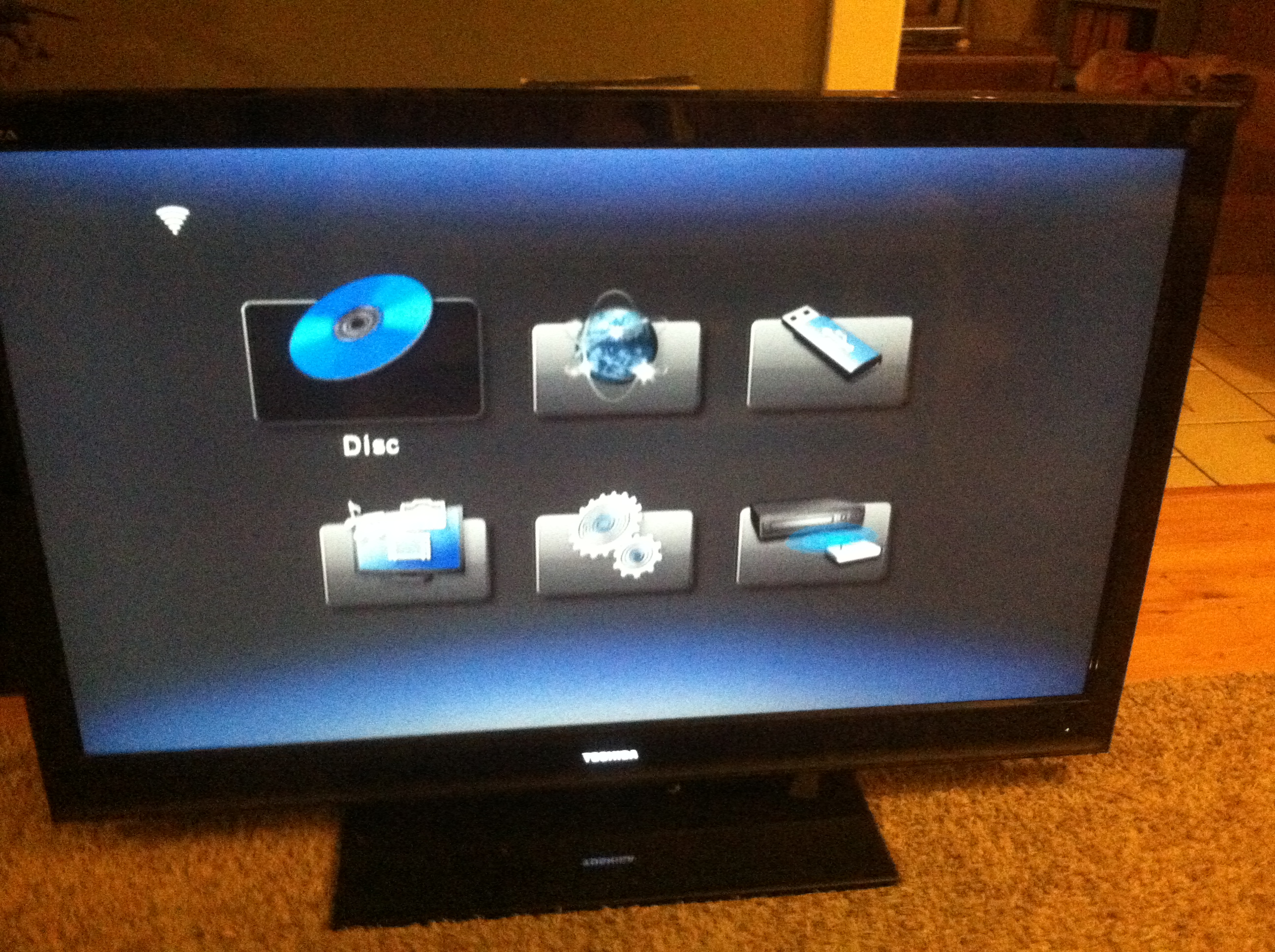

    Toshiba 52XV645U shuts off when signal is connected.
    I picked this TV up on Tuesday. It wouldn't turn on when I bought it. I got it home and plugged it in and it powered on. I emailed the seller to ask if this had happened before. He said it had. Once, it stayed on for twenty minutes. Another time, it stayed on for 4 hours. Who knows if this is true or not. At any rate. Without a signal connected. It seems to come on and shut off fine. However, it will not turn on if the HDMI is connected to any of the HDMI inputs. It shuts off after a few seconds when using A/V inputs. I believe this points to a main board issue. When the set is working, POW_PRT, POW_SIG, AC_DET, and POW_LCD all show 3.0V. When the set isn't working, POW_SIG and POW_LCD drop out. Here are some pics.

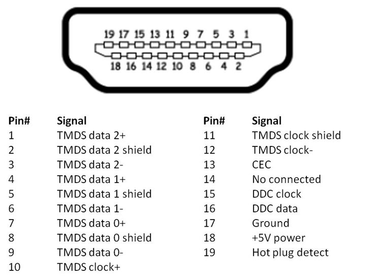

      I would check for a damaged HDMI port. Pin # 17 Gnd, #18 +5vdc, #19 Hot Plug Detect. Try plugging into the other HDMI port and see if it works OK

          It shuts off when using any of the three HDMI ports.

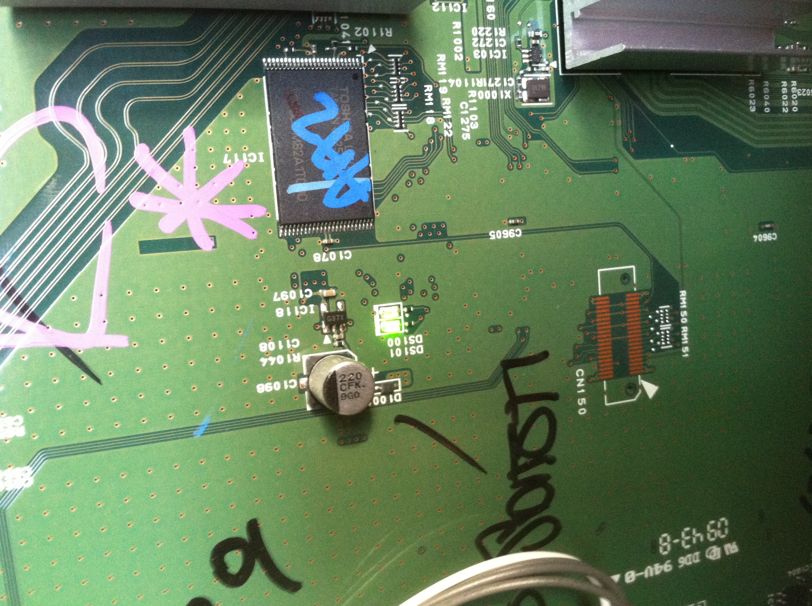

              It shuts off using any of the inputs. Right now there is nothing connected and it won't turn on. On the occasions that it does turn on, the PSU relays click and the green LED lights on the main board. When it won't turn on, the relays click and the LED won't light.

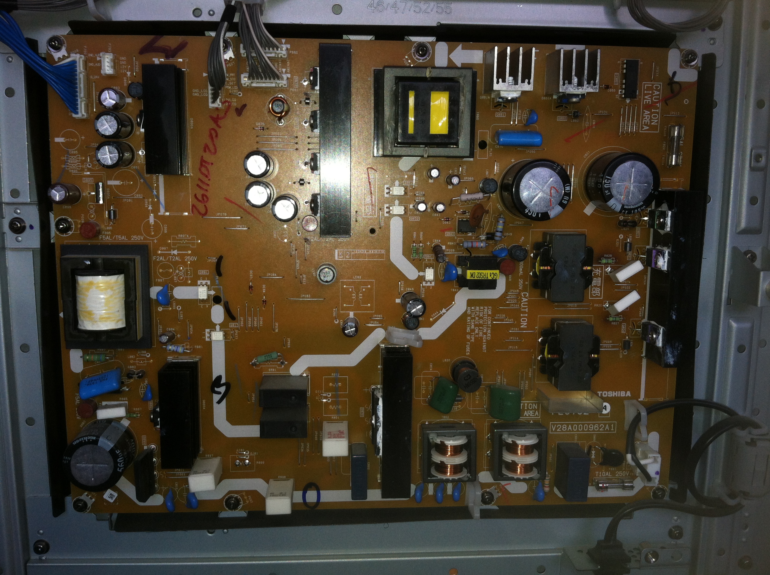

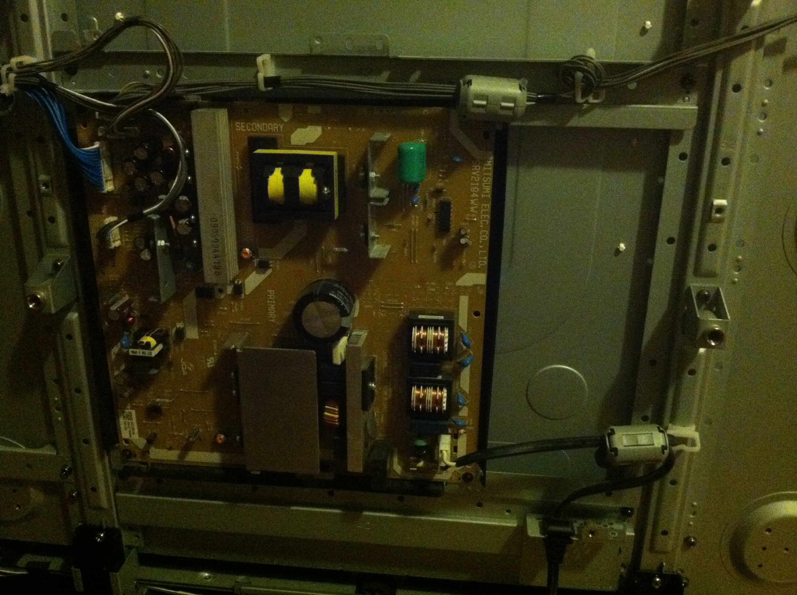

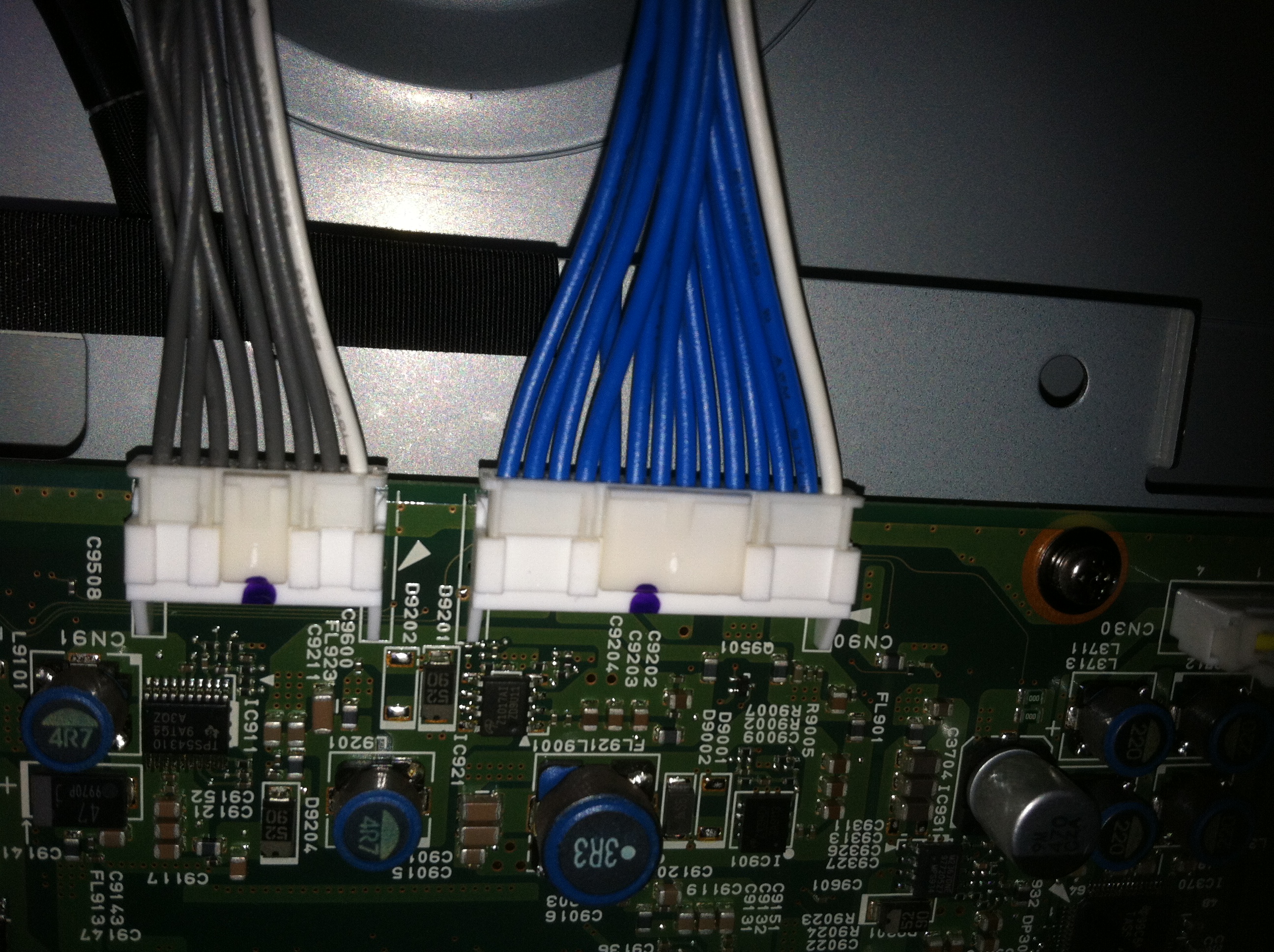

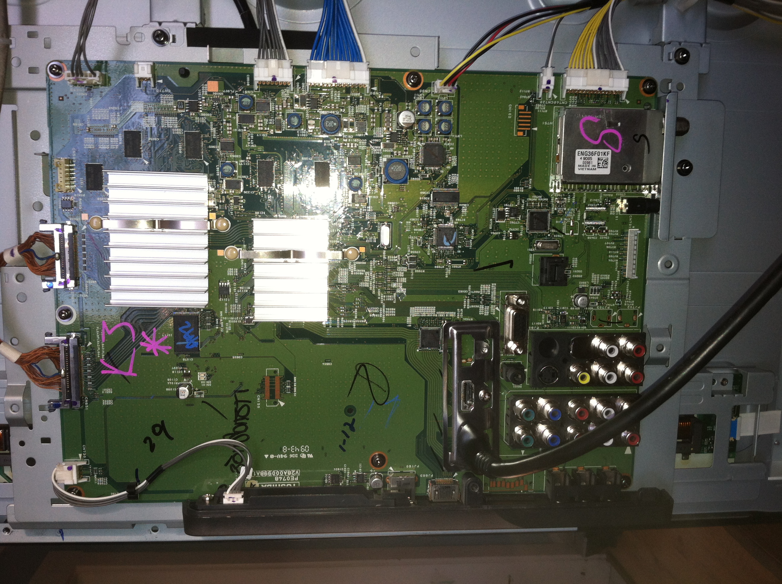

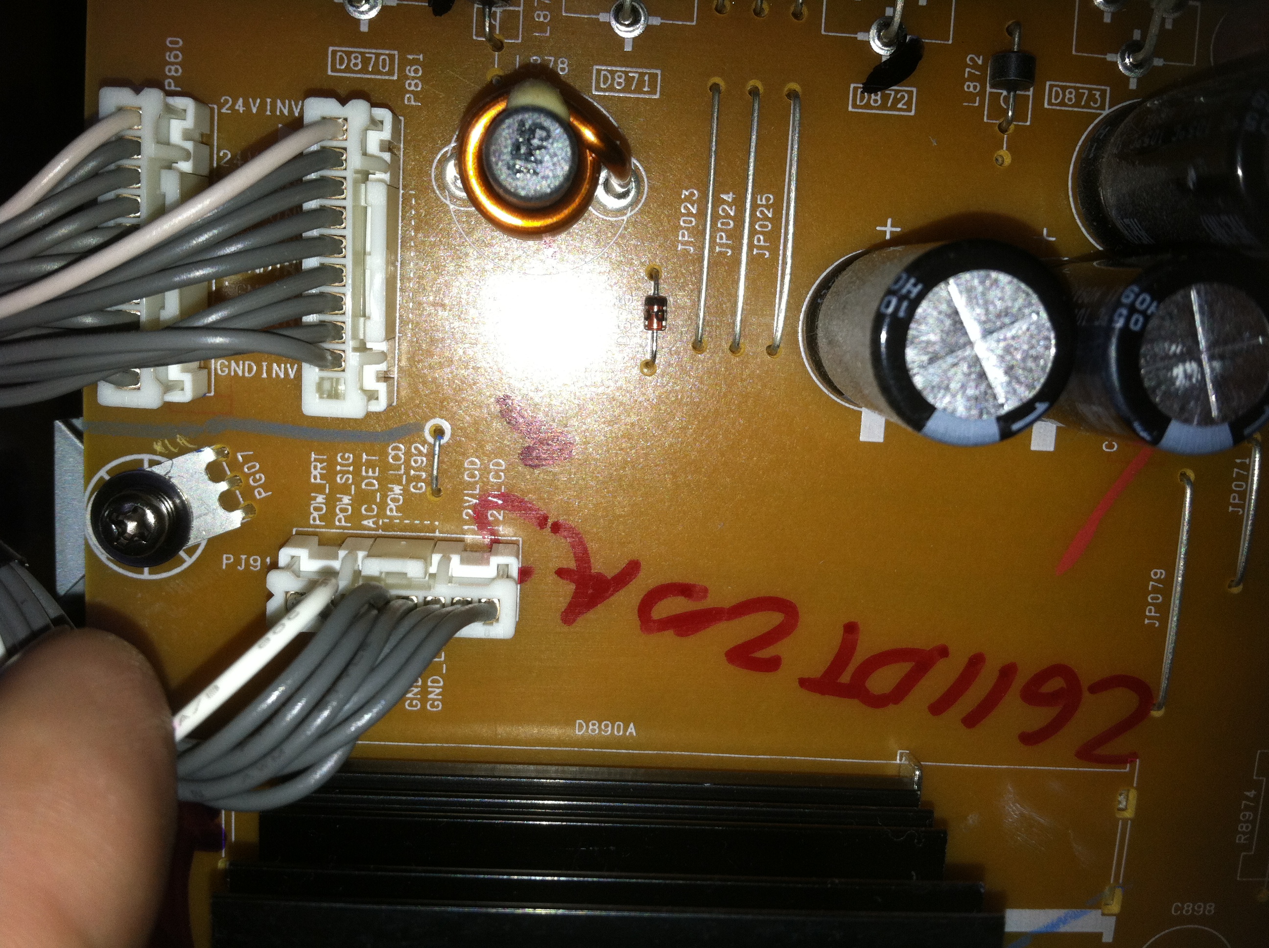

                        I'm back with an update on this one. Eventually it got to the point that this one wouldn't turn on at all. The LED on the front would blink three groups of three times, then go solid, then go out. I found a 40xv645u (same main, different PSU) with a cracked screen on Craigslist. I put the main board in and had the same blinking LED with no power. Like I said, the PSU is slightly different than the original, but will still fit inside the chasis using the same screw holes. It also has all of the proper connectors, two to the main board and one to each inverter. All pins are labeled the same as well. I put it in, just to see what would happen and the set came to life and works now. The original 52" TV uses 18 bulbs, the 40" only uses 14. I suspect there will be some issue with current draw or something like that, if not though, can I just keep the PSU for the 40" in the 52"?
                        The first pic is the 40" PSU, the second is the original, the third is the 40" PSU installed in the 52" TV. I apologize for the quality of the third pic, it was late and I didn't realize how crappy it was until this morning.

                            Re: Toshiba 52XV645U shuts off when signal is connected.
                            Well, it seems that you identified that the original power supply was the problem at least. I would think that the 40 inch power supply would be close to overloaded, but then again they've got pretty good regulation on these SMPS and if the heatsinking was adequate it might keep going.
                            On that original board I'd be looking for bad joints in the vicinity of the semi-conductor devices connected to the heatsinks. From your description it sounds like something giving up as things warm up or extra current is drawn. There's a regulating IC that is marked IC551 I think? I'm growing increasungly suspicious of the types of devices the more I get into this hobby. If it's the same on device on both boards you could even do a swap over? Also, check that big diode out that's next to the Regulating IC. It'll be a fast-switching device. You might need to lift a leg to properly check that one.

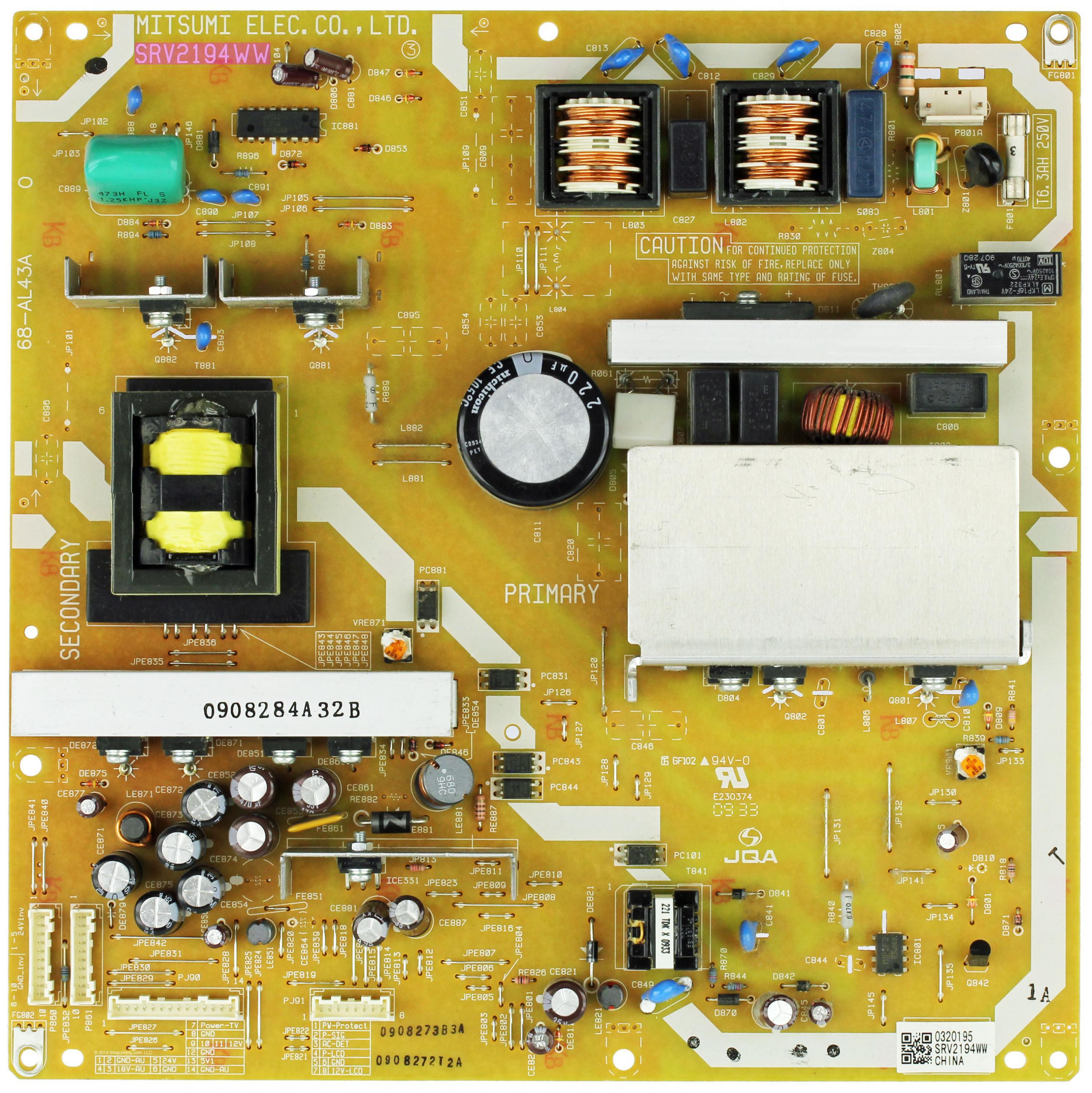

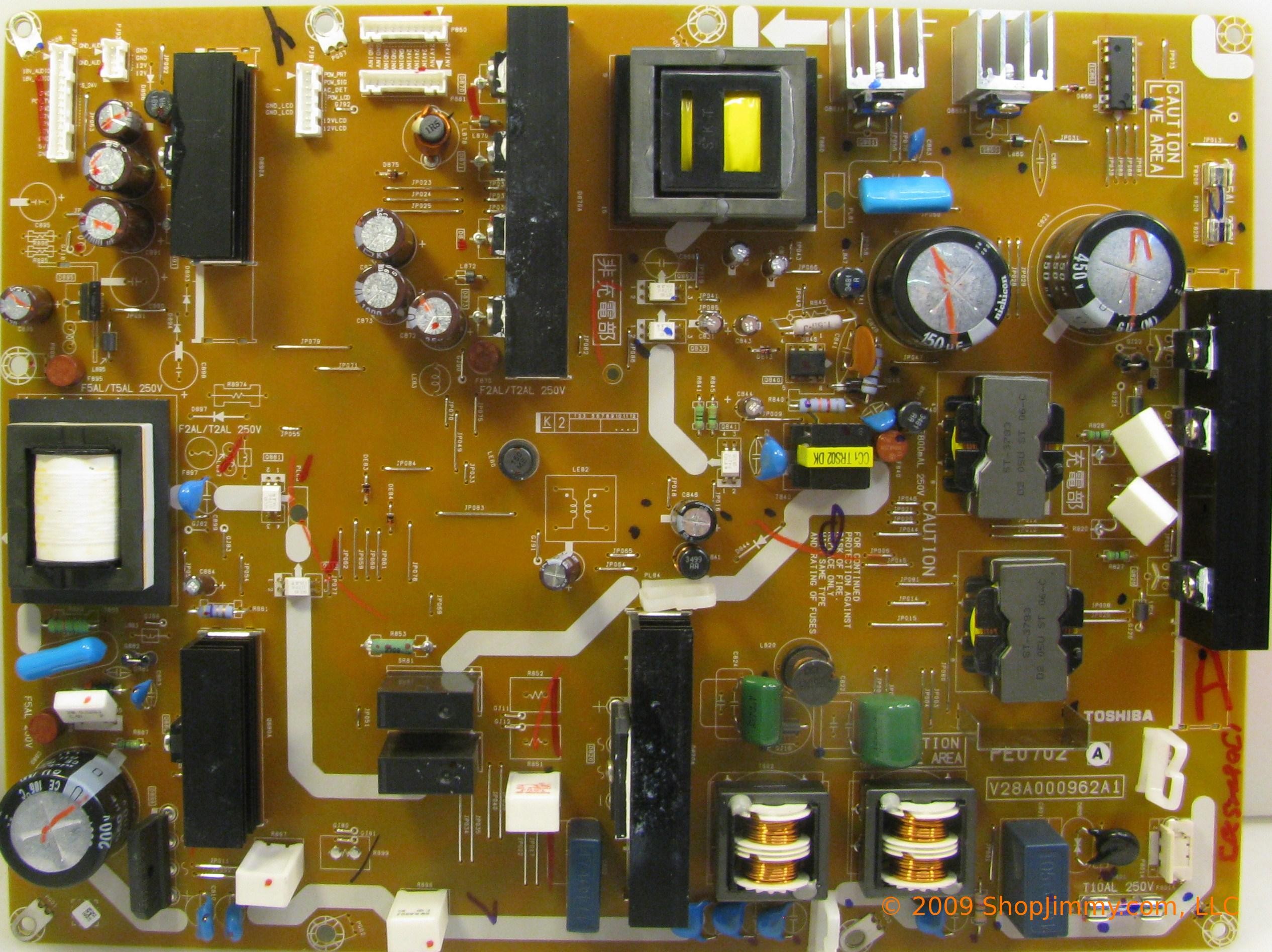

                              I found this repair kit on eBay.
                              http://www.ebay.com/itm/Power-Supply...item1e83af0b86

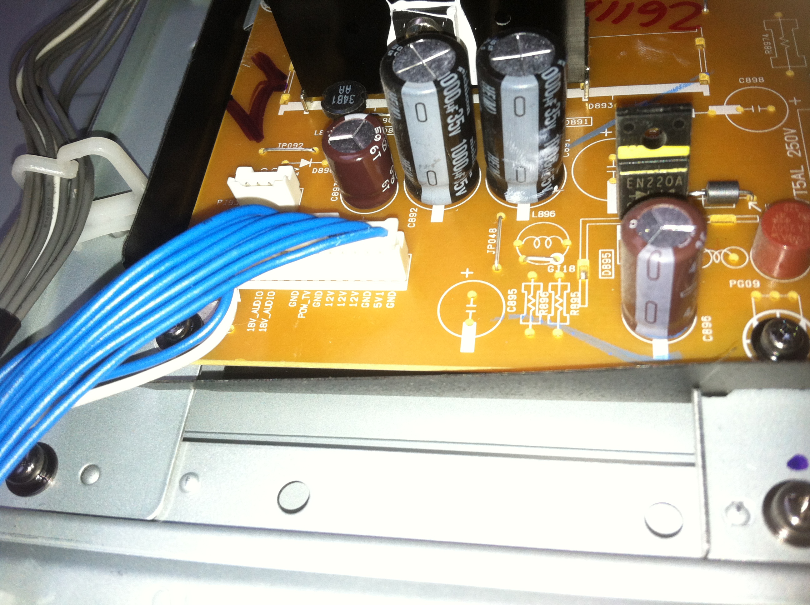

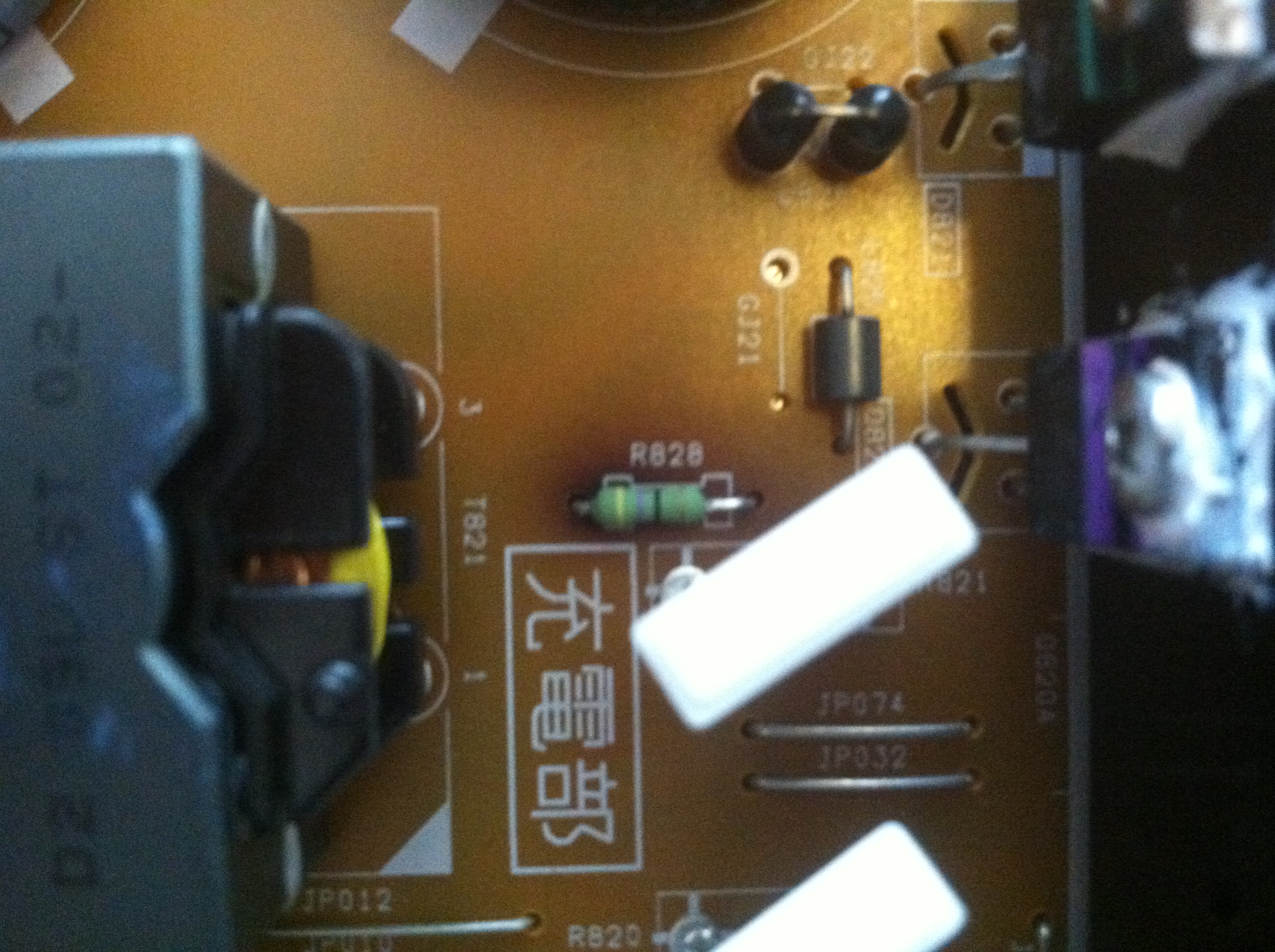

                              It includes D820, R850, and "upgraded" R827 and R828. I checked my D820 and don't see any shorts, R850 appears to be OK as well, but both R827 and R828 show signs of getting really hot. I tried to get a picture. The board under the resistor is really dark. It looks alot worse in person. Yet, both resistors show 47 ohms.
                                  I notice he says that kit is only if the TV is COMPLETELY DEAD. Which yours wasn't really. Those overheating resistors certainly could do with upgrading - seems like a design fault. How do the joints look? Overheating components can lead to cracked joints due to expansion and contraction which in turn gives you a thermal fault.
