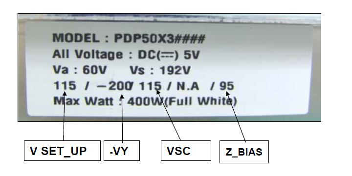

                          Re: LG 50PA5500 no picture
                          You need to check voltage test points.
                          Vs and va located on the power supply.
                          Vsc and -VY on the ysus
                          And z-bias located On the z-sus.
                          The voltages should match the panel sticker like so:
                            With the power on right? Can i use a digital multimeter with ac/dc voltages up to 600v?
                              #34
                              Yes, power must be on.
                              And use DC range. Do not test on AC range.
                                        Ok. I left my upper buffer board off, plug that back up? Also, the voltages from the picture should be at or around those numbers?
                                        • Hamie
                                          • Apr 2014
                                          • 1383
                                          #40
                                          You can check the voltages required either with both buffers connected or both removed.
