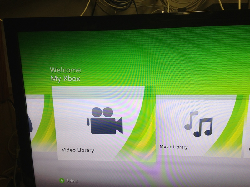

    Found this while driving home last week. Unfortunately it had started drizzling and by the time I got to it, there was a light misting of rain on the TV. I've spent the last couple of days trying to dry it out. Had a fan blowing on the front and then the back hoping to get it dry.

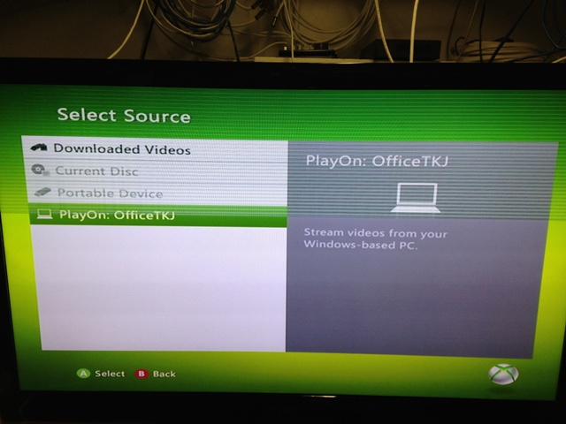

    Powered it up today and the picture below is what I saw. The lines on the top 40% of the screen are regardless of the input and also show up in the menu.
    My question is: Is this a panel issue or a board issue?

    I would say probably panel, could be down to the tab bonds, which "may" be fixable.

      That's the opposite of what I was hoping for. At least it didn't cost me anything.
        Re: coby ledtv4626 46" LED TV
        Tons of new LED TVs are dying due to panel fault, cost cutting likely the cause
