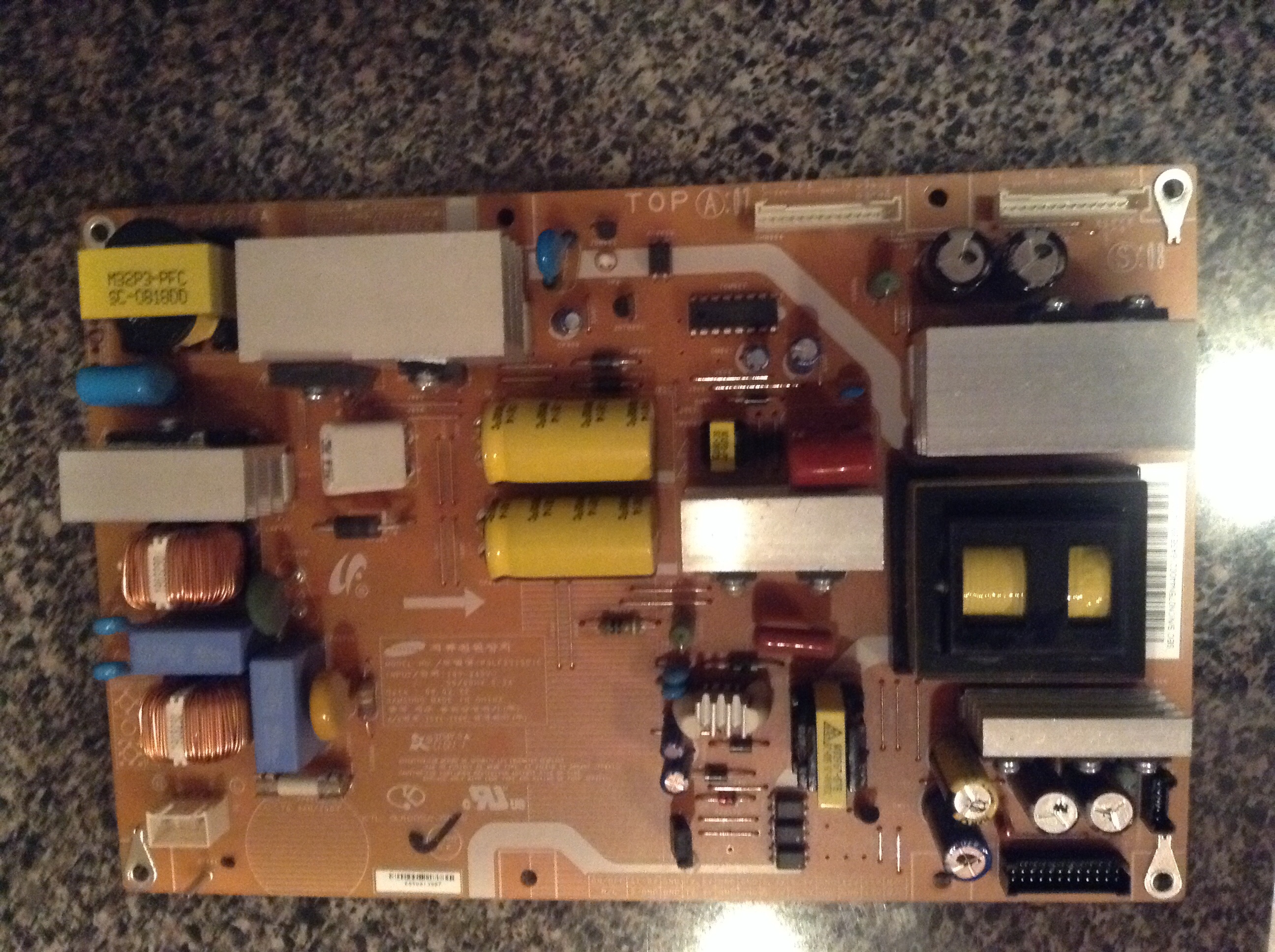

    I am looking to get some info on repairing my Samsung ln37a550p3f. It stopped working and won't even power on the red "power" light when plugged in. I have removed the power supply and noticed several caps that are leaking but not bulging at all. I know that the caps are a common problem but didn't want to just start replacing things without getting some advice. I am capable of replacing the caps if that is the problem but I'm am unsure of how to troubleshoot the board. Also I am not wanting to spend much because this set is about 5 years old and I didn't pay much for it. I have attached some pics of the board for reference. Any help would be great.

      Should I replace all of 6 on the left side in the picture? I just haven't seen anyone have the issue of the tv not powering up at all. Most people at least get the clicking sound. And one more question how do I know the right caps to get I see the values on the but on digikey they have a lot that match but are different physical size and ripple current. Sorry for all the questions I just want to get this thing fixed.

              How do you know the caps are leaking? Looking at your photos, those caps actually look fine and those black marks on top are usually marks from a permanent marker when they are being checked. Since you don't have the red standby led light your PSU is probably not outputting the standby 5V.
              Have you checked the main AC fuse?

                Test output voltages at the connector on secondary side of psu

                  I guess I don't know the caps are leaking. I thought that the black stuff on top was from them leaking. How can I check the output? And yes I have checked the fuse. It was good.

                        OK, see the output connector going from the power board to the main board (with the video inputs on it?) Can you get a listing of the voltages on each pin and a photo of the label near it.
                        To test voltages, red probe touches each pin and black probe on chassis, DC20V range.

                          Sorry I haven't had time to look at this. I plugged it all back up and did not get voltages on any of the 24 pins. I double checked the fuse and checked for power at the wall plug just to be certain that my meter was working. What now?

                            OK. Now, please undo the connector between the main board and power board. Are there any outputs if you do this?

                              Not sure if I fully understand the process here but I have tried to get readings with the connection from the power board and input board plugged in and not plugged in. Still nothing
                                Re: Samsung ln37a550p3f
                                That's exactly what I meant, it means the power board is bad. You can either replace it, or we can try to repair it. If a repair is to be attempted, the BN44-xxxxxx number off the power board is required, so schematics can be obtained.

                                  Not sure if have have the skill set to repair the board but I guess it's worth a shot if you are willing to lead me through it. The number on the board is BN44-00216A

                                    Schematic available:
                                    Do you see the two big yellow capacitors lying on their side next to each other?
                                    With your multimeter on its highest DC range (for example 1000V) test voltage across them (not from one end to ground; red probe one end, black the other.)
                                    What do you see? Expecting 160~170V or 380~400V, if that area of the circuit works.
                                    You are testing on the primary side. Please be careful not to slip or touch any heatsinks, due to the shock hazard.
