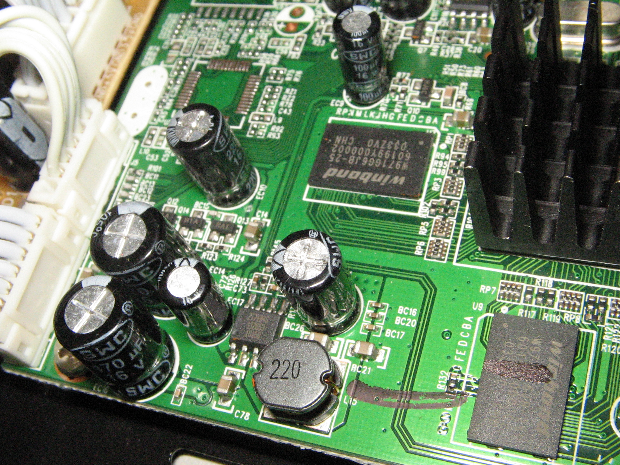

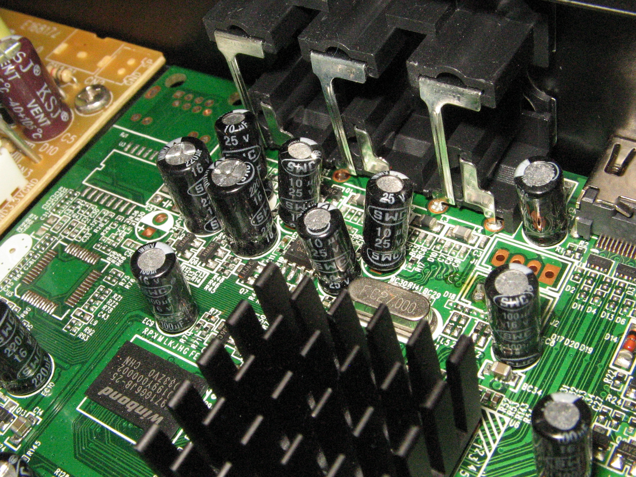

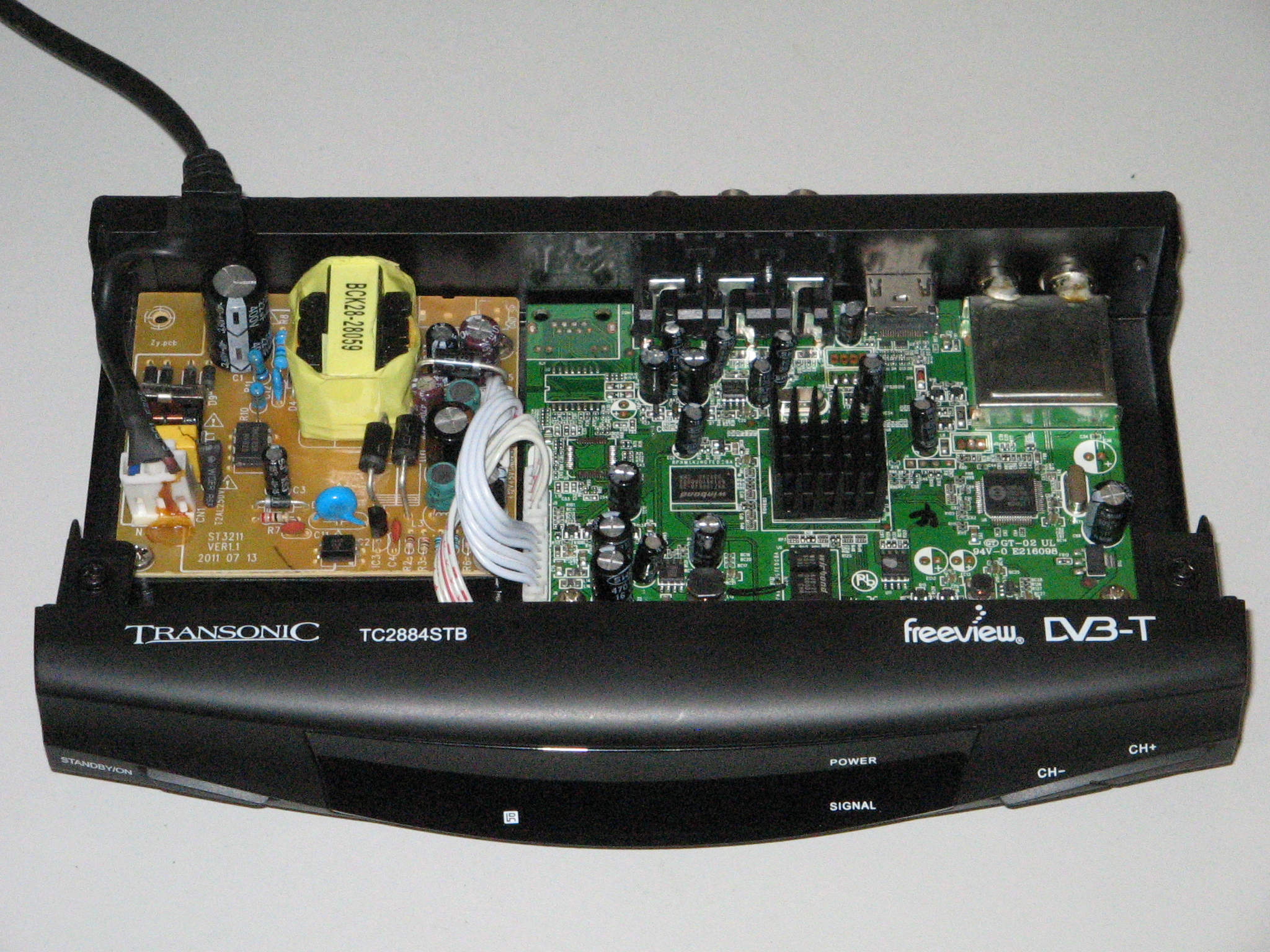

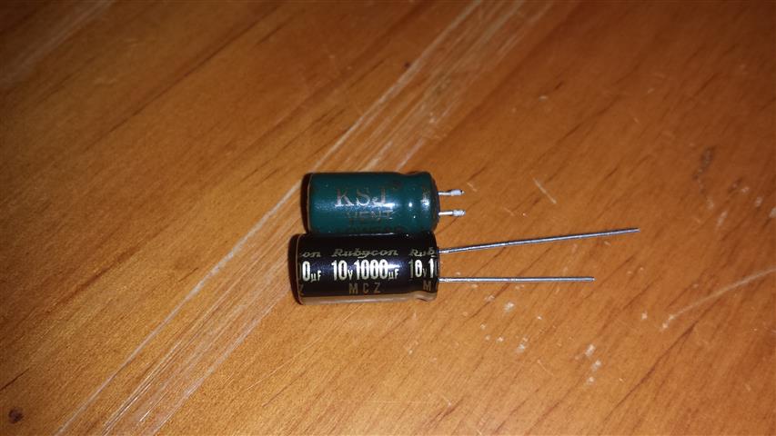

    Got a Transonic TC2884STB here (Transonic is a brand 'exclusive' to a cheap department store in NZ) but no doubt from some big Chinese OEM.
    Symptoms: Turns on but remote\buttons unresponsive. Doesn't output video signal.
    I can make it work by blasting the mainboard with a hairdryer for a couple of minutes. This leads me to suspect marginal capacitors.
    The problem is they are brands I have not heard of and (so far) cannot find online.

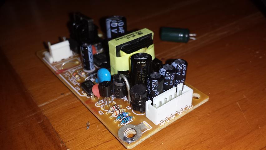

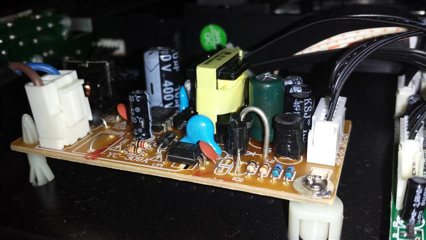

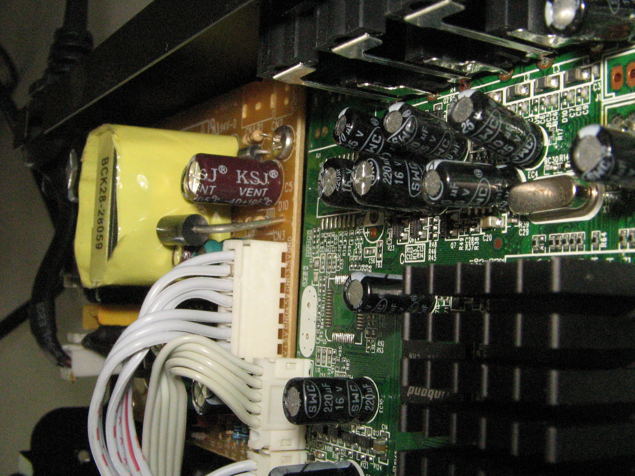

    The PSU uses "KSJ" with no series (but the variety of sleeve colours probably means the series are colour-coded rather than labelled)
    The mainboard uses "SWC" and they all appear to be "KM Series"
    They do turn up here: http://capacitor.web.fc2.com/s_other.html#swc but there is no web address.
    They all seem to be either 10, 100, 220 or 470uF.
    What would be an advisable series as a general (and cheap) replacement, assuming no datasheets can be found?

    It's worth a shot replacing those capacitors, but based on "heating it makes it work" it could also be some surface mount stuff (ceramic resistor or capacitor) make contact with pcb once the copper on pcb expands with heat.
    Yeah, standard capacitors should do it, I don't think you need to use anything fancy.

      Any recommendation for a suitable brand\series? I normally lookup the original datasheet but in this case can't find it.
      I assume Panasonic FC or similar would be a sensible choice - Low ESR but not super low.

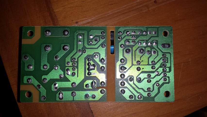

        Just found the same looking caps in a Laser brand DVD player, model HD0020 from a cheap department store here in Australia (Kmart)
        The one marked KSJ had LOWESR written on it, so I used a Rubycon MCZ to replace it... mostly because that's all I had here at home.
        I only replaced the one suspiciously bulging cap, then replaced the power board and bench tested it and it seems to be working ok.
        Might consider ordering replacements for the rest of the board too before it goes back into service.

                            I recapped this one yesterday, unfortunately the problem has not been resolved. At first test it did the same thing, no video output and buttons\remote not responding.
                            I tried it a few more times and after the CPU heatsink became warm it worked, a-ha I thought, perhaps it's bad BGA soldering here?
                            Problem is I tried it again last night and this morning when it was stone cold and it worked just fine, where before it had not done so as I recall. So this looks like some pain in the ass intermittent that may or may not be heat related. Great.
