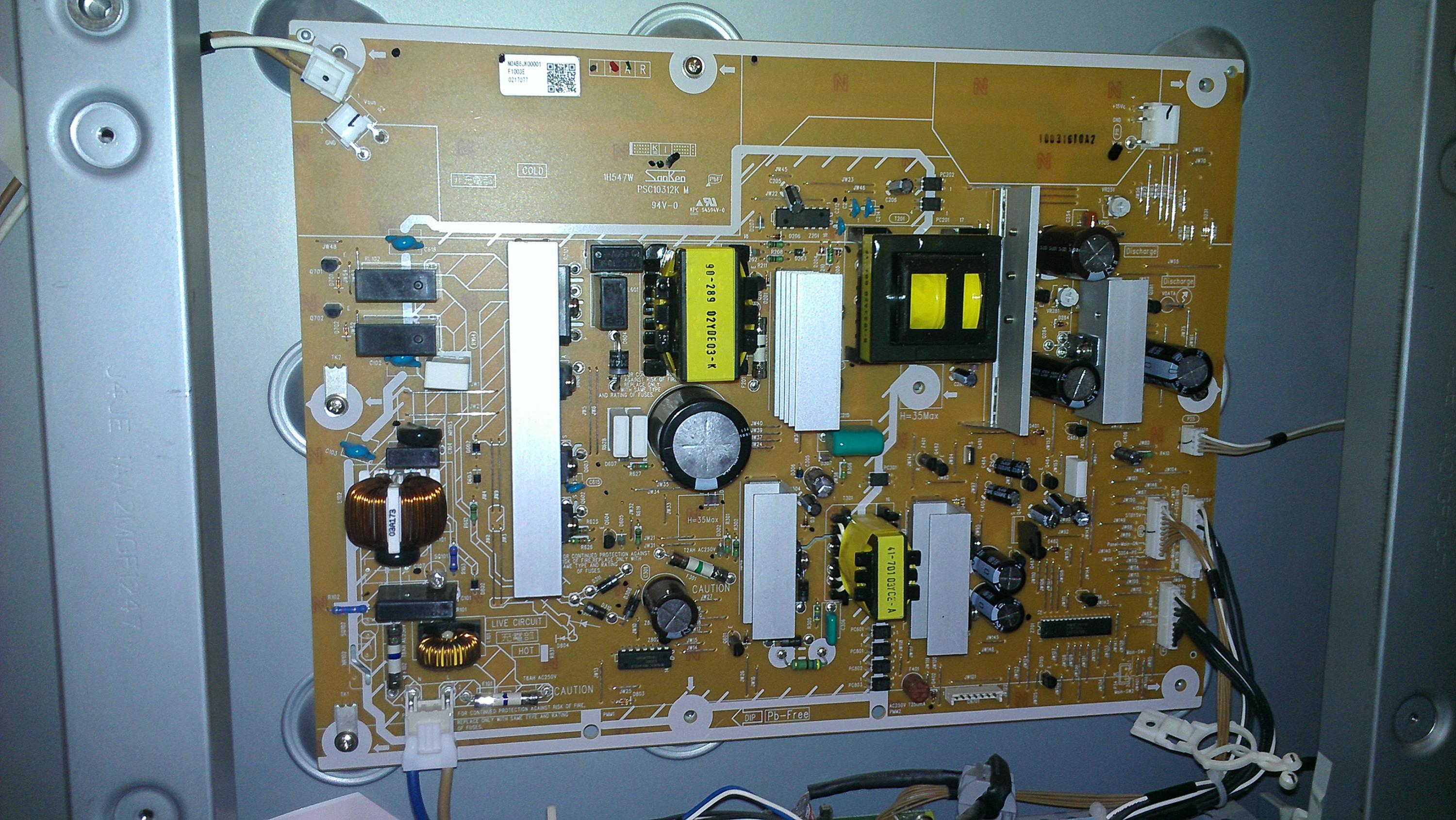

    So what i thought was the problem was my PSB so i replaced it...no luck

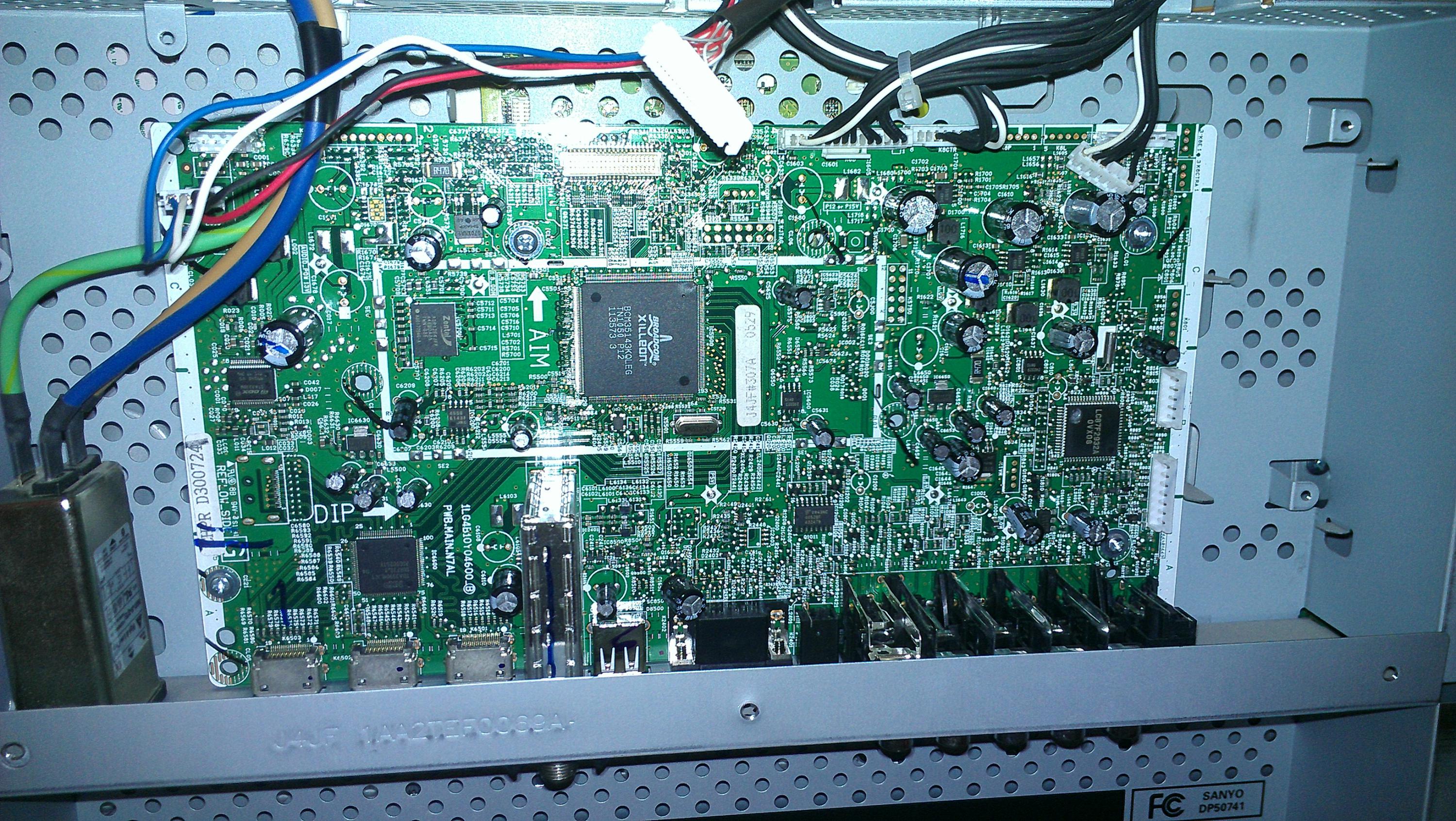

    Then i found something funny in my main board (no voltage at the audio 13v star thing.) so i replaced it ....no luck
    A few things i have done for self diagnosis are start unplugging and every time i unplug check to see if it stays on longer. only when i unplug both left and right boards the tv stays on for about 7 seconds but does not and will not stay on at all.

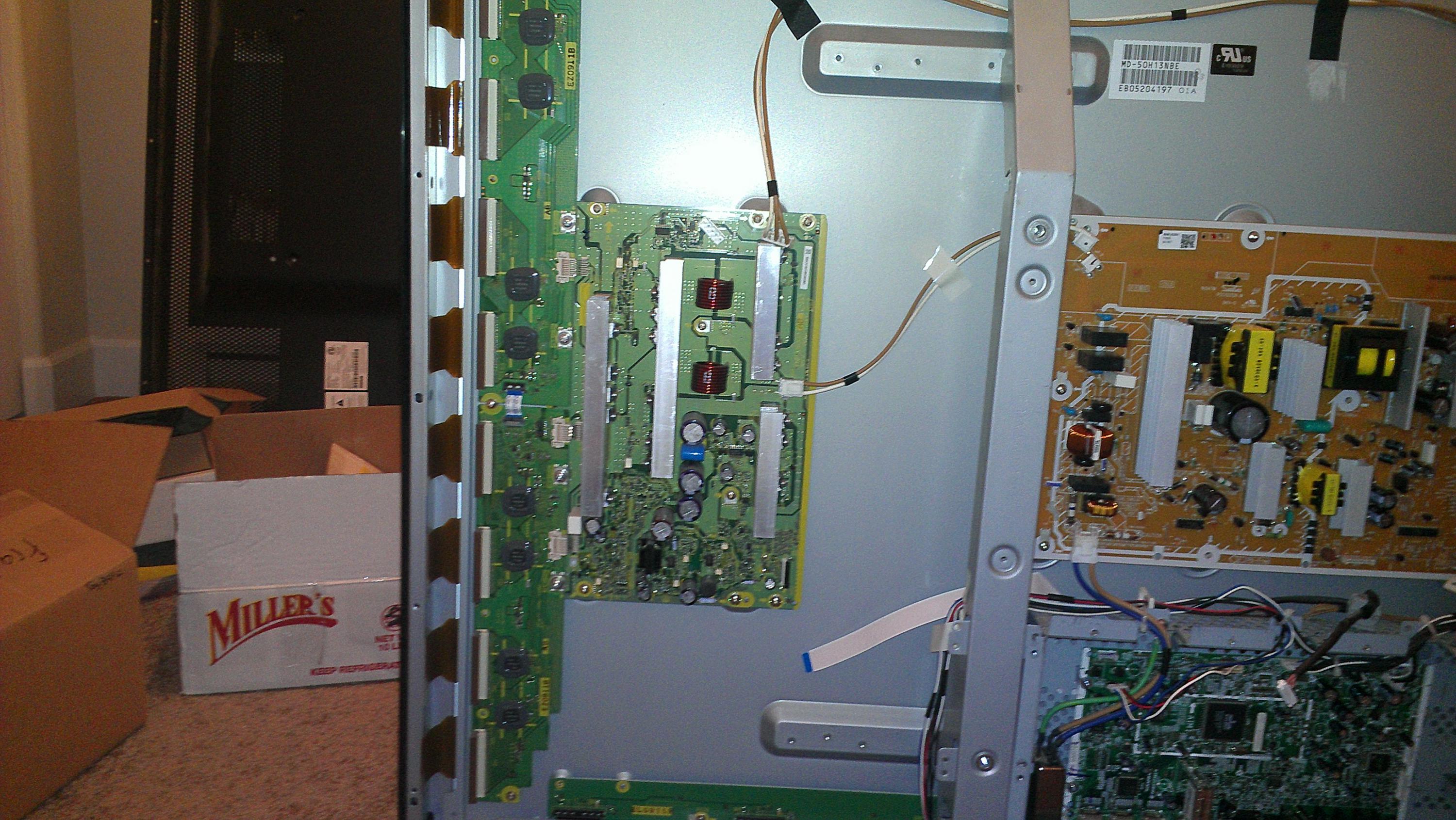

    I just had a quick look at the SJ website to see what boards this has since you don't have a picture of the complete setup.
    It's a Panasonic panel and driver boards. On the left you have 2 buffer boards known as SU(upper), SD (lower) driven by the SC (y-sustain).
    On the right you have ths SS ( x-sustain ) which I suspect is board number TNPA5072 rev AE ? I know that board fails shorted in the Panasonic models and i suspect why the TV shuts down straight away when connected and with it disconnected stays on longer.
    On the TNPA5072 there should be a connector which the PSU is connected, SS11. disconnect the power cable and measure resistance across TPVSUS and gnd pin, you may find this shorted.
    On this board Q001,002,021,022 can go short but these boards are fairly cheap to buy if it has failed.
    I'd do the same and check on the SC board TNPA5063AB at SC2 for short as well across those 2 pins.

      Thank you for getting back to me I checked my x Sustain tnpa5072 ae board and I tested the connector that comes from the powe supply (TPVSUS). On the power supply they are vsus, gnd, and +15Vc I get 0.000 between vsus and ground. And OL between +15Vc and ground. And OL between +15vc and vsus.
      Then I checked my ysus TNPA5063 AB and tested connector SC2 and I don't get continuity and the ohms jump around

        So on the connector at the SS, SS11 0 ohms tpvsus -gnd, just as I suspected. Looks like just that board to start with, no shorts anywhere else so replace the SS.
