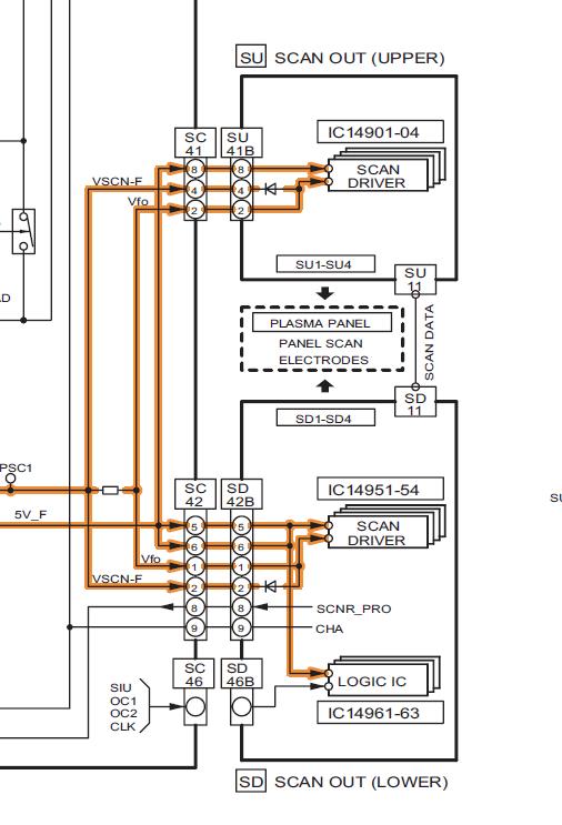

    You'll have to work out the pins, one side is odd, the other even. I've attached a picture for a guide.
    At SU41 measure pins 2,4, 8 with respect to the gnd point where the bolts go.
    SD42, pins 1,2, 5&6(should be the same result) to gnd
    note the results.
    I don't know the exact figures but i have a good idea and if bad hopefully it will stand out
    These tests are done with the boards disconnected from the SC, the interconnecting ribbon between the SD/SU is disconnected too. I usually remove them from the TV, reseating the panel ribbons can be tempermental if you have not done it before.
