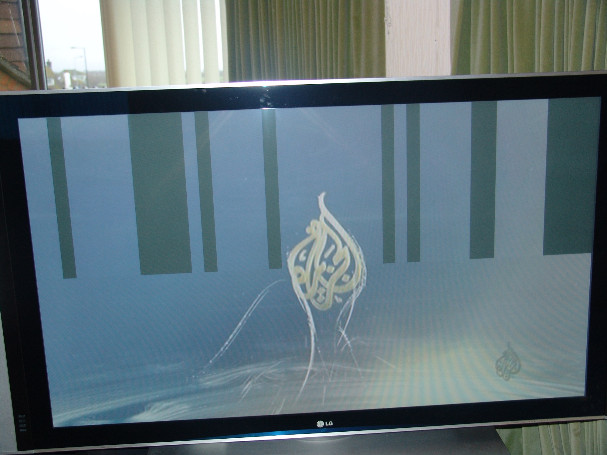

    Hi Guys,
    Can anybody comment on were they think the fault is with this plasma from the attached photo?
    Thanks.
    Re: LG Plasma RZ 60-PY10
    Most likely cracked solder joints on the COF resistors.
    The COF are at top and bottom of panel, and run the length of the panel.
    There may be burn in where the parts of the image did not light properly.
    • blib
      • Feb 2012
      • 56
      Thanks Tom.
      Should I only be looking at the cof chips at the top of the panel as the lines are at the top of the screen? Is it possible to resolder them?
        Yes, and yes.
