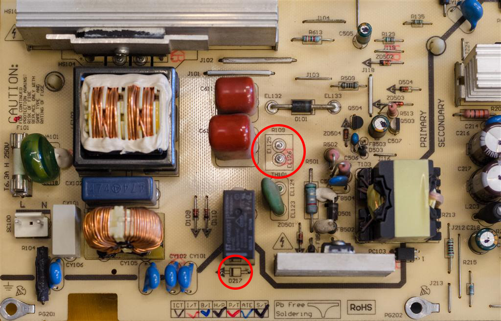

Hi! This is my friends TV with EAY32731102 power board and someone ripped off some components, one resistor R109 location and one Diode D217 and I can't find which one was that, can't find schematics.If someone can help me identify those two, any help will be appreciated. Thanks
LG 42LY95 Help identify components.
Re: LG 42LY95 Help identify components.
D217 will be 1N4148 type.
The R will be 5W, on the order of a few ohms. (<4.7 ohms.)
Also the person who "repaired" this board clearly did not know how to solder; fix the cold joints too.Please do not PM me with questions! Questions via PM will not be answered. Post on the forums instead!

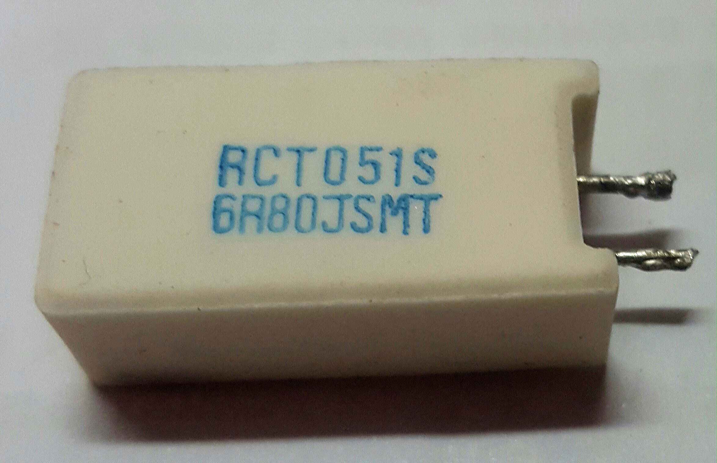

I know this is an older post but I'm currently working on this unit so I thought I'd add this information. The component R109 is a Thermal Cut-off Resistor or Fuse, it's a RCT051S / 6R8. Here is a link to the DATASHEET.
This is an image of the bad one I pulled out. Not having one on hand I temporarily am testing it with a 2W 6.8ohm resistor in series with a glass fuse.
Hope this is helpful for someone. What I could really use is a schematic of this darn board...Comment
